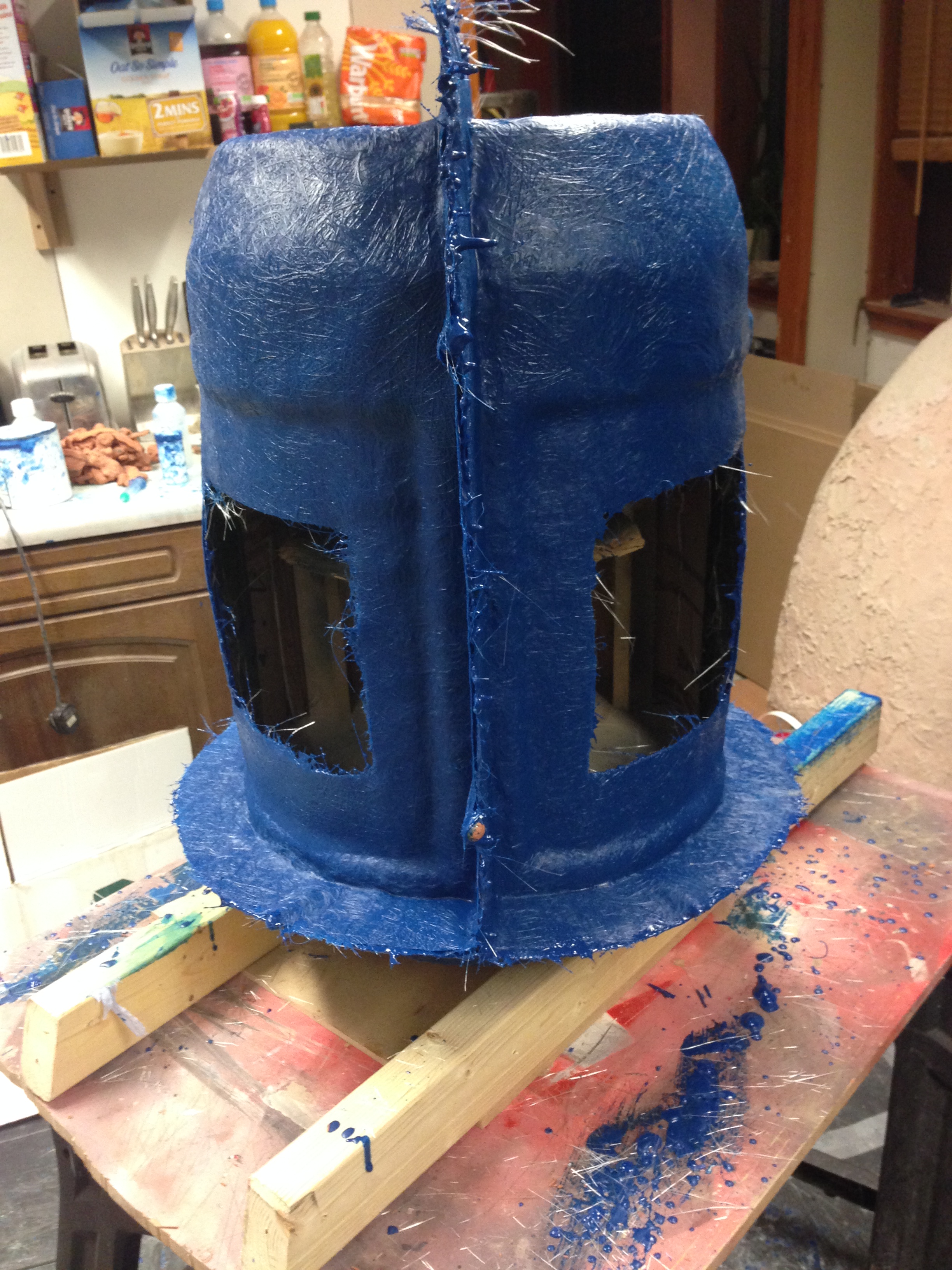

time for another photo dump, I finished the body off
2016-02-28 21.49.09.jpg2016-02-28 21.49.01.jpg2016-02-28 21.48.49.jpg2016-02-28 21.48.04.jpg2016-02-27 18.52.52.jpg2016-03-20 22.13.41.jpg2016-03-20 22.13.34.jpg2016-03-20 22.13.28.jpg

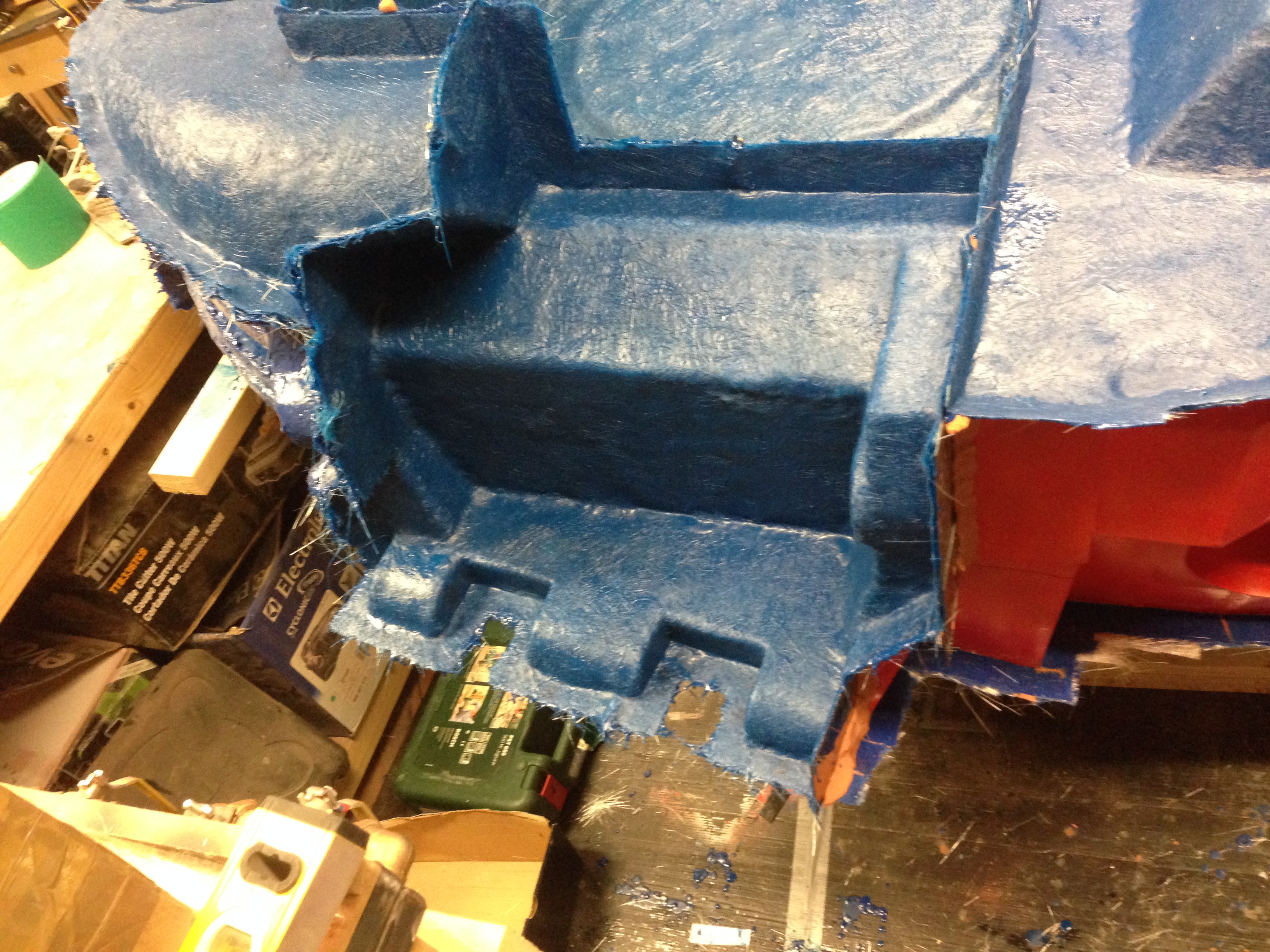

Also trimmed and drilled for bolts on the body

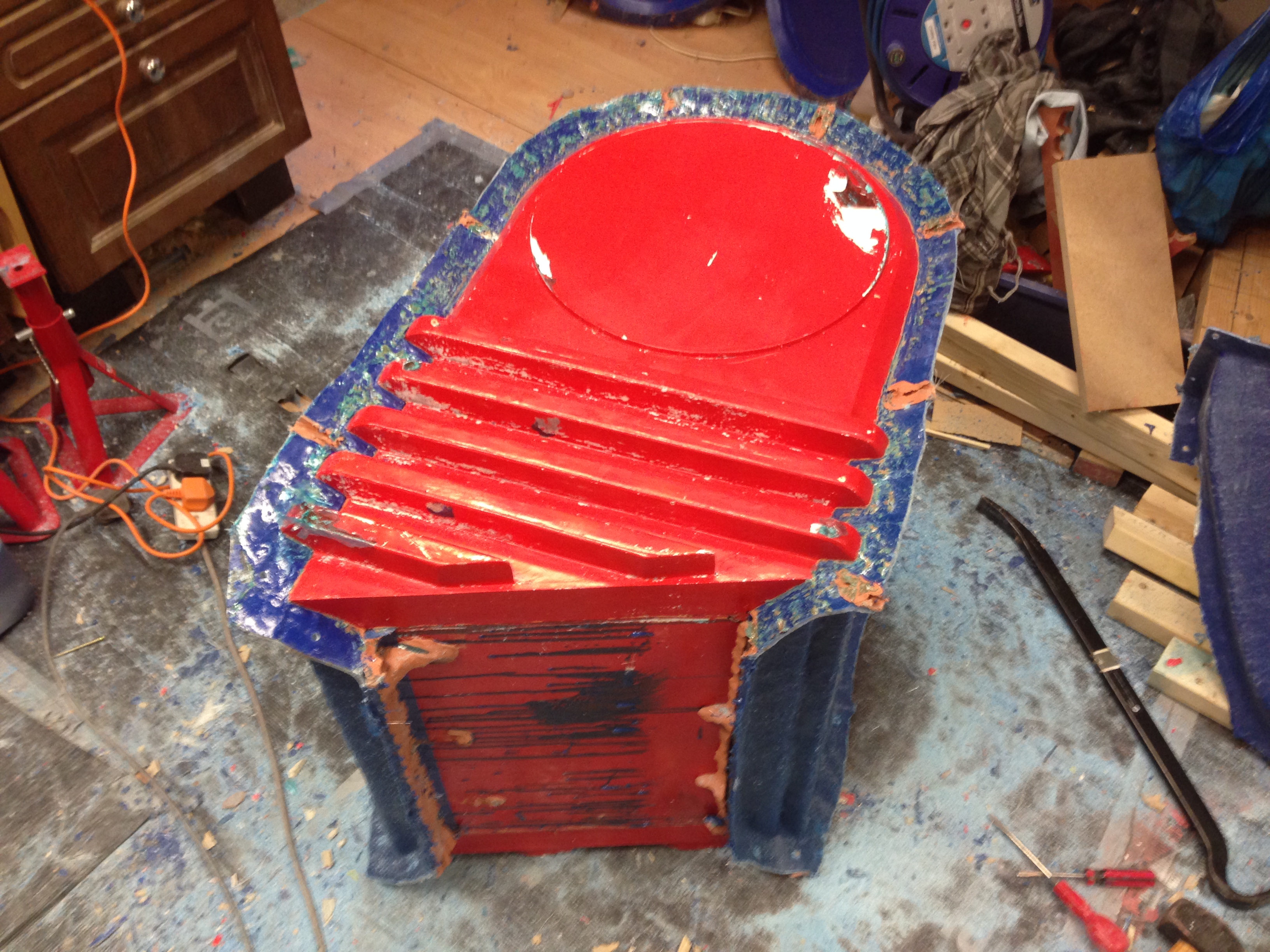

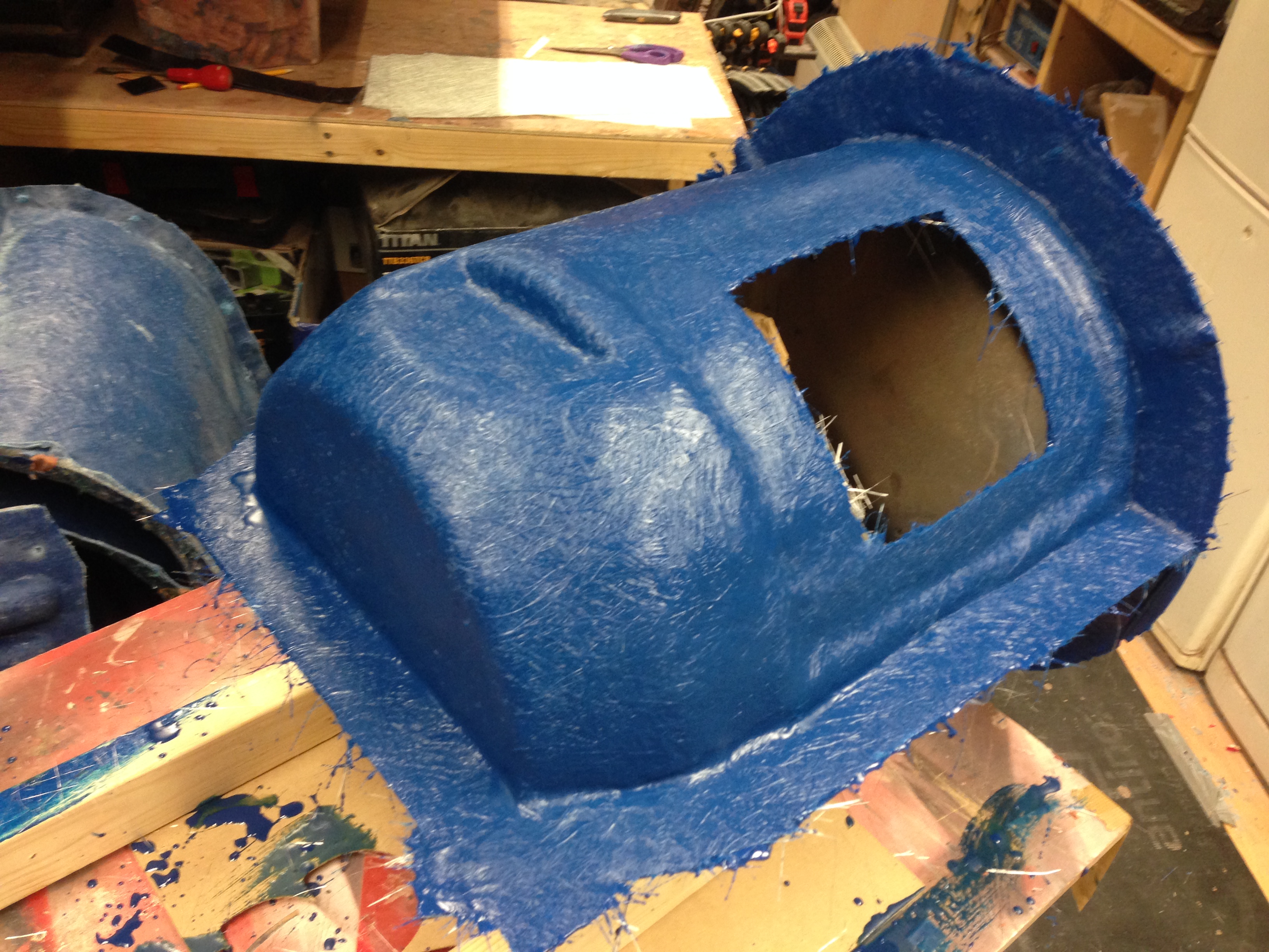

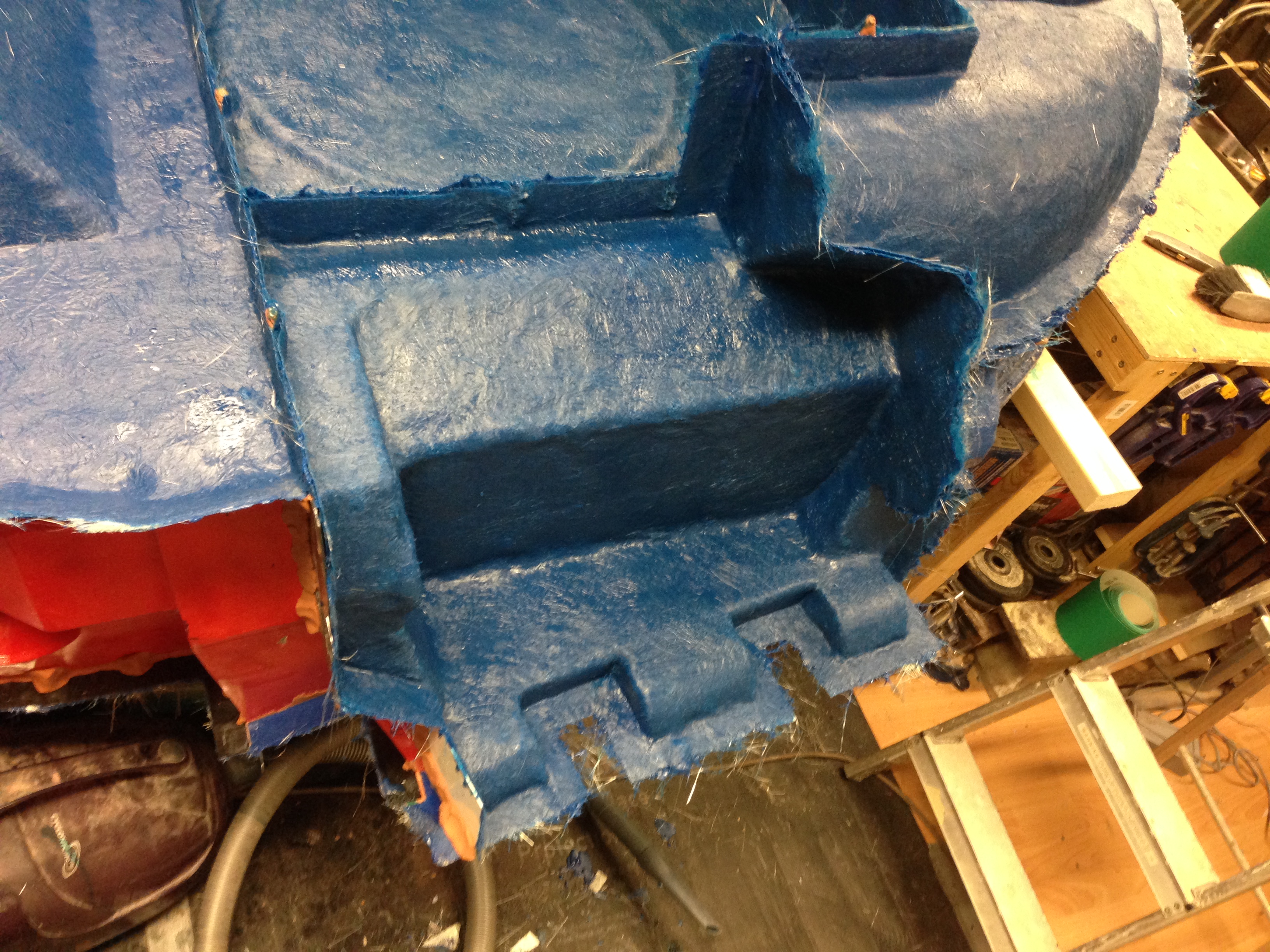

and i demoulded the body and pelvis
2016-04-03 16.15.46.jpg2016-04-03 11.11.59.jpg2016-04-03 13.25.38.jpg2016-04-03 13.59.03.jpg2016-04-03 17.23.25.jpg

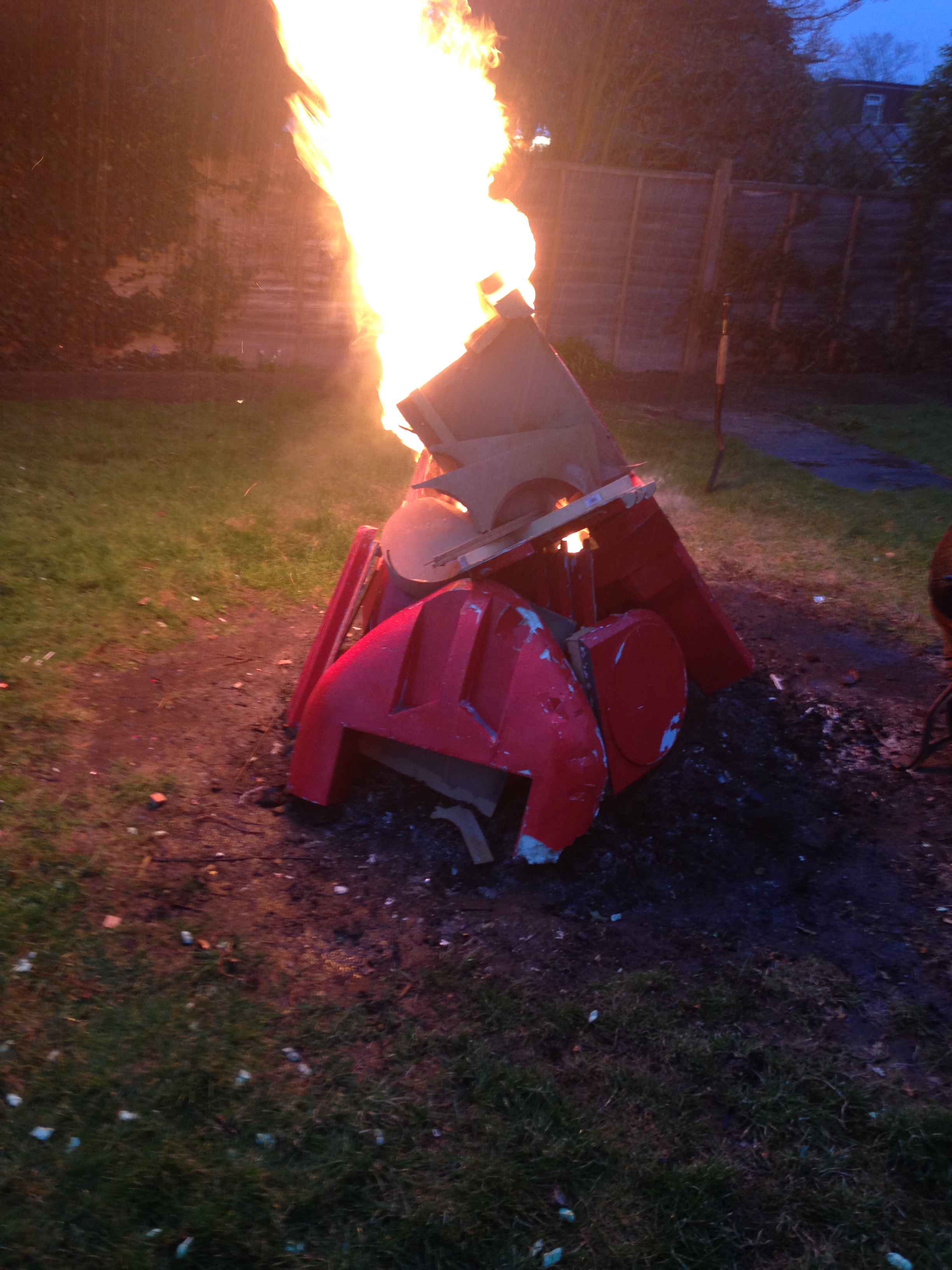

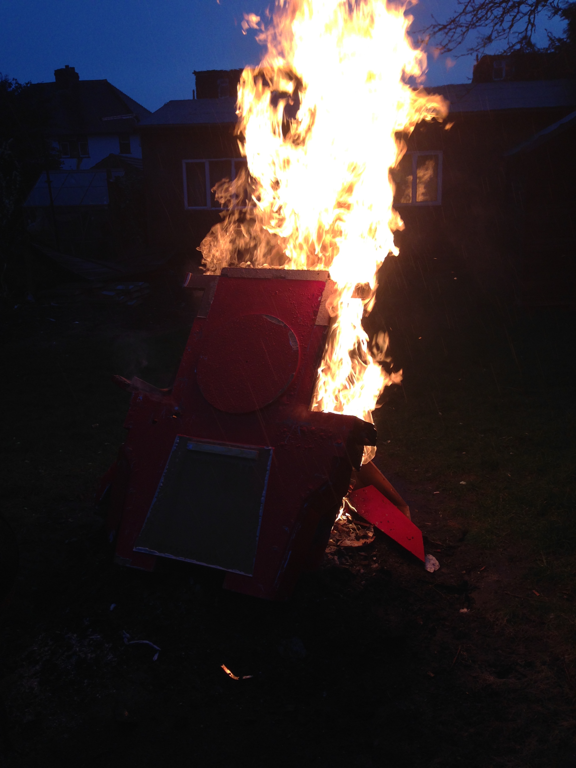

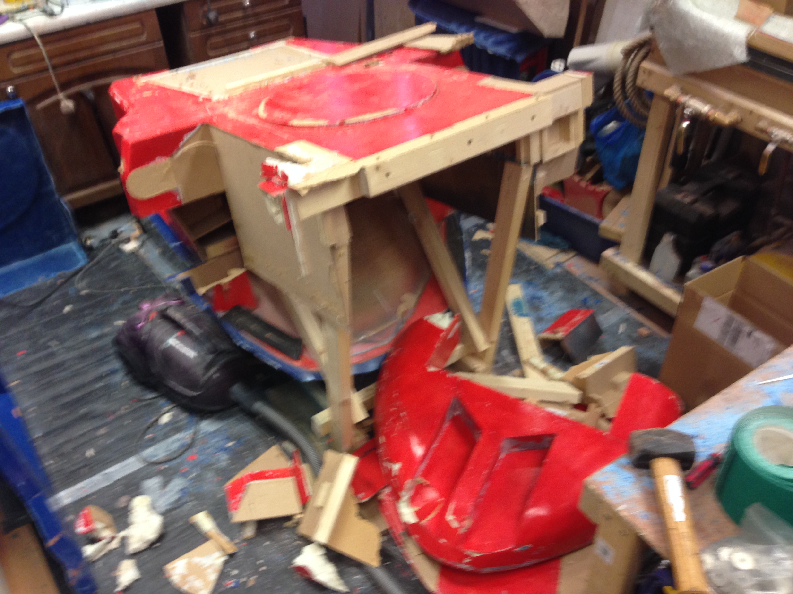

and burned the masters to save space
2016-04-03 19.15.59.jpg2016-04-03 19.15.52.jpg2016-04-03 19.15.42.jpg2016-04-03 19.15.34.jpg
I can only imagine how cathartic that must've been. Best I could manage was to watch a bulldozer crush mine at a landfill.
Gorgeous. :)
yeah it was a strange feeling watching what you have worked months on go up in flames, i'm quite pleased. one of the best things was putting a hammer though it to get it out of my place as it wouldn't fit through the door, plus I was on my own and I couldn't lift the body mould on my own any more.
I've had a few people on the facebook page freaking out and even making me offers for my masters, they don't seem to understand they were only suppose to survive long enough to make a mould of them.

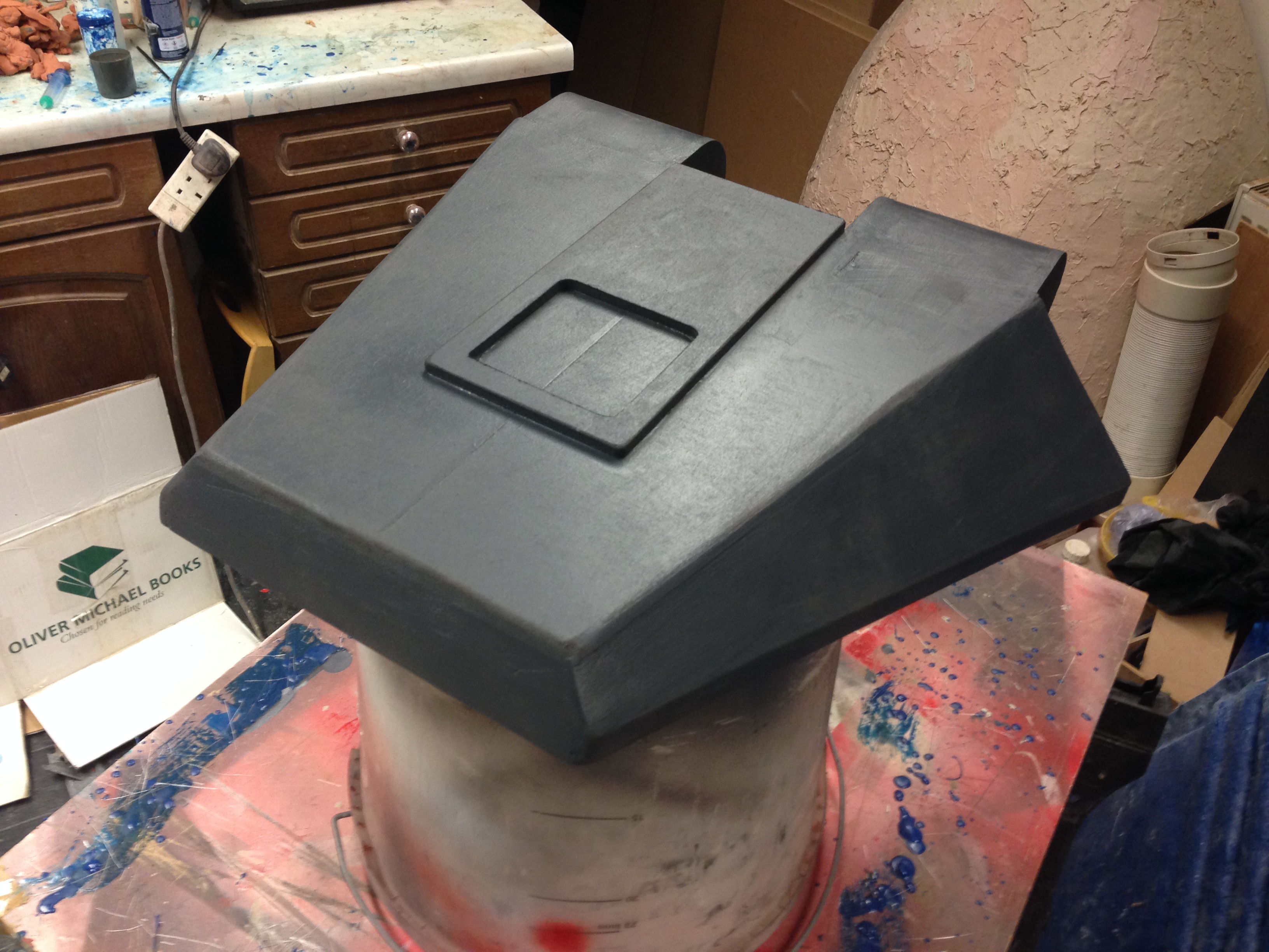

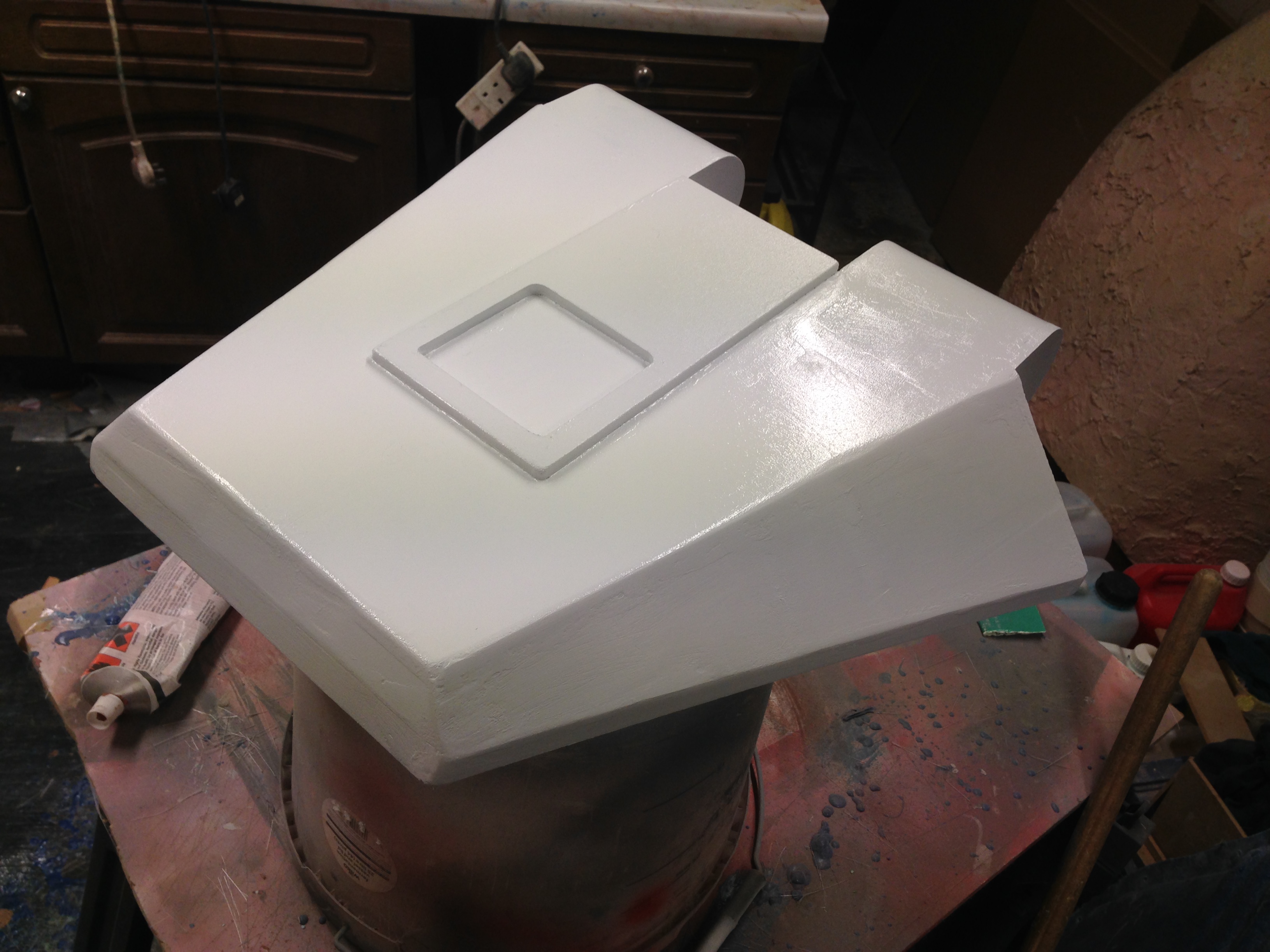

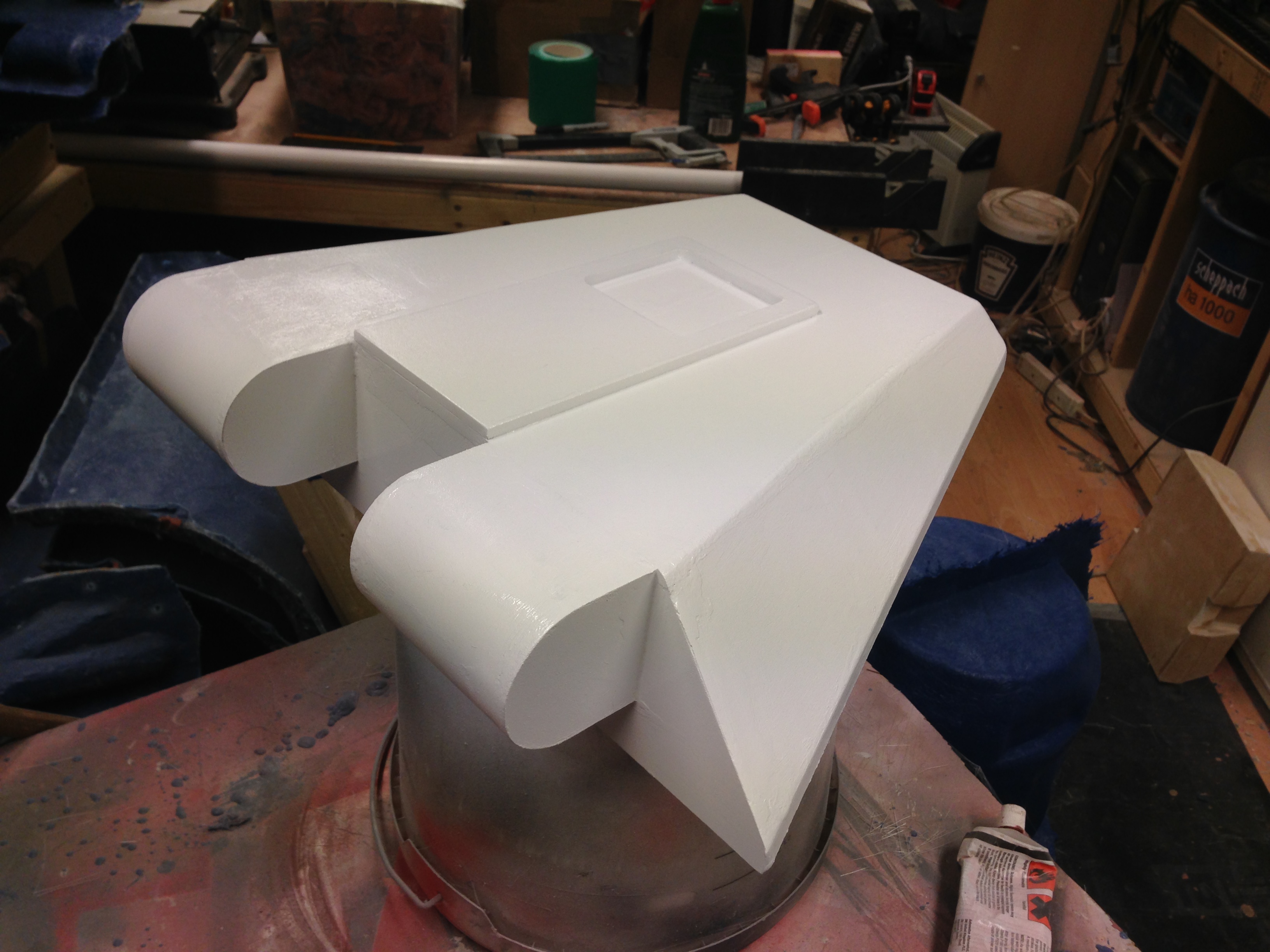

so some more progress with the ED-209 build, finished moulding the gun pod, and created the flap that goes over the elbow
2016-04-08 23.57.06.jpg2016-04-08 23.57.14.jpg2016-04-08 23.57.20.jpg2016-04-10 01.04.55.jpg2016-04-10 01.05.01.jpg2016-04-10 01.05.09.jpg2016-04-10 01.05.16.jpg2016-04-10 22.54.46.jpg2016-04-10 22.54.30.jpg2016-04-10 22.54.23.jpg2016-04-10 22.54.12-2.jpg2016-04-10 22.55.02.jpg2016-04-11 20.34.58.jpg2016-04-11 20.34.51.jpg2016-04-10 22.56.36.jpg2016-04-10 22.56.27.jpg2016-04-10 22.56.14.jpg2016-04-10 22.56.04.jpg2016-04-11 20.35.06.jpg

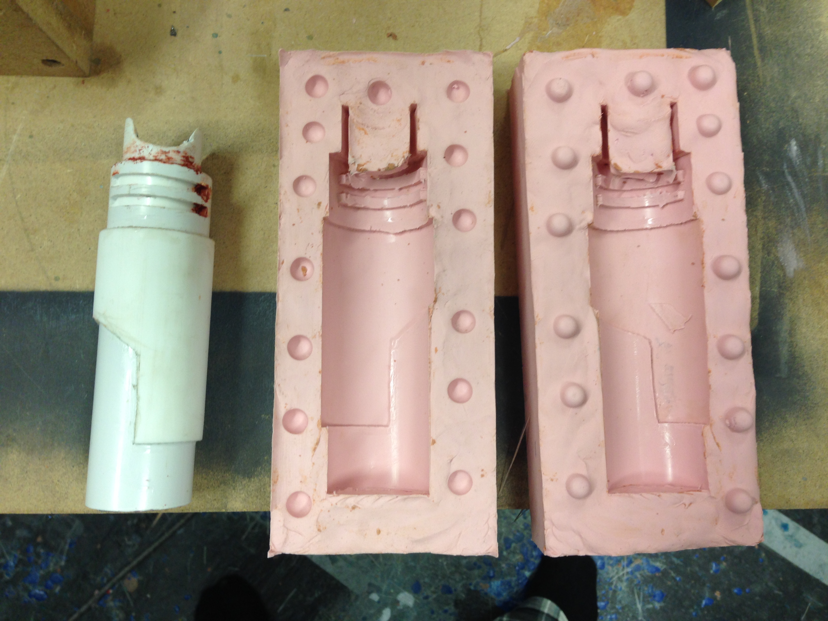

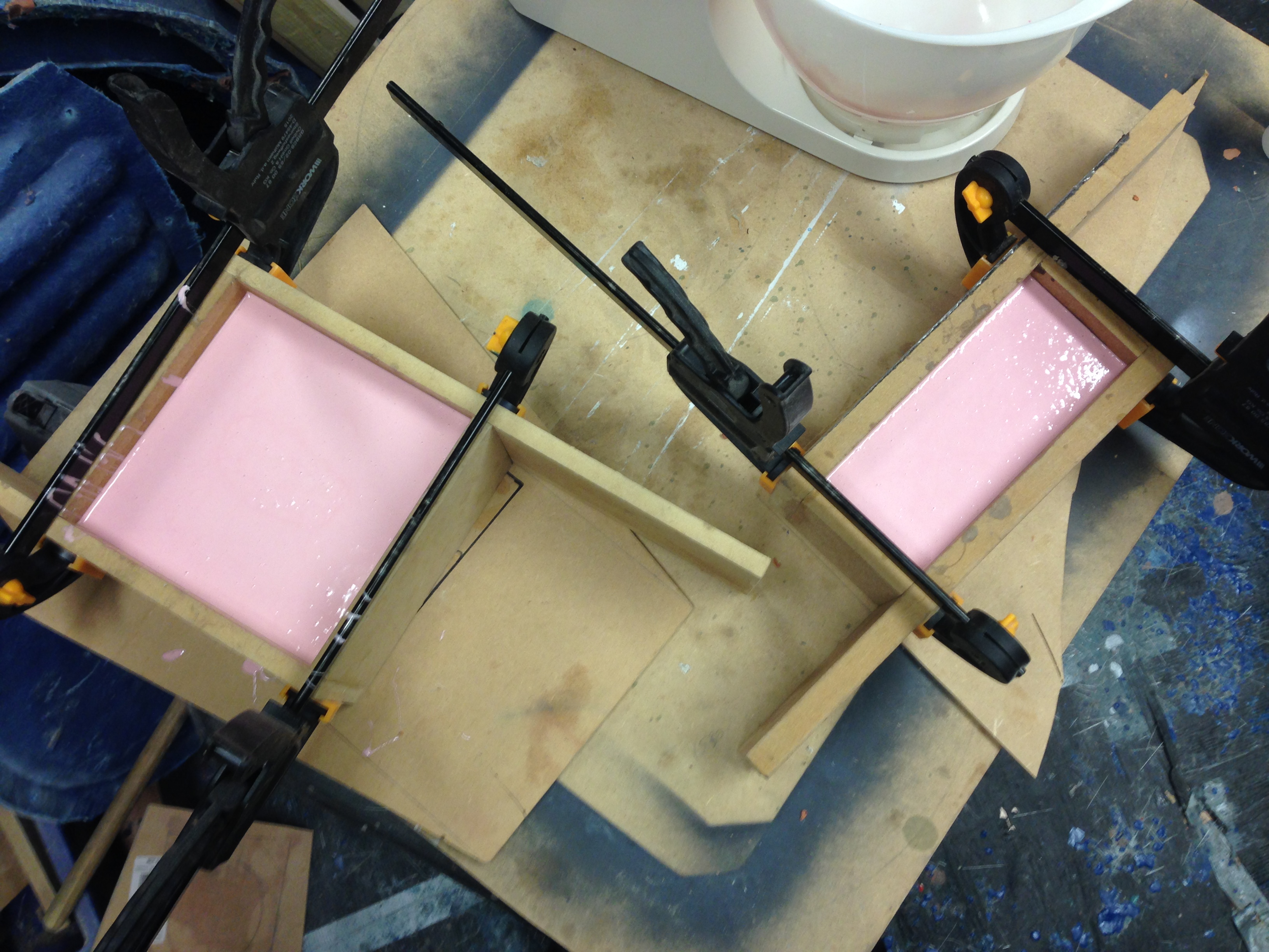

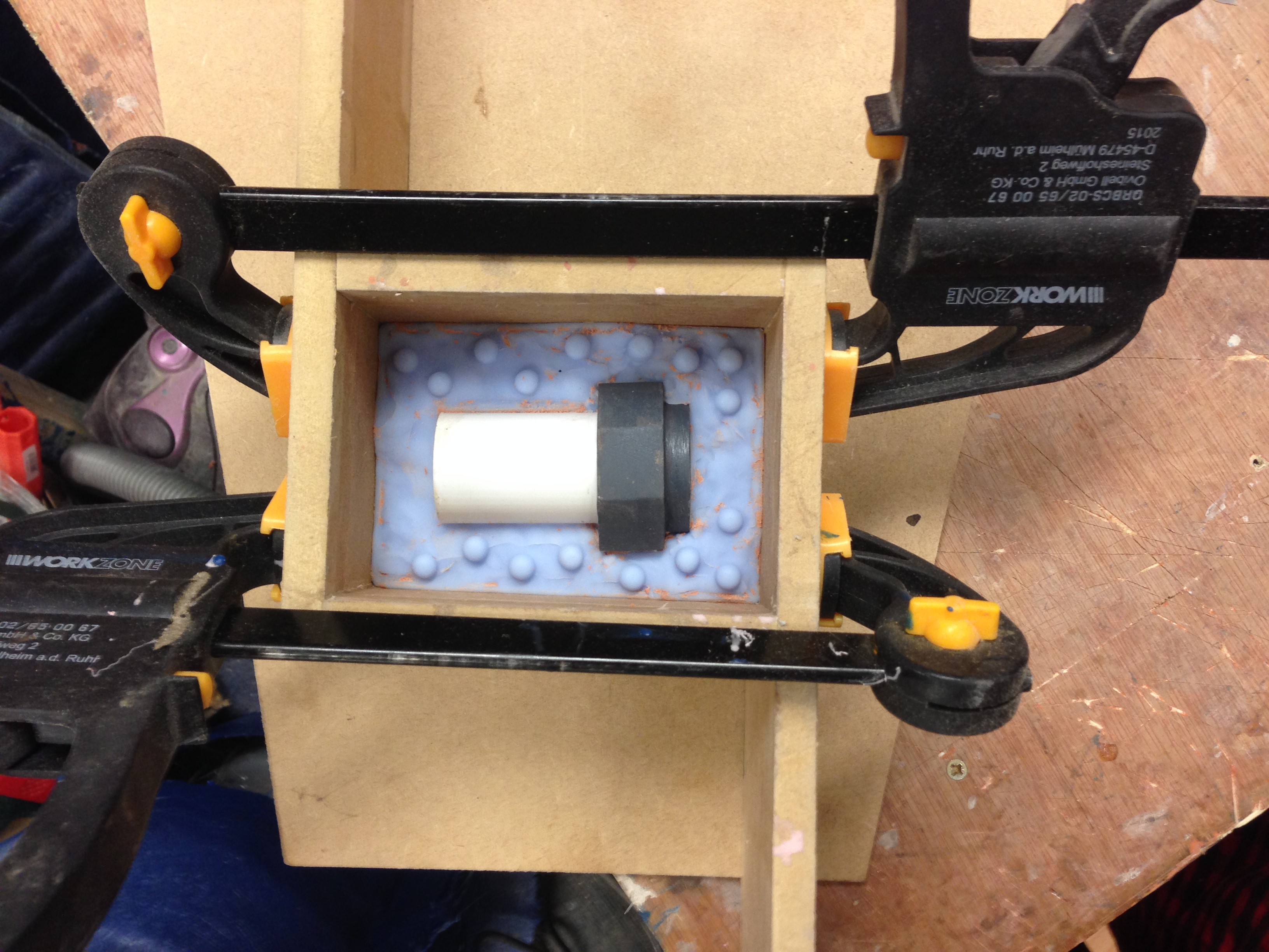

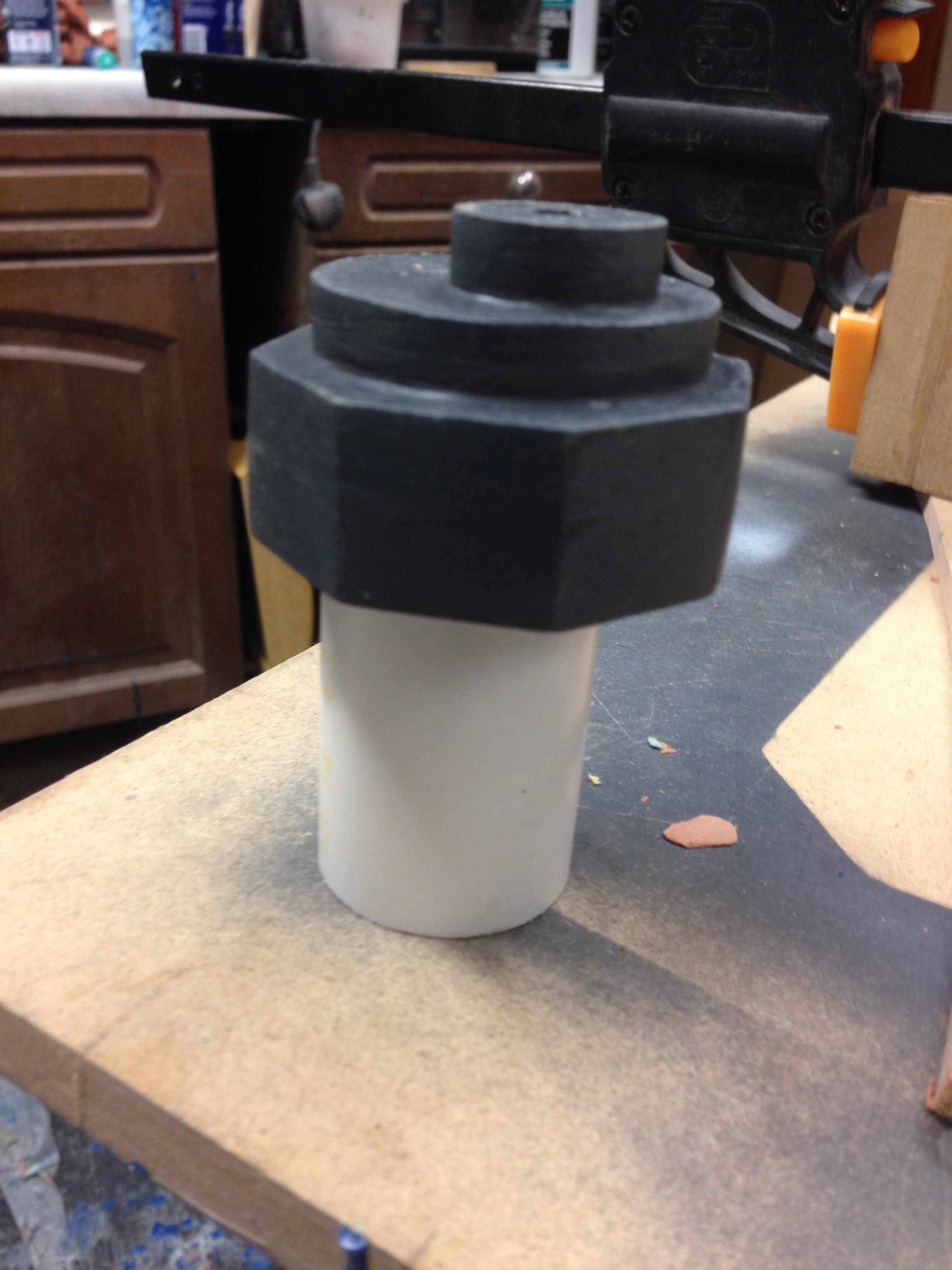

Also moulded some of the gun parts I made a while back, I used a Kenwood mixer to mix the silicone, i had concerns about mixing in too much air bit it didnt mix in any more than mixing by hand. I was careful to run the mixer on its slowest setting and gave it a couple of minutes to sit before pouring.
2016-04-17 18.19.03.jpg2016-04-17 19.15.37.jpg2016-04-17 19.15.48.jpg2016-04-17 21.07.47.jpg2016-04-17 21.49.46.jpg2016-04-17 21.50.18.jpg2016-04-17 21.50.28.jpg2016-04-22 22.41.31.jpg2016-04-22 22.37.25.jpg2016-04-17 22.26.25.jpg2016-04-17 22.26.20.jpg2016-04-22 22.41.59.jpg

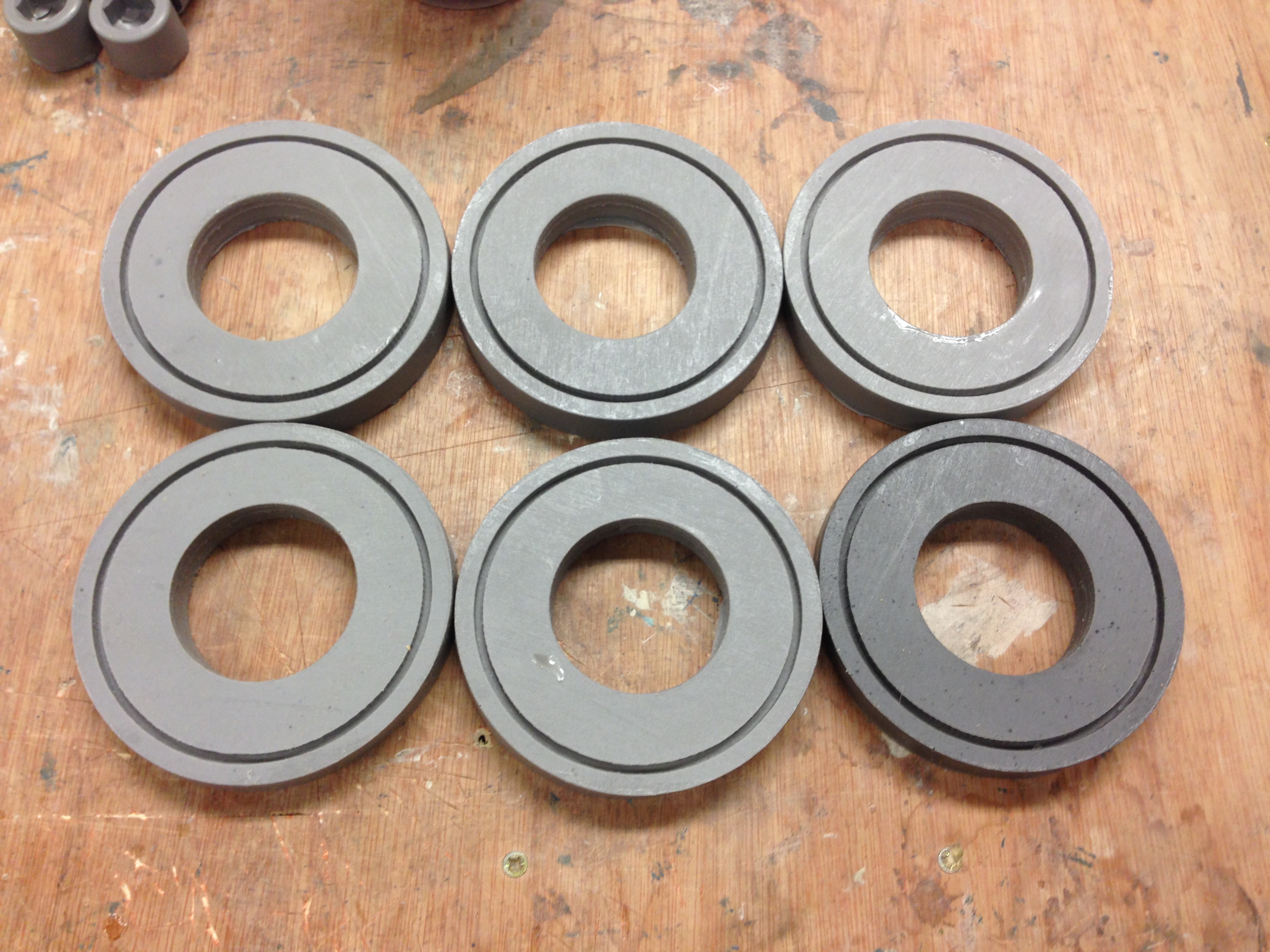

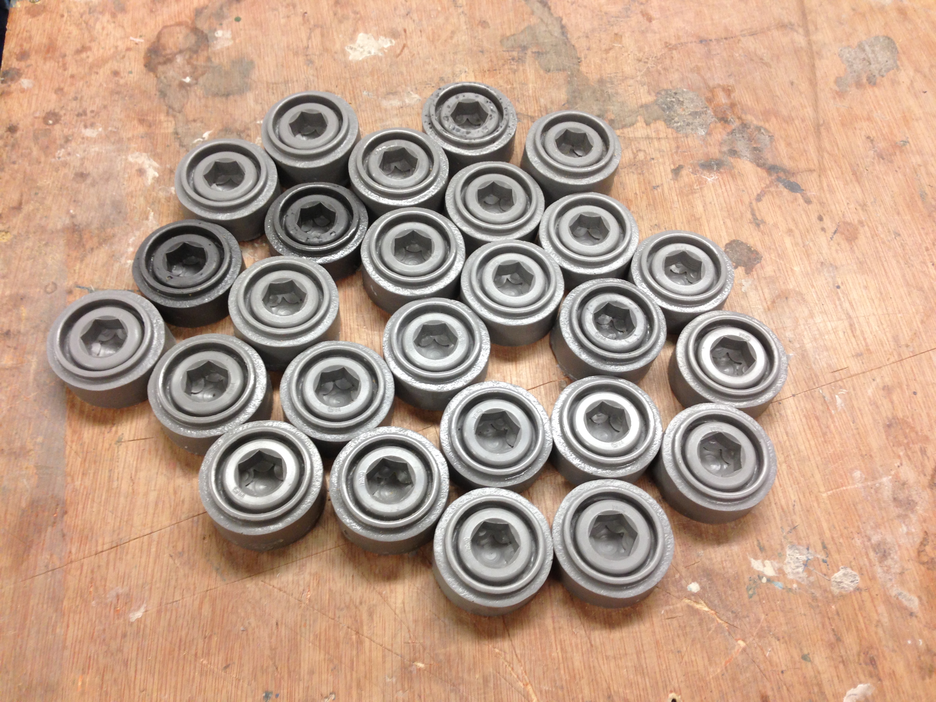

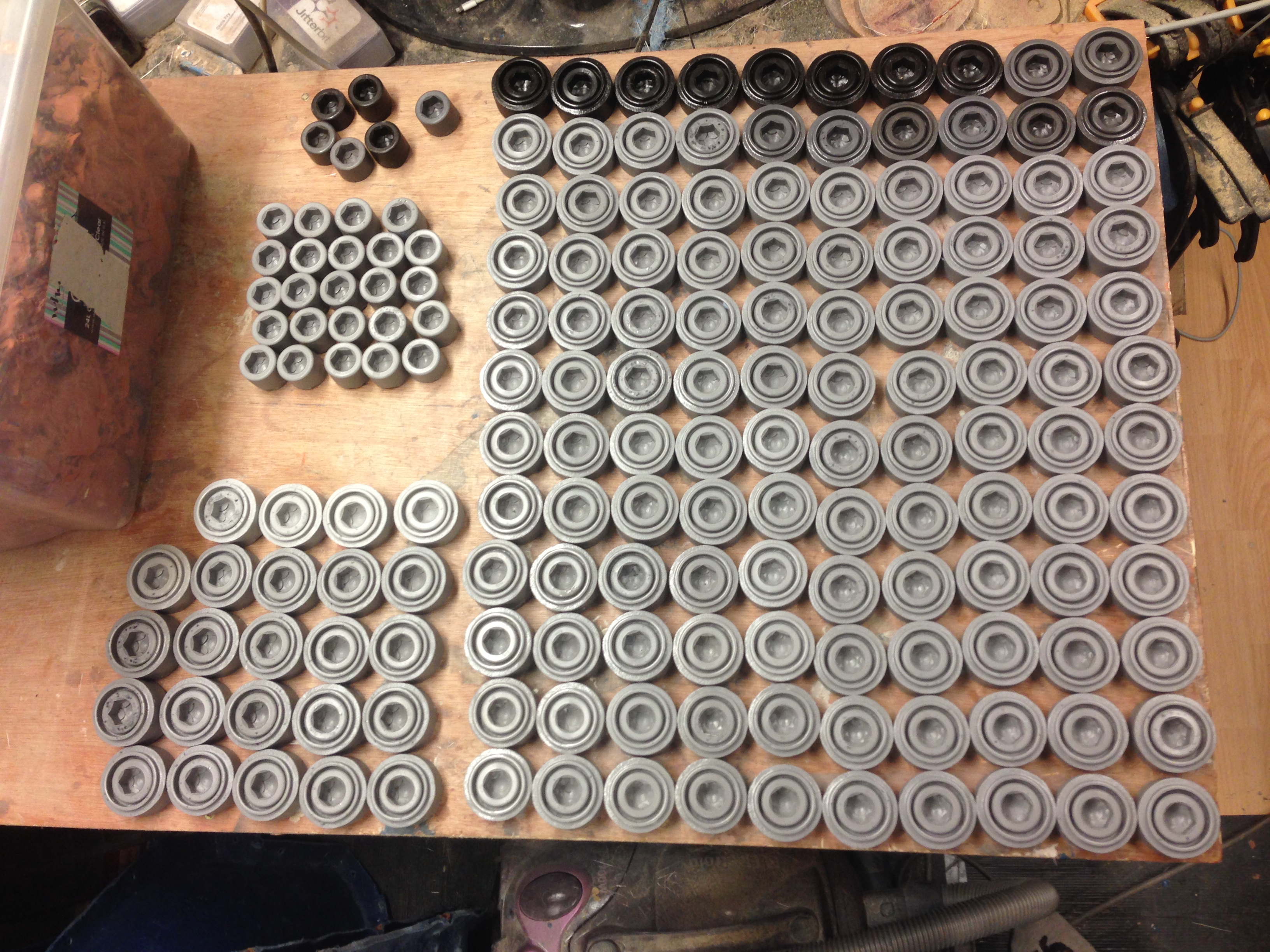

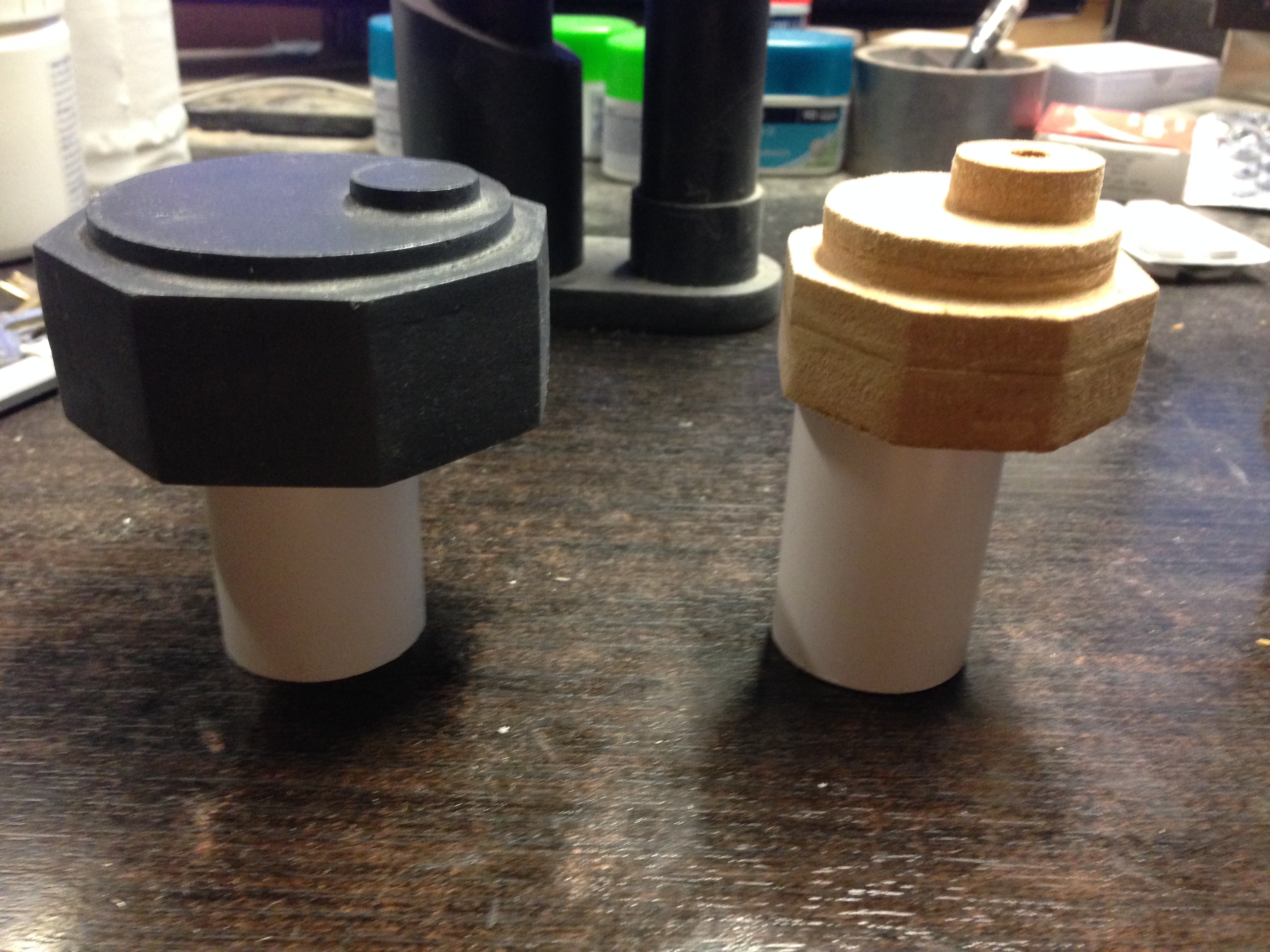

yesterday I remachined a detail for the ammo box as I wasnt happy it matched up to the film and behind the scenes photos, also cast a load of parts with polyurethane liquid plastic and I am very please with the results.
2016-04-23 14.36.21.jpg2016-04-23 16.49.08.jpg2016-04-24 00.34.43.jpg2016-04-24 00.35.41.jpg2016-04-24 00.34.47.jpg2016-04-24 00.37.26.jpg2016-04-24 00.34.39.jpg2016-04-24 00.35.24.jpg2016-04-24 00.37.08.jpg
