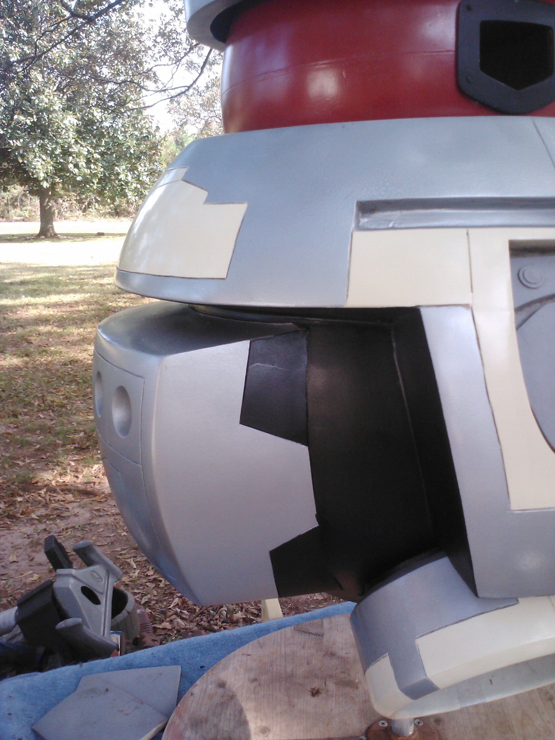

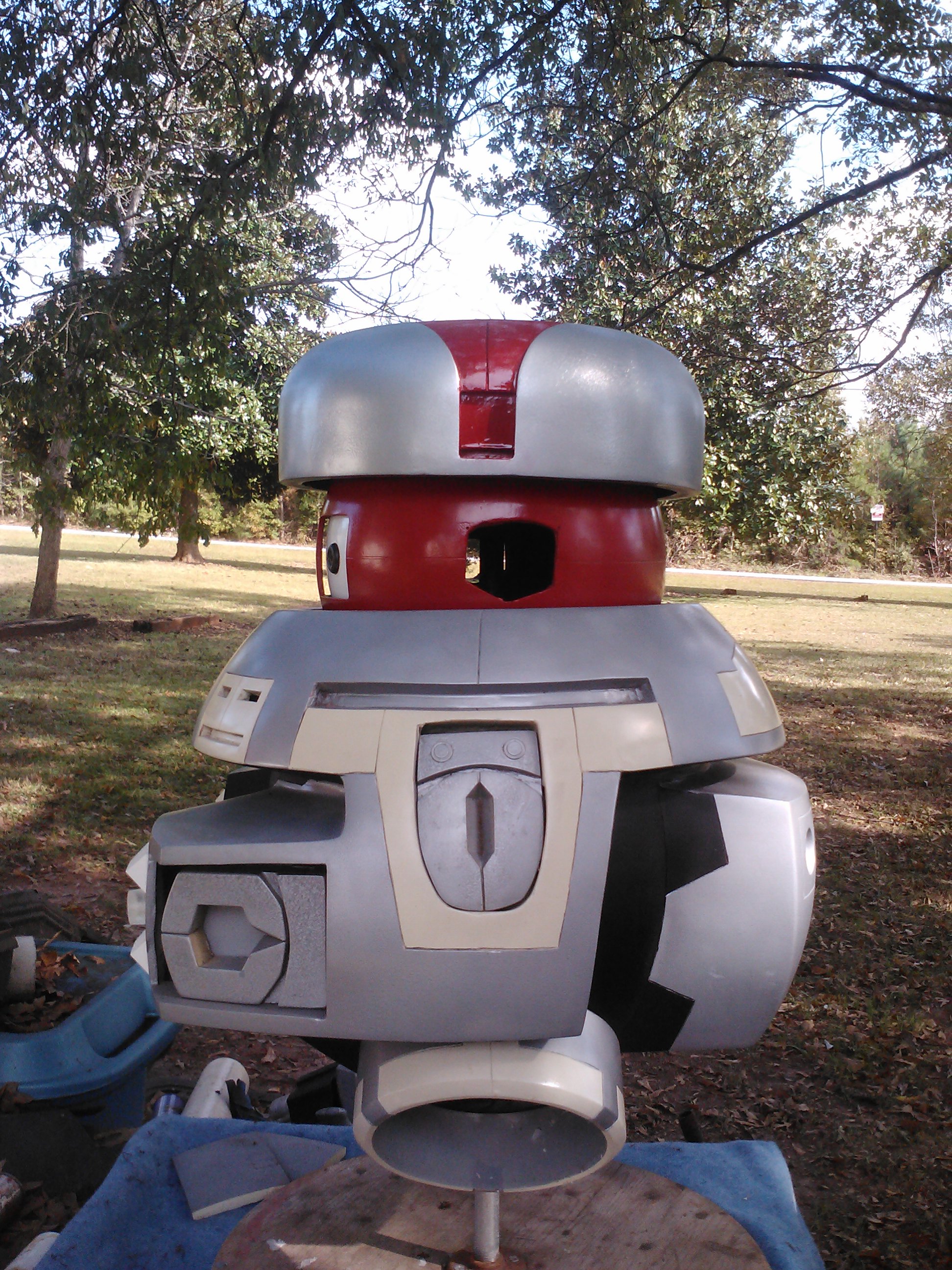

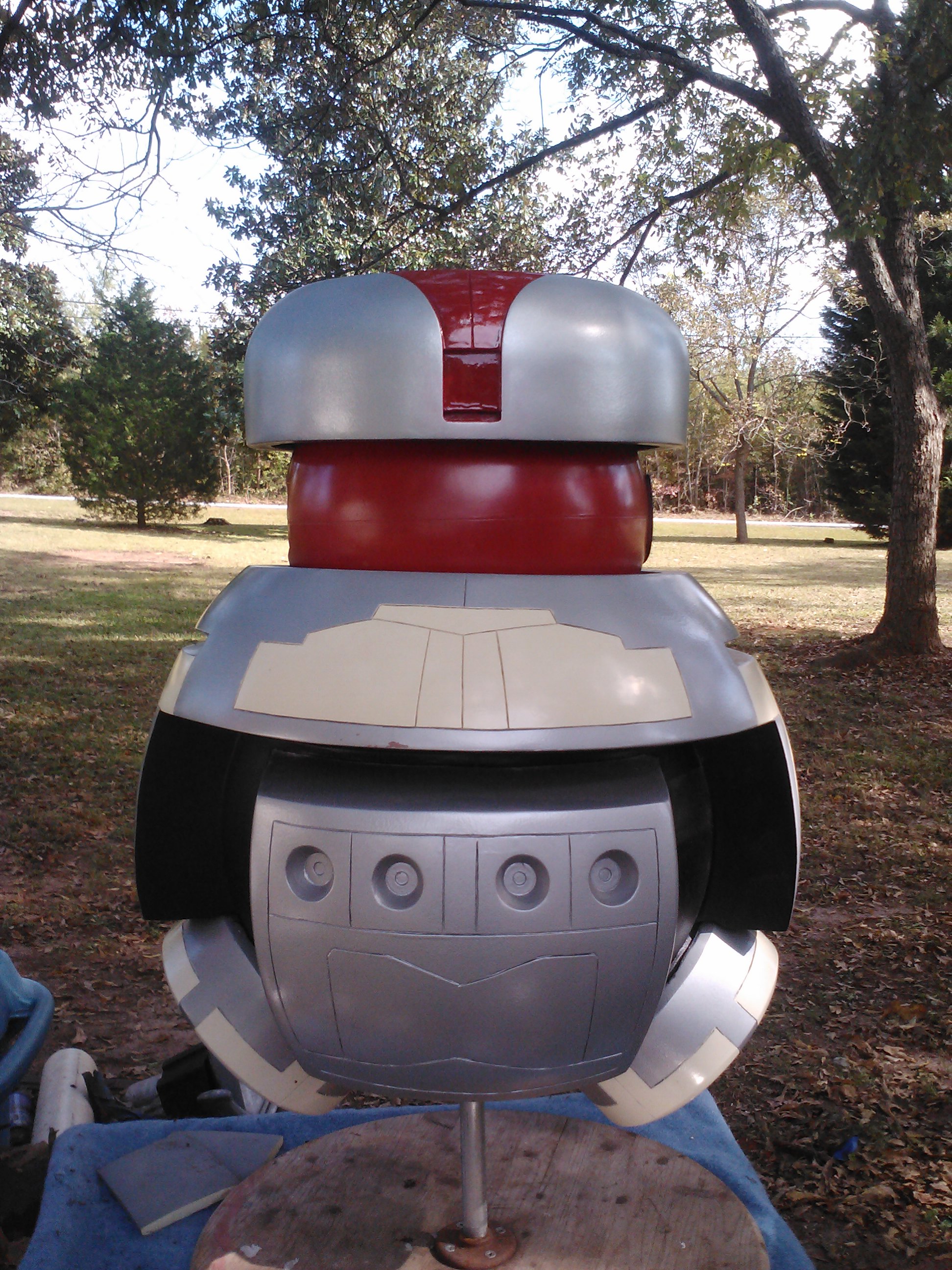

Hello, everyone. I finally have some more progress pics of the V.I.N.CENT. buildup I am working on. I must apologize for my long absence between posts. I have been busy with taking care of family. Last year my mother underwent surgery and chemotherapy for cancer. Since then she has been in and out of the hospital many times. I am her sole caretaker so I have been terribly busy looking after her. The last two years I have been a bit overwhelmed with the responsibilities of caring for her. This week she is having another surgery, this time to have her thyroid removed. I'm hoping once she gets on the thyroid hormone her overall health will start to improve.
Anyway, back to V.I.N.CENT. I have been trying to figure out the best paint scheme for V.I.N.CENT., I decided on a Hammered Silver and primer in one for the main body by Krylon. I had tried Rustoleum, but could not get the uniform hammered texture that I did with the Krylon. For the panels, I am using Rustoleum Almond. The key is prepping the surface to ensure maximum adhesion of the paint. I surface sanded all the fiberglass surfaces then used Duplicolor Self Etching Primer to get a good bond with the paint. For the black surfaces I used Rustoleum Textured Black, It gives a very flat sheen that is a nice contrast to the Silver. For the red, I used Rustoleum Regal Red.
