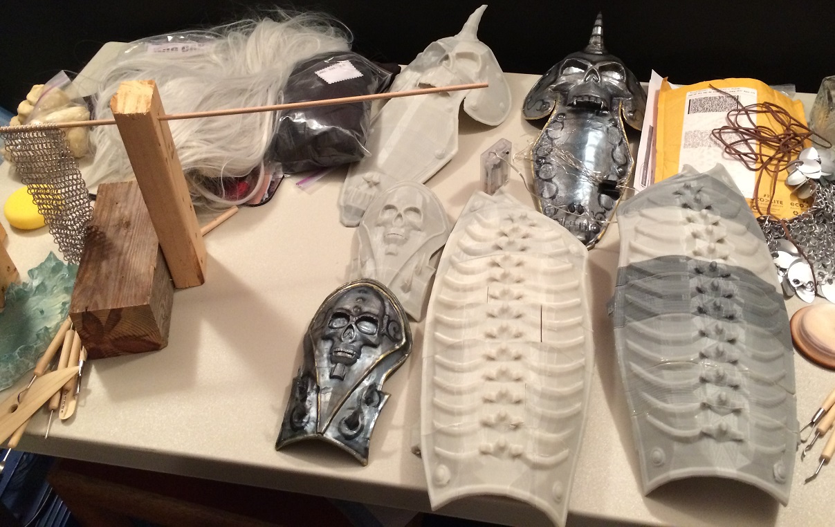

So, this is what a pile of Lich King armor looks like. Some finished, other parts are just raw printed pieces. And this isn't even all of it!
The list of all the pieces I have to make. The next one is what's currently done.

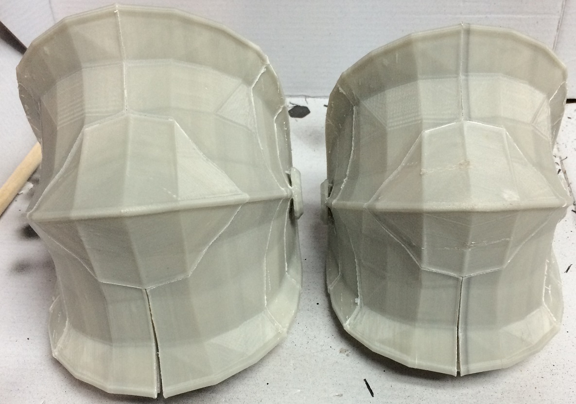

This is what 10% larger looks like. The correctly sized (and larger) elbow is on the left. Fits perfectly now!

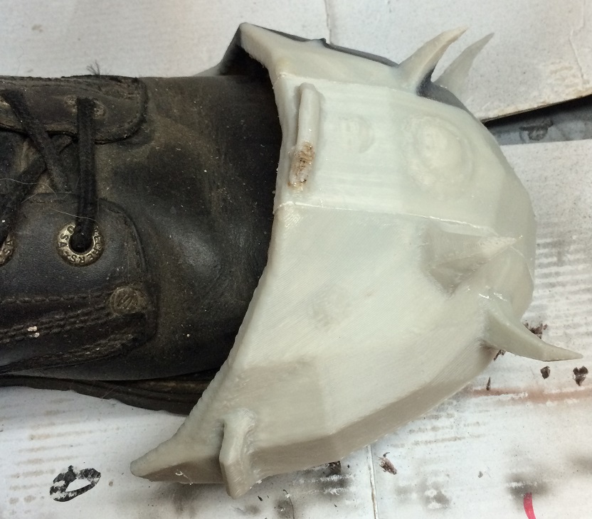

Toe parts! Here's a few shots of the toe piece that will be strapped to my boot with leather. There is a piece for the heel and the side too.

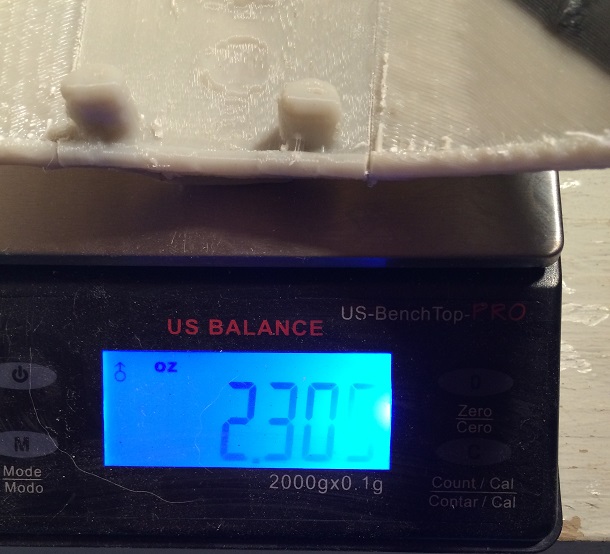

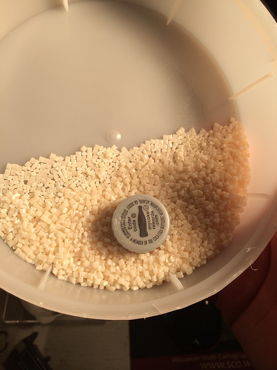

A while back I was asked about cost and how much plastic I'm using. It's not very much, but here's a visual. The toe piece weighs 2.3oz. The next pic is what 2.3oz looks like before it's made into filament. It's not very much at all. I threw a plastic bottle cap in there to give a size reference. Hope that helps. I can weigh other items and show you the comparison if anyone really wants to see.

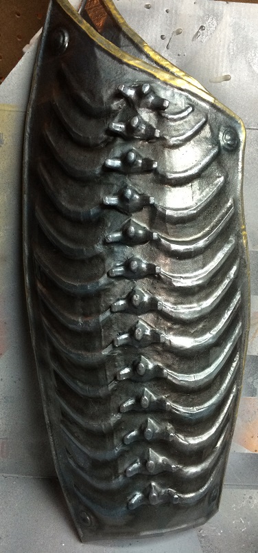

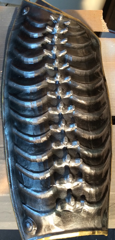

Below is the finished thigh piece (1 of 2). I'm showing different stages of the finishing process, along with some narrative of what occurs at each step. I've also started using a bit of a different technique for finishing the pieces. Here's what I'm doing...
Instead of Bondo, I've decided to use wood filler instead. Bondo is a pain to work with. Not much working time, horrible fumes and it's a pain to sand. I don't need it for strength, I just need it to fill gaps and smooth certain small areas out. So, I decided to try wood filler, and it works great! It has a great working time, is easily applied, no fumes, and can be sanded smooth.
After applying the filler to small gaps and whatnot, I sand it down. Then I apply a coat of resin over the "finished" side of the piece. I then spray it with a filler primer, which helps fill any small problem areas, and shows any other areas that needs more touch-up. Once the "finished" side is complete, I then fiberglass and resin coat the back side of the piece for strength. It's a great process and is helping speed up the finishing process.
Enjoy the pics!

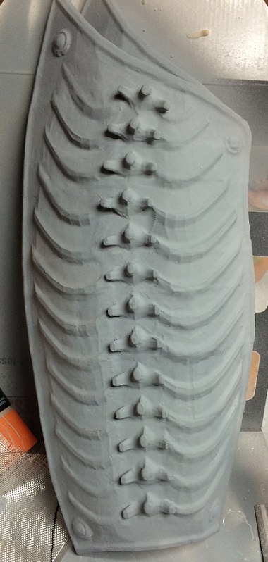

Here's the piece after filling and priming. Just about ready for paint at this step.

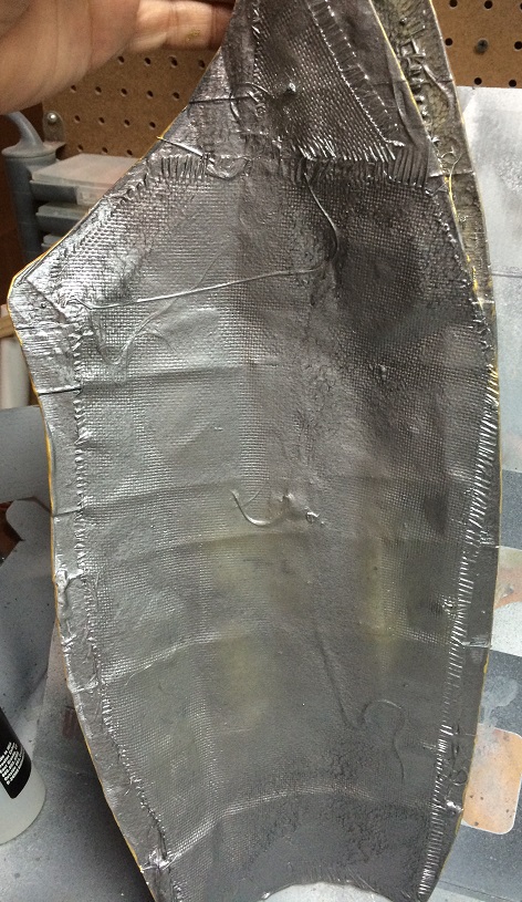

Here's the backside of the piece after fiberglass and resin. Super strong after this. I sprayed it because you might be able to see small parts of the back as I walk.

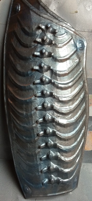

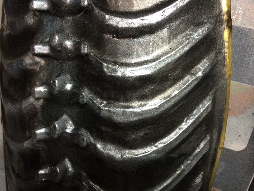

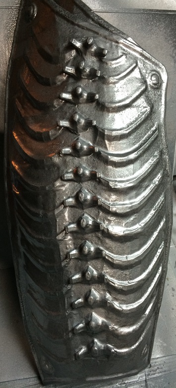

First coat of paint is a "hammered metal" finish. It comes out of a can, has HORRIBLE fumes, but it looks amazing. Makes a great basecoat!
I then airbrush a semi-transparent blue over the piece. This helps show the "cold" of the metal. Remember, this is the Lich King we're dealing with. I may actually add icicles at a later date (there are great products out there to do this)...we'll see how much effort I want to put in!

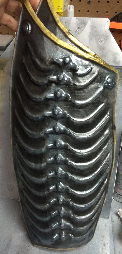

Gold trim around the edge and I start airbrushing black in the valley's and highlight the peaks with a semi-transparent silver.
Finished piece.
Just a different angle. The paint job shifts colors in the light. Really helps sell the "frozen" part of it. The paint is perfect for this project!

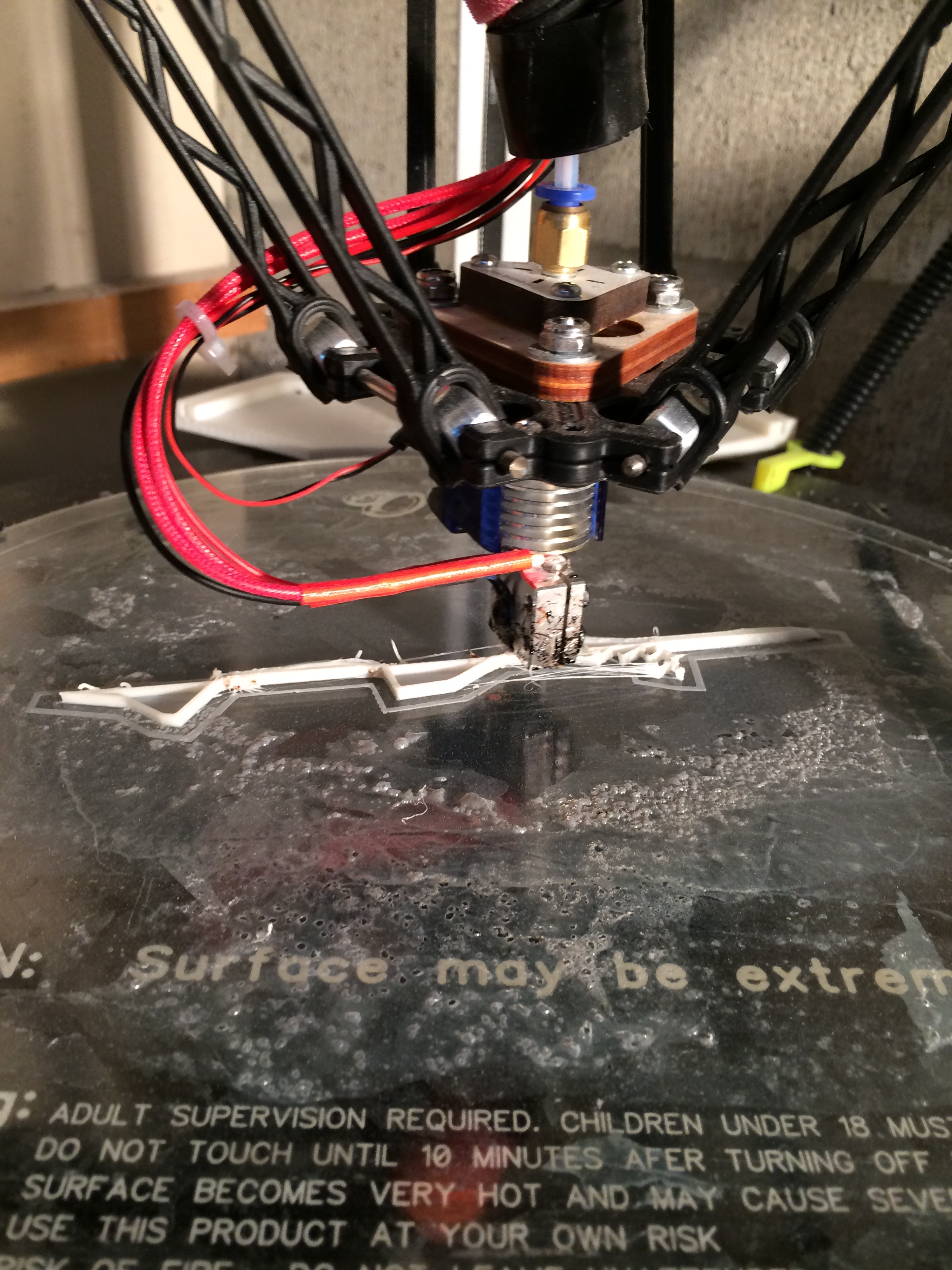

I'm currently re-printing the belt. I didn't like how the previous attempt was turning out. Also, my printer has a new print head and is VERY dialed in now. Using some new printing software that has an auto-leveling feature.

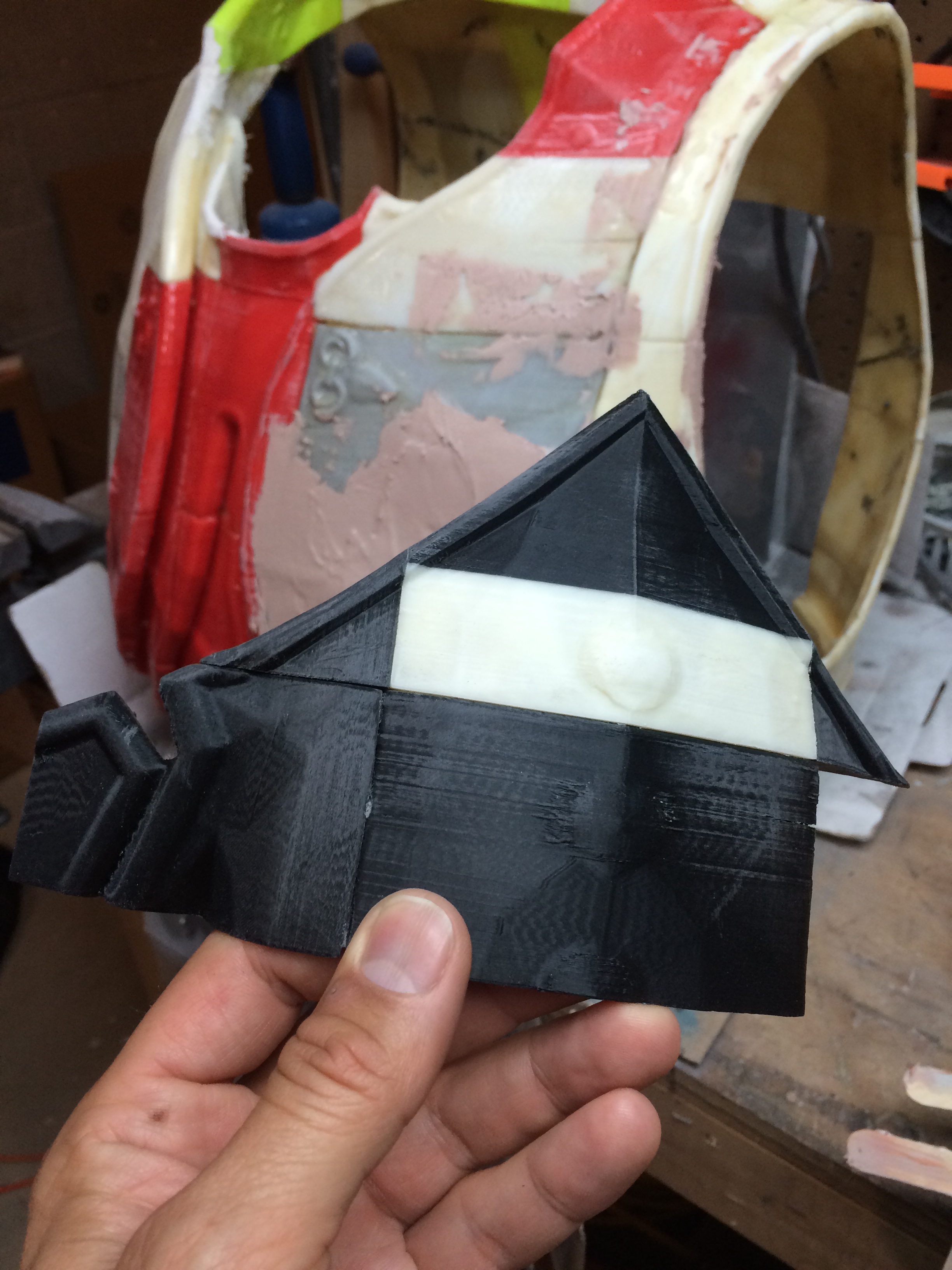

Here's a quick shot of what's printed on the belt:

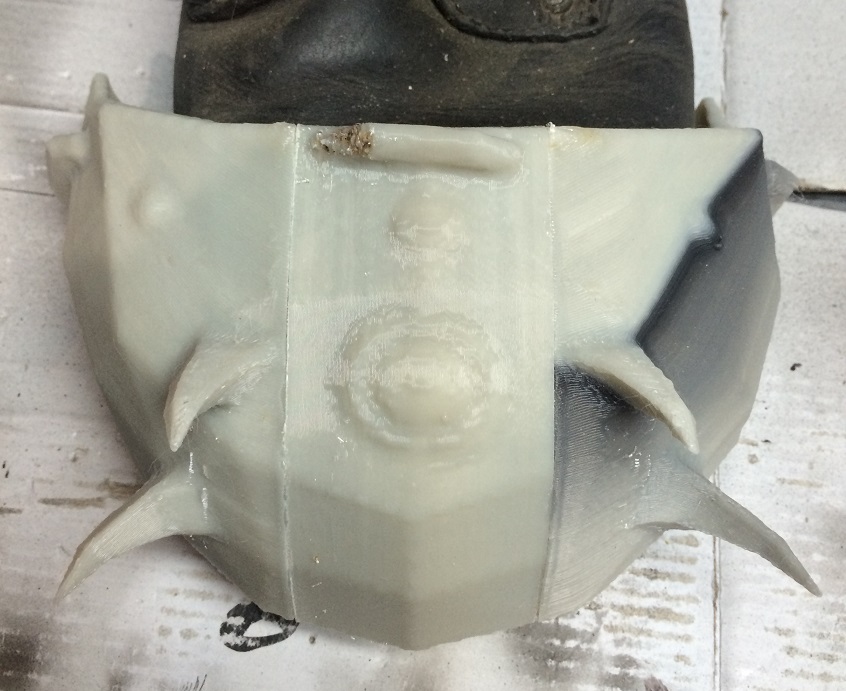

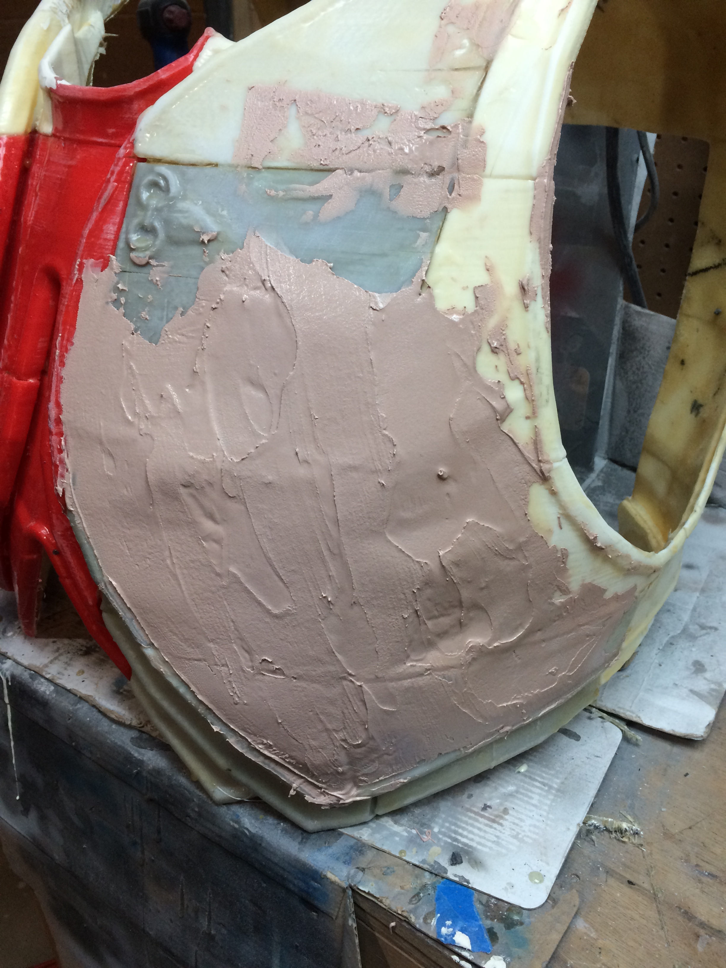

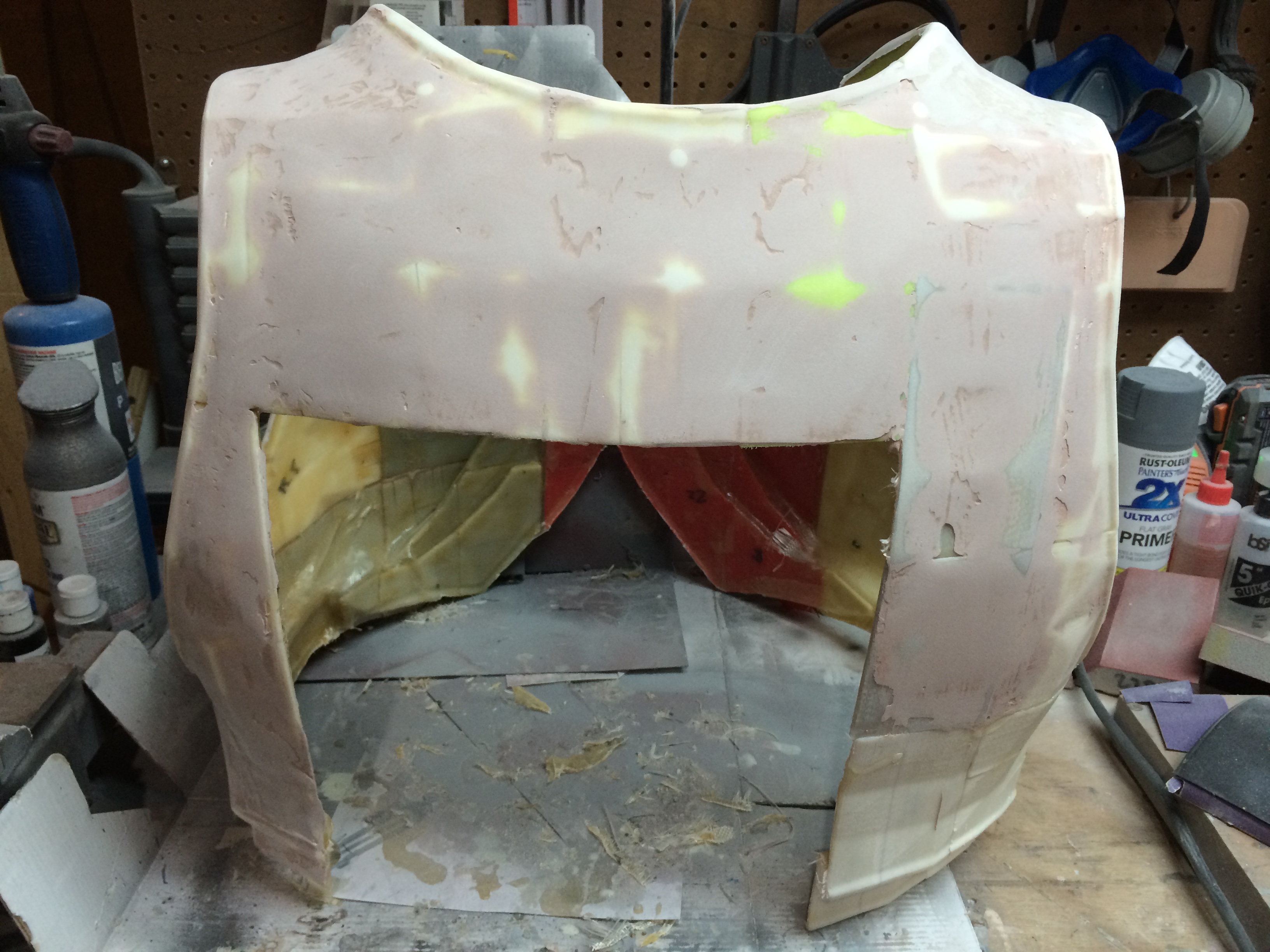

And I've started to bondo the chest piece. The nice thing about building armor is that it doesn't have to be "perfect". What I mean is that it doesn't have to be completely smooth and symmetrical. Imperfections (along with a good paint job) is what makes it look real. And before anyone asks, yes, I will be adding bondo to the entire chest piece, sanding it and sealing it before painting.
Did another layer of bondo the other day, and then sanded it up today. Starting to really come together! The nice thing about bondo is that the low points that need to be filled are always darker than the rest of the bondo (since they didn't get sanded). One more layer after this and I'll be able to do a final sanding and touch up. I'm going to add the rivets back on (covered them up with bondo) and the two brass "closures" that you saw in early pics.
Almost done with the bondo layer. Looking to completely remove the joint lines, but leaving "dents" and other minor imperfections for realism. I'll make them stand out even more when I airbrush the piece.

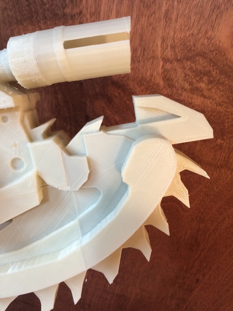

I have "Jarvis" printing the belt in large sections.
