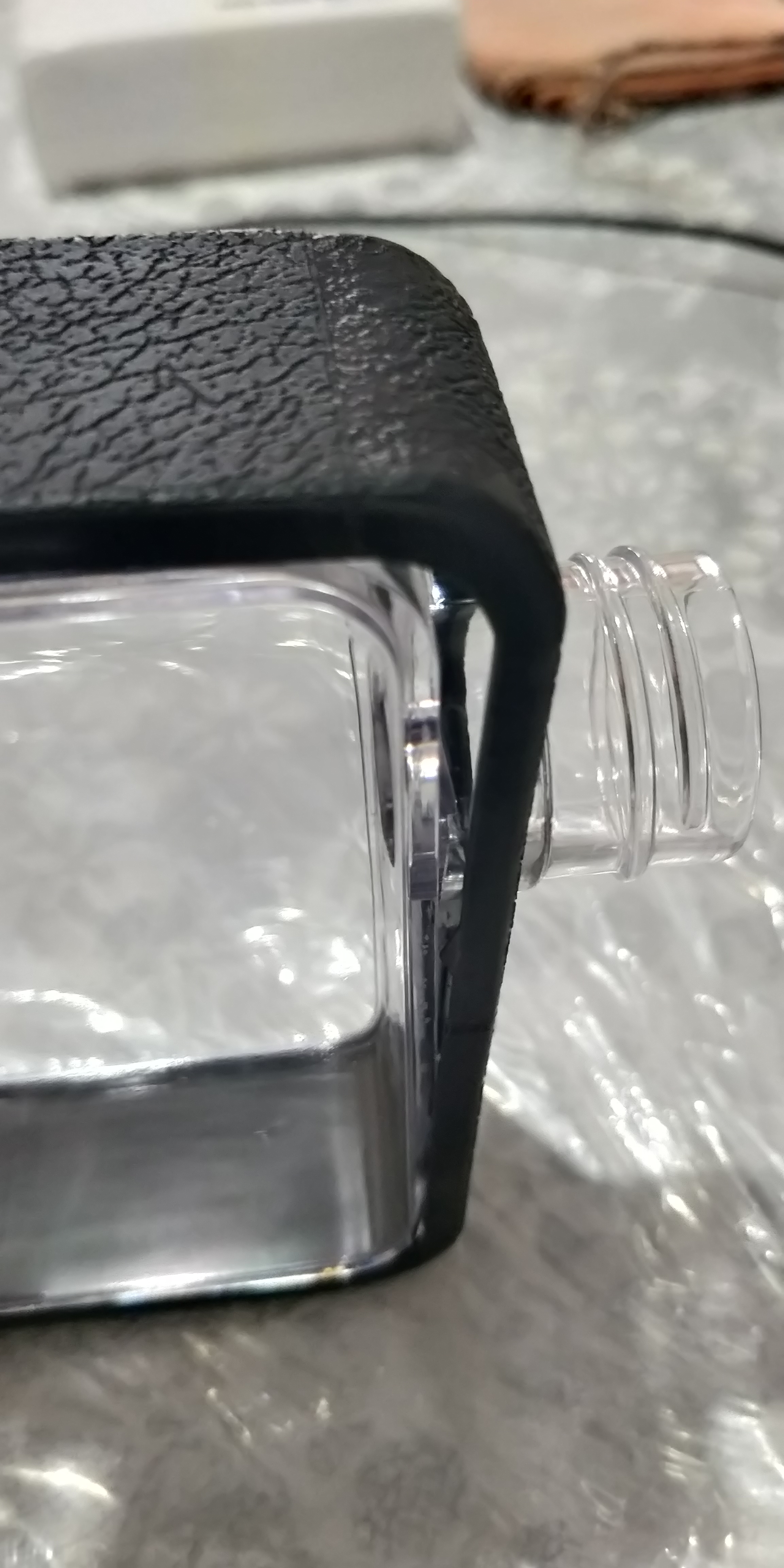

They finally arrived. Now I can go on the hose connector device. Have to adjust a little bit the template. 1mm bigger from each side.

Estimated the PVC hose diameter in 7mm. Used several images. This is the clearest image to check. Bottle neck is 28mm. There are several PVC hoses 7mm OD x 5mm ID. Will be great If someone else can check on my estimation.

And I guess, just guessing cause I don't have one of them on my hand, that this
  • 1/8-inch barb by 1/8-inch barb coupling
Will do the job just fine. IF they can fit and hold a 5mm ID hose. just drill a 5mm hole at the top of the cap and you are done. What do you think? Any feedback will be welcome. I can almost see the shape at this image. Cap height is about 25mm and they are only 19mm tall. It will remain hidden inside.
PS: I modeled and printed one of them. They are way smaller and even If they will do the job, the one used on the prop looks like that have a taller neck.
