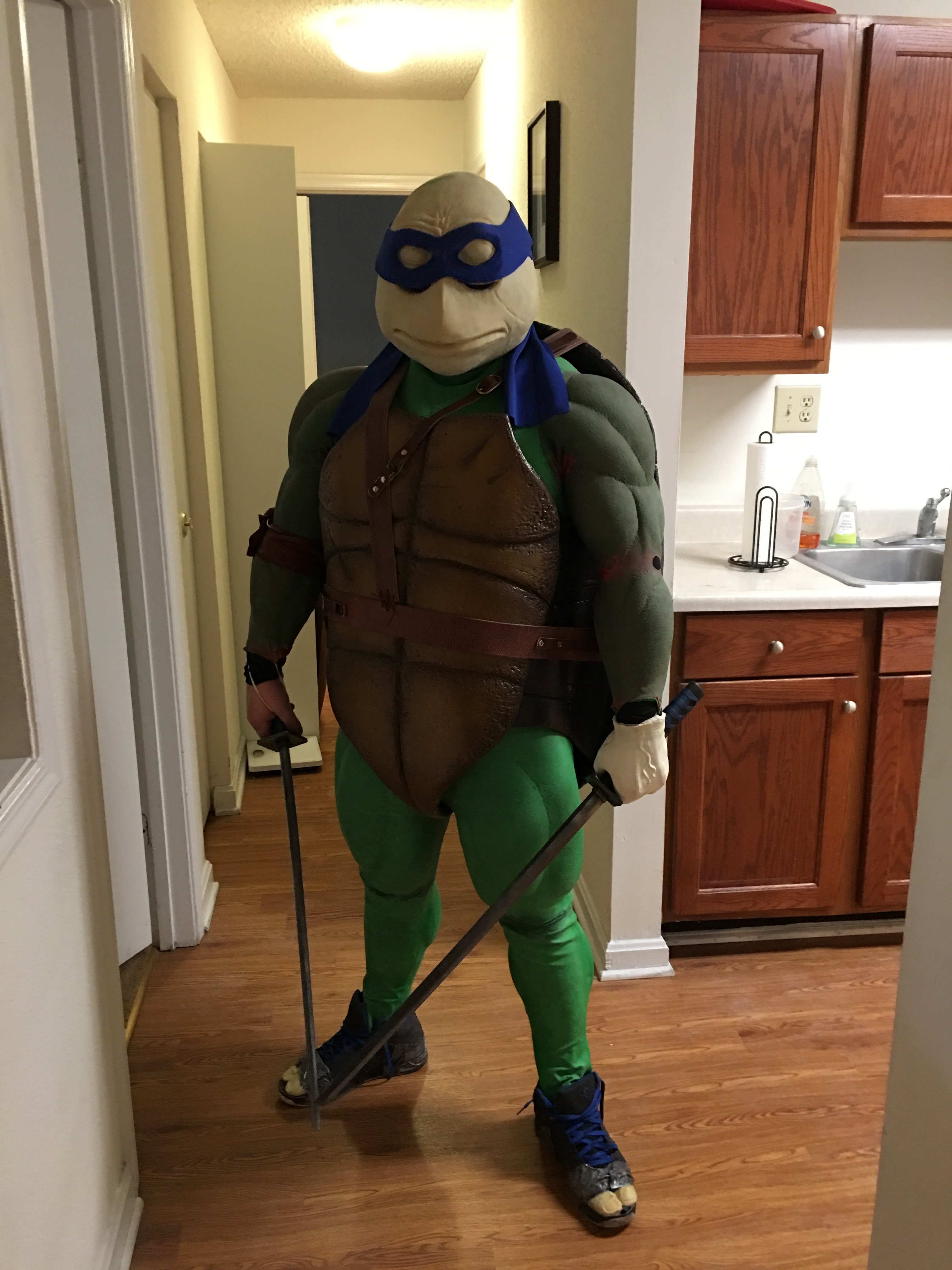

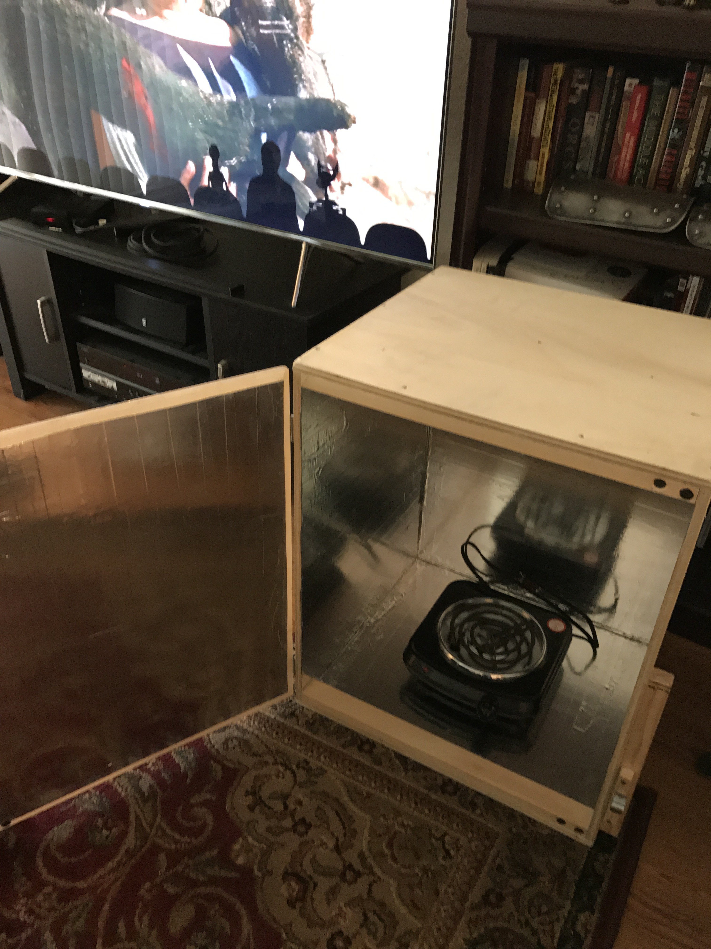

Built an oven for casting the gloves in foam latex over the weekend. It isn't much, but it should do the job (but if someone with experience has any tips to improve it, please let me know!). I still need to add the casters so it's off the ground (will use it outside) and a rack so the mold doesn't sit directly on the heater.

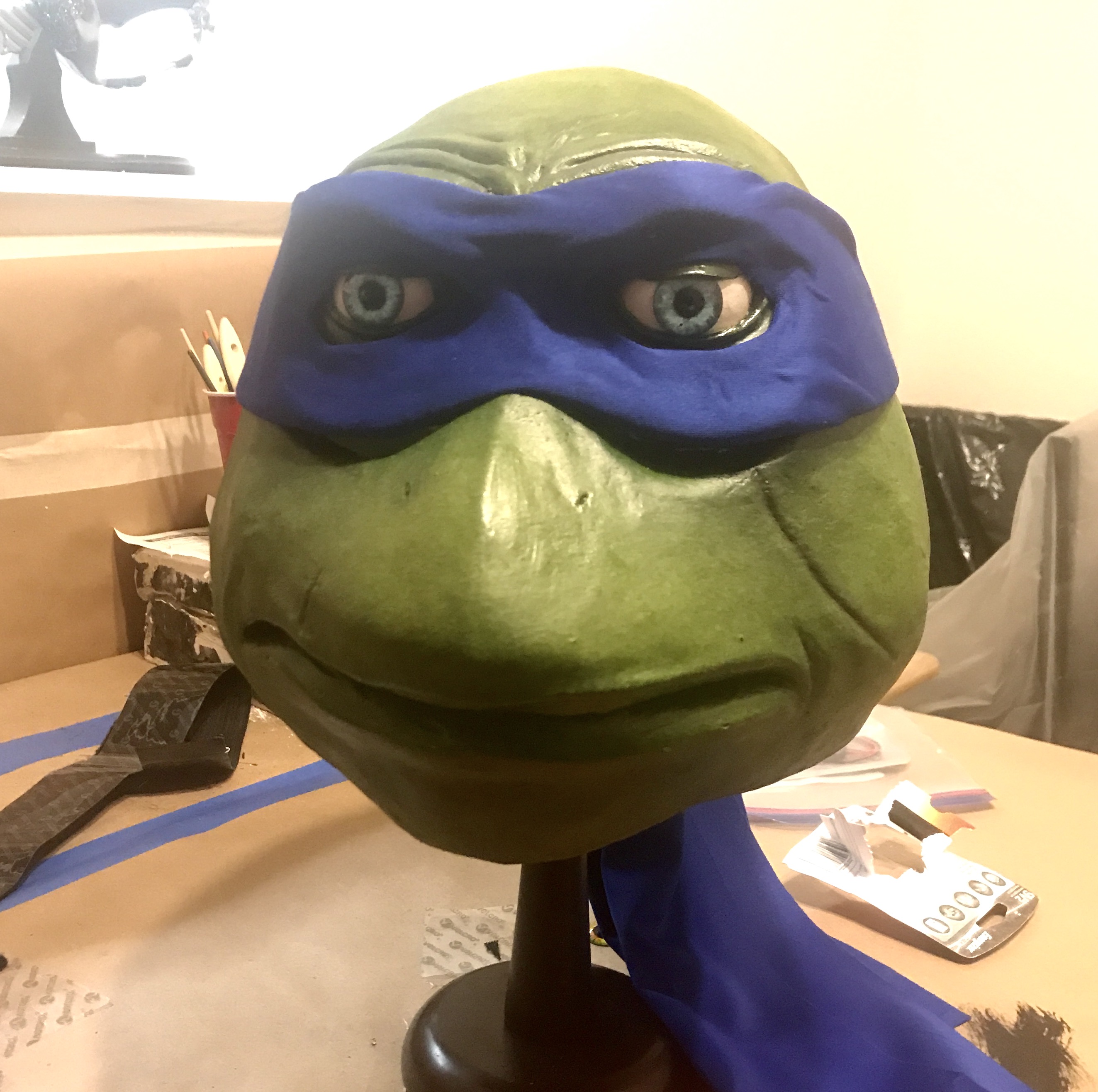

I also just finished sculpting the mask (for the third time). I like this one a lot, so crossing my fingers that making the mold goes well.

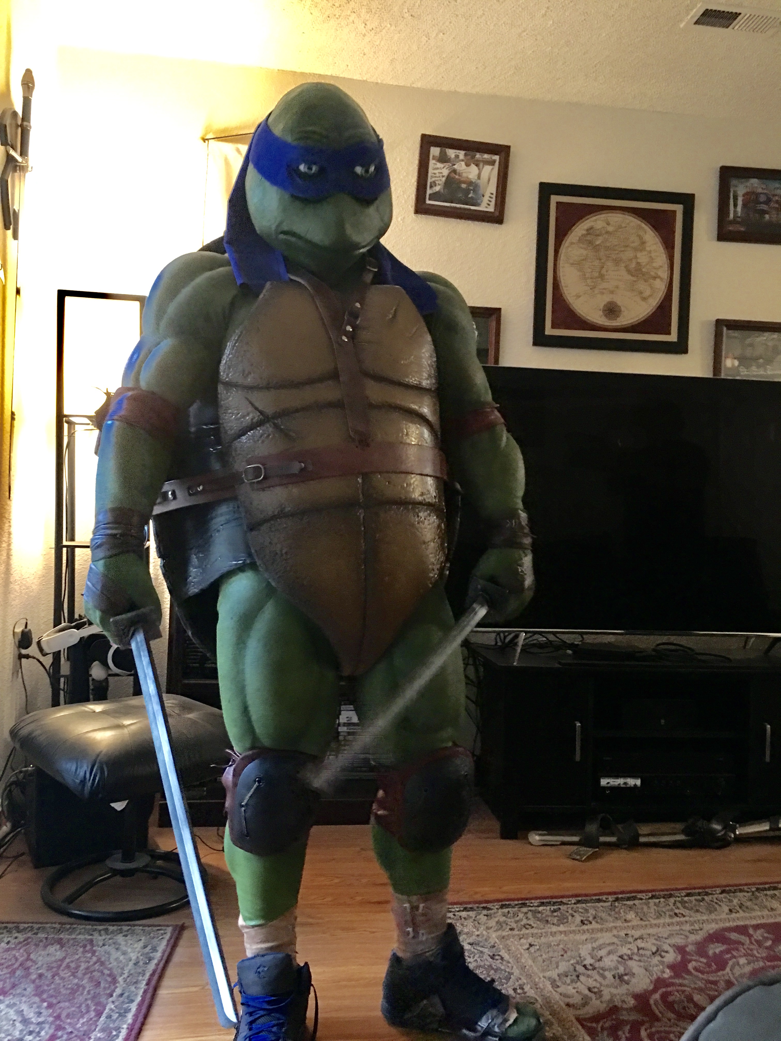

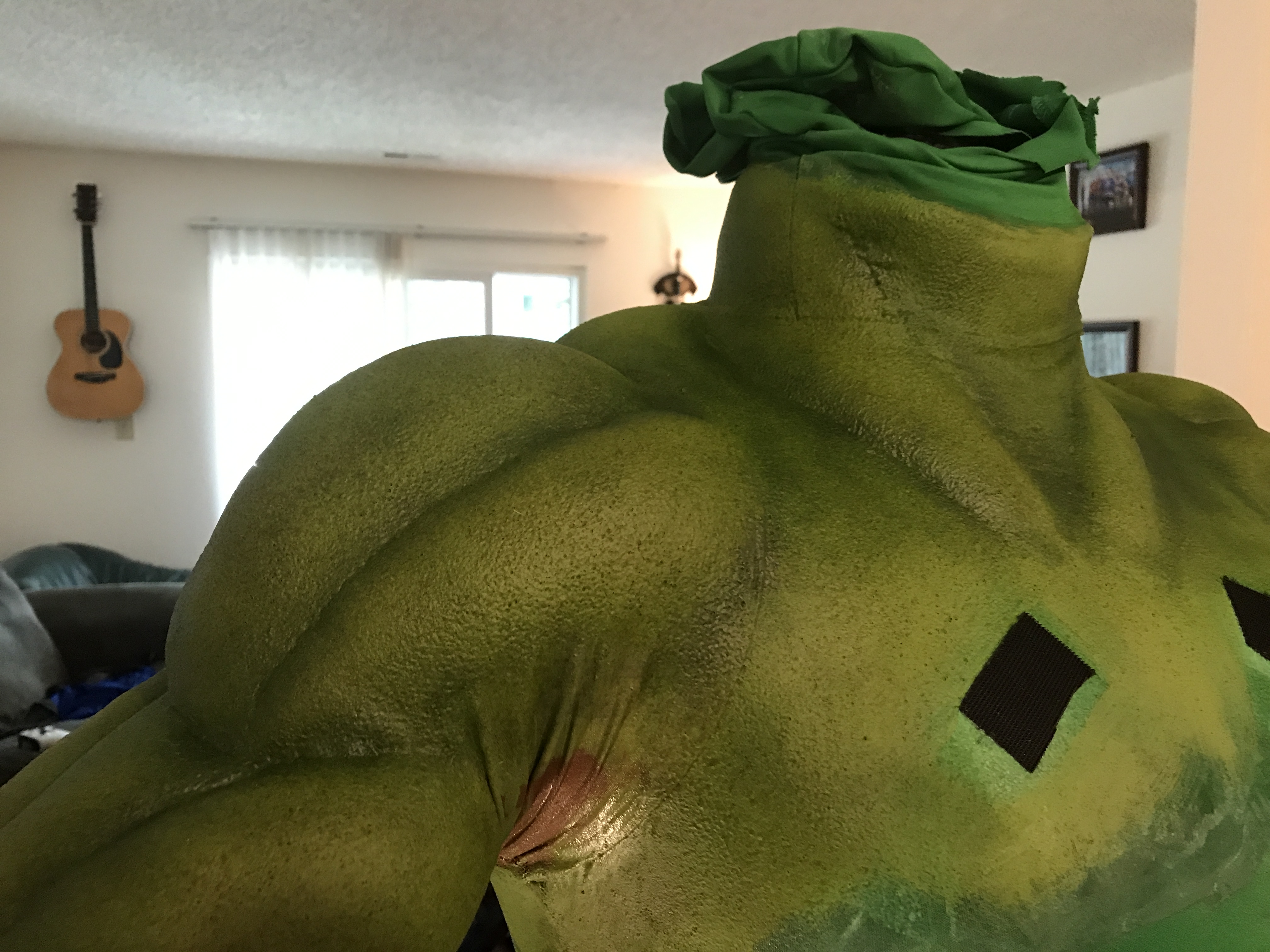

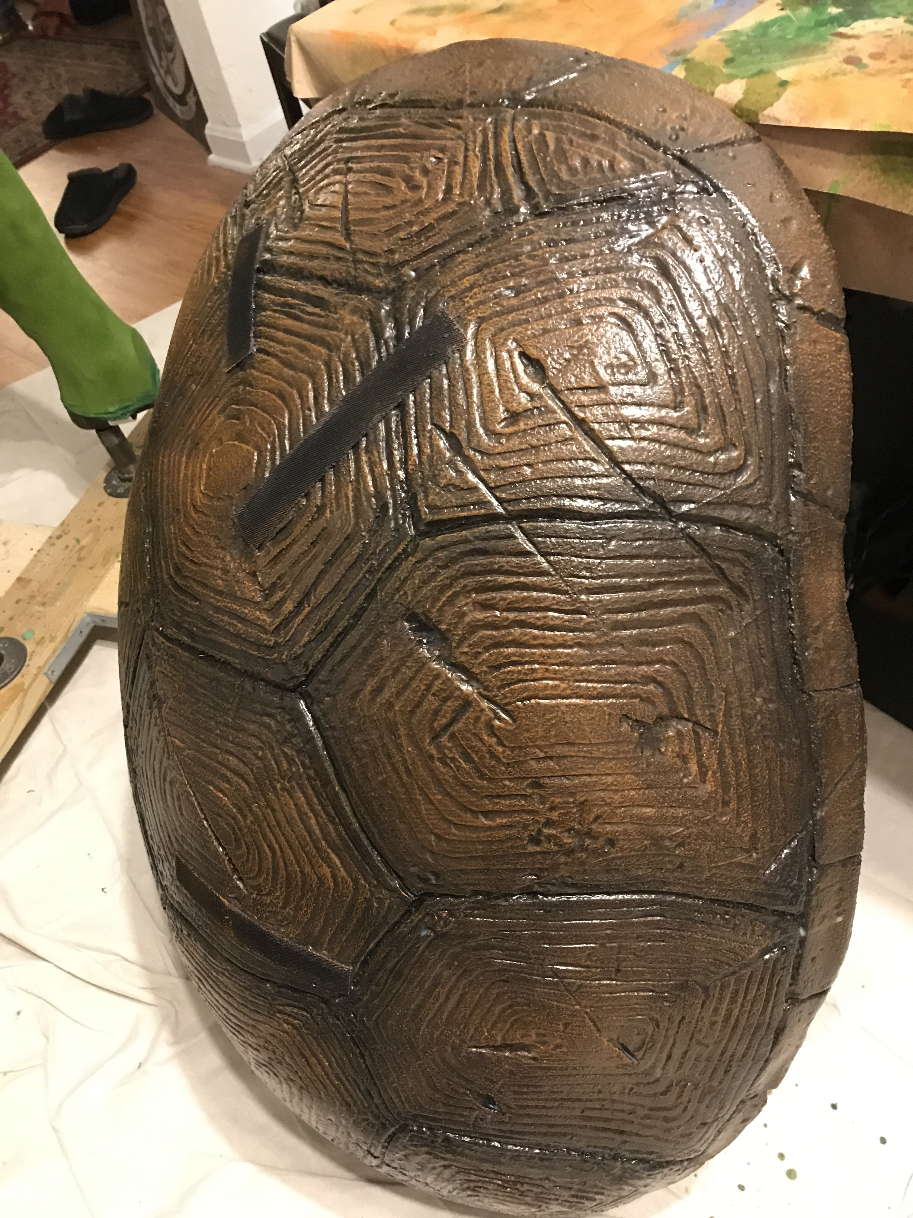

Im working on the paint job this weekend. There was a tough start, but I've got it to a place a like. I'm having issues with the armpits (I did not apply latex there for breathability and am now kicking myself for the spandex color).
Fuzz,you absolutely nailed it with this build:thumbsup especially the mask.
Looking forward to seeing the feet included as well.
Have fun at the Comic Con and I hope you get lots of positive reactions!

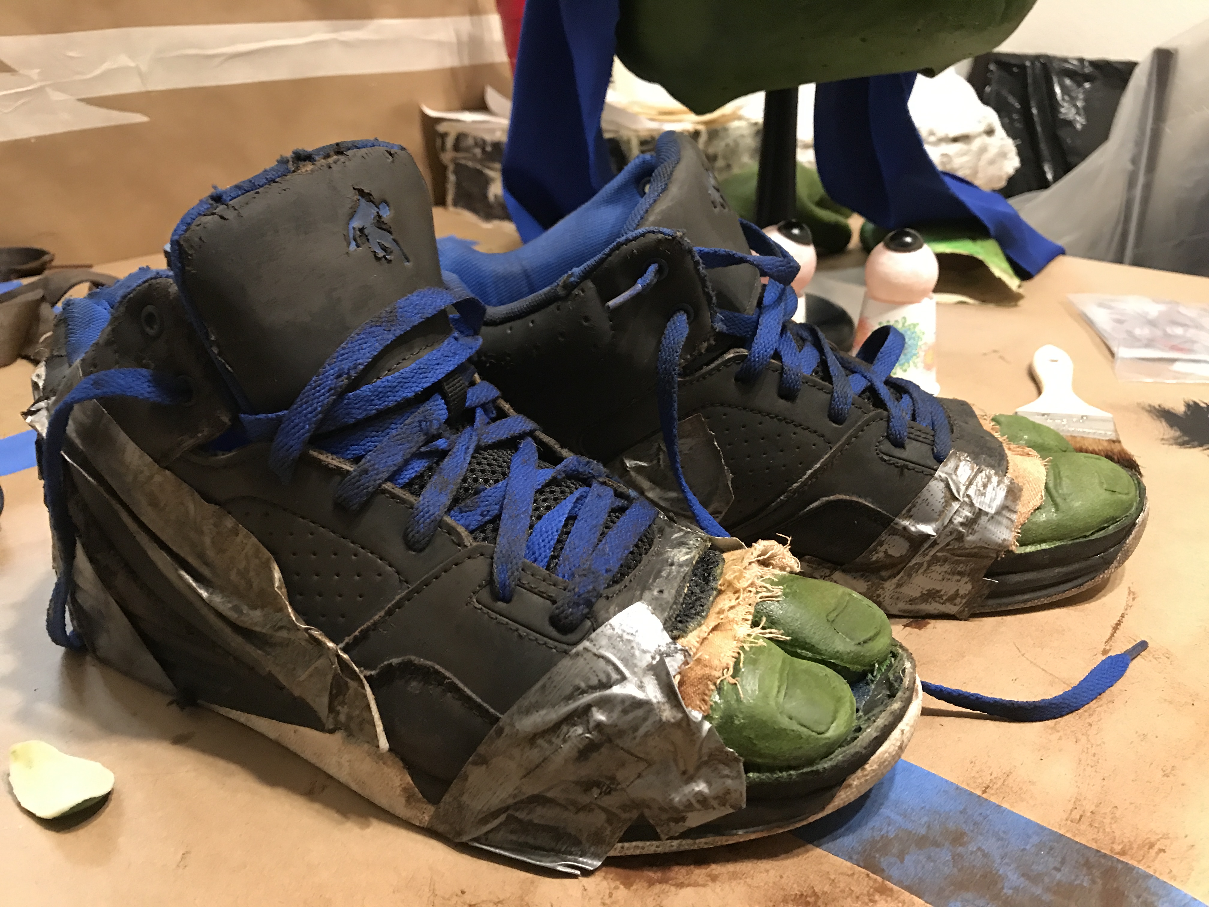

Awesome-Con was fantastic. I fought heat exhaustion all day, but it was worth it. I also entered into the big costume contest and took home two prizes for Best Portrayal and Best Craftsmanship. Here's a few photos (as well as a shot of how I handled the feet).
