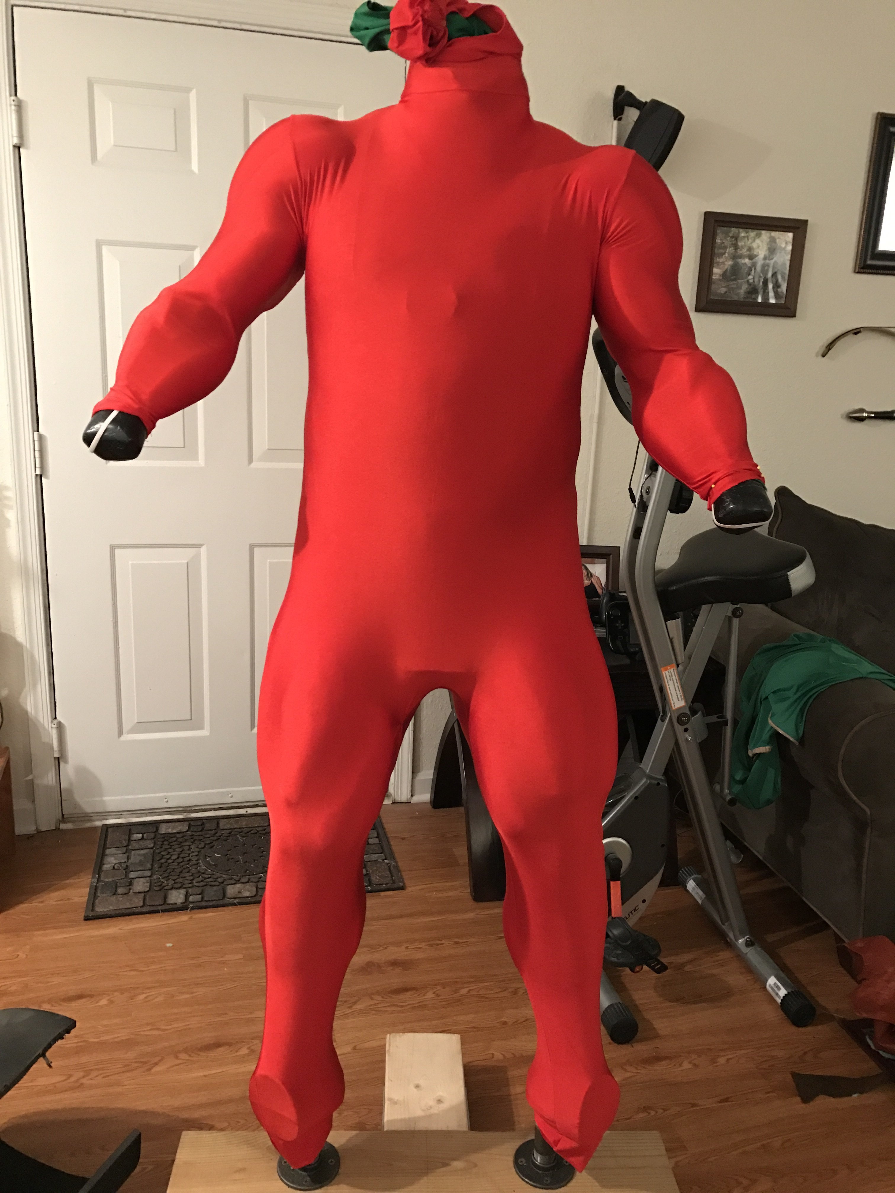

And I thought I was finally done with spandex...after putting on the skin layer spandex body suit, I think I'll need to hobble together a custom fit one. I had to get a larger one so the arms would fit over the muscles, but that leaves a tone of room in the chest (I want the arm seams past the shoulders so they'll be covered by the leather straps), so I think I'll need to sew together two different sized spandex suits. Bah!
I also made a harness for the back shell. It's underneath the suit in the above pic, so you can't see it aside from a little bulge on the chest which will be covered up, so I'm happy about that.

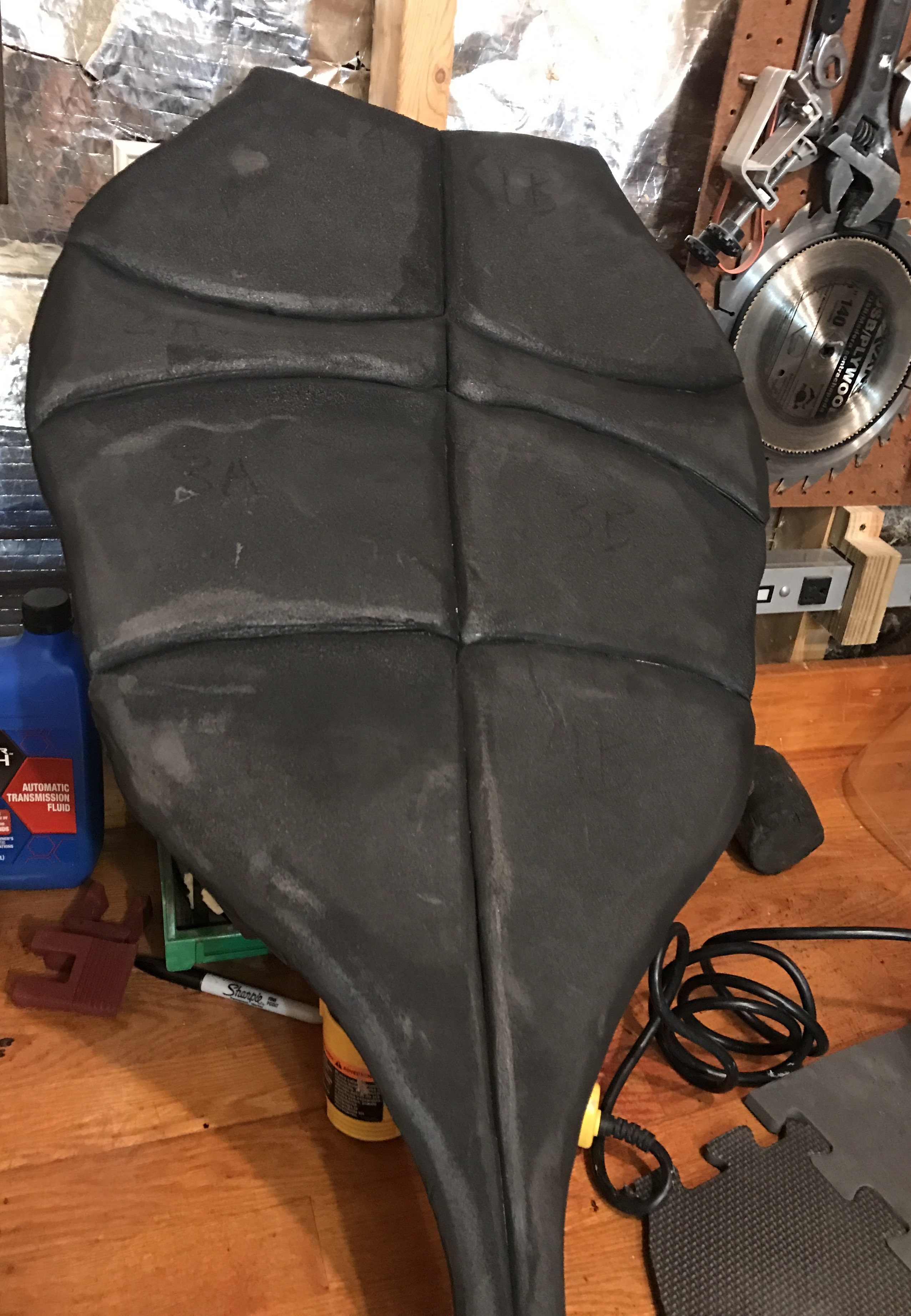

I also got most of the front shell created. Each piece is an individually crafted section of EVA foam, attached to another layer of foam backing to hold it all together using barge cement. I've sanding everything down into the basic shape that I want, but I still want to go in and carve some small detailing in. I still need to decide which method I want to use to cover it up (I think I saw a Punished Props video comparing different methods). But I'll hold off on that for now. Time to start on the back shell!

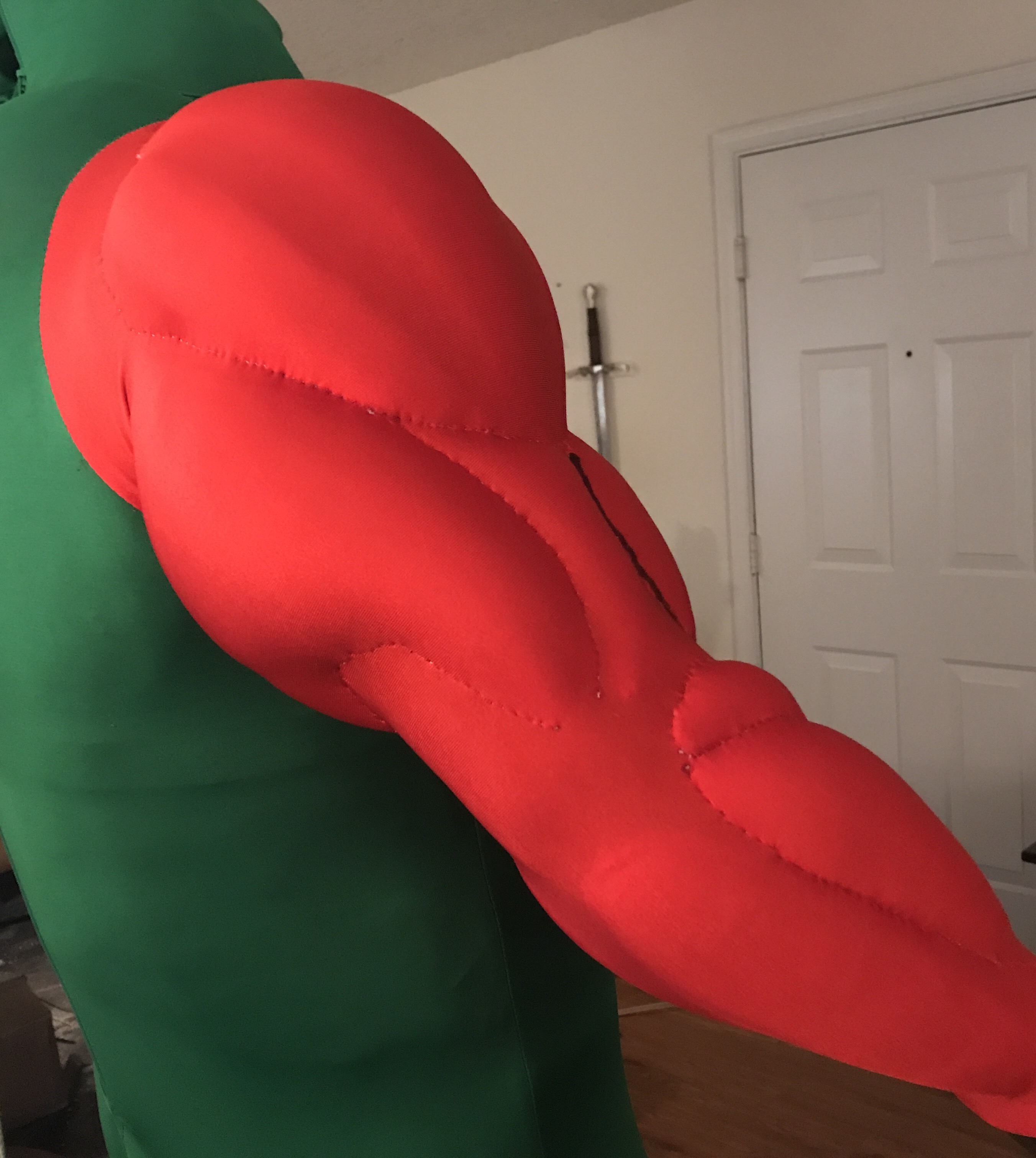

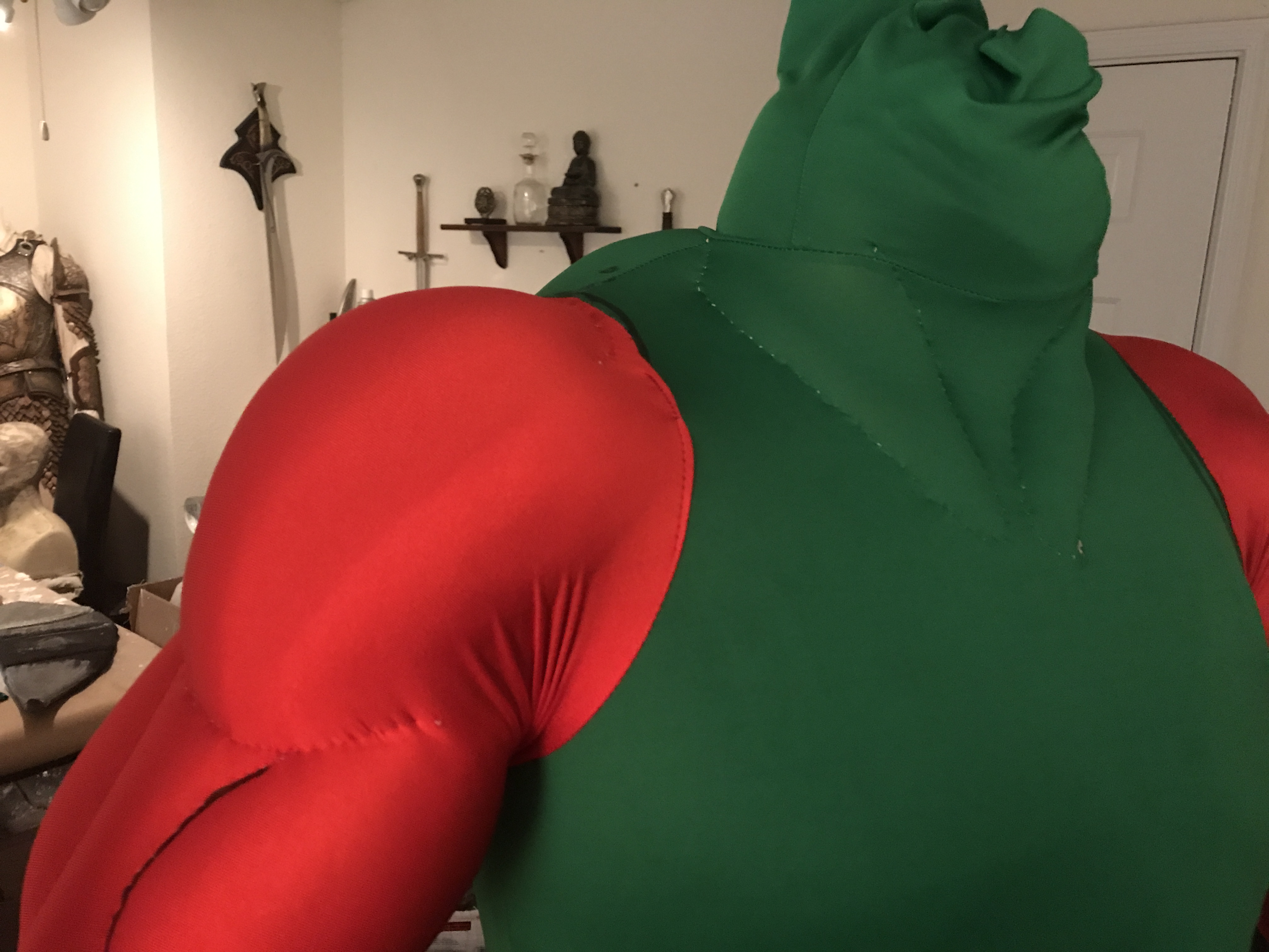

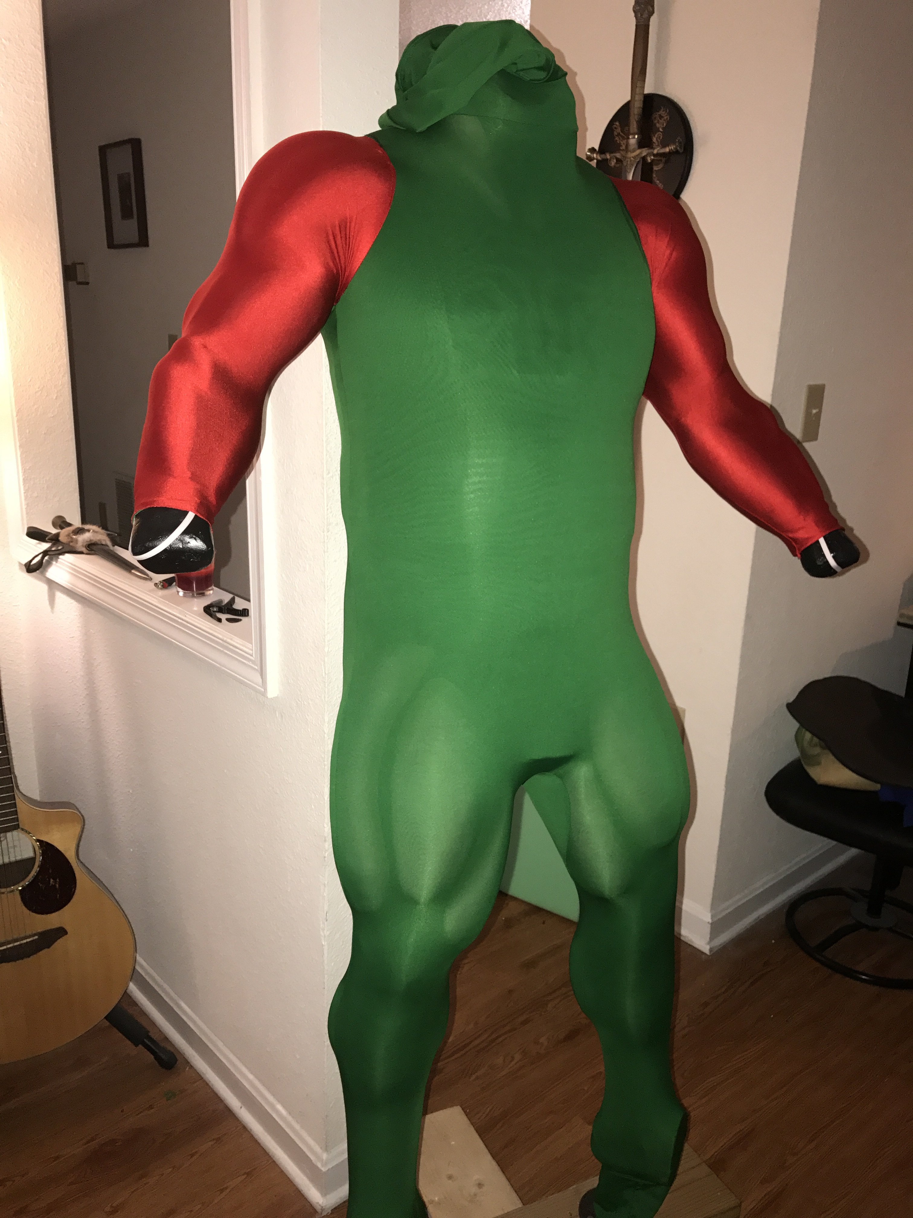

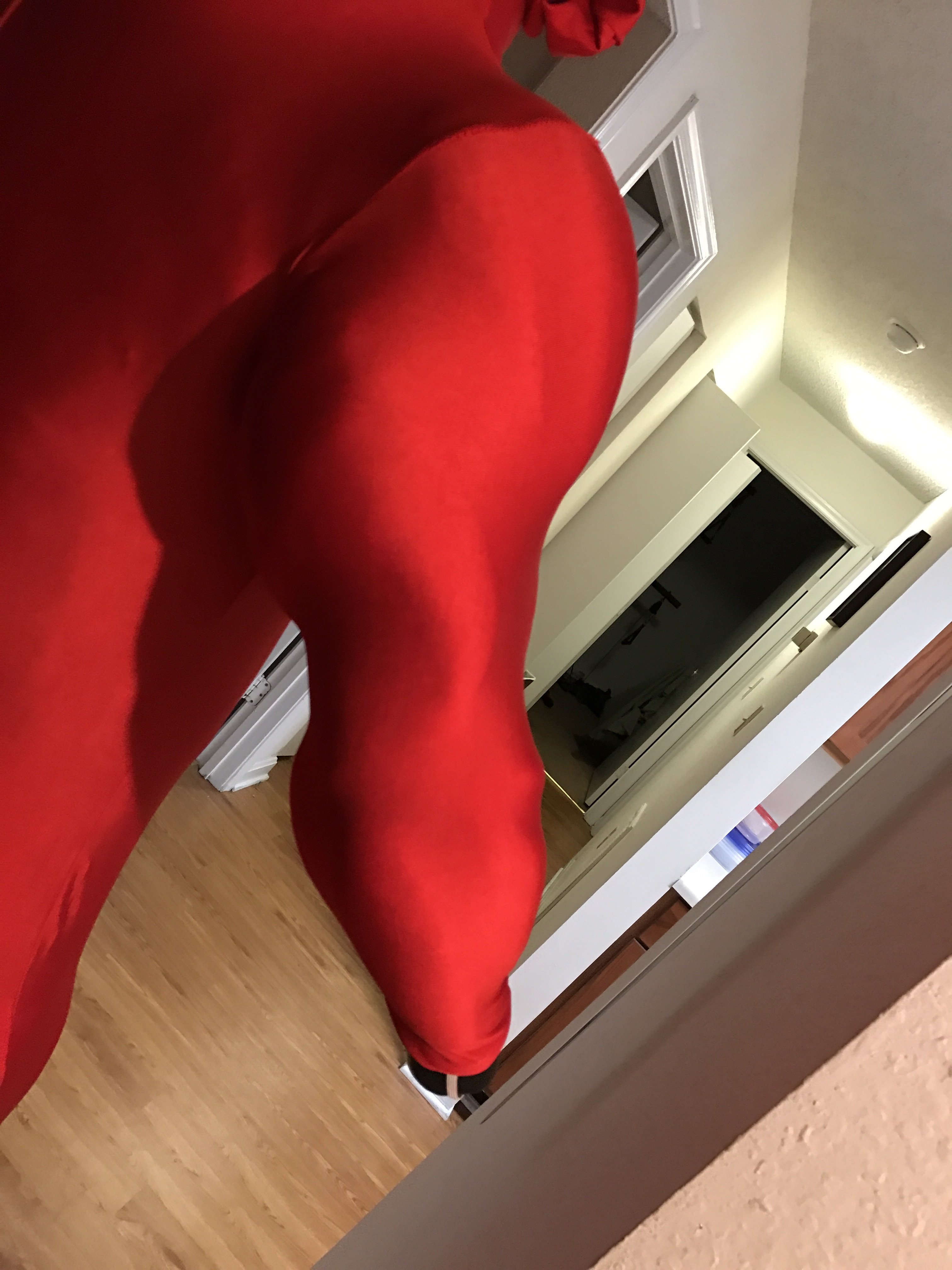

While waiting for more clay to ship, I went back to work on the muscle suit. All the muscles are carved, covered in spandex and attached to the under suit. The skin layer body suit's chest was too large, so I removed the arms and attached them to a smaller suit. I'm not concerned with the color difference. I'm now going through and stitching in details to give the muscles some needed definition. I'm making the assumption that the hard lines can be softened up by the latex layers. I see I'll have a (small?) issue with adding the latex and painting the area around the armpits and the arms on my mannequin don't move. I'll deal with that when I have to, though.

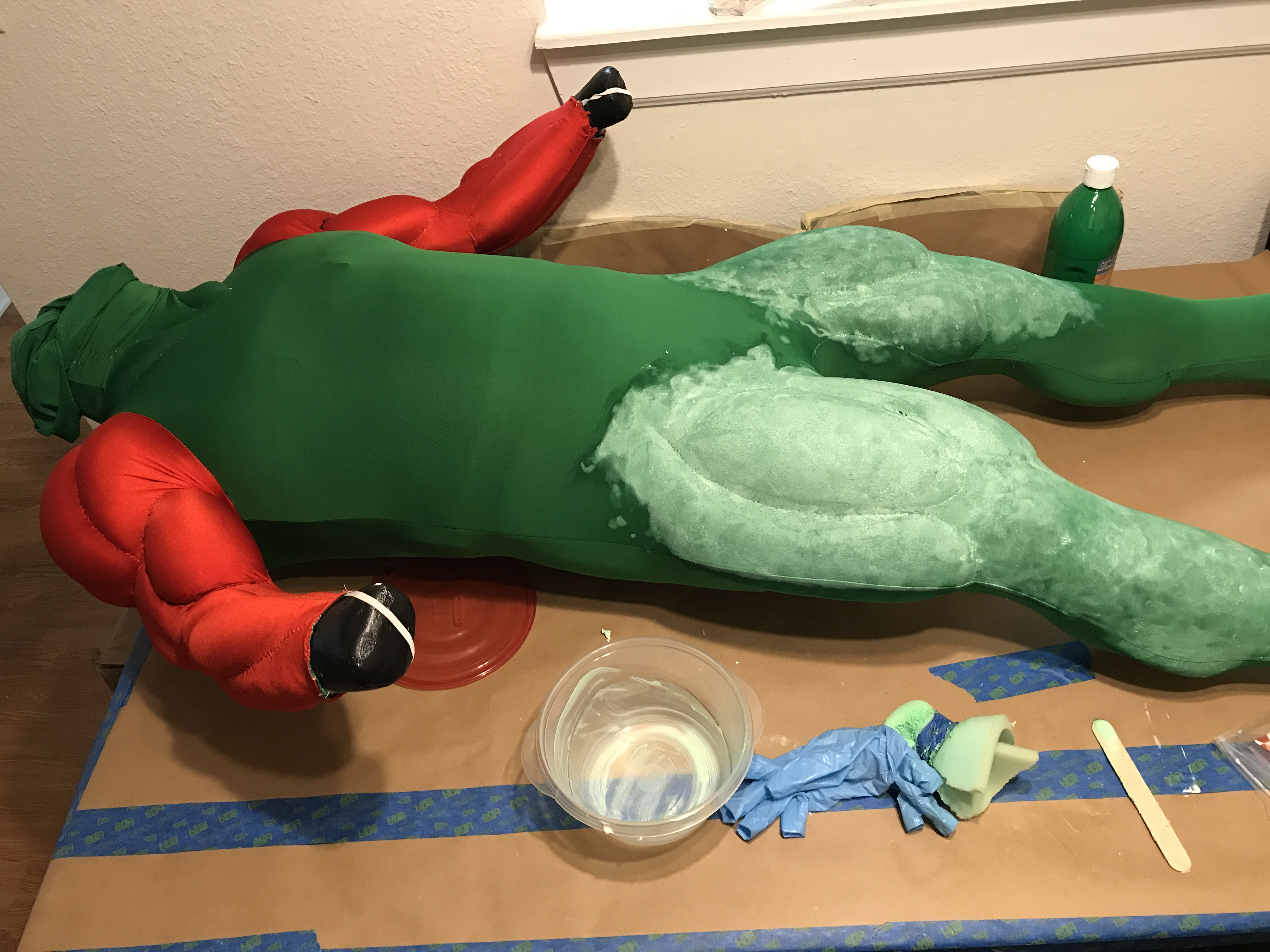

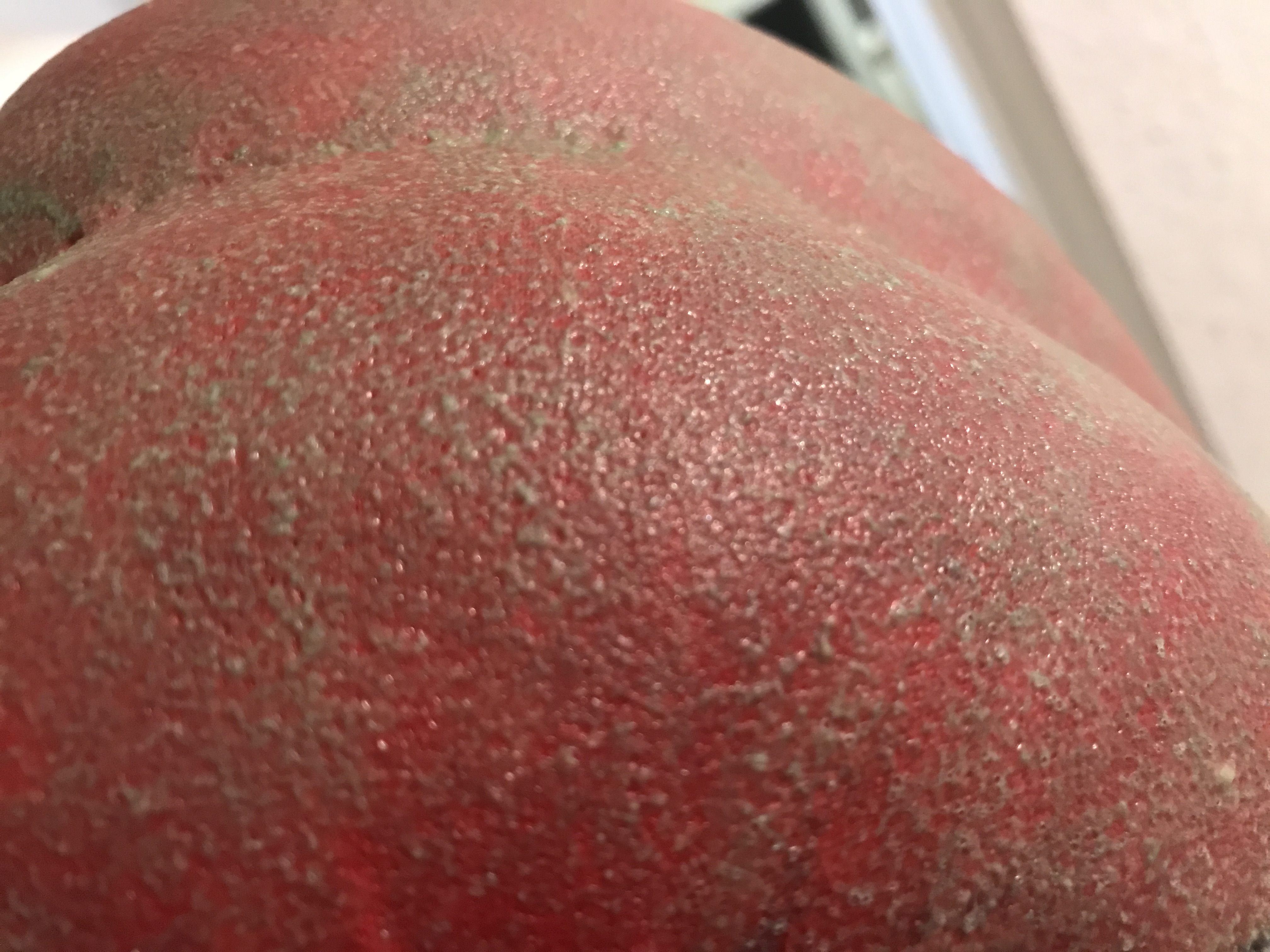

Just a tiny update showing how the latex application is going. I'm tinting it with some green paint to try and reduce the red fabric prior to painting (and to reduce streaks of white if the latex stretches too much). It's a slow process, but easy. Once the bulk of the body is done and the latex has dried enough to not stick to itself, I'll remove it from the mannequin to get some of the harder to reach spots (inside of arms). Images below are just two layers of latex so far. I'll need to build up the latex more in the creases of the muscles to reduce the look of seams, but it isn't too bad so far. I imagine the final paint job will help as well.
I'm just using left over upholstery foam to apply the latex; wiping it on and going back over and dabbing it up to get that texture. It isn't scales, but it's a nice subtle affect I'm happy with.

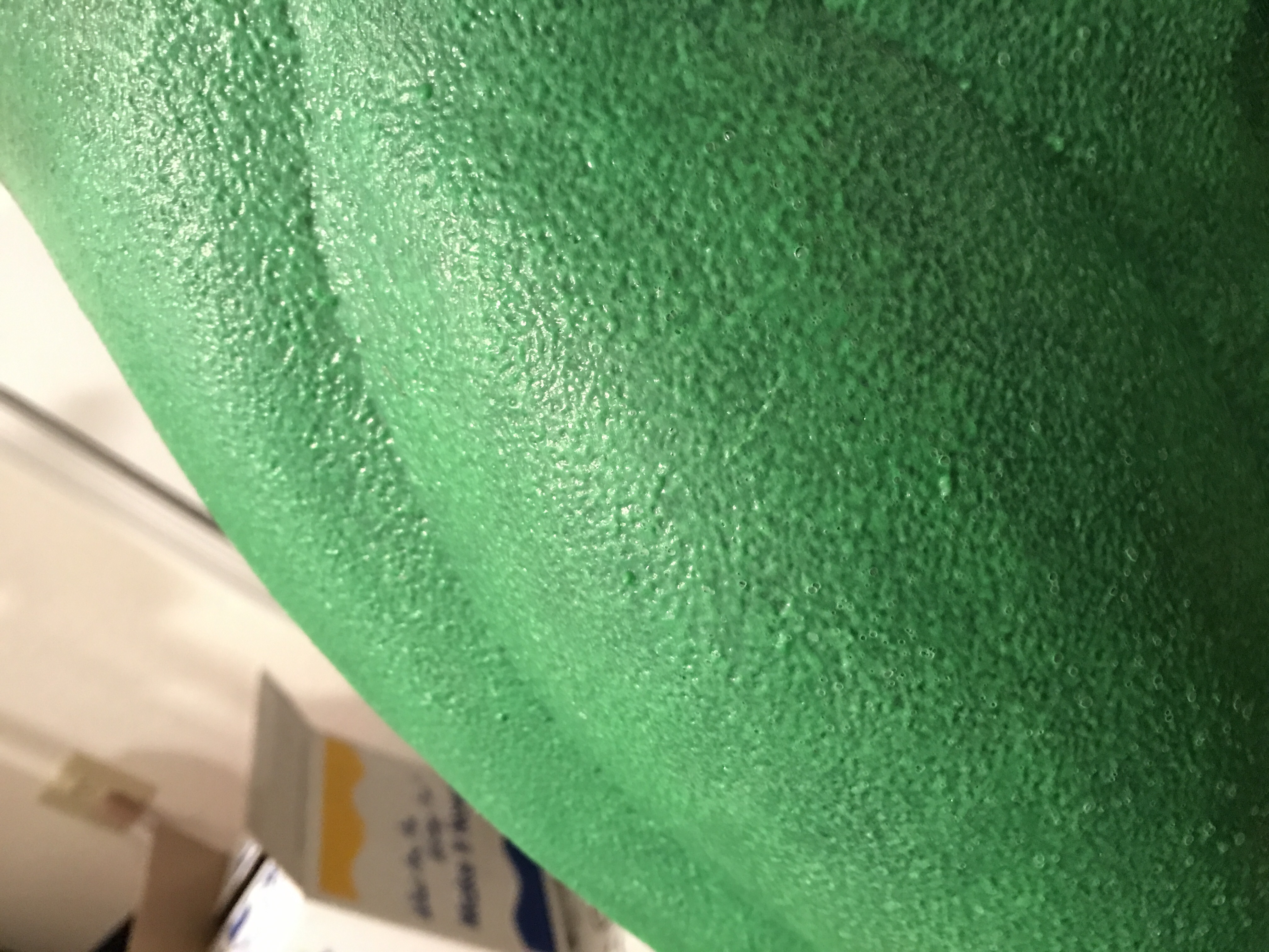

Latex application is coming along well. Think I just need to do one more layer. Here's a close up of the texture on the leg.

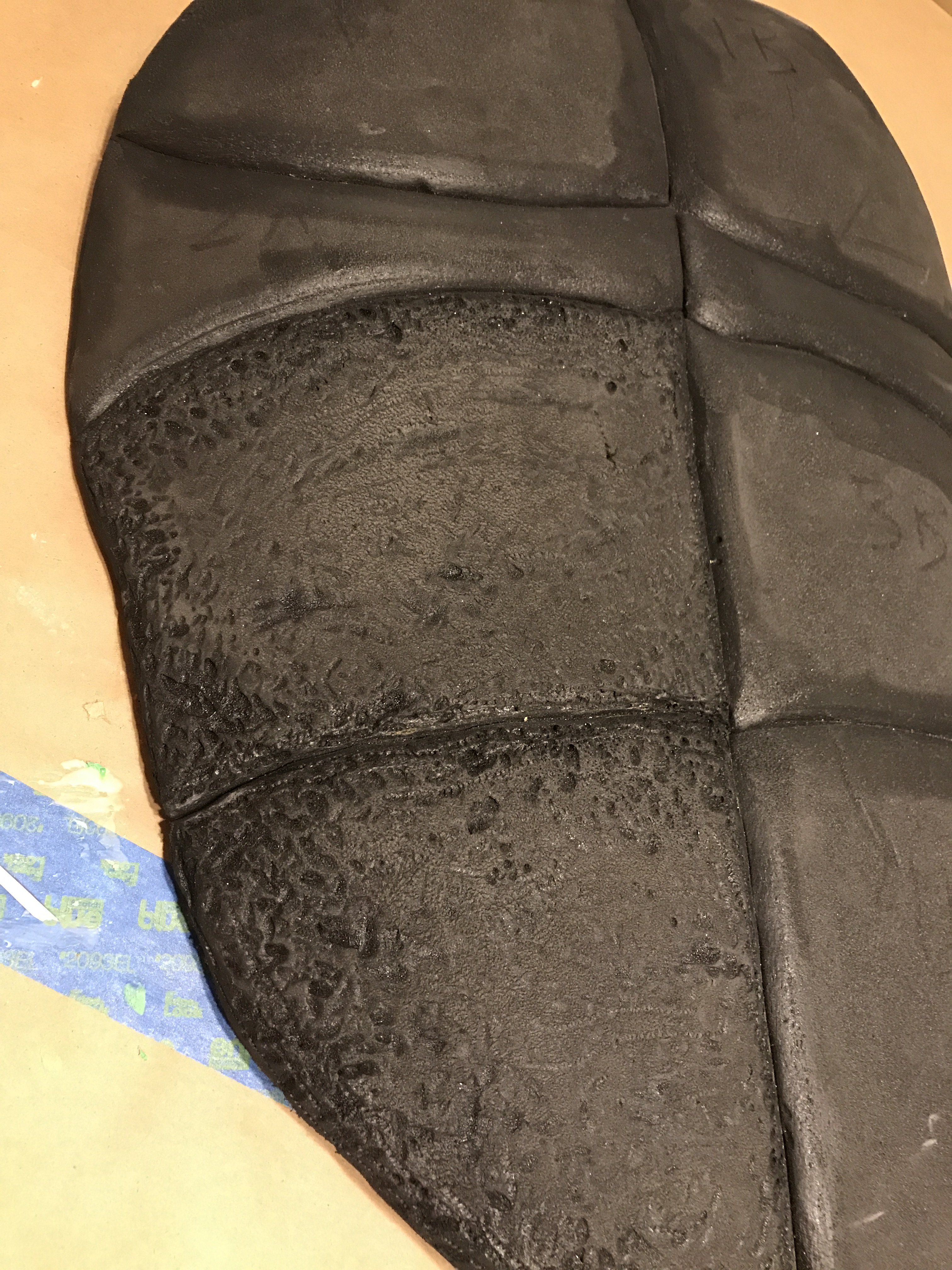

I decided to walk away from the back shell for a bit and take a look at the front shell. I decided that I wanted to give the front shell a distinctive look; instead of a plain and smooth look, I thought it'd be cool to give the front shell some texture using a wood burning tool (with appropriate ventilation and breathing protection, of course!). Here's where it's heading.
