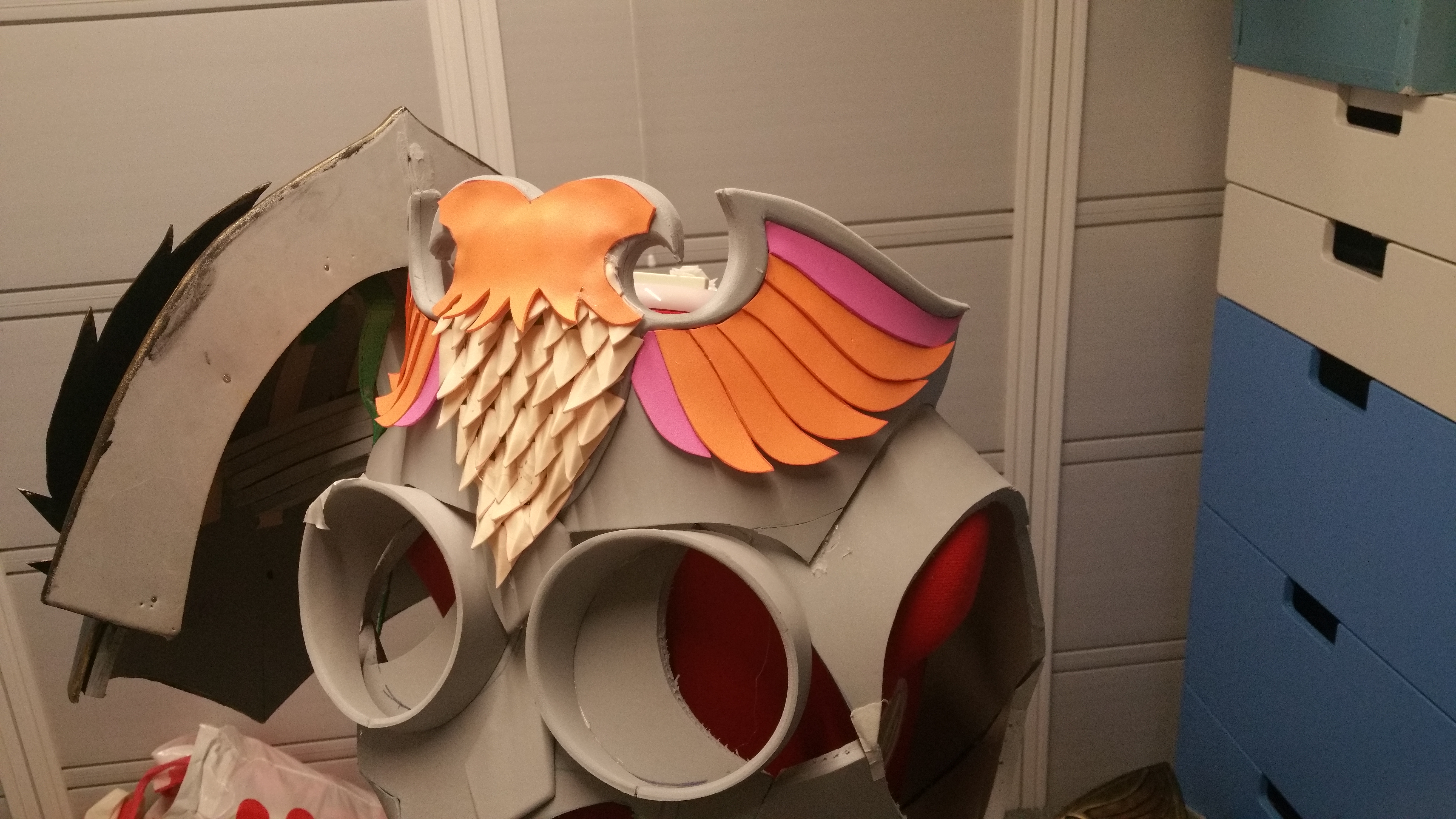

And now...the chestplate...I made it piece by piece, as I do not see well in space and was unable to make a pattern for the whole chestplate at once. So I can't say much about this part, I built it directly on the mannequin.
There's even an eagle in the back ! Too bad that it will be covered by my helmet's plume...

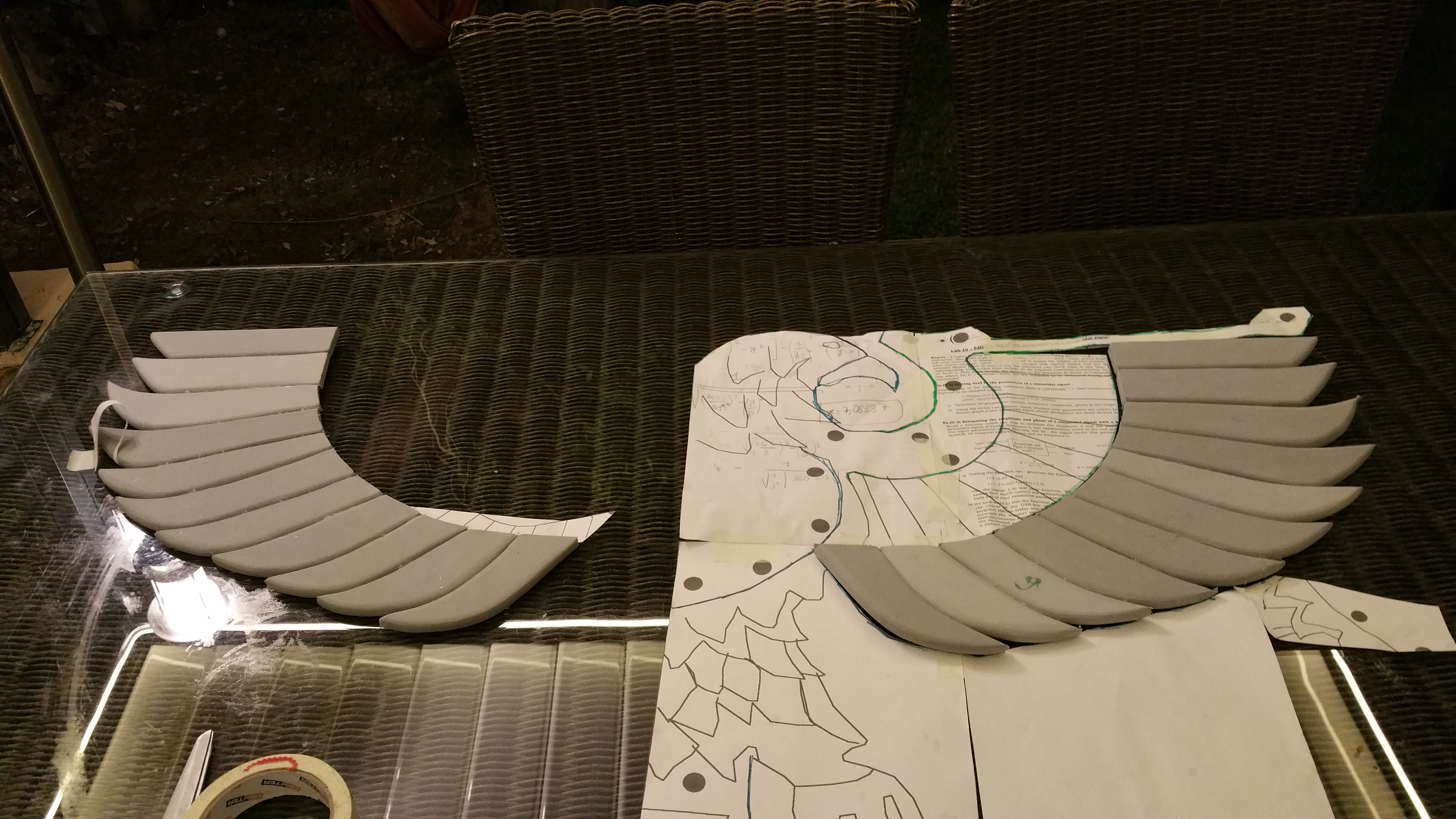

Now, let's talk a bit about props. I'm going to build a guardian spear (it should be able to shoot nerf ammo), but I fell in love with custodes vexillas and shields...
After cutting, sanding and engraving more than one hundred feather-like pieces of foam for my Baharroth cosplay, i thought I had seen enough wings for the rest of the year.
WRONG !
I know, it's big, but a banner is meant to be seen from far away. I'm really sorry about my stupid face, I was facing the sun.
