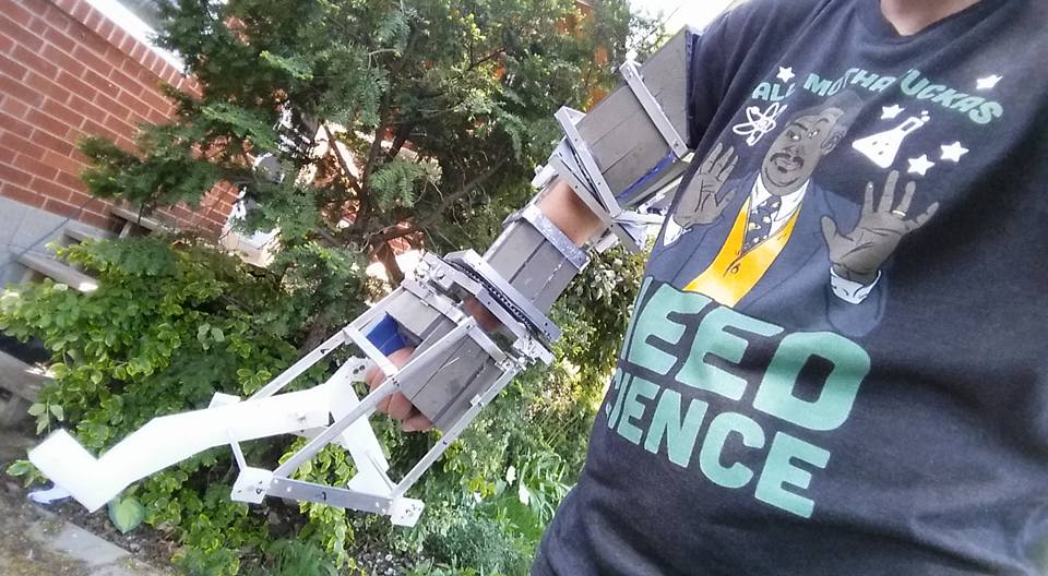

Build consists of an articulated aluminum exoskeleton with Sintra cladding. Lightweight as it'll get with this mode of construction. wanted full articulation for the arm so I used some 'lazy susan' bearings to give me twist in the arm and wrist.
Aluminum was riveted together because I don't have a TIG :)

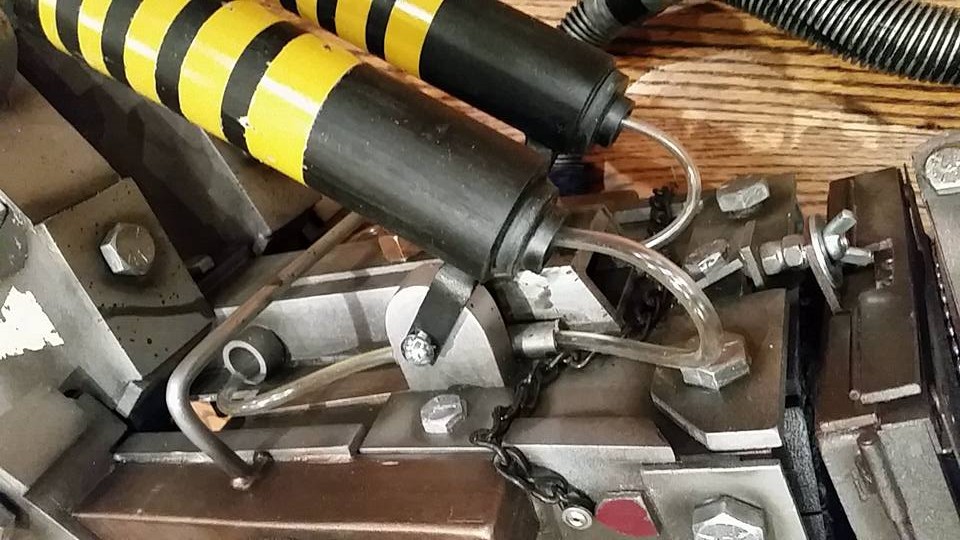

pistons and hoses added next...
