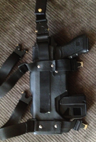

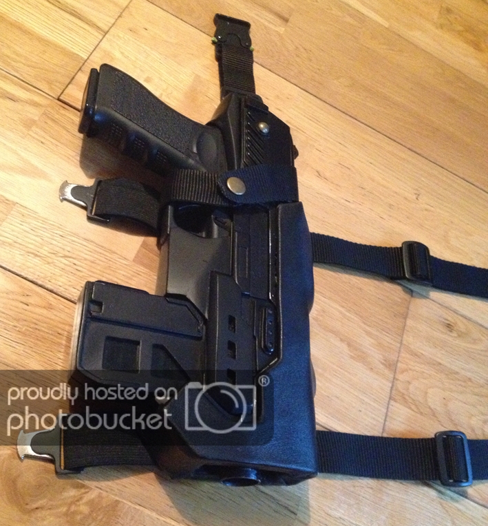

And finally today I took some scrap leather I had laying around (approx 1mm thick) and some Evo Stick sontact cement and covered the exterior leather side out and the interior leather side in/suede side out.
The lawgiver fits reaaaaaaally snug and smooth now
- Only the strapping left to do....only...hmmmm
