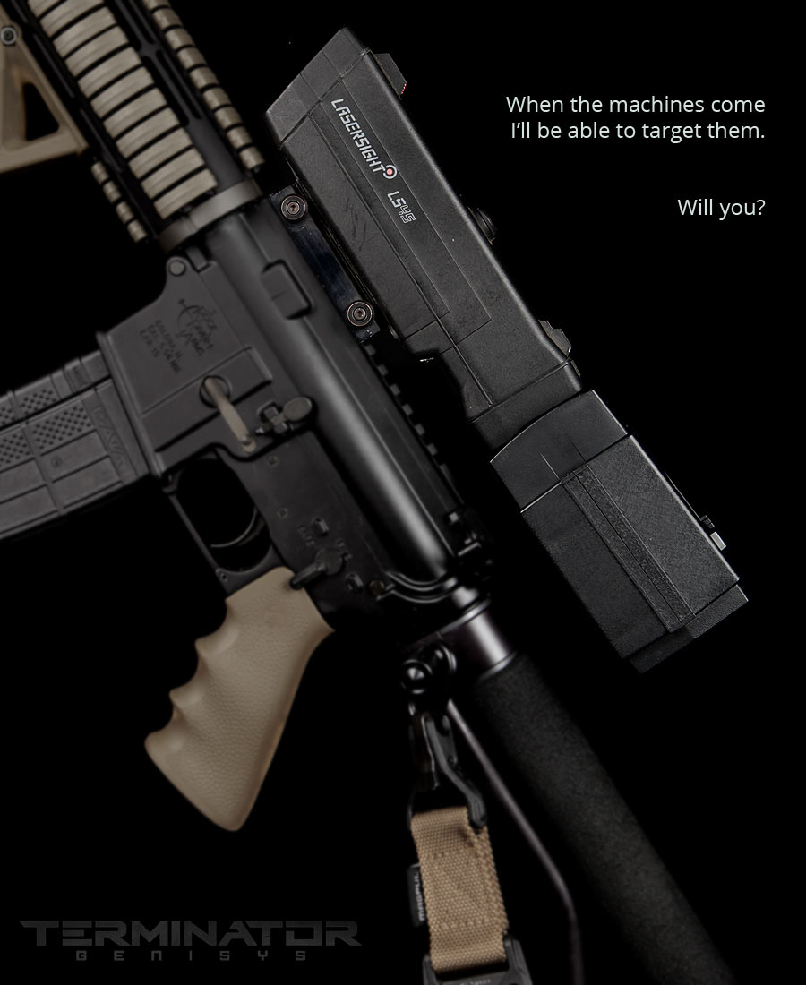

The Pana-Vue 2 mounts upside down with the main screw that holds on the battery cover for the LS45 also being the main screw to hold the Pana-Vue in place. A second, smaller screw, just as seen in robstyle 's pics goes in the upper left corner of the Pana-Vue to keep it from rotating on the LS-45 battery cover.
From what I can see in the film, the power cord for the LS-45 is never hooked up and the lasers are never on. However the Pana-Vue is on in one or two scenes (but not most) and the Pana-Vue on my scope still works as well (didn't bother with adding the on/off switch so you can just get a momentary on by pressing the slide tray on the bottom of the Pana-Vue.
This is a super easy and surprisingly strong assembly of parts that seem very dissimilar and fragile.
