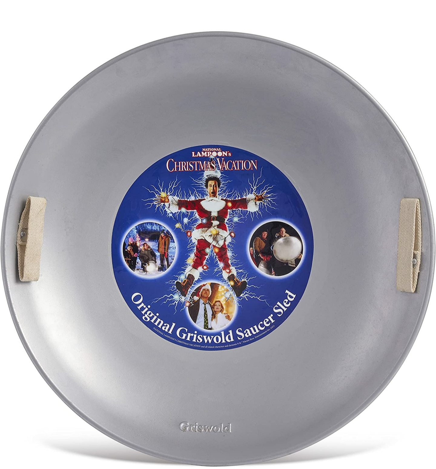

I think I've found something that might work.
An aluminum saucer sled..
