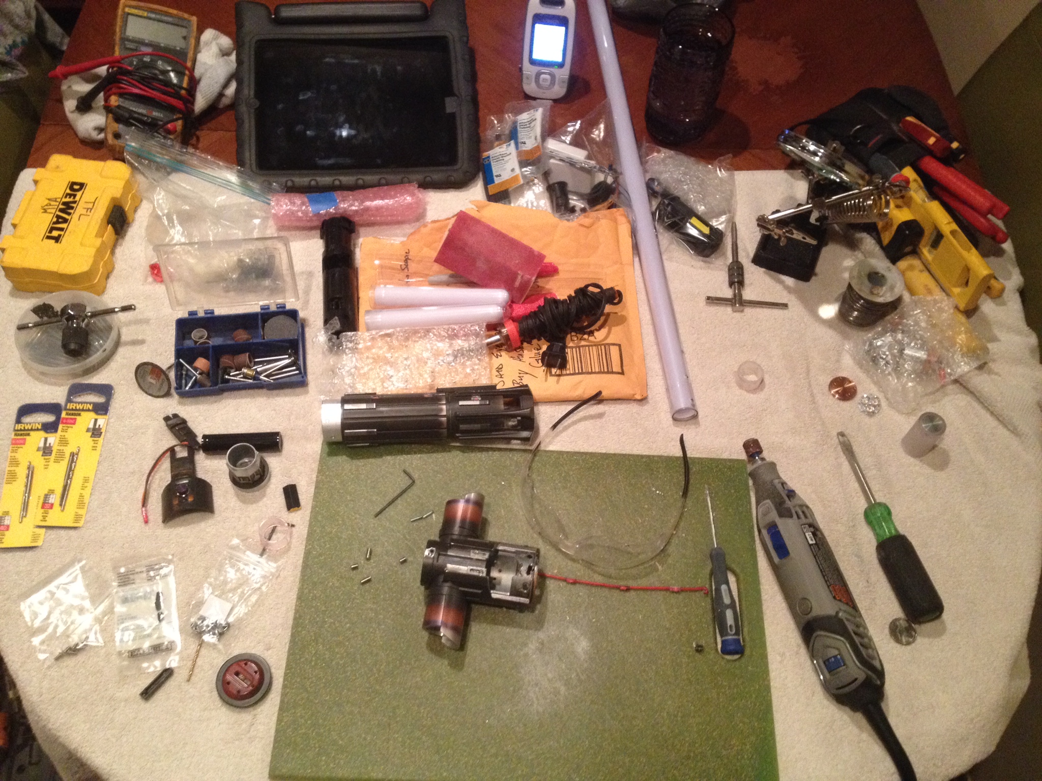

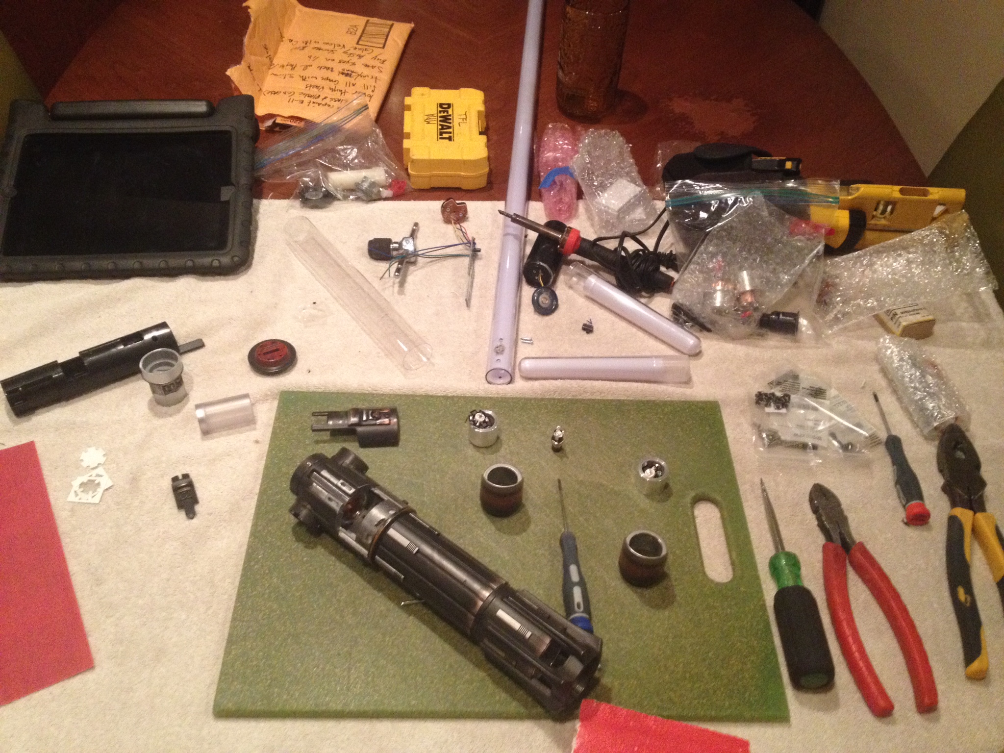

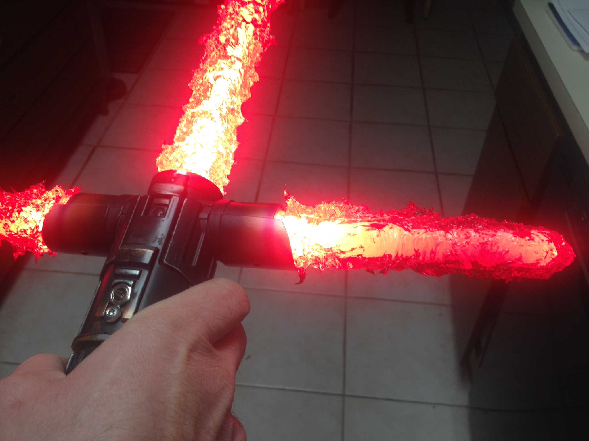

i converted my Kylo Ren black series Lightsaber by changing internal electronics to a Spark2 soundboard with rechargeable battery and kill key with removable custom made unstable main/side blades.

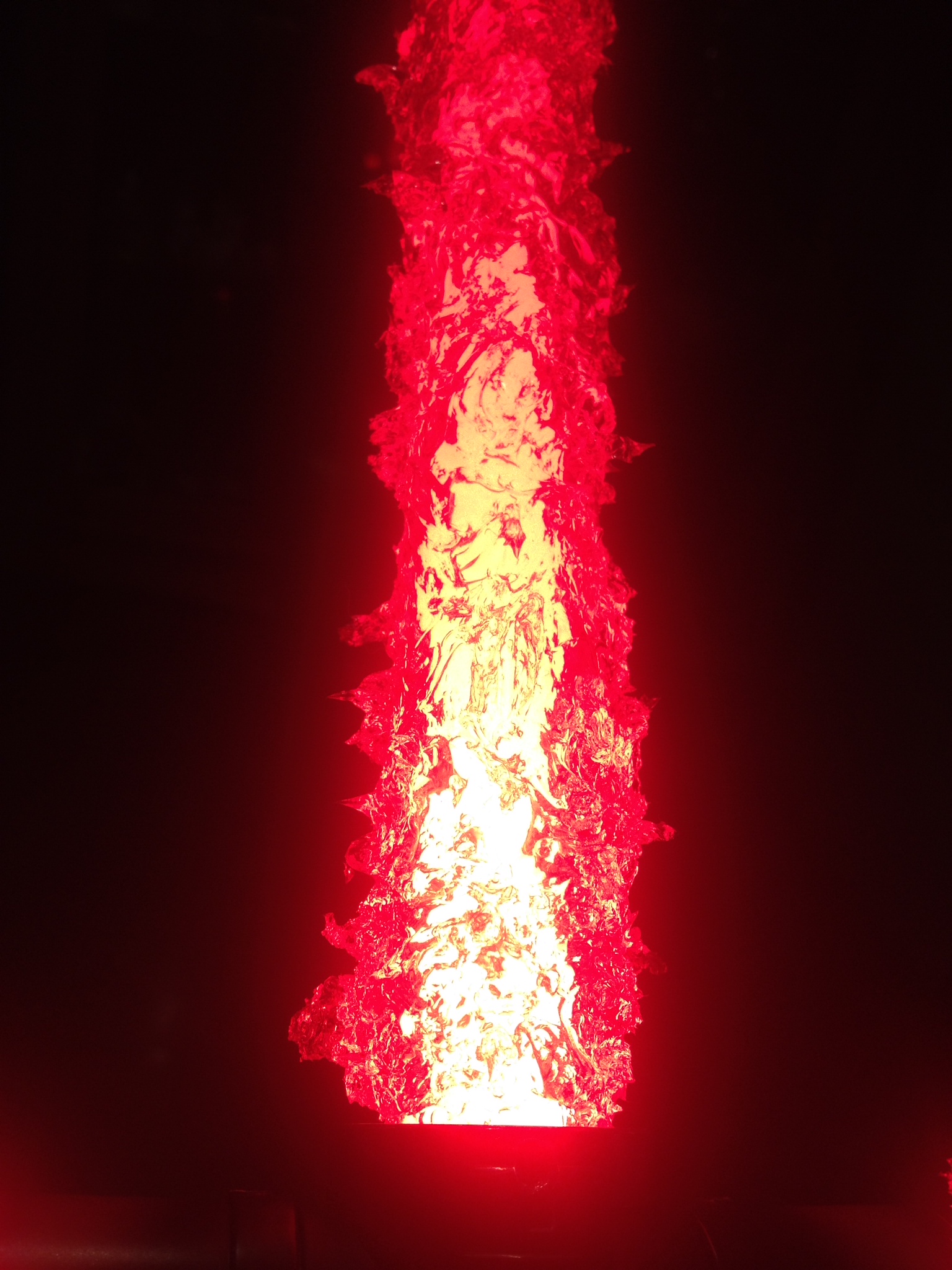

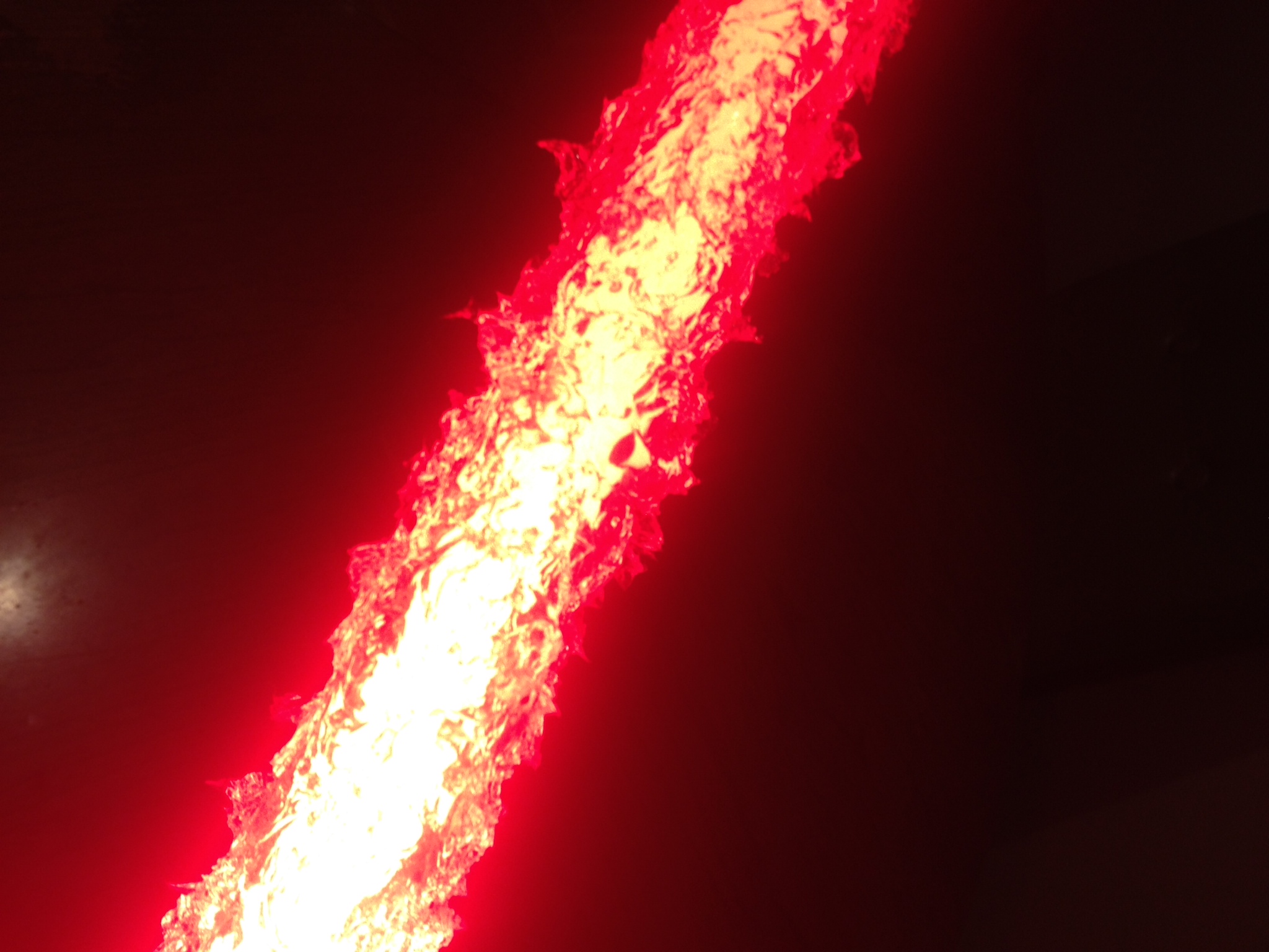

Thank you! These were the blades that came with my black series saber. I used clear silicone that I bought from Home Depot applied it directly to the blades and used a fork to spike out the silicone to get the unstable effect. After the silicone was dry, I sprayed the blades with Red translucent tail light spray paint bought from auto zone.
The silicone looks great but the red translucent paint makes the saber come to life! Better than white!
