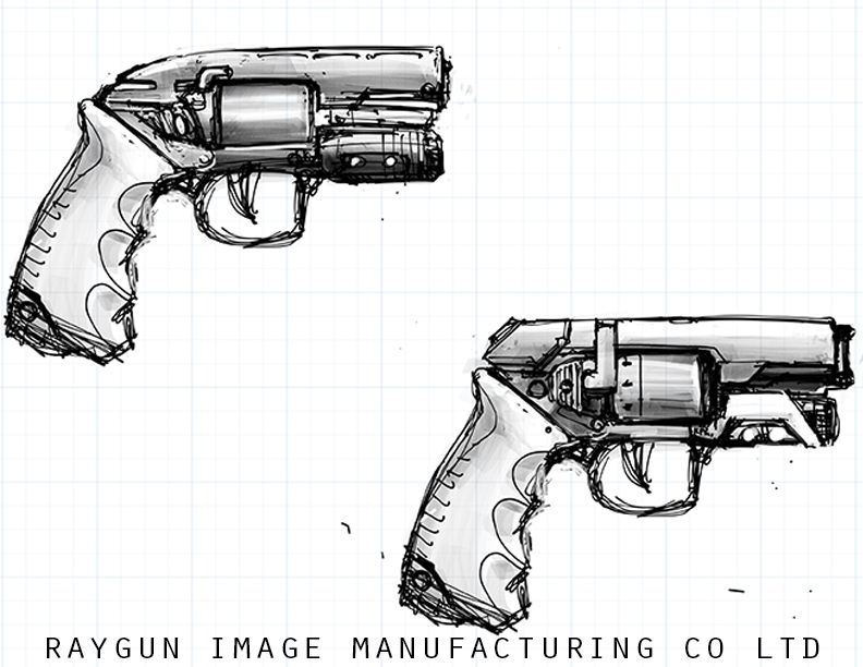

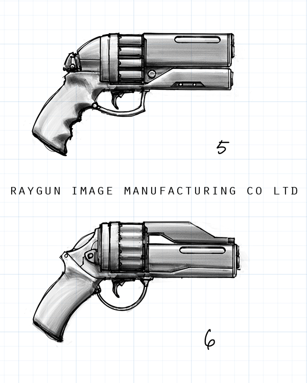

One of the most distinctive things of the BR Blaster is that its sorta has the silhouette of a revolver but no visible cylinder suggesting a technology that is outside our perceived norms like something in the future might be.....like in Blade Runner. The thing is that our world of Death Note was not in the future but now.... todayish. So with this in mind I started incorporating the cylinder into the design which eventually lead to these two:

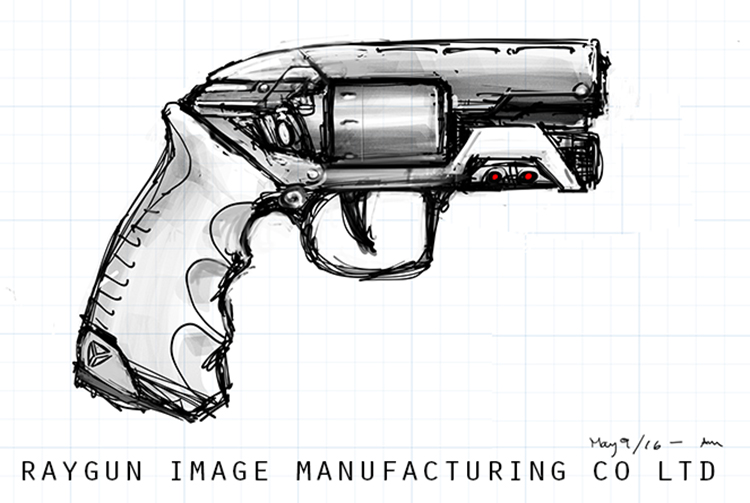

Which was ultimately combined to this one....
