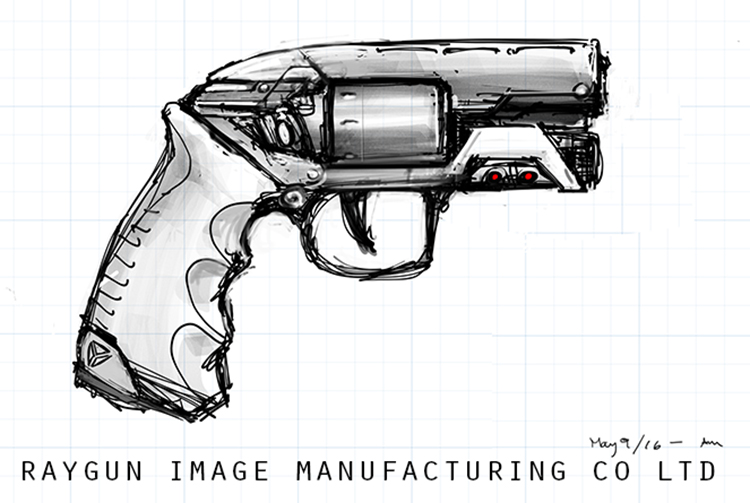

After a few design sketches to get the approved feel of L's Blaster came down to this sketch to start creating a full out design render.
When designing a fictional firearm it is generally based and built around an existing one that can actually go bang bang much like the BR Blaster and countless other blasters, except for Phasers. Actually I lie as the Assualt Phaser was based around a Beretta but I digress.
I think it wasn't quite decided for sure if we were to base this on a donor gun as there was some talk that the pow pow could be done in post production as a VFX effect because the gun wasn't really scripted to fire that much if it fired at all. This would have been a budgetary (as well as a design) consideration as it costs a little less to fabricate a static prop and I could be free to design anything I wanted.
But I like to design stuff and things that feel like they belong or can exist.... that there is realism in the design. So I started to model the KPD anyways on an existing revolver just to A: get the proportions feeling right and B: they might decide to fire the Blaster for whatever reason.......so I modeled up the revolver frame based on a plastic scale model of a Smith and Wesson ( 357 I think) that I found in a garage sale......

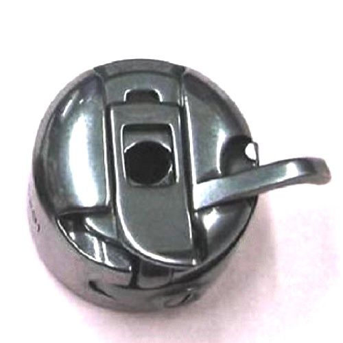

I had a direction for the front part of the gun but what I was having a hard time with was the rear of the gun behind the cylinder..... it was looking way too pedestrian and not very PKD Blaster. But then I remembered this thing:
Anyone know what this is?
Right! It's a bobbin case for a sewing machine. When I was very little, I was totally fascinated with this thing from my mom's sewing machine. It had an engineered machined look and functioned really simply and it looked pretty neat too. And I thought it'll be cool as a design nod to my mom.
Once I decided that is this is what I was going to do, it was pretty straight forward in implementing that into the design.

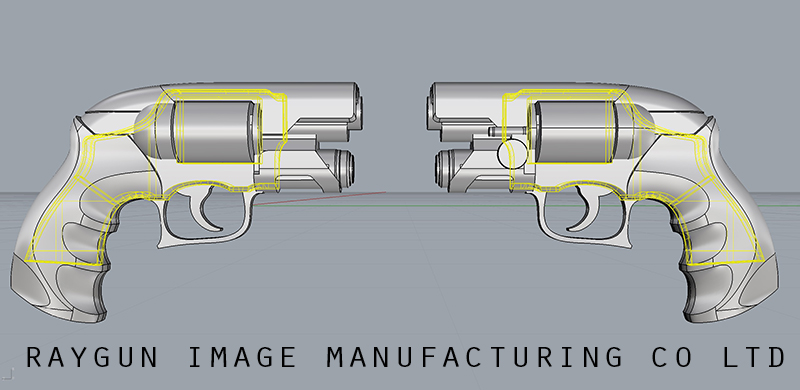

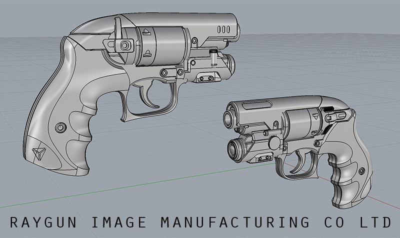

Here is a screen grab of the design model before a material render pass

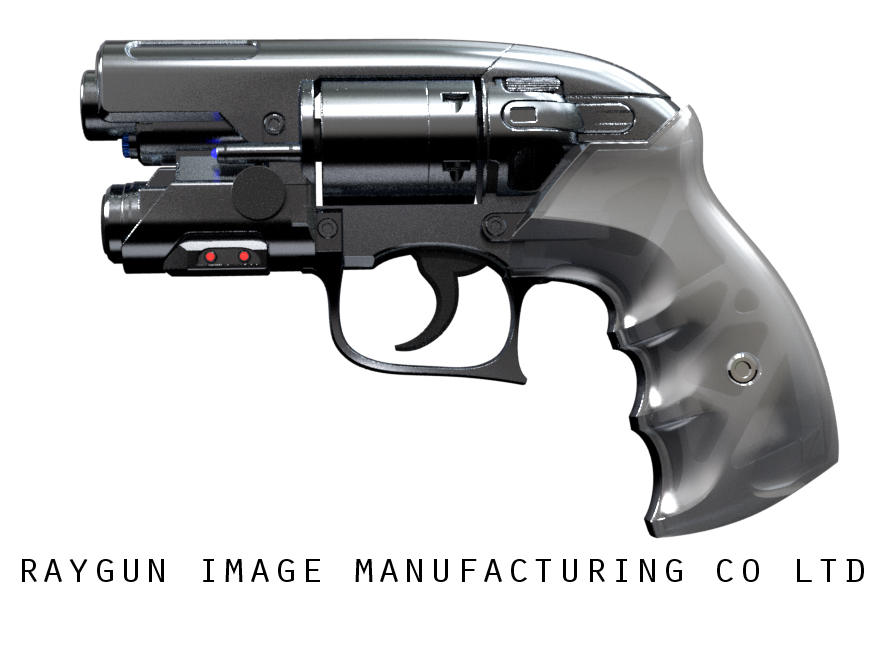

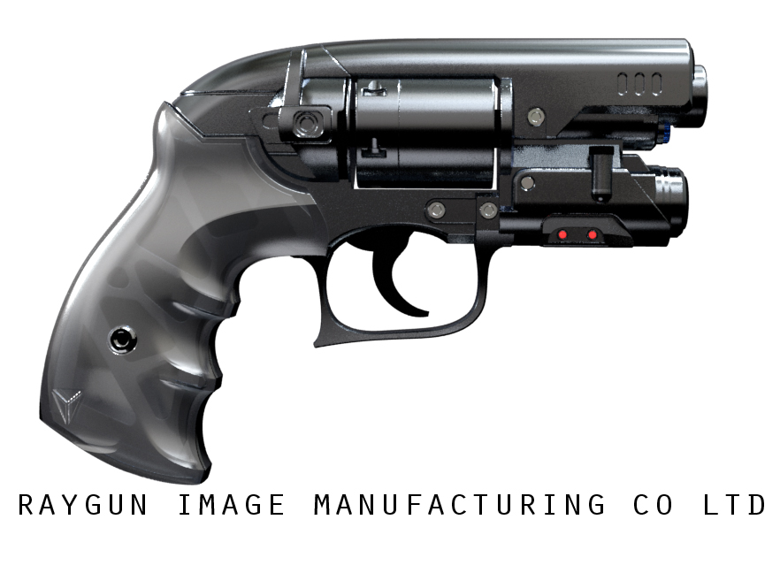

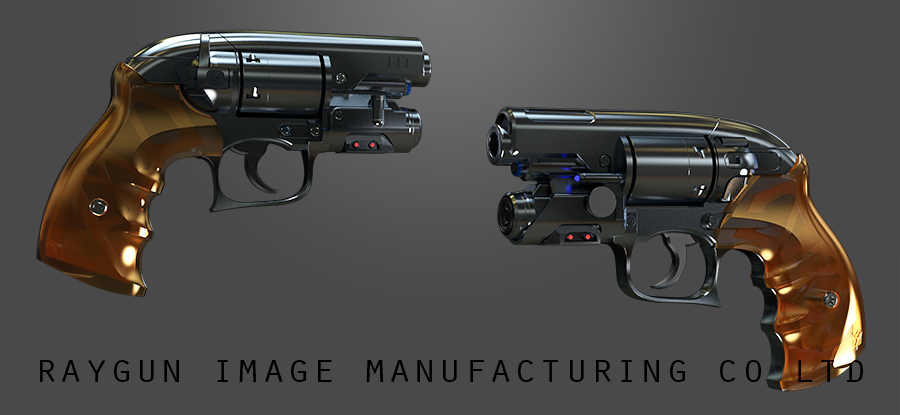

Here is a material render study in the vein of it's inspiration.
And one of the final material renders that was approved.

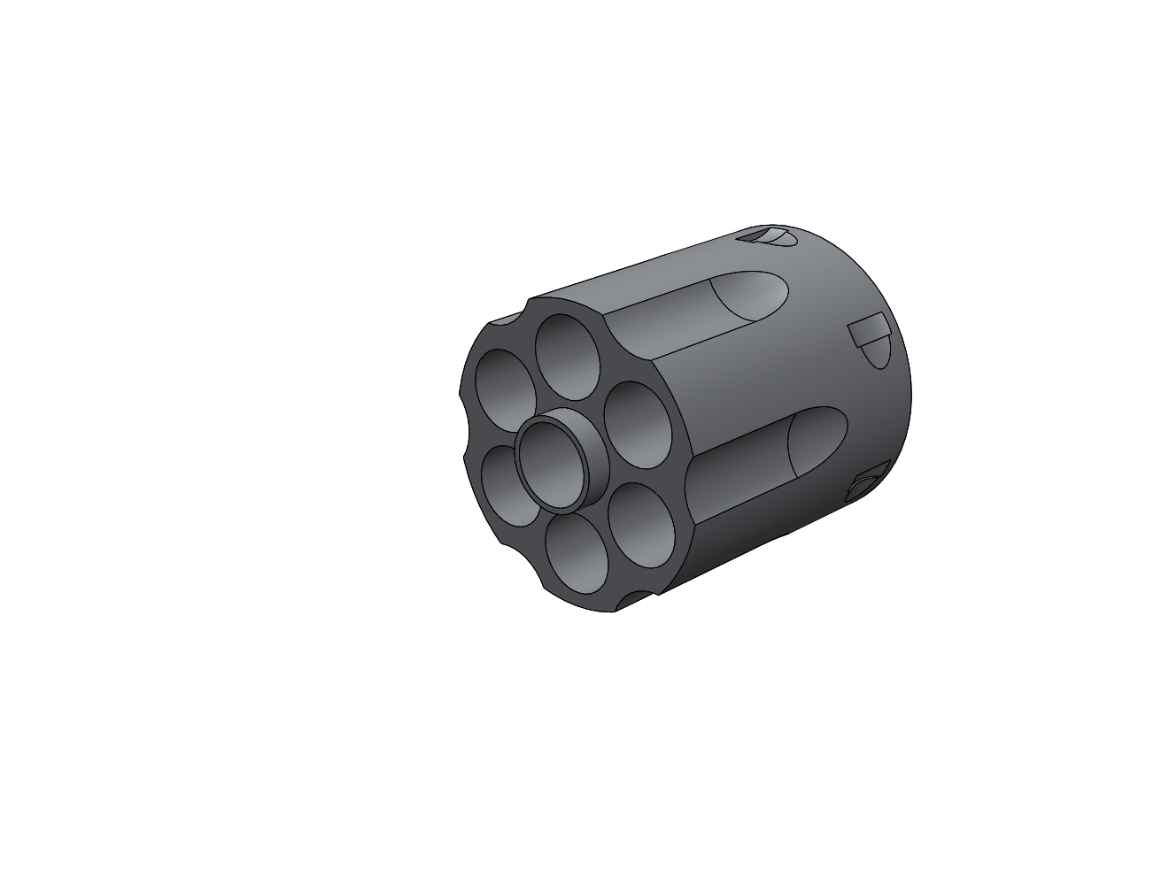

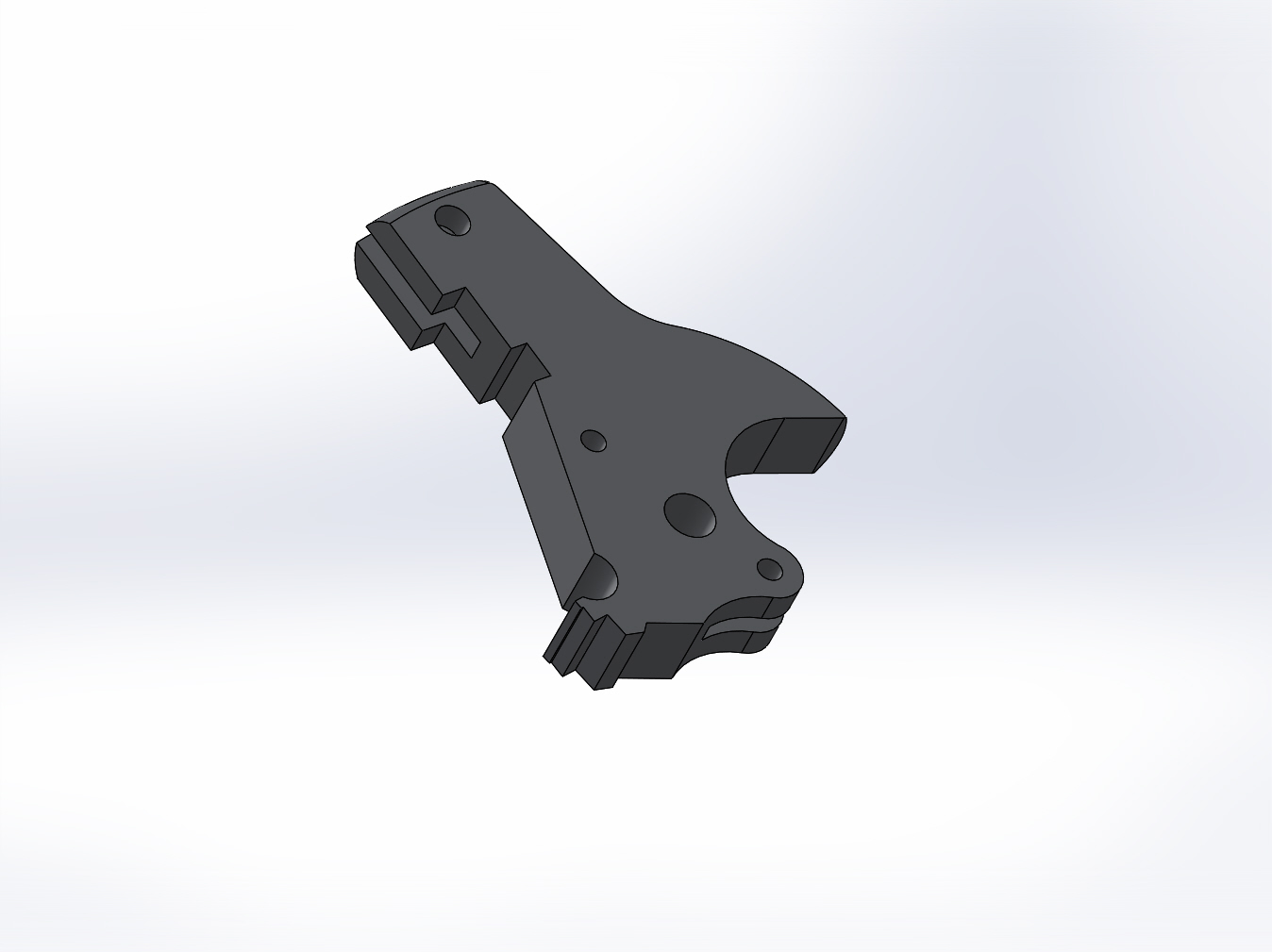

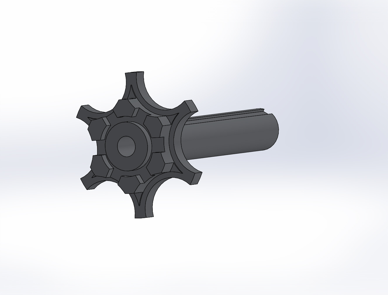

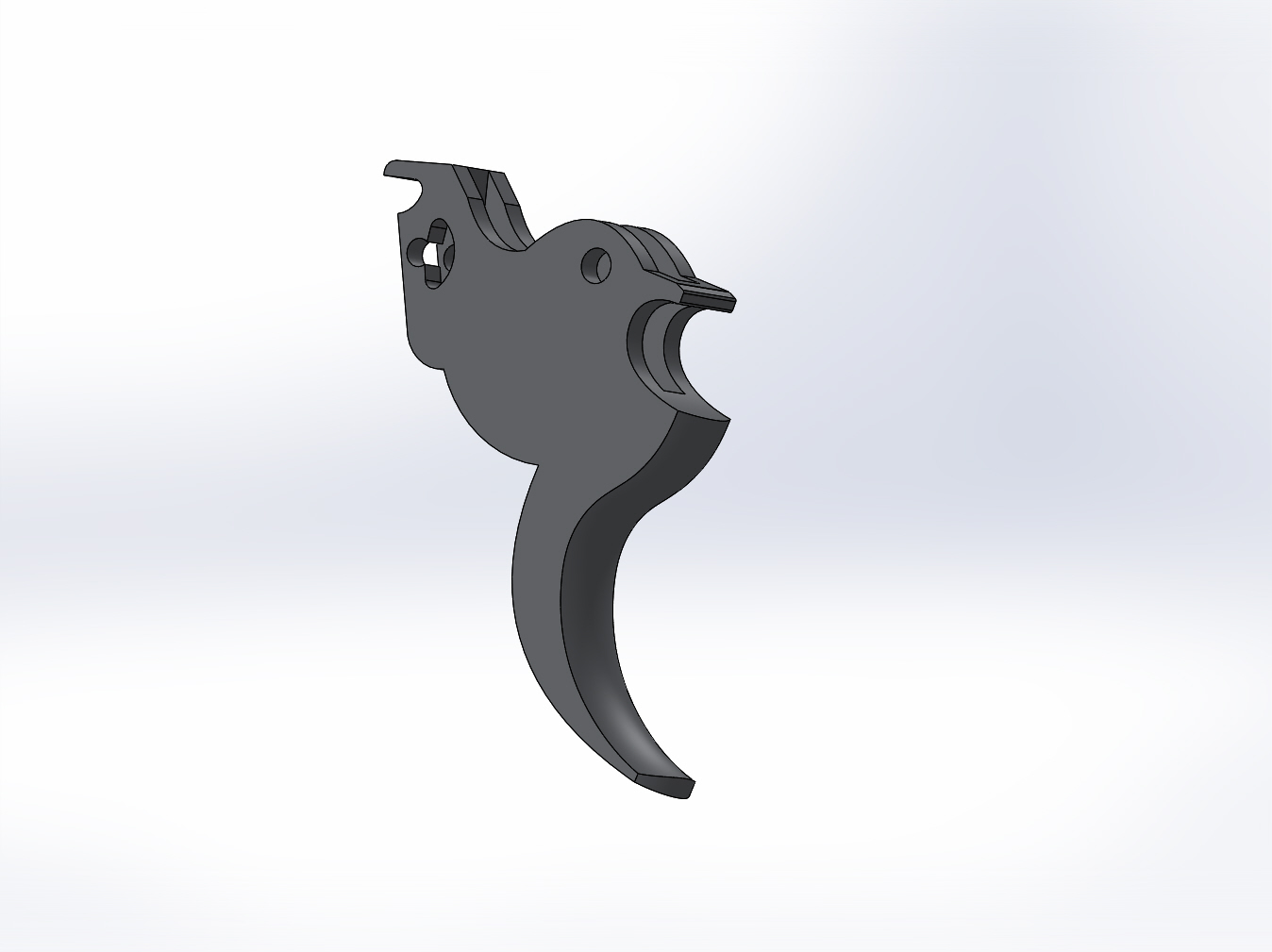

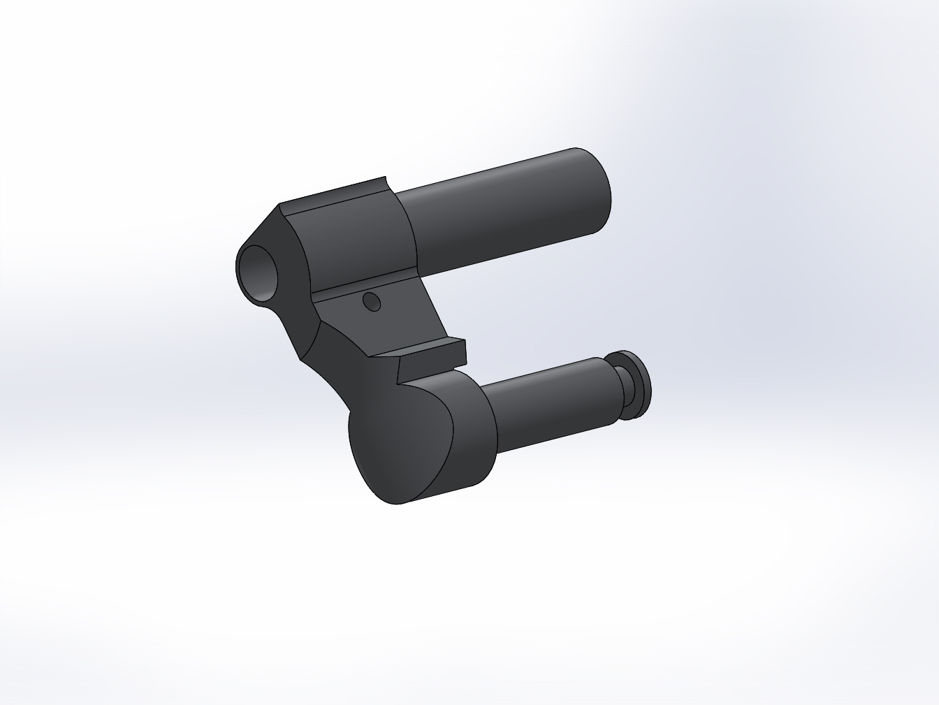

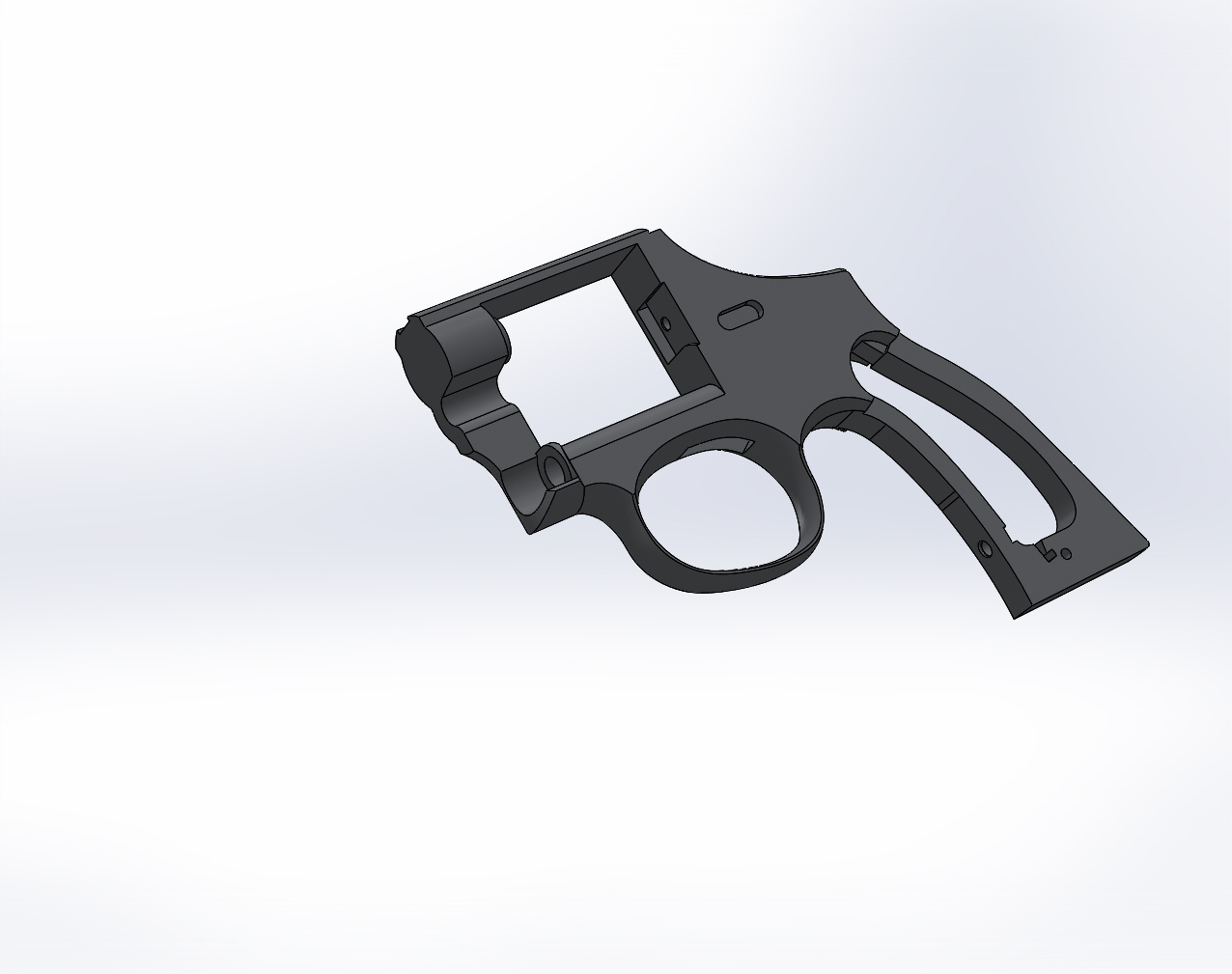

Let's get back on track again. Over the years I have chosen a few different firearms as my typical "safe" base guns to use when covering with machined aluminum parts. Anyone that knows some of my work knows I favor the Smith and Wesson 38s. Typically the model 15. It's easy to convert to fire blanks. It's easy to design, machine, mount barrels to it etc etc. And I have proven many design mods to this gun over the years. It's a beast. The armorer already knew I favored the model 15 and had suggested the gun to production because I had mapped it over the years and it could blend in with what they were thinking. I had created real working CAD models of the weapon and that was another deciding factor. I have close relationships with firearms manufacturers and I'm one of the very very few fortunate to have contracts and NDAs in play with these companies for full access to their CAD models.
However, because this is an older weapon, there were no CAD models ever done or available.... only factory blueprints. I took whatever prints I could get and spent, I believe, a month creating a full detailed set of CAD models on this gun. This is important when I design "aluminum shells" I'm going to machine and mount over it. It all needs to be precise and fit the gun like a glove. During this month, I measured like crazy using everything from micrometers to calipers to even breaking out my $80,000 laser scanner. Here's some of the parts.
Another huge reason I have made CAD models of so many weapons we often use is the fact that it saves considerable amount of lead time during the design and build time. This is extremely important.

AND Ray..... shame on you for not showing me the render with the Blade Runner color scheme! I would have made up some bull**** story to production about not using chrome! Man.... this would have made a better stab at the Alcon guys!
The BR colors render really is just incredible. If this goes to kit, I'm raising my hand for that option :)

Love all of it guys! The process, the B-T-S aspects (budgets, safety, renderings, designs, etc):cool And Ray, when I saw that bobbin case it reminded me of my Mother's old Singer!
As a kid, I was always fascinated by that little piece of engineering!
