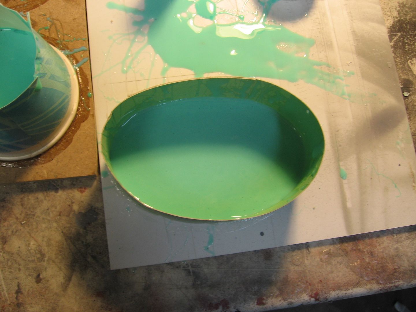

Back to making kits today and making some new molds. Some are getting worn already. I'll in the kitchen I'm finally getting around to cleaning up and molding these COM badges I've had since my Paramount days. One of the guys down there gave me a set. I've made a new mold and will finally get to make some up. I'm looking into a sound chip for them that makes the sound when you press on them.
I have a cobra original Phaser too I plan to get to down the road. New mold. Hallow cast and electronics. Fun side projects.
