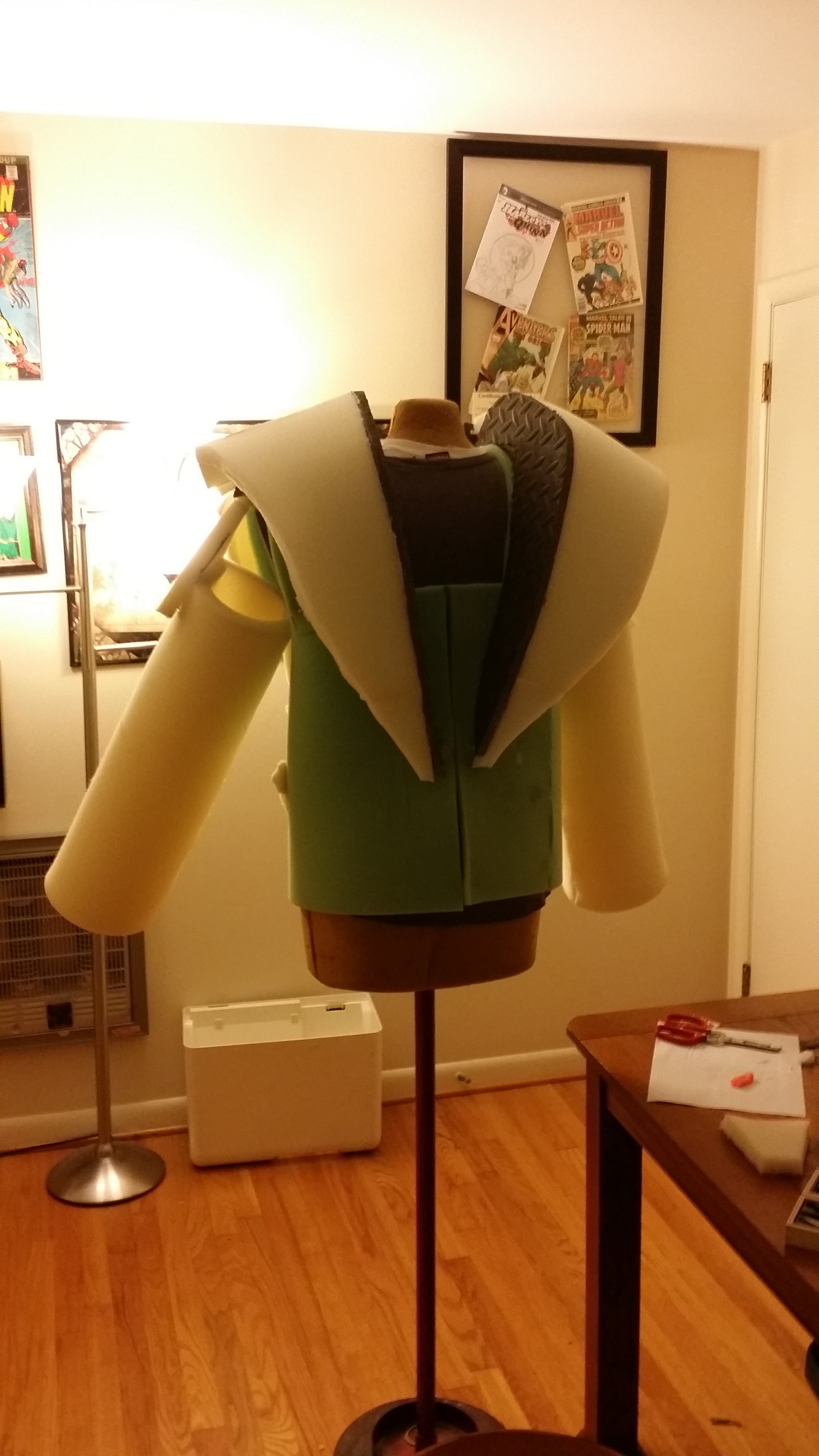

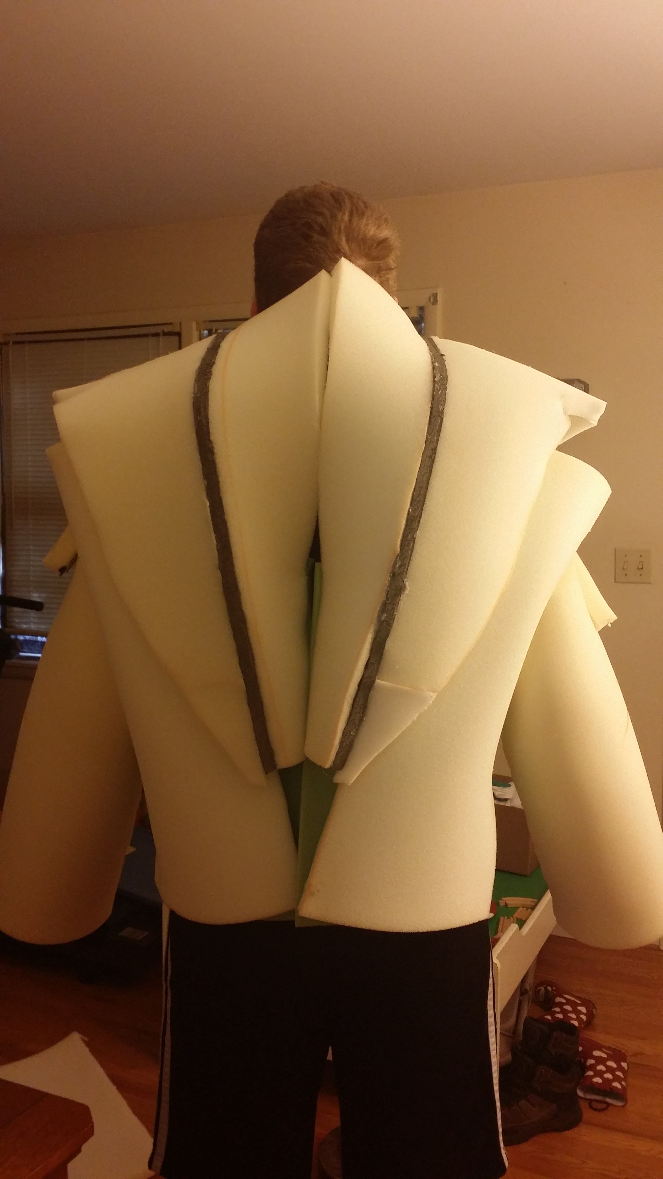

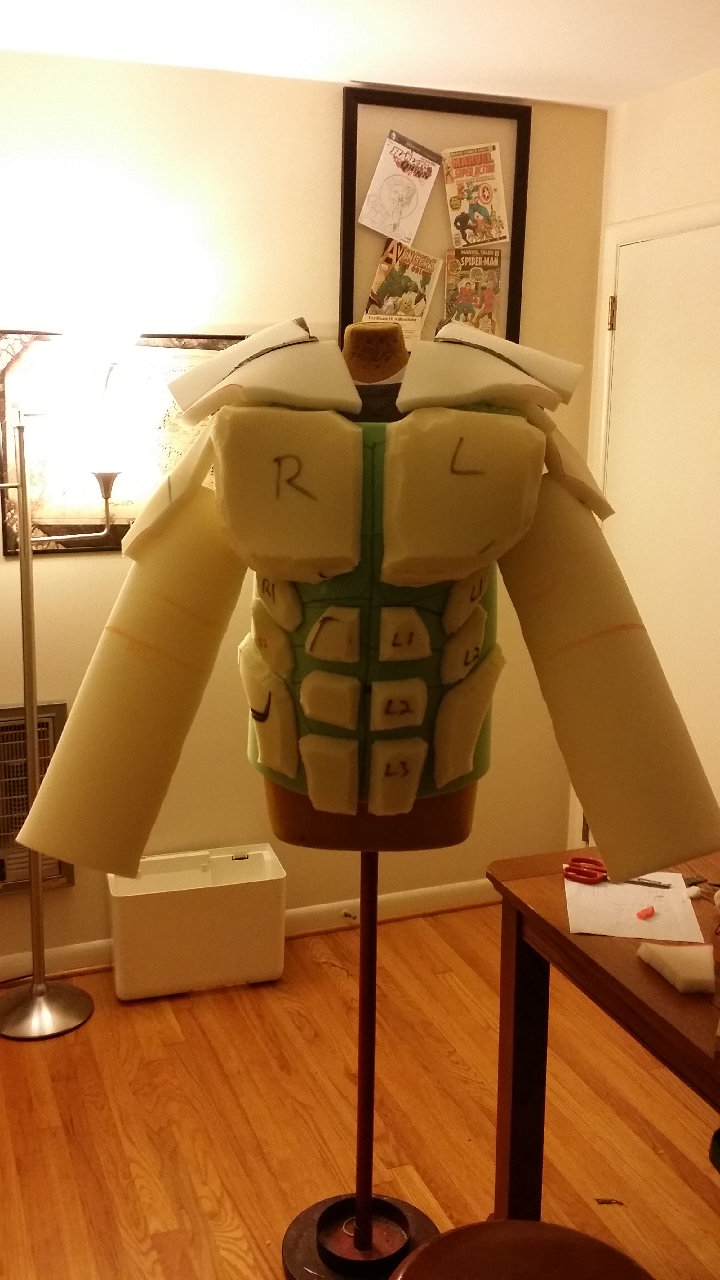

New updates! I have been scratching my head on how to build the torso without making it look goofy. My initial instinct was that bigger is better, but after some thinking I realized that making the muscles too big will make it very hard to move as well as look ridiculous as they would look out of proportion. I will upload some of my reference pictures in a minute to let you see my goal. I have added the trapeszius muscles and will finish with the latisimus dorsi before I go to bed.

It's looking good so far. I think bulking up the back and filling out the lats will really add to the believability.
Something that I think you might be neglecting is this area that I've circled in red. I don't really have a name for it. The way your muscle suit is going right now there are gigantic pecs and abdominal muscles sitting on a weak little skeleton. Filling out this section suggests that he has a strong rib cage capable of supporting those muscles.

Awesome Hazmat! Thank you for pointing that out to me. I would have completely overlooked that area. I just finished working on the lats so I'll upload those in a minute. Thank you again for your honest opinions. I think sometimes people get nervous that they might offend the builder, but that how we learn from each other and get better at building!

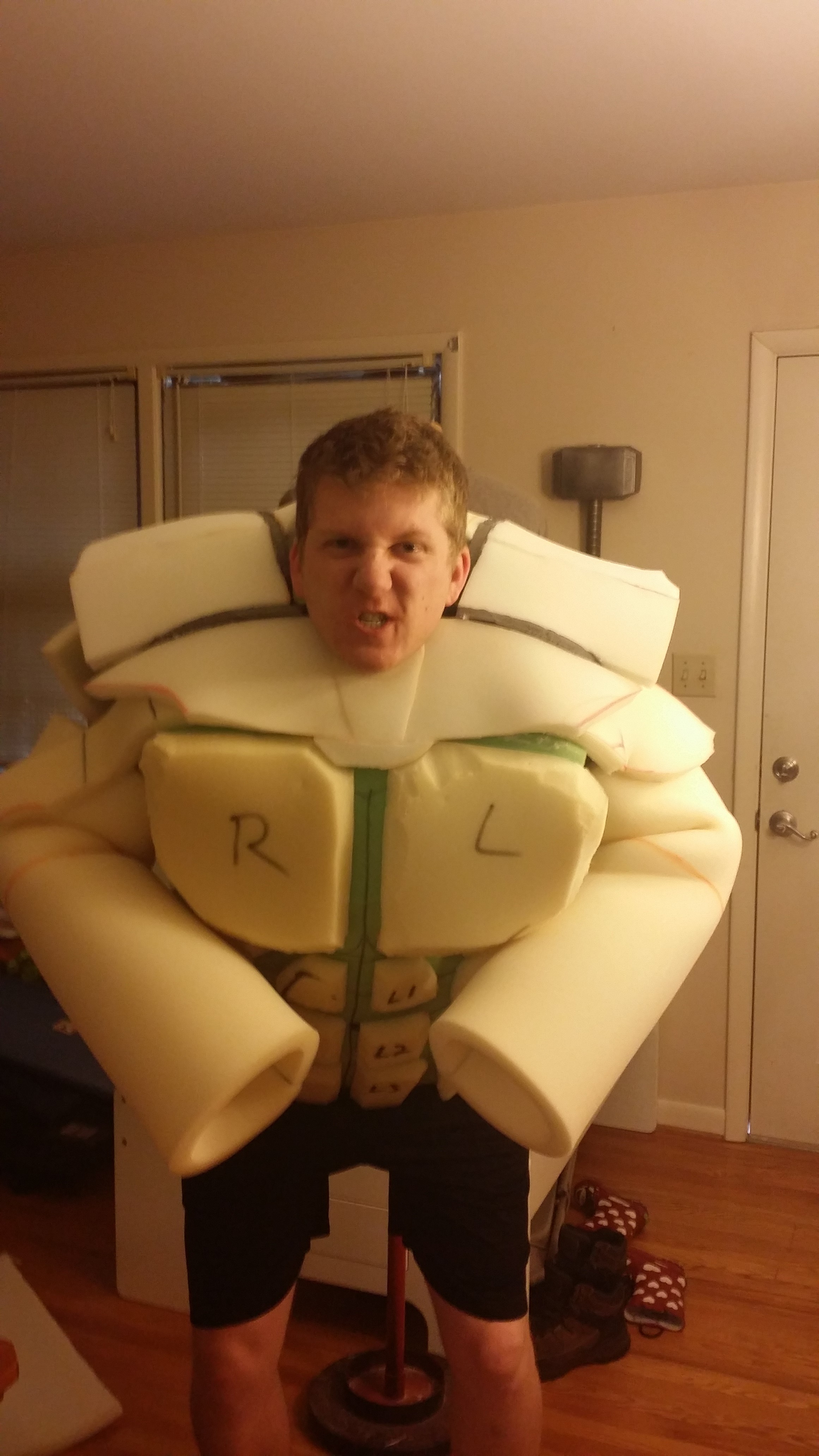

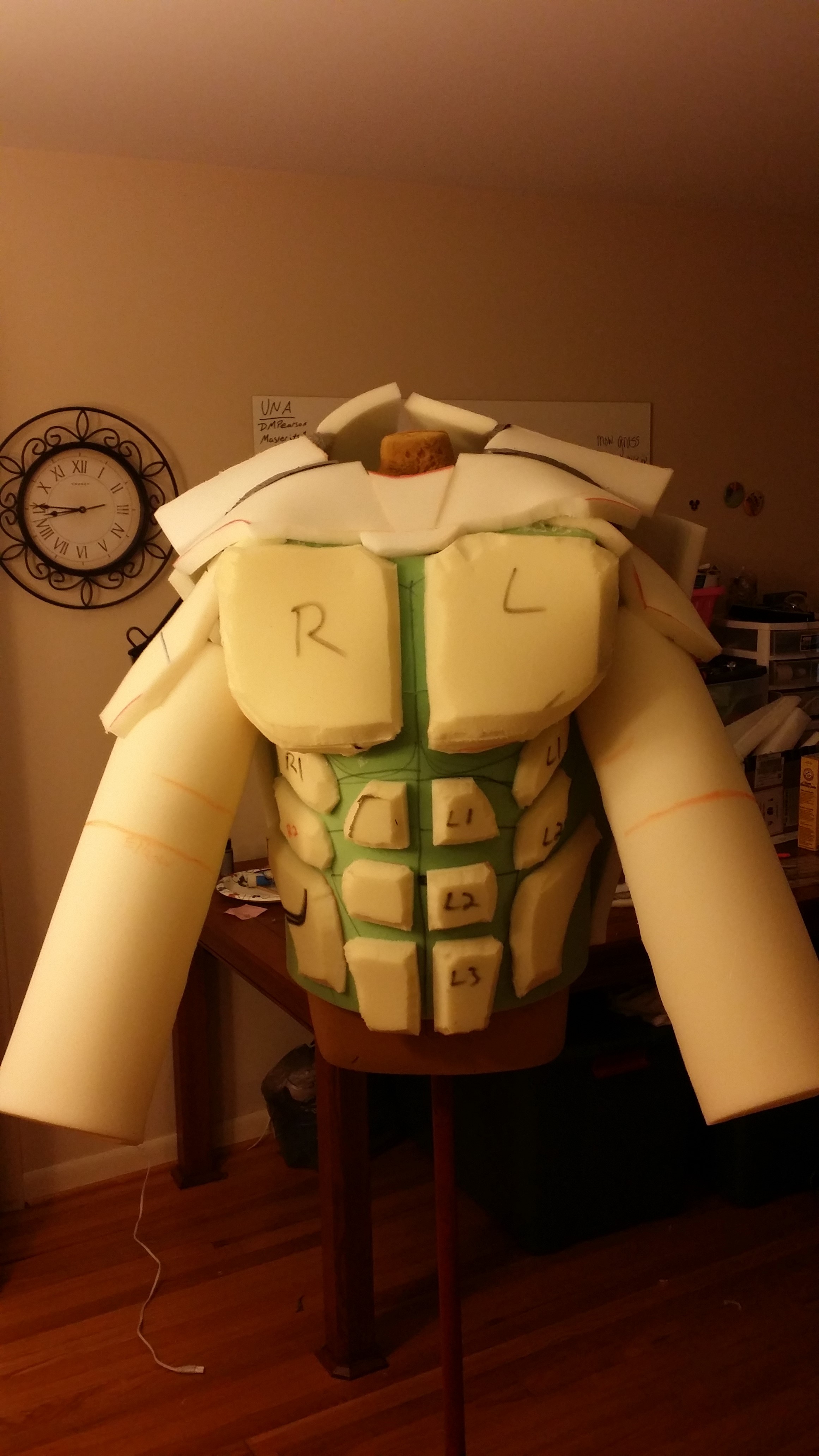

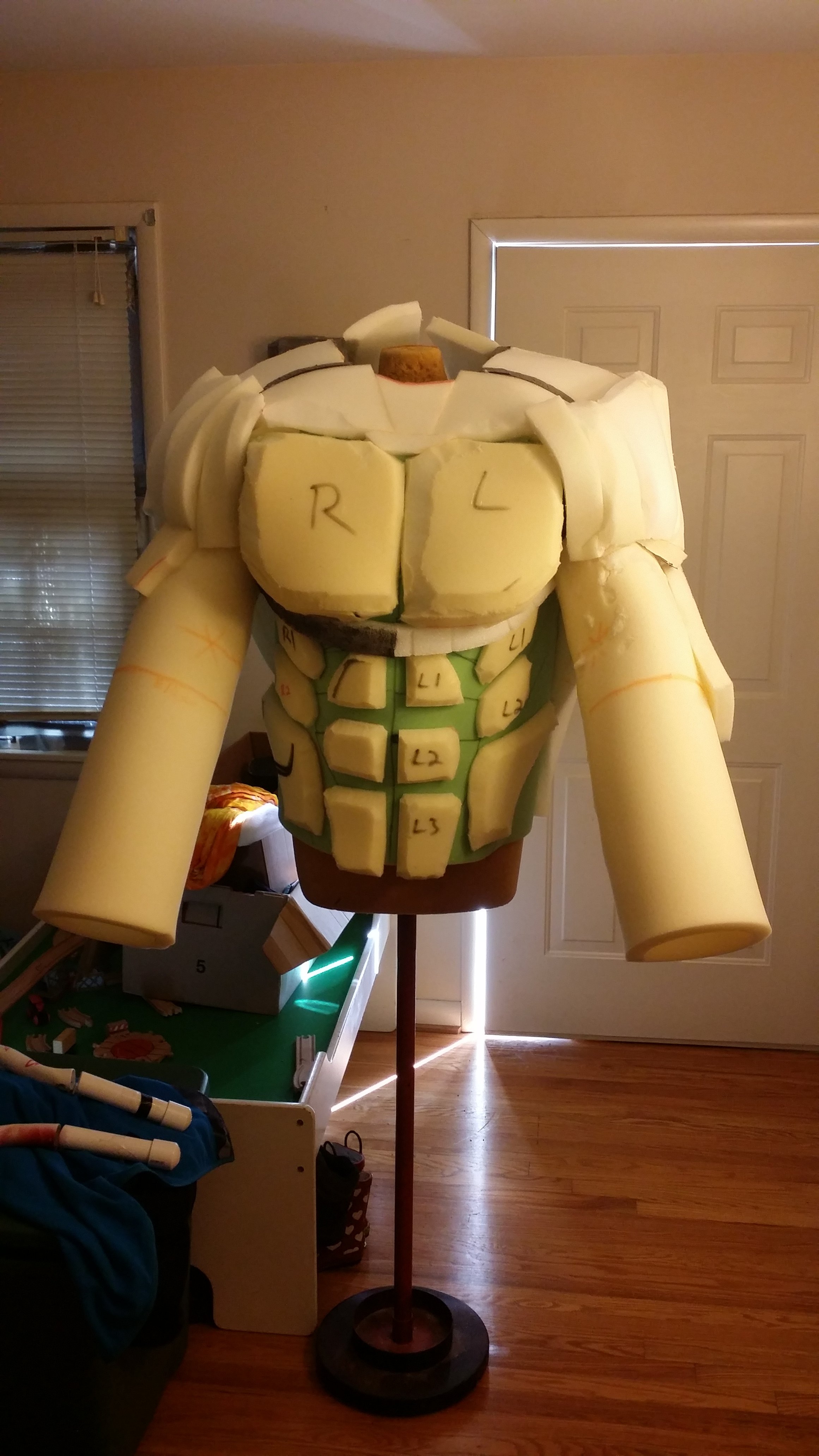

After working most of the evening, I have an issue. The Biceps are very close to the pecs and I am limited in my options due to my arm length. Anyone else run into this problem or have a suggestion? His Bicep is going to be rather small compared to the rest of the arms.

on my hulk suit ( http://www.therpf.com/f78/big-muscly-character-base-hulk-thanos-thing-233192/index2.html )
the chest is quite wide and my arms aren't long enough to reach the hands and i've ran into the same problem
you can spare to extend the width of the chest without needing long arms

I guess you could slim the chest down
what i was saying was you can still keep the chest wide but you'll have to use arm/hand extenders instead of having to shorten the arms

Great build! I am not a learned student of this character but he is Juggernaut, not "bench-pressernaut," right? He mainly smashes into stuff? I think somewhat smaller pecs are perfectly in keeping with his particular shtick. Powerful back, thighs, abdomen and neck are critical. Pecs, not so much. Just my opinion.
Re: Juggernaut costume *UPDATE 2-28-15*
Also, remember that the pectoralis muscle is triangular, coming to a point laterally at its insertion into the humerus (arm bone). Start trimming there and it will reveal the biceps more.

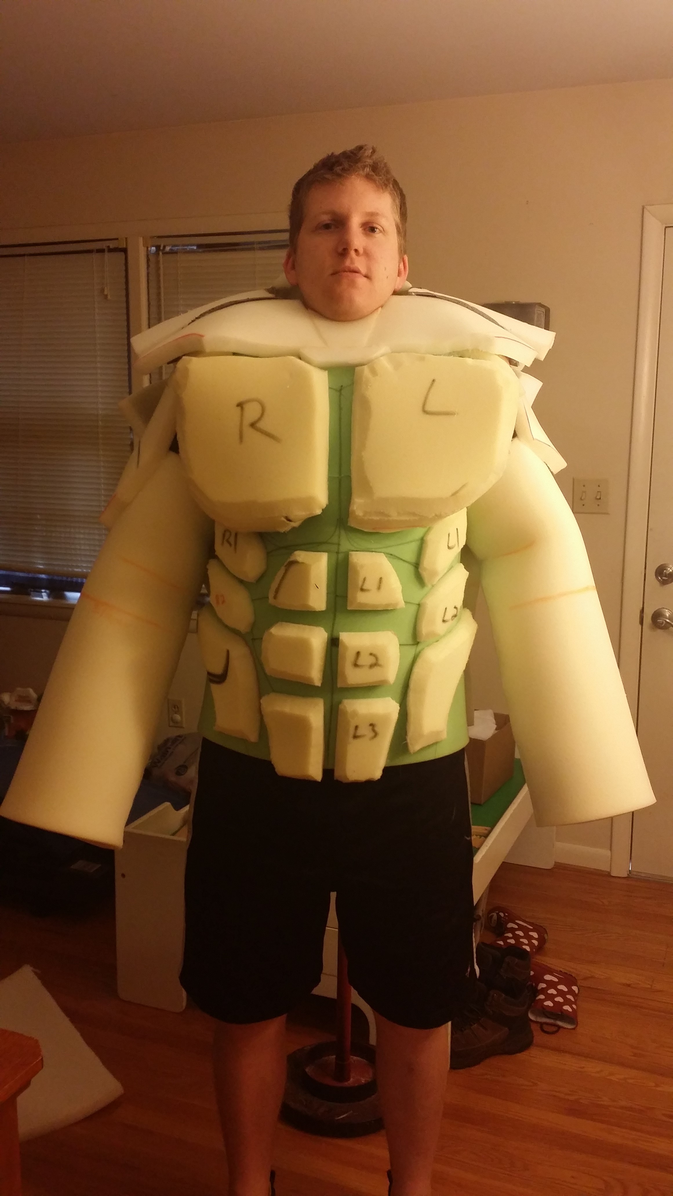

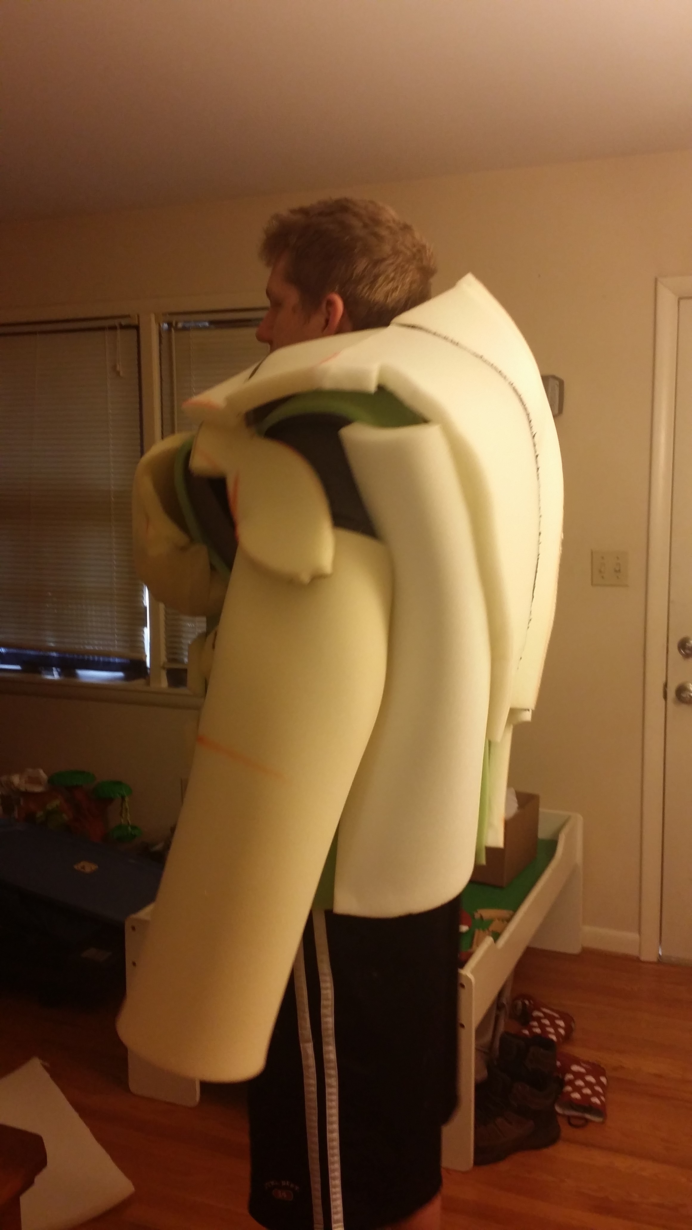

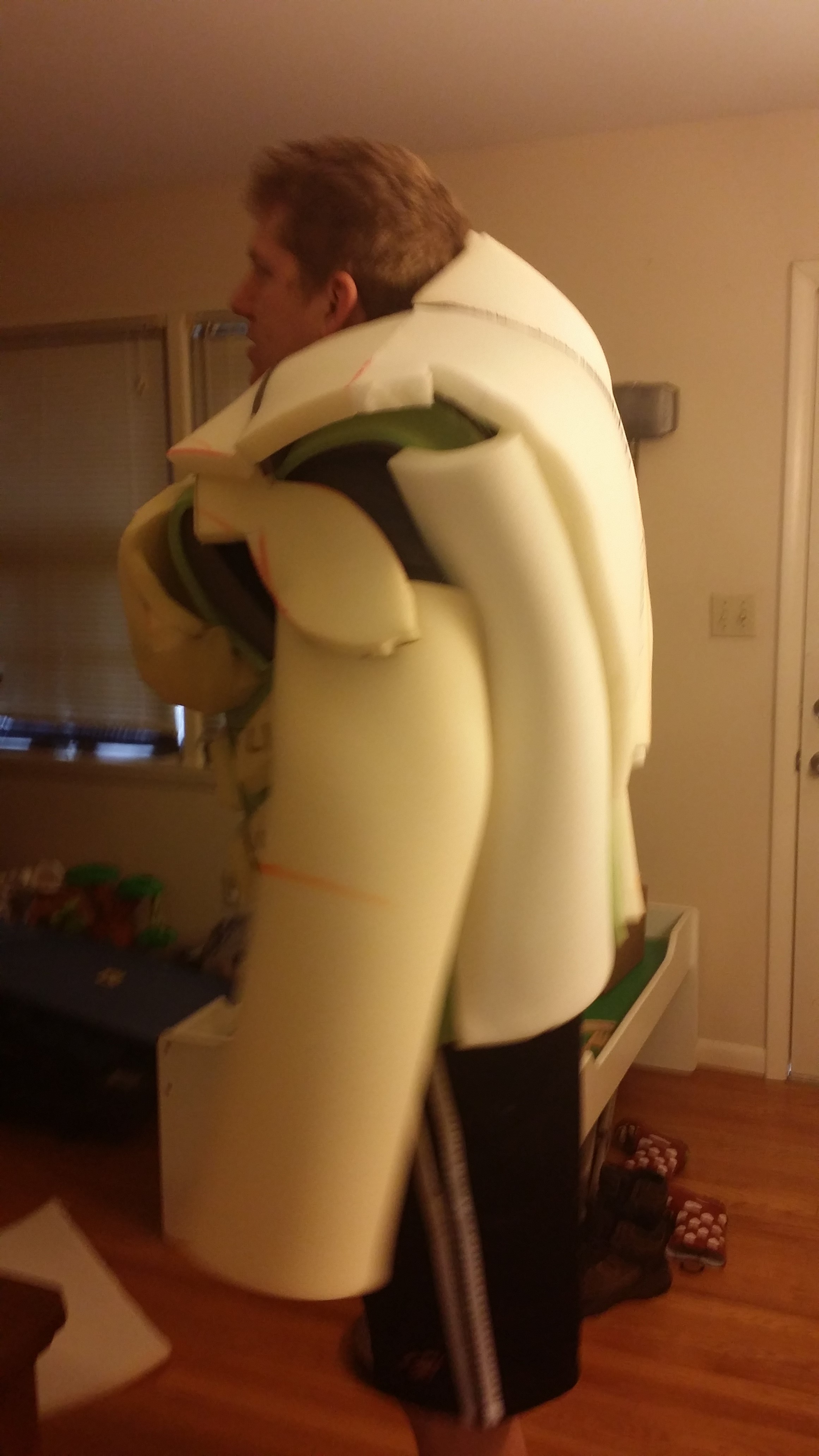

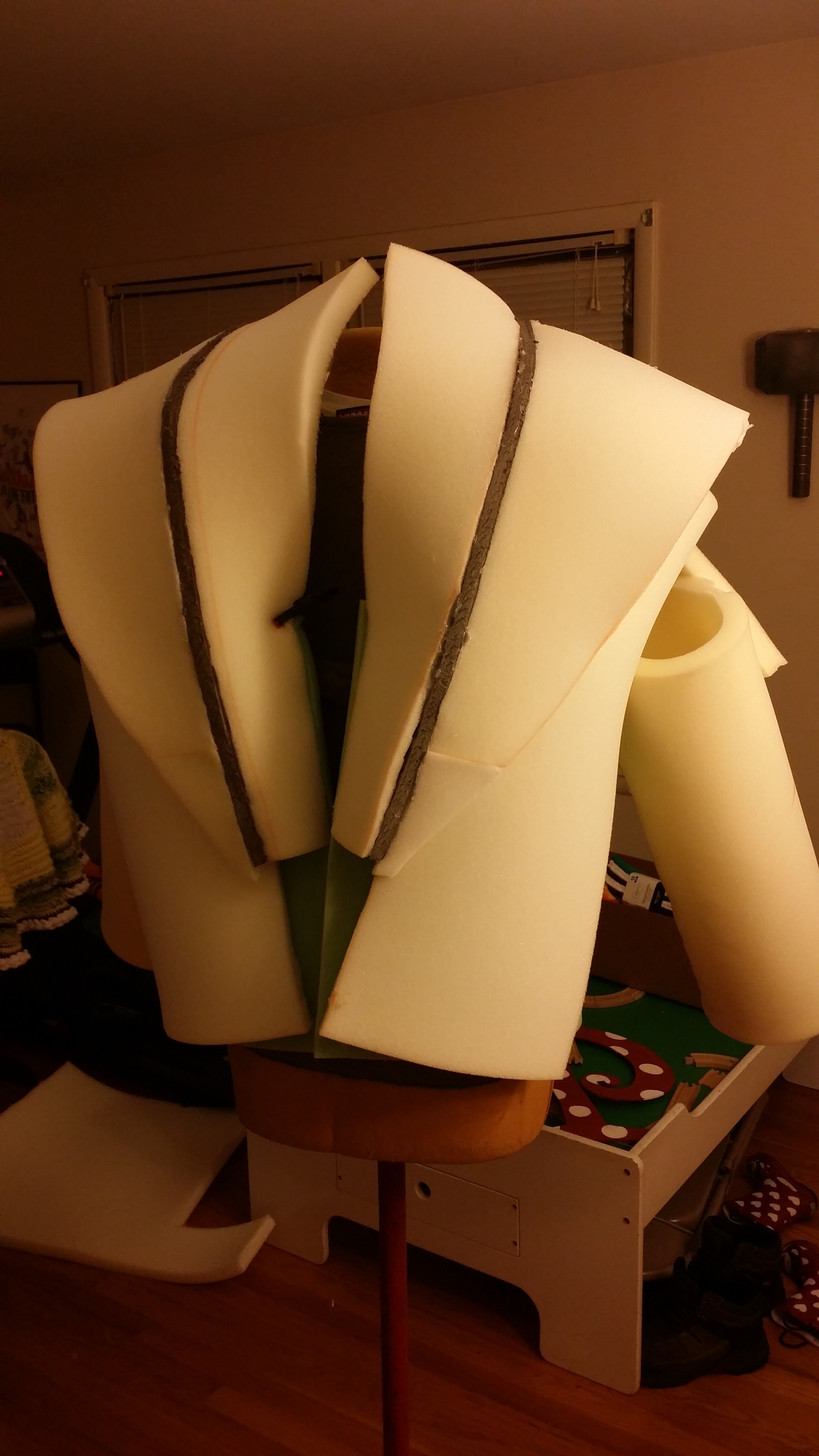

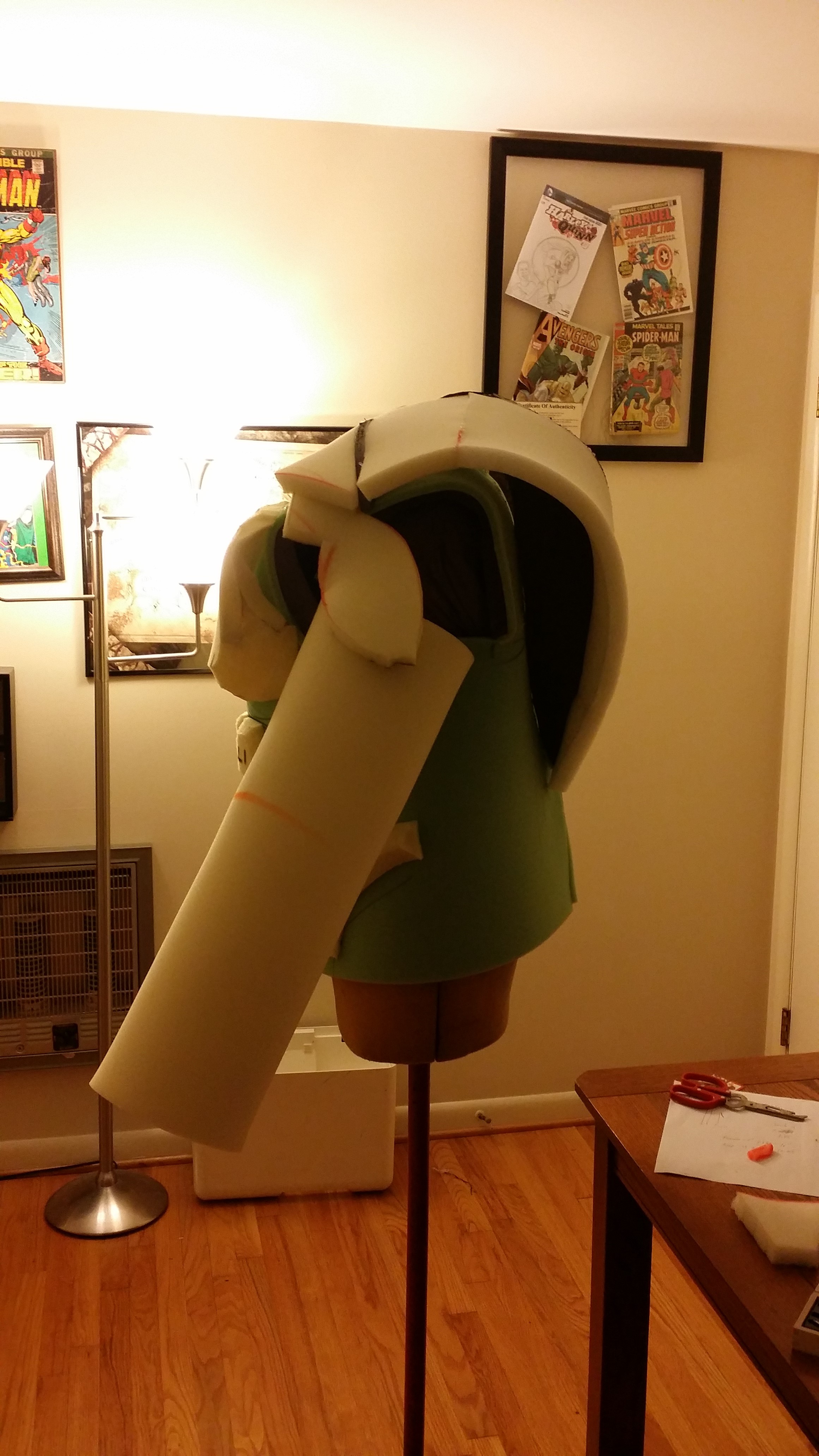

i adjusted the pecs more to the center and added the foam for the other shoulder (not trimmed yet) better closer warmer?
Way better. Look at anatomy drawings and you will improve the front of the armpit. The deltoid is also triangular and it should not (IMHO) come quite that far around to the front. That will free up your arm to swing forward at the shoulder while wearing the costume.
This is excellent work!

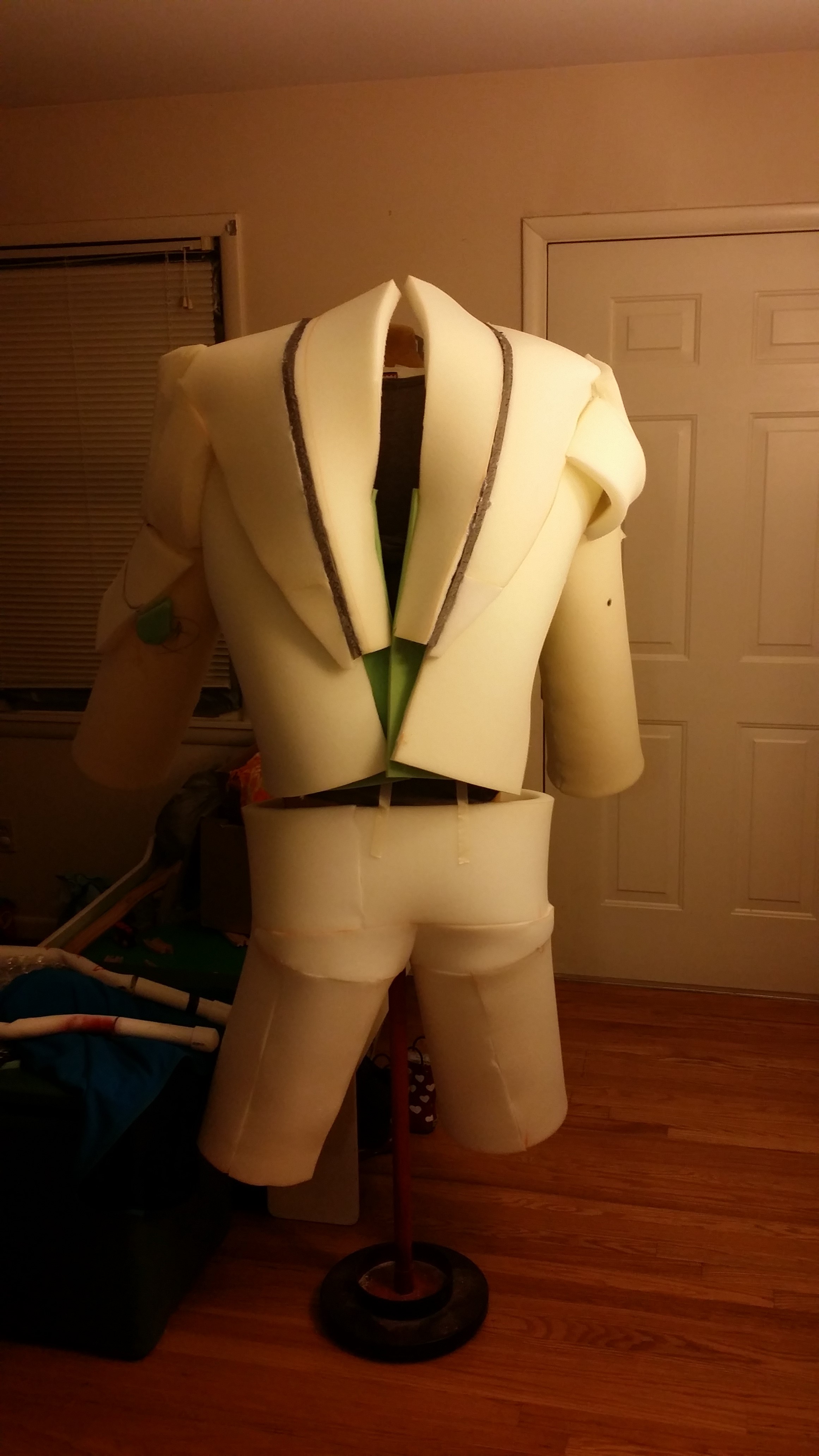

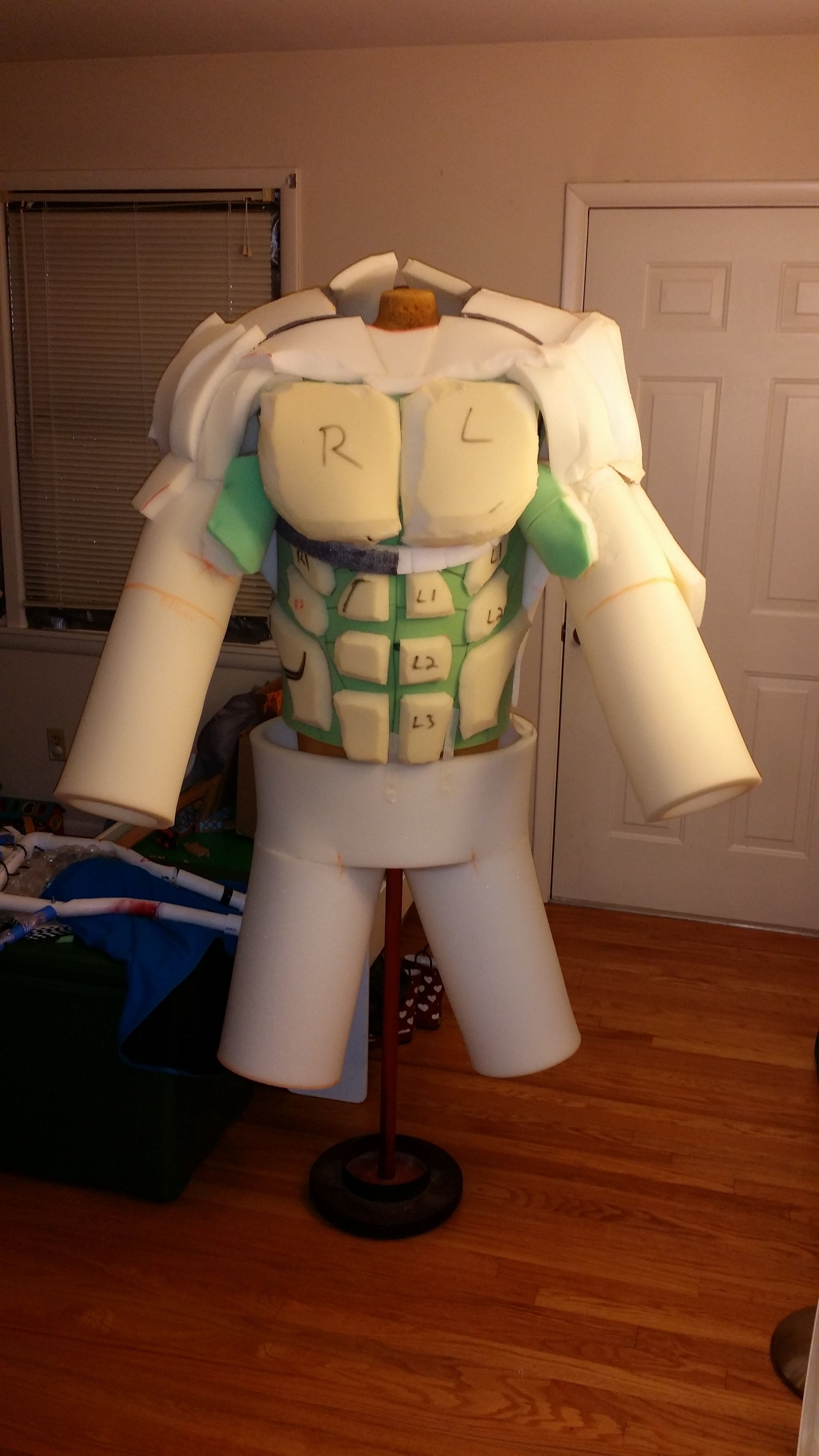

My progress for this weekend. I think I freed up enough room for the biceps. Started the lower torso (Which looks very sassy from the back). Hopefully I can get some more foam this week and have something I can walk around in by the end of the week! Thanks everyone for the help and keep the advice coming!
