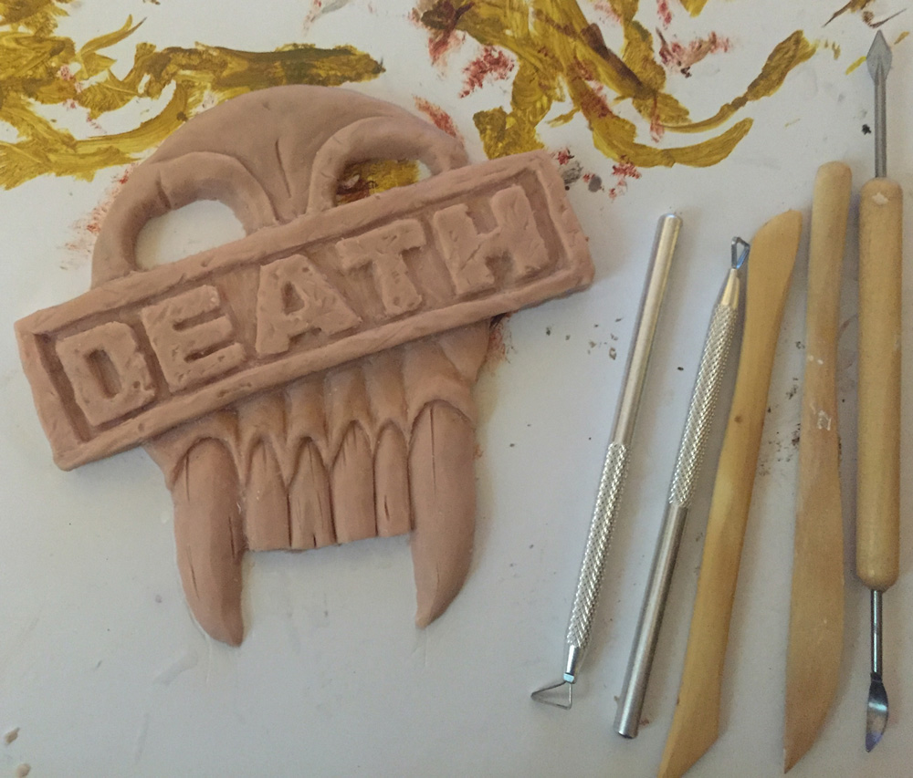

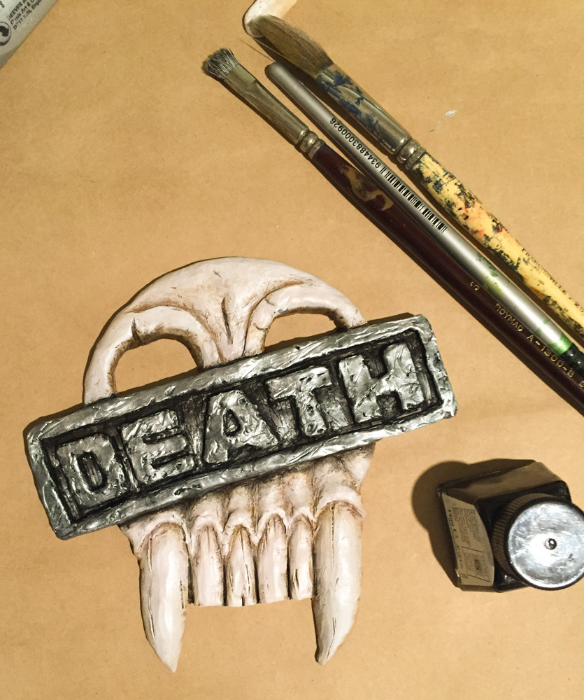

Starting with the badge: this is a pure Sculpey build. Most of the elements are painted using a combination 3 coats of Acrylic paint, from dark to light, then Ink wash to bring out shadows.

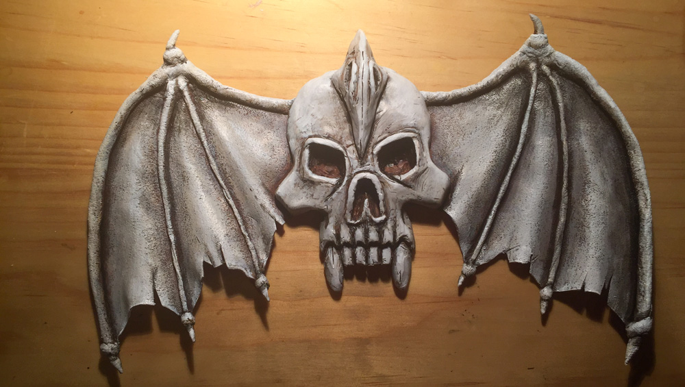

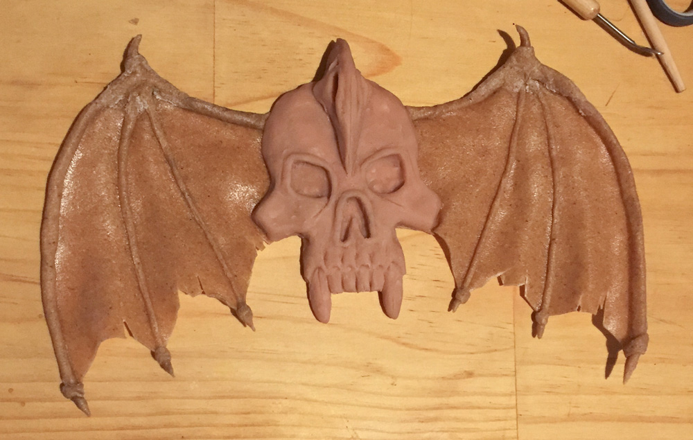

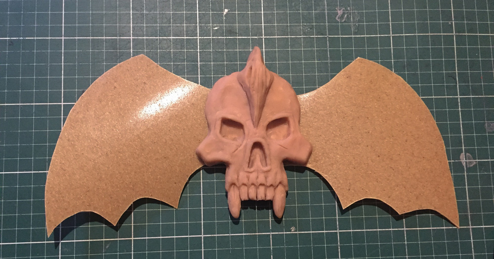

Belt Buckle: the build uses a combination of Sculpey for the skull and Warbla for the wings. This was my experience with Warbla, its very intuitive and easy to work with.

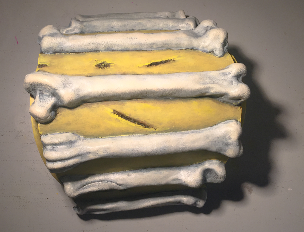

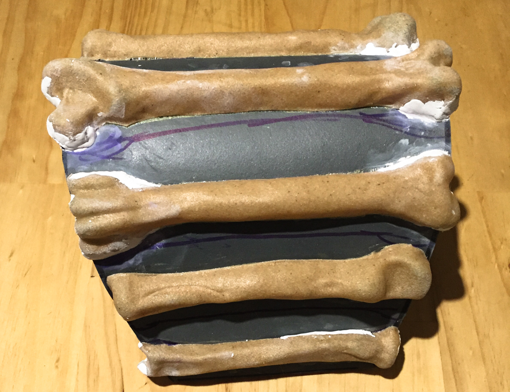

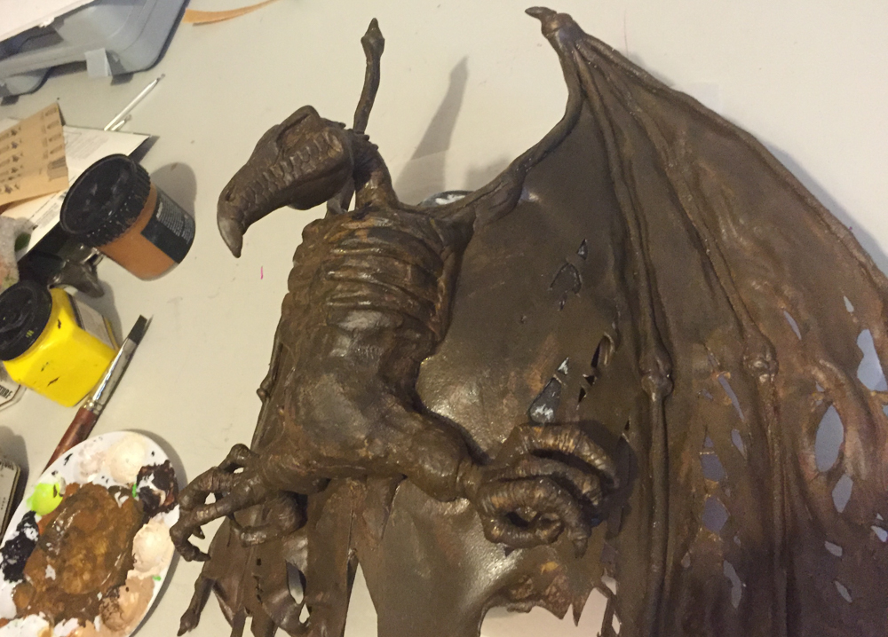

Right Shoulder: This was the most complex so far and is a combination of Warbla, Sculpey, Miliput (epoxy clay) and craft foam.
shoulder-3.jpg shoulder-7.jpg shoulder-9.jpg shoulder-11.jpgshoulder-13.jpg shoulder-17.jpg shoulder-18.jpg

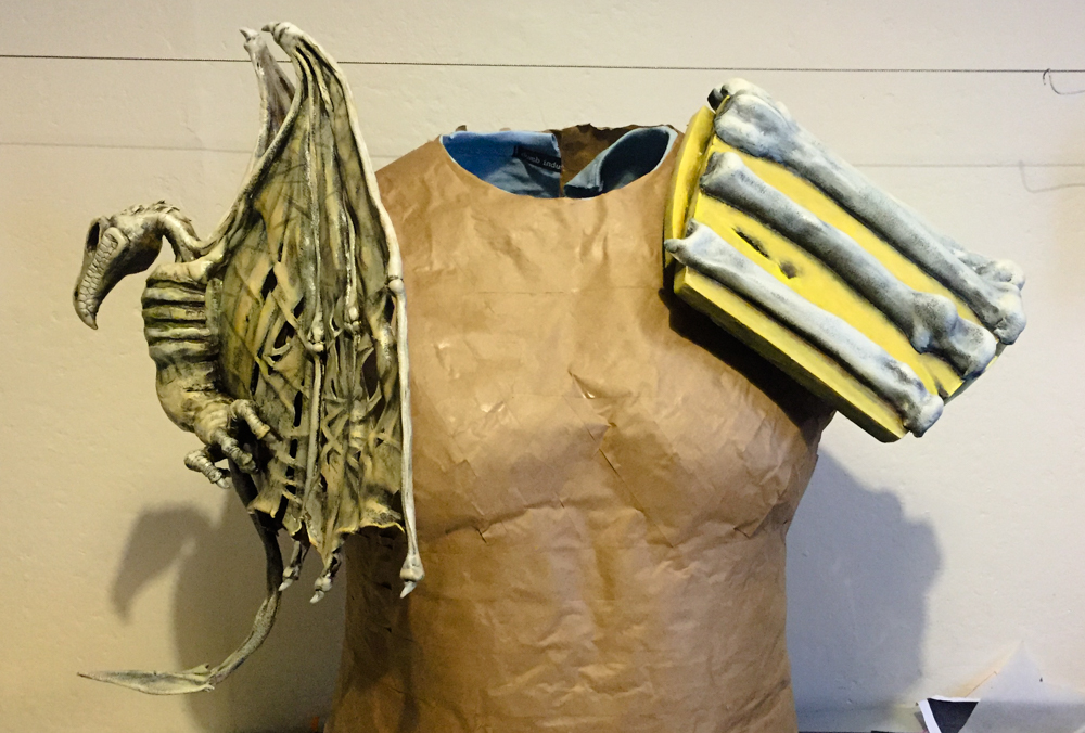

Left Shoulder: Constructed with EVA Foam base; The bones were first made with a soft molding clay, I then cut and heated Worbla and gently pressed the heated material over the clay that was then scraped out once cooled; Contact Cement was used to bond the bone shells to the EVA Foam base and Miliput was shaped over to fill any gaps; Finally the usual acrylic paint and ink treatment was applied.
shoulder2-1.jpgshoulder2-2.jpgshoulder2-5.jpgshoulder2-6.jpgshoulder2-7.jpgshoulder2-8.jpg

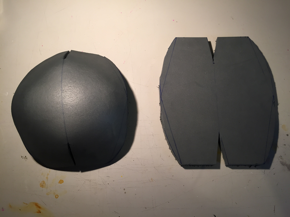

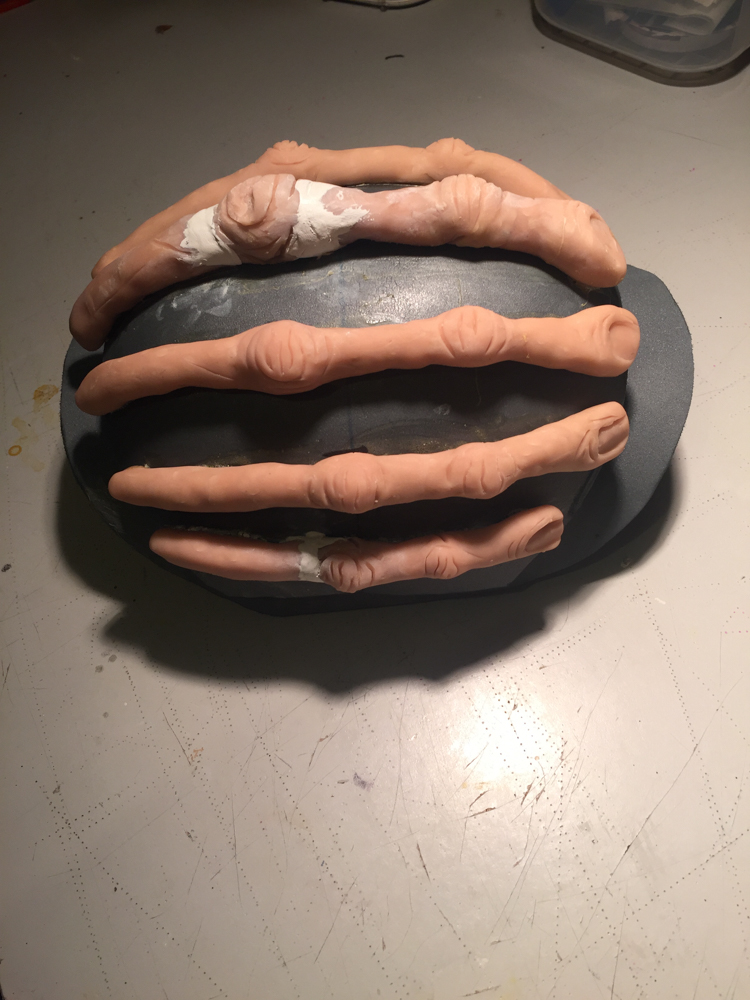

Elbow pads..
The first shot is the before and after shaping of the EVA foam dome piece, the next are the shaped dome pieces and the underlay, they were then fused together with Contact Cement.

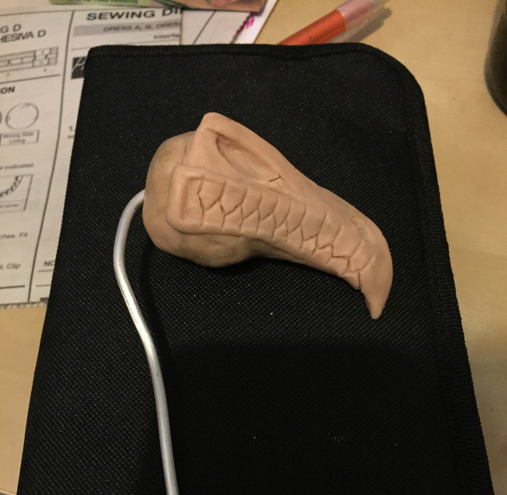

I was going to use the same Worbla method as the bones on the shoulder pad to make the fingers on this build. Unfortunately the fact that the fingers needed to have a fairly precise curve meant that I could not. Instead I used Sculpey with foil inner. Once they were baked I test placed them on the pad. You can see on the 4th pic that some breaking and remolding with Miliput had to be done to get the fingers fitting perfectly, once they did I used Contact Cement to glue them in place.
After the first coat of paint was applied I cut and applied Worbla for the finger nails. Then finished off with 2 more coats of paint, some dirty ink effects and a Mod Podge coat.
shoulder2-1.jpgshoulder2-2.jpgshoulder2-3.jpgshoulder2-4.jpgshoulder2-5.jpgshoulder2-6.jpg
