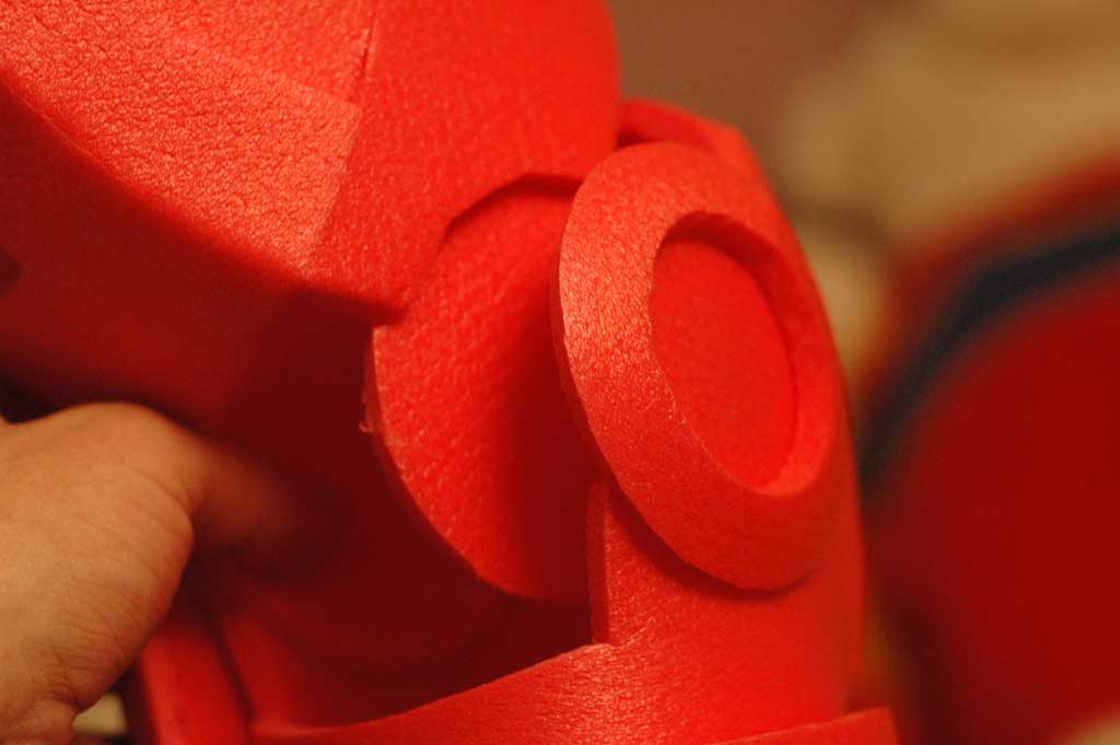

2 - Regarding the elbow bolt on your Mark VII - I've looked at the pictures of the suit you've put together, but can't tell; did you make that a complete piece, or did you do the interior circle and out ring as two separate pieces?
Well, the large inner circle is attached to the lower biceps, and both center and ring circles are attached together to the upper forearm. Pic :
On this one, the elbow is motionless and attached to the ring with the upper forearm. But here it's all up to you...

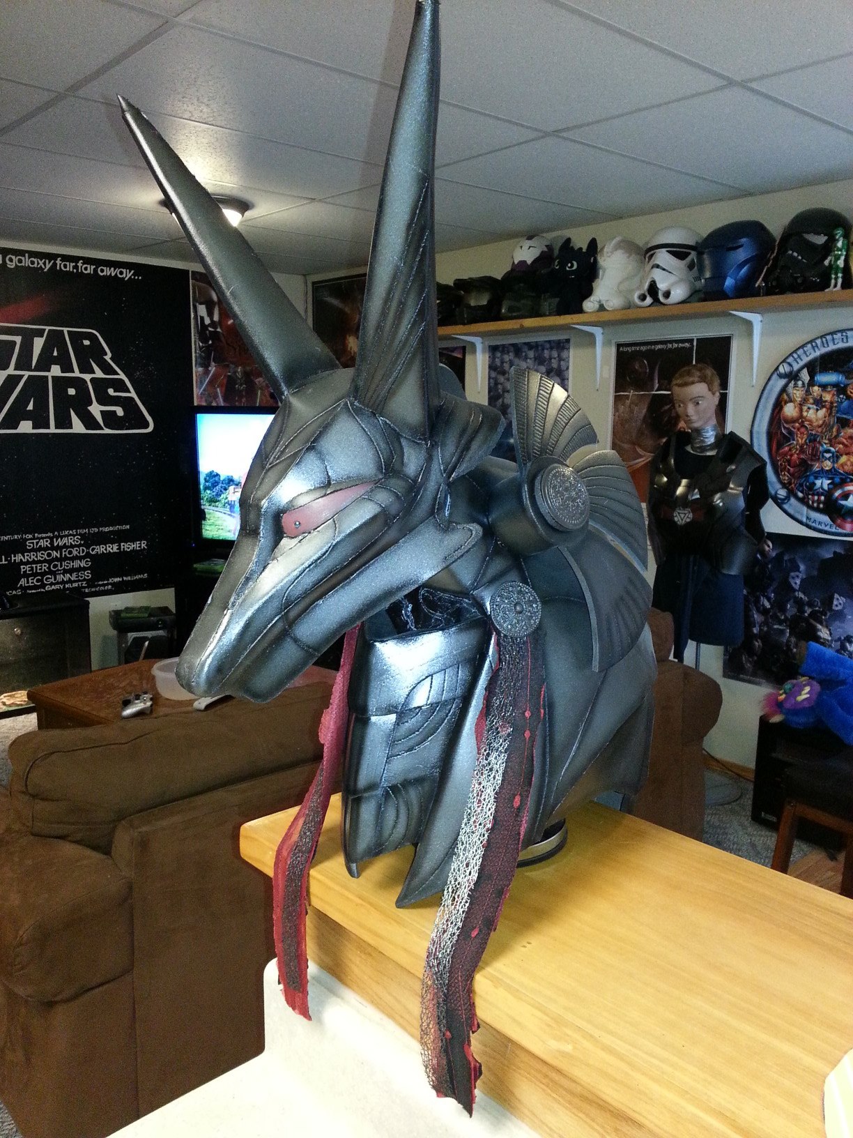

Seems like I didn't post this.... must be over due since the Horus (chirp) one's are popping up everywhere, time for an Anubis. With everyone asking for templates, this is what JFcustom templates come out as. Of course details are free to interpretation.
