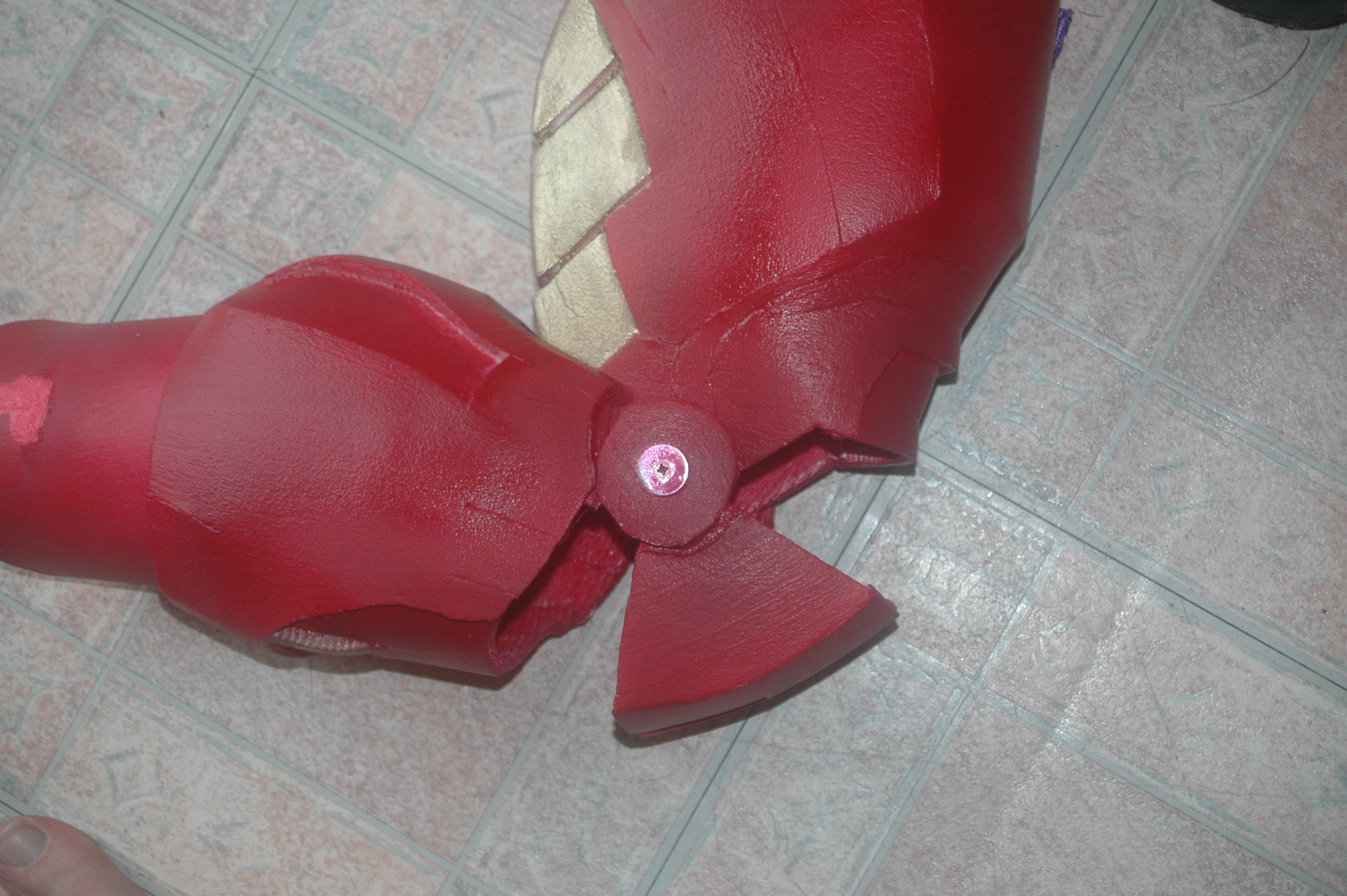

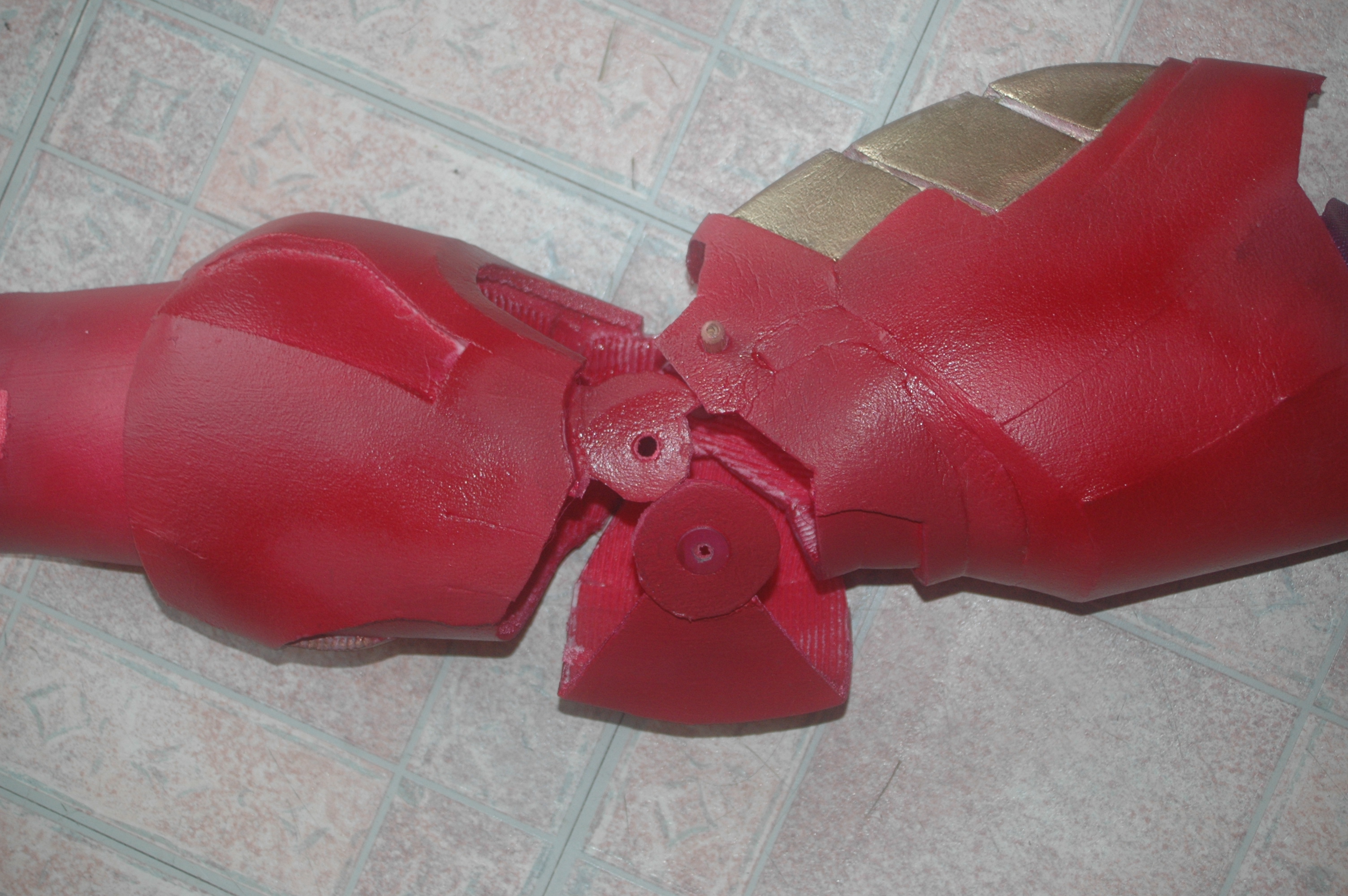

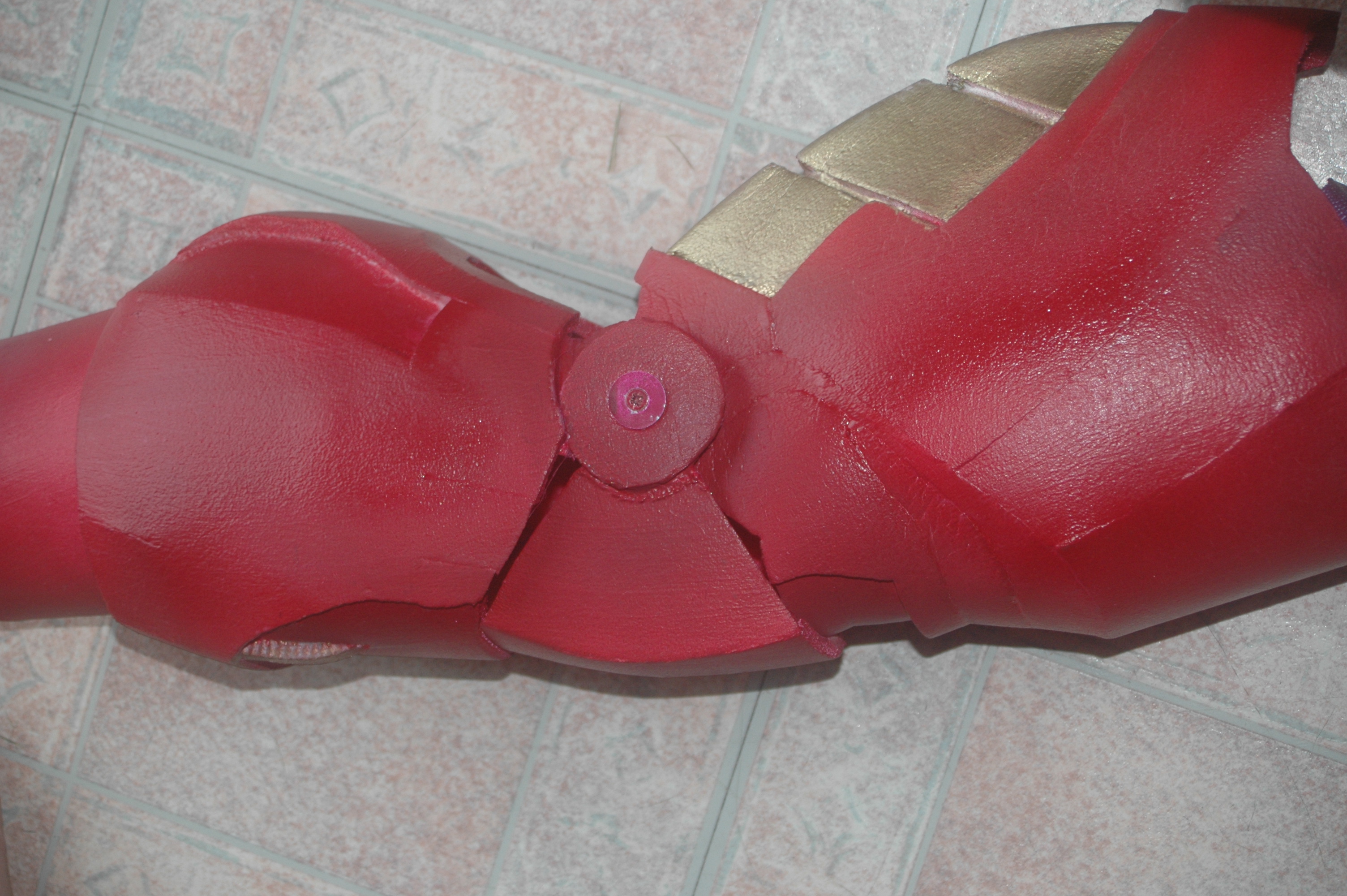

I figured it out last night. It wasn't the scale that was the problem, it was a mistake on my part. When I was gluing the "elbow pad" the top back part of the fore arm up, I cut 2 45 degree angles and ended up gluing the sides at a straight 90 degree angle. after looking at the pep model again I noticed its a compound bend. The first is outward at about 45degrees then another bend. When I did this the width came out perfect. Just wish I had seen that befor cutting the entire forearm out and wasting a lot of foam. Oh we'll, lesson learned!

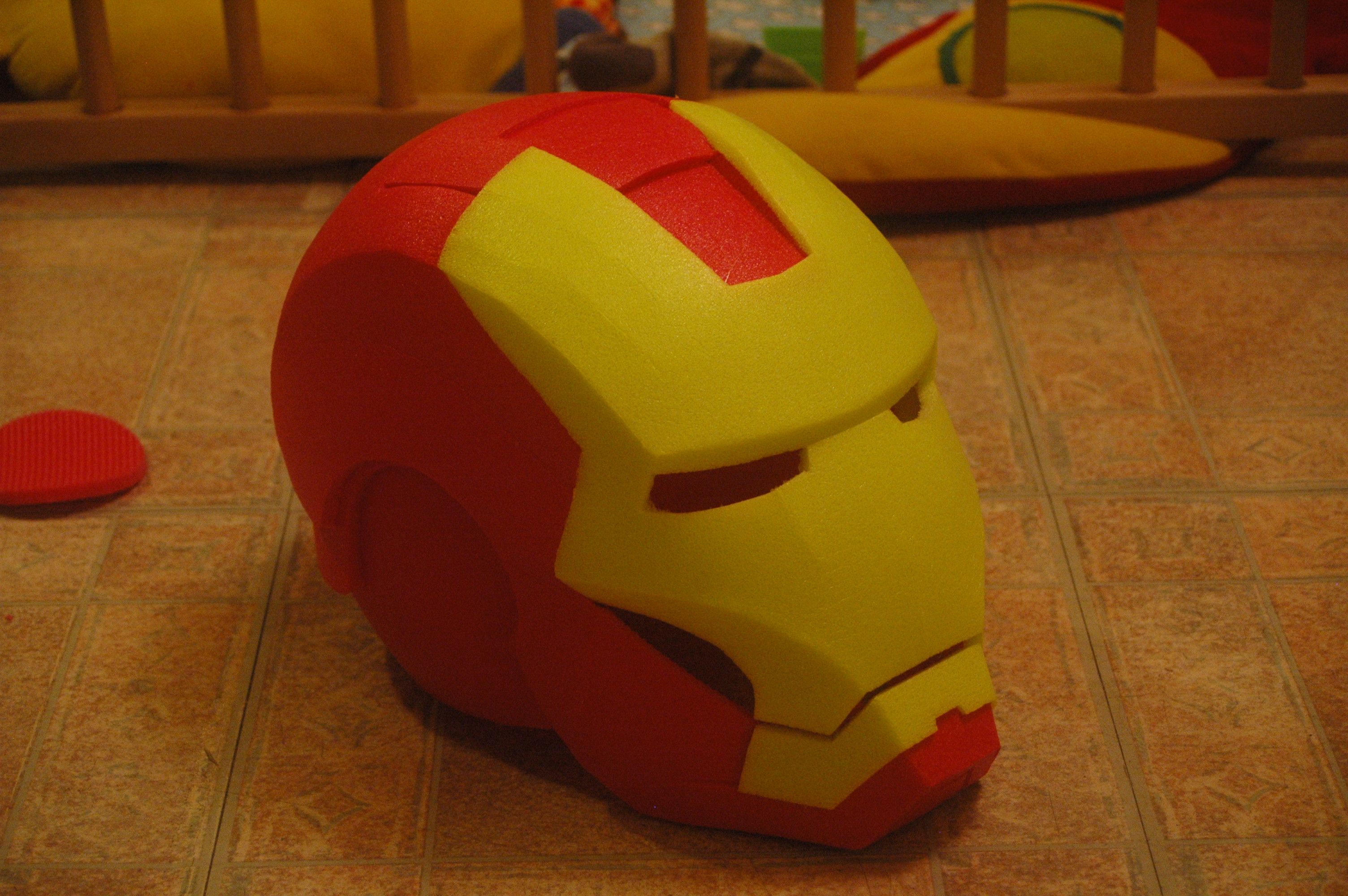

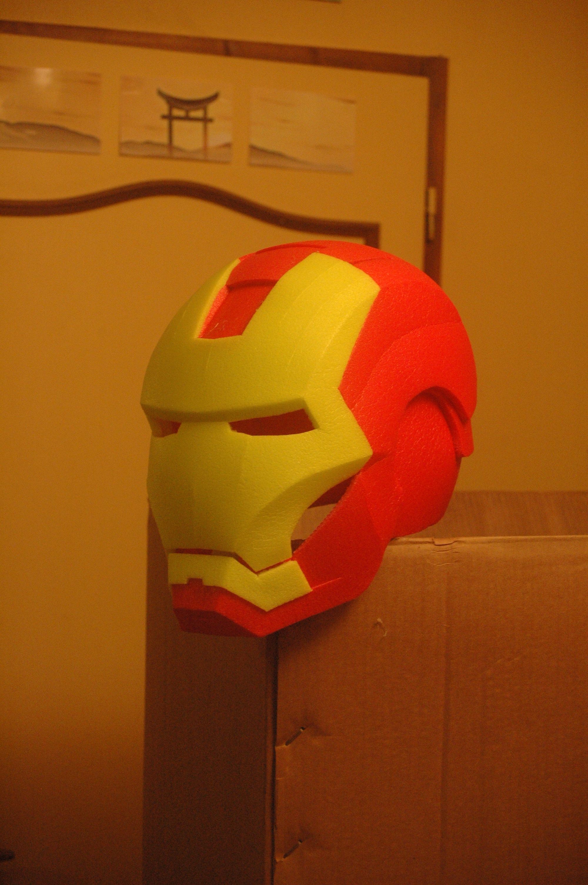

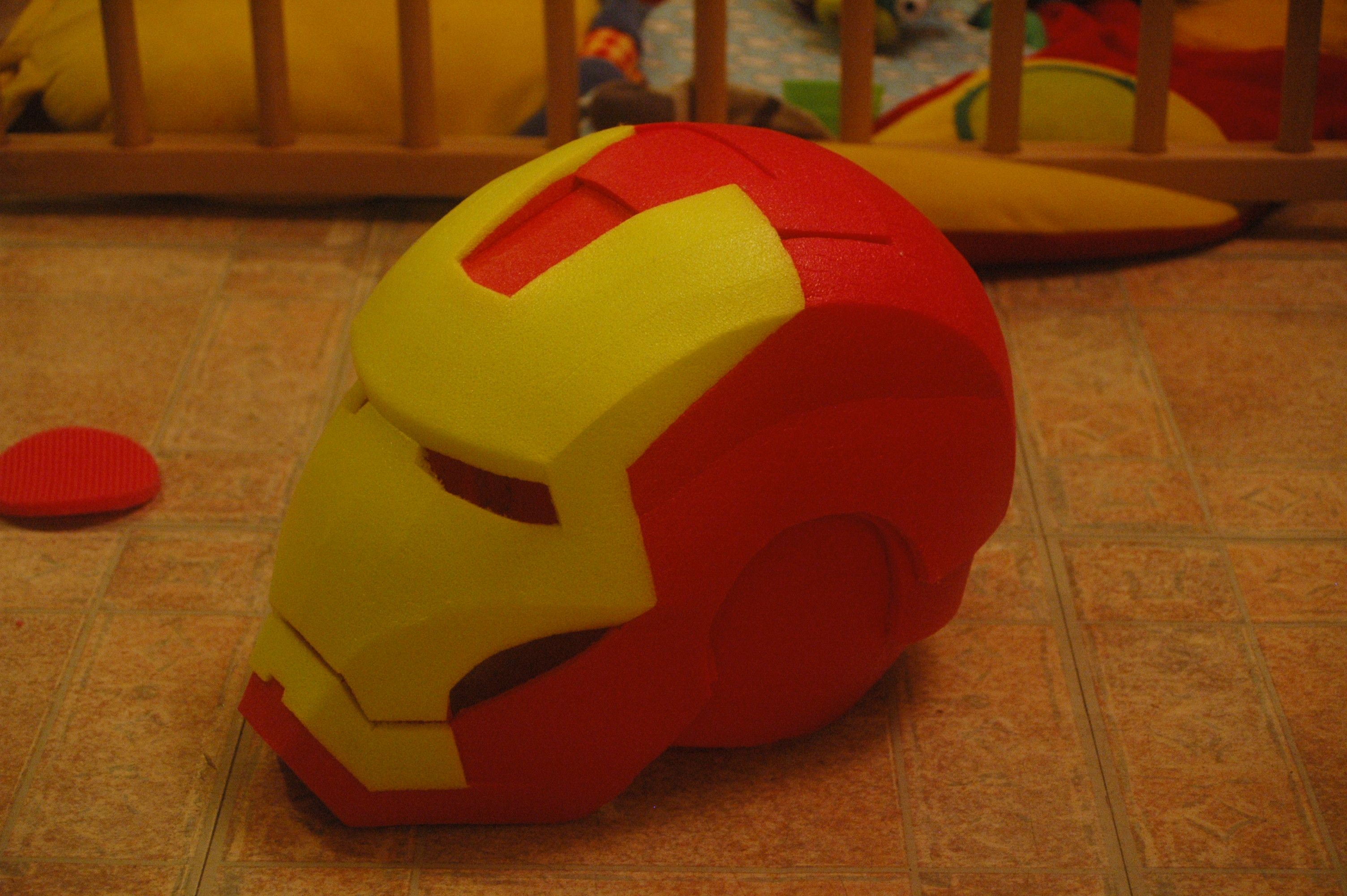

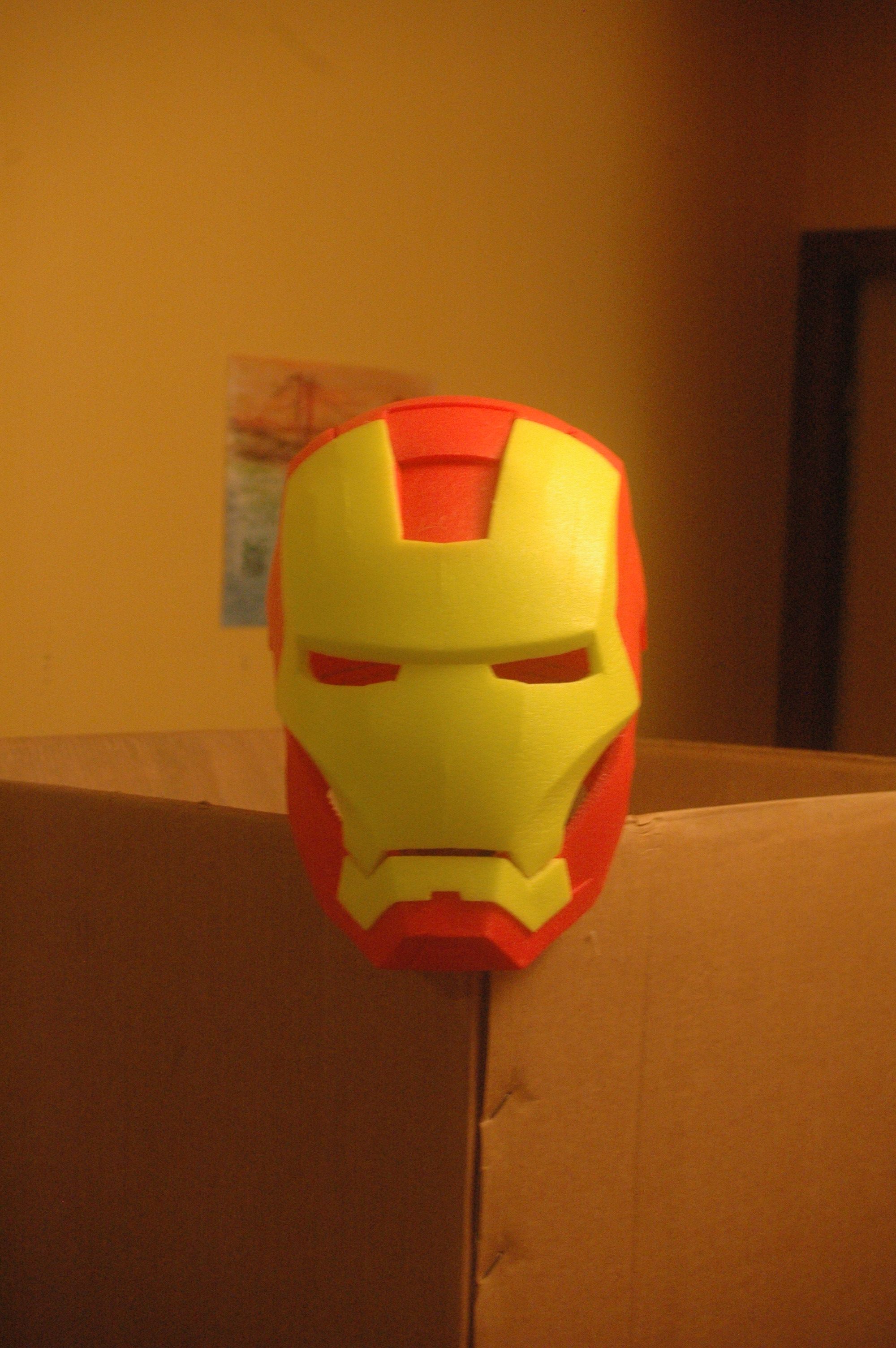

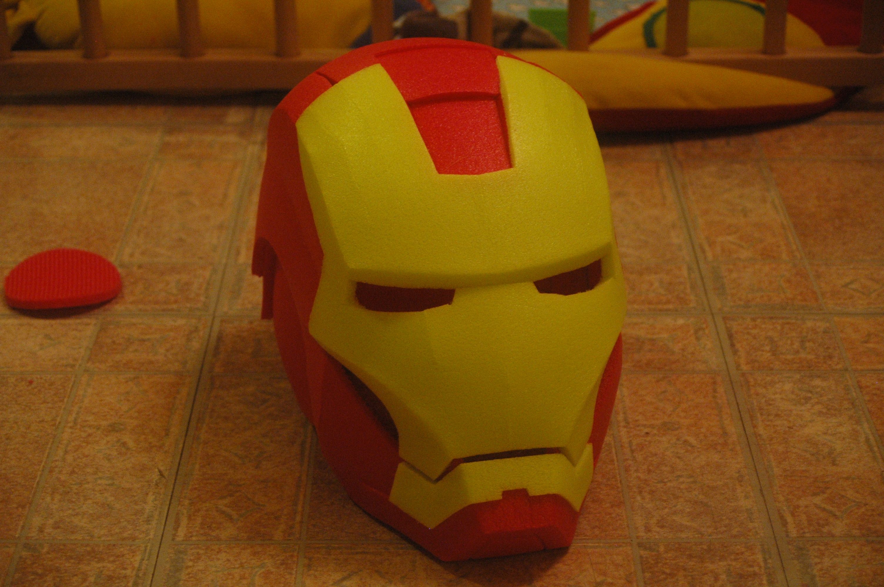

And to both solve the issue of the lower eyes that happen to bulge way out, as described here, and improve the details of the ears area, here's an enhanced unfolding version of Sharkhead's Iron Man Helmet :
Sharkhead7854-ironman-helmet-foam-unfold-by-JFcustom.pdo
JF that helmet is amazing. I'd ask how you do it... but I kind of see it...I just can't fathom it haha
thanks for all of your input, and your edits!
you are truly a master of the foam. great work as usual!

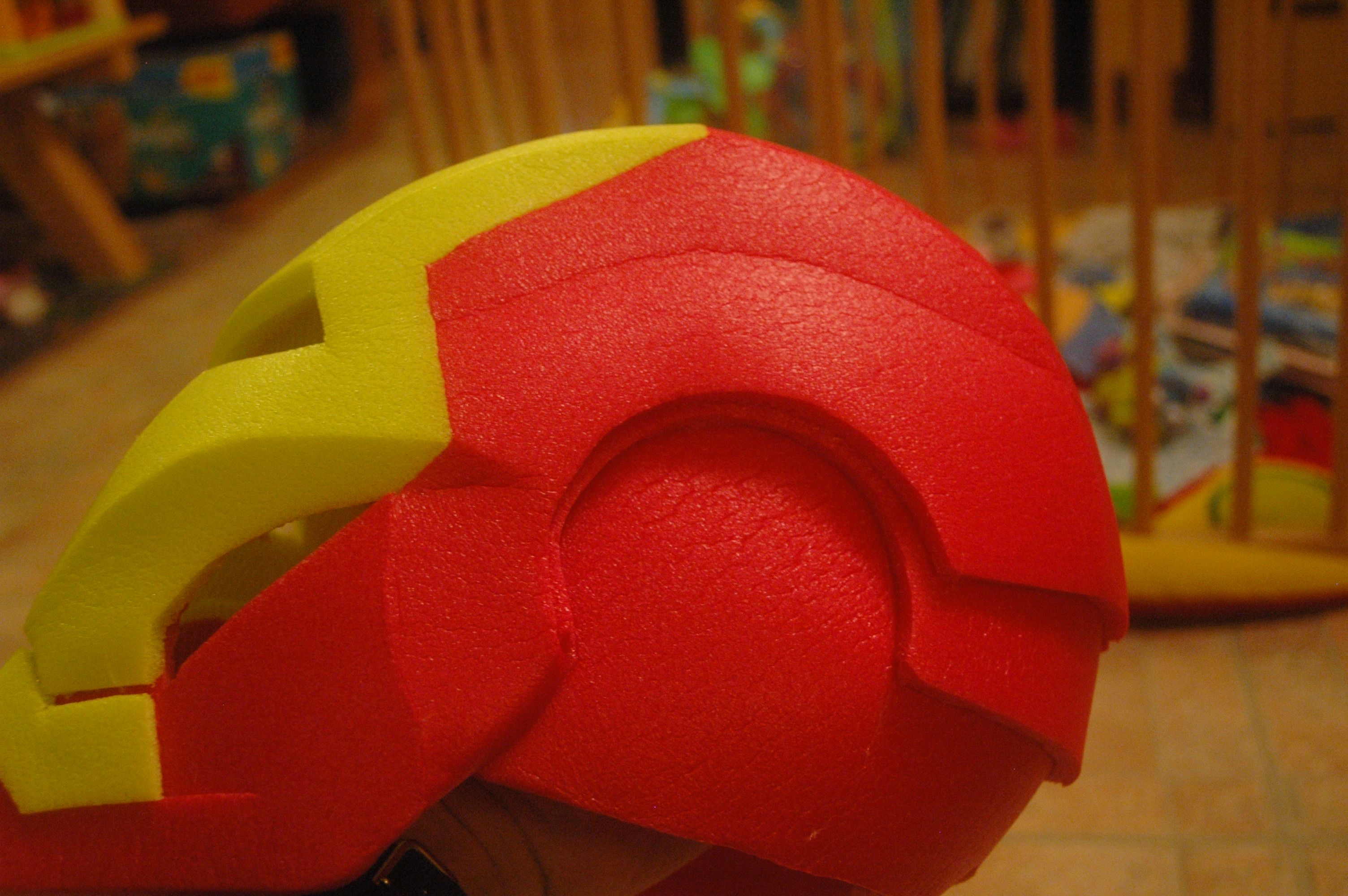

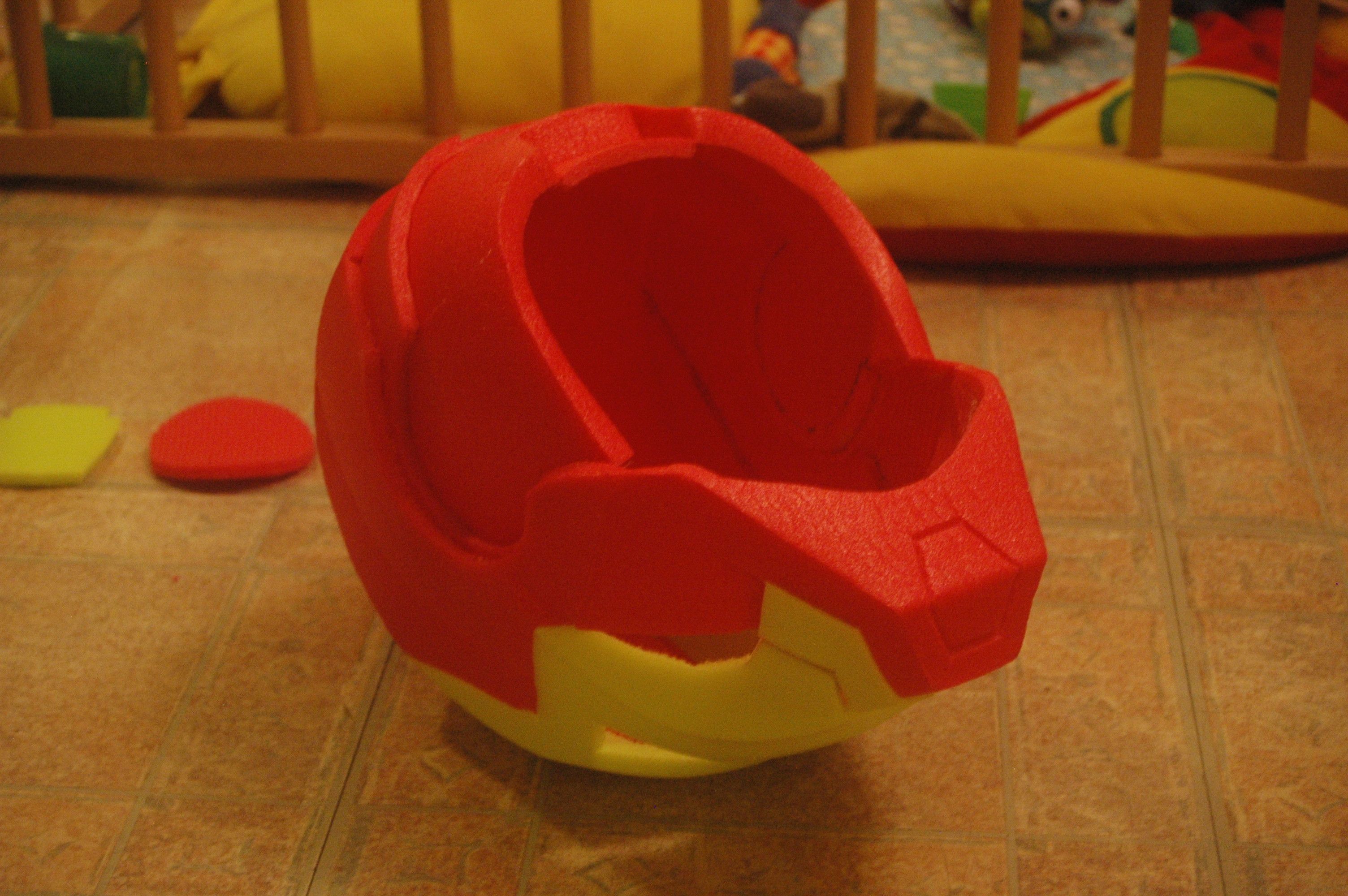

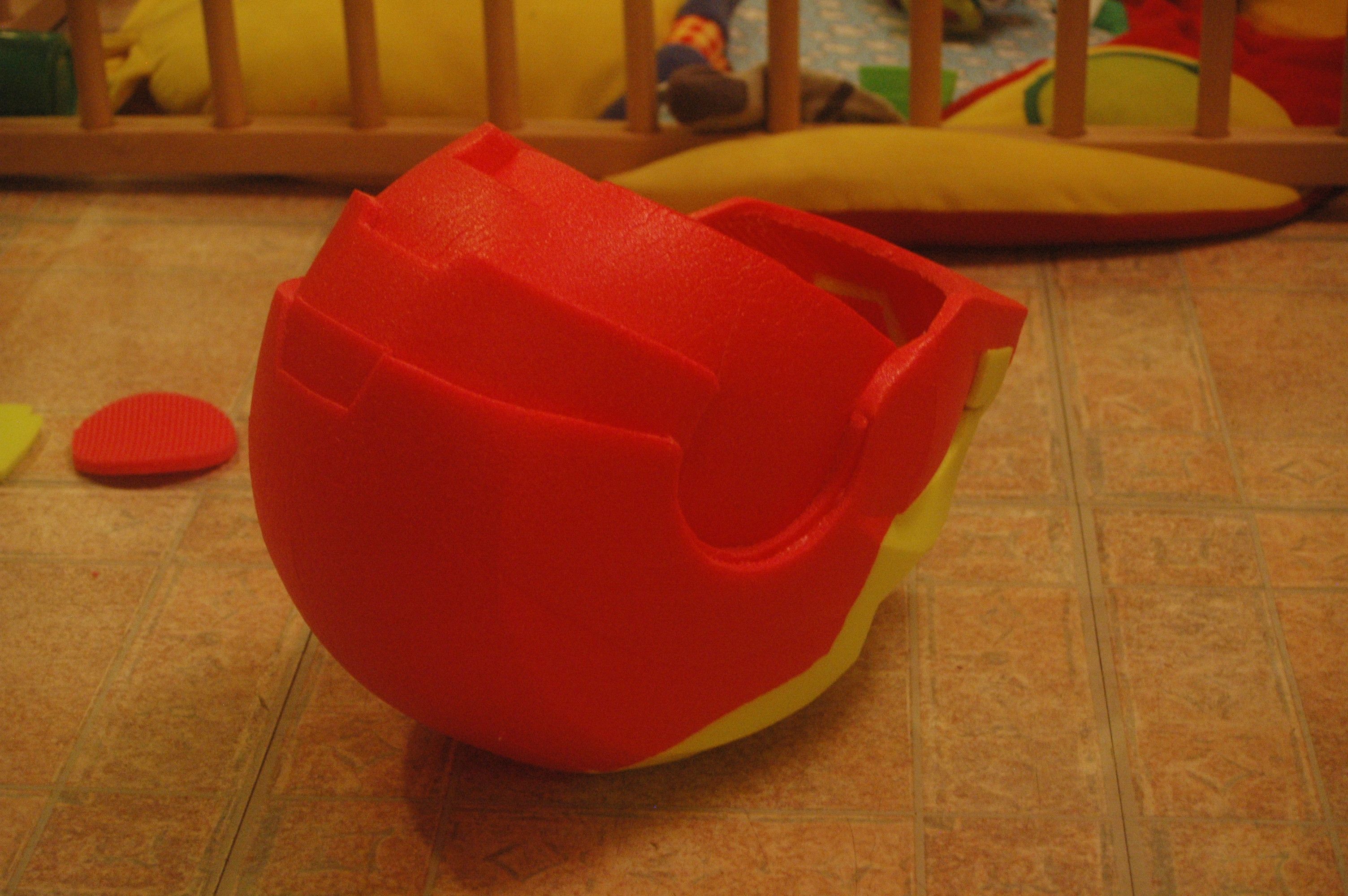

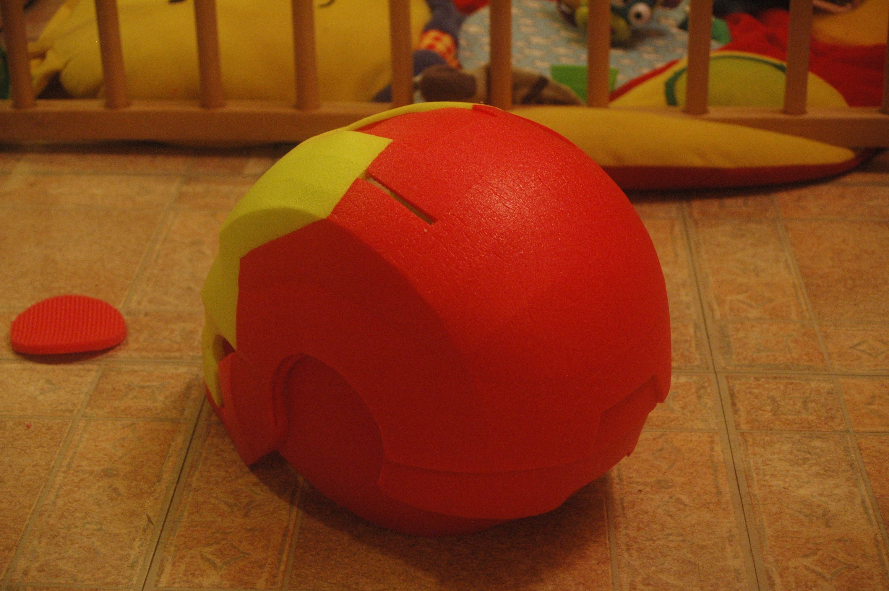

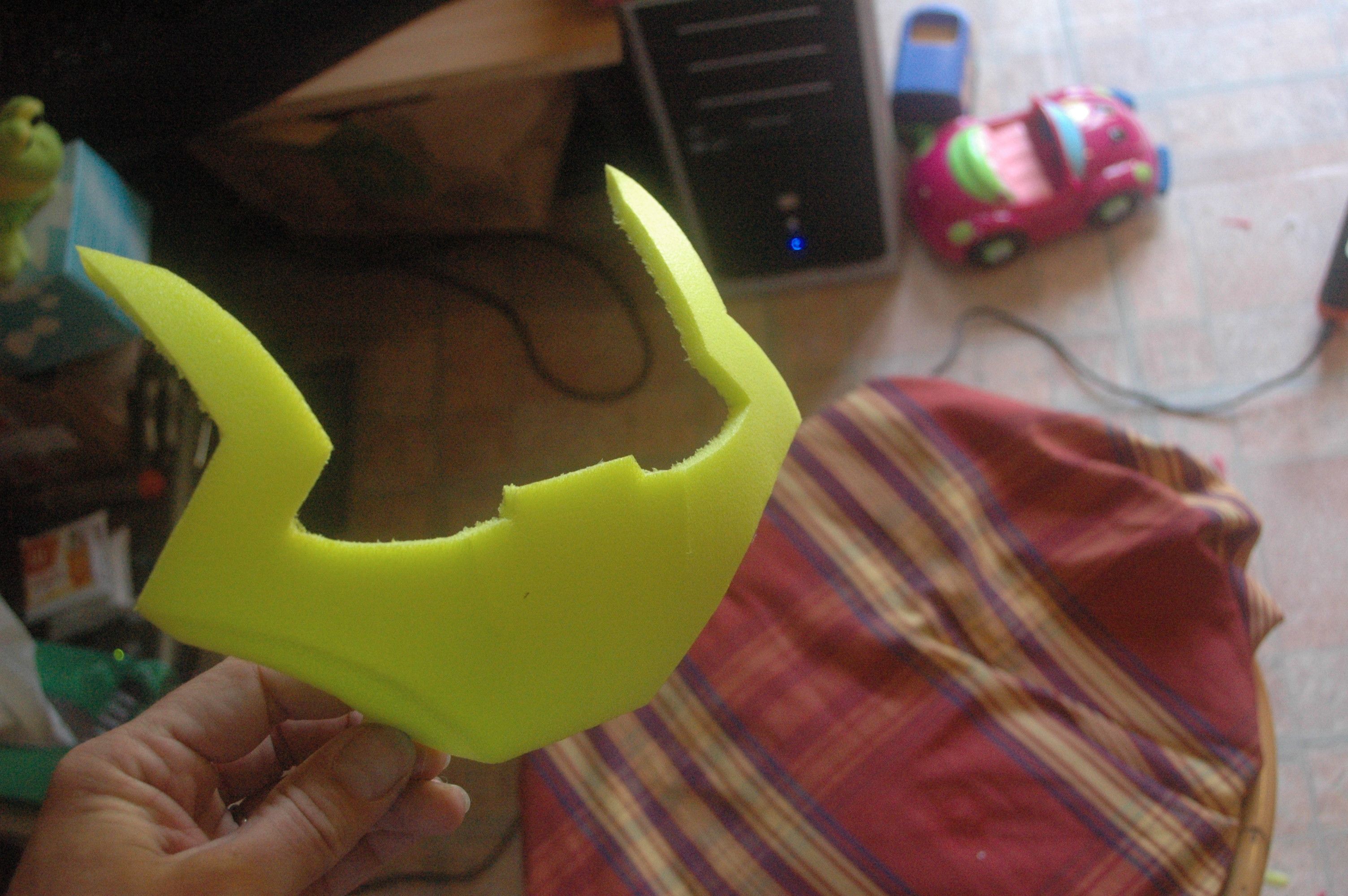

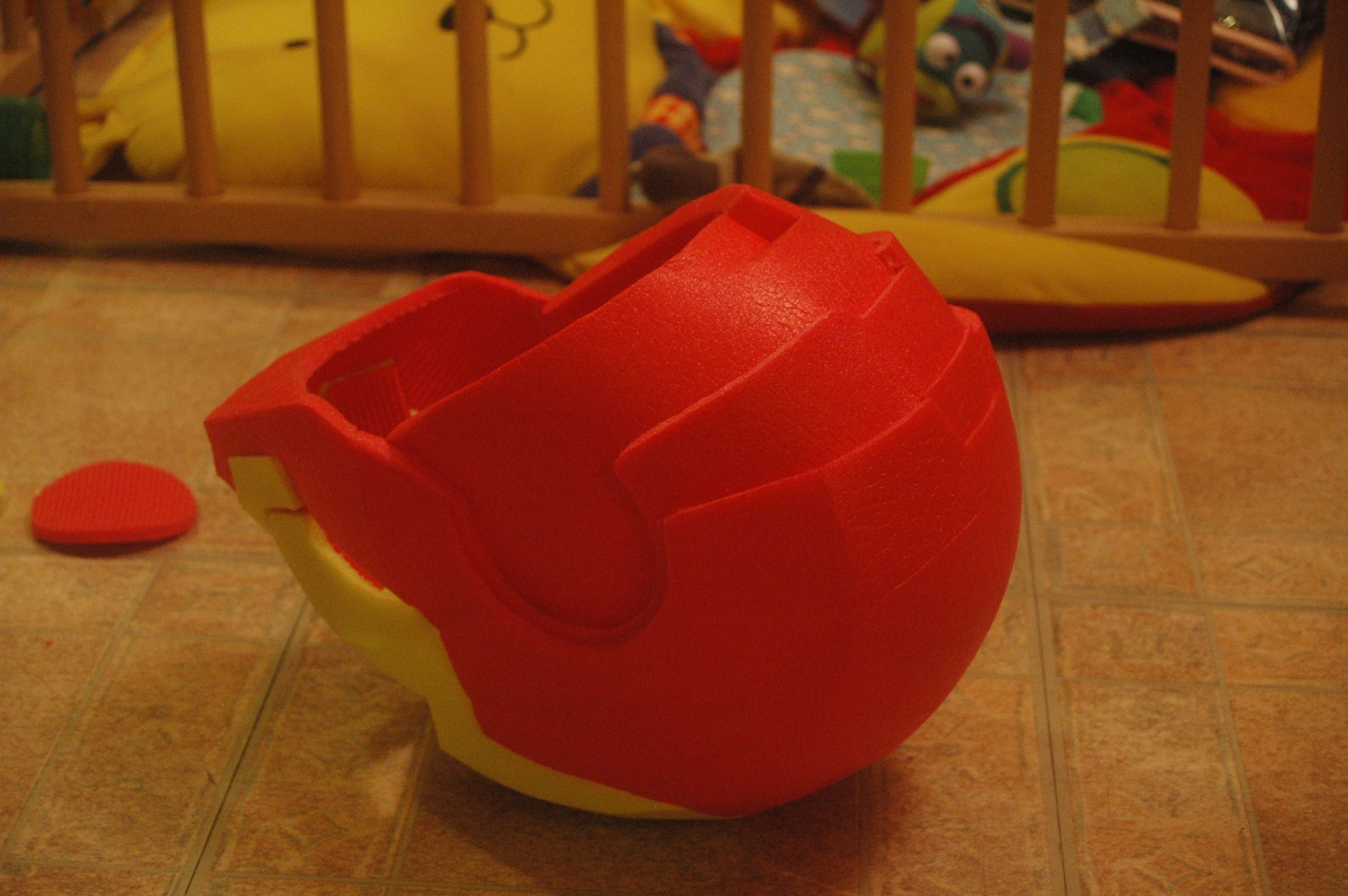

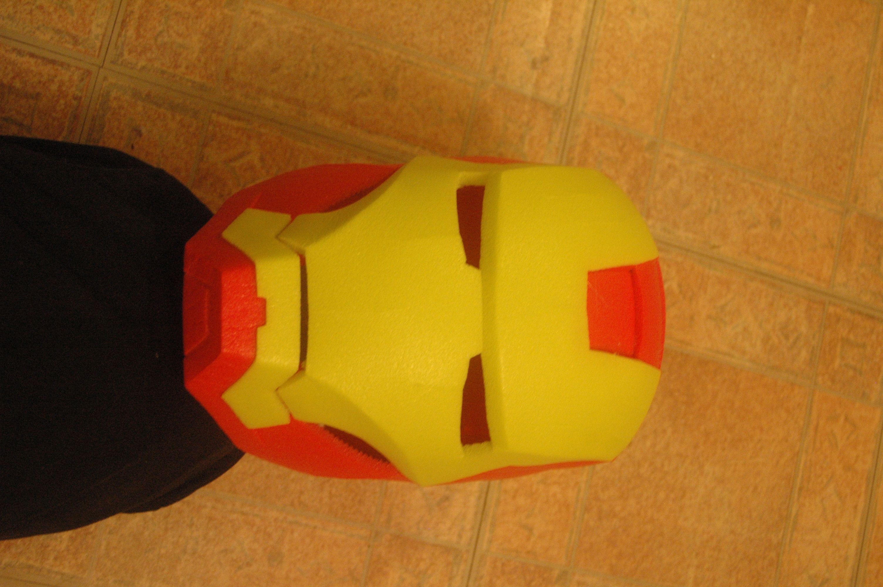

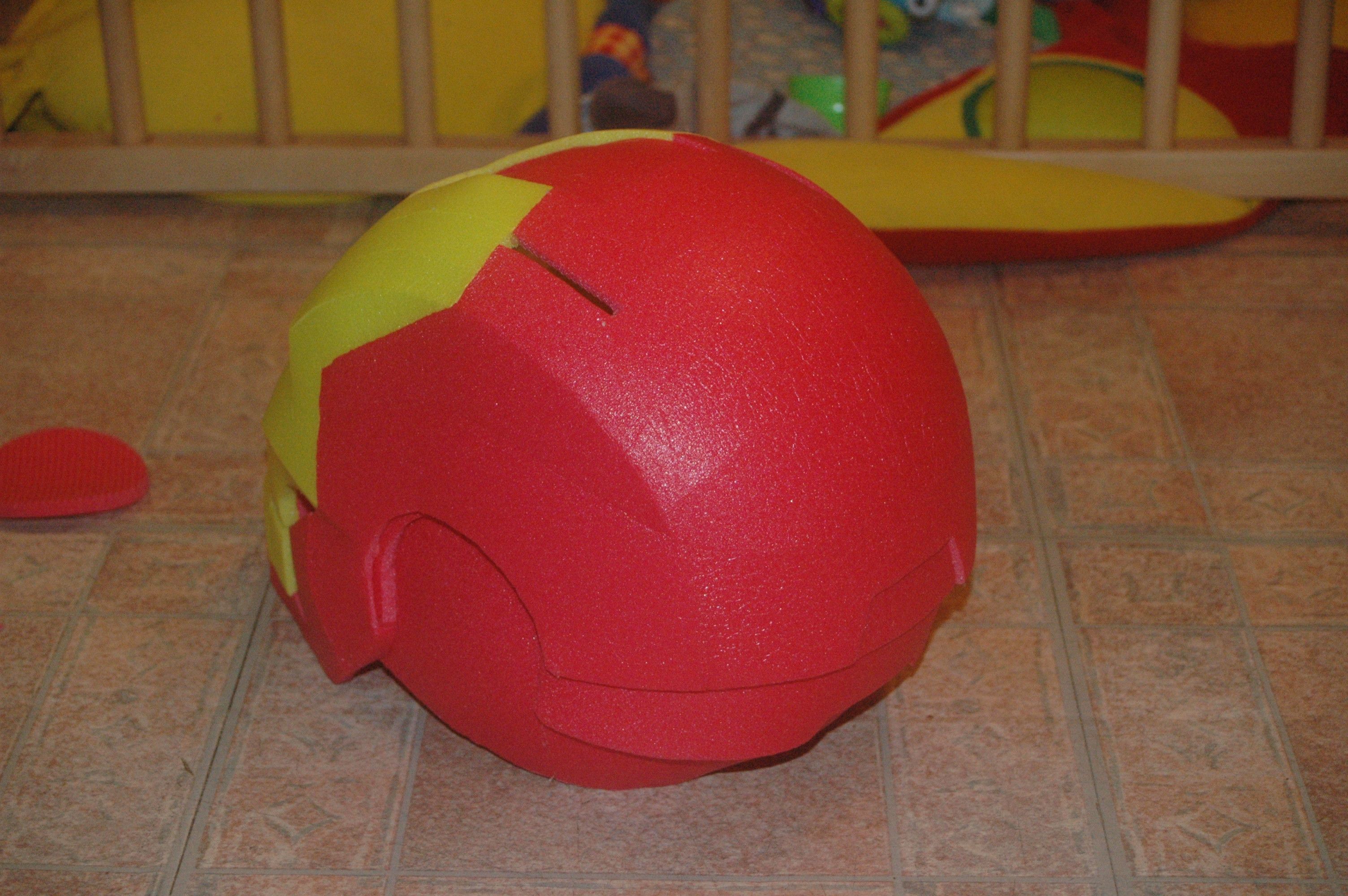

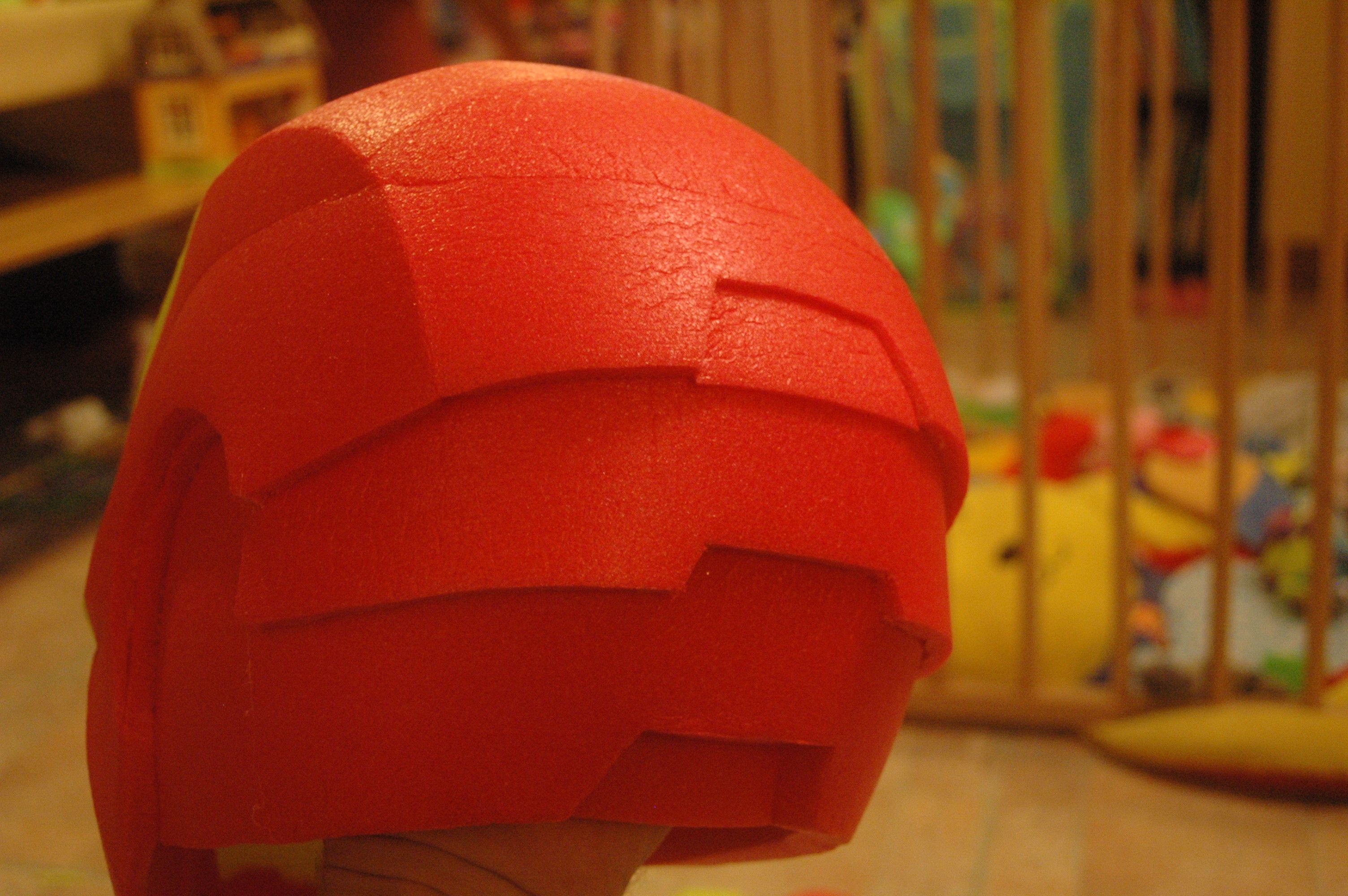

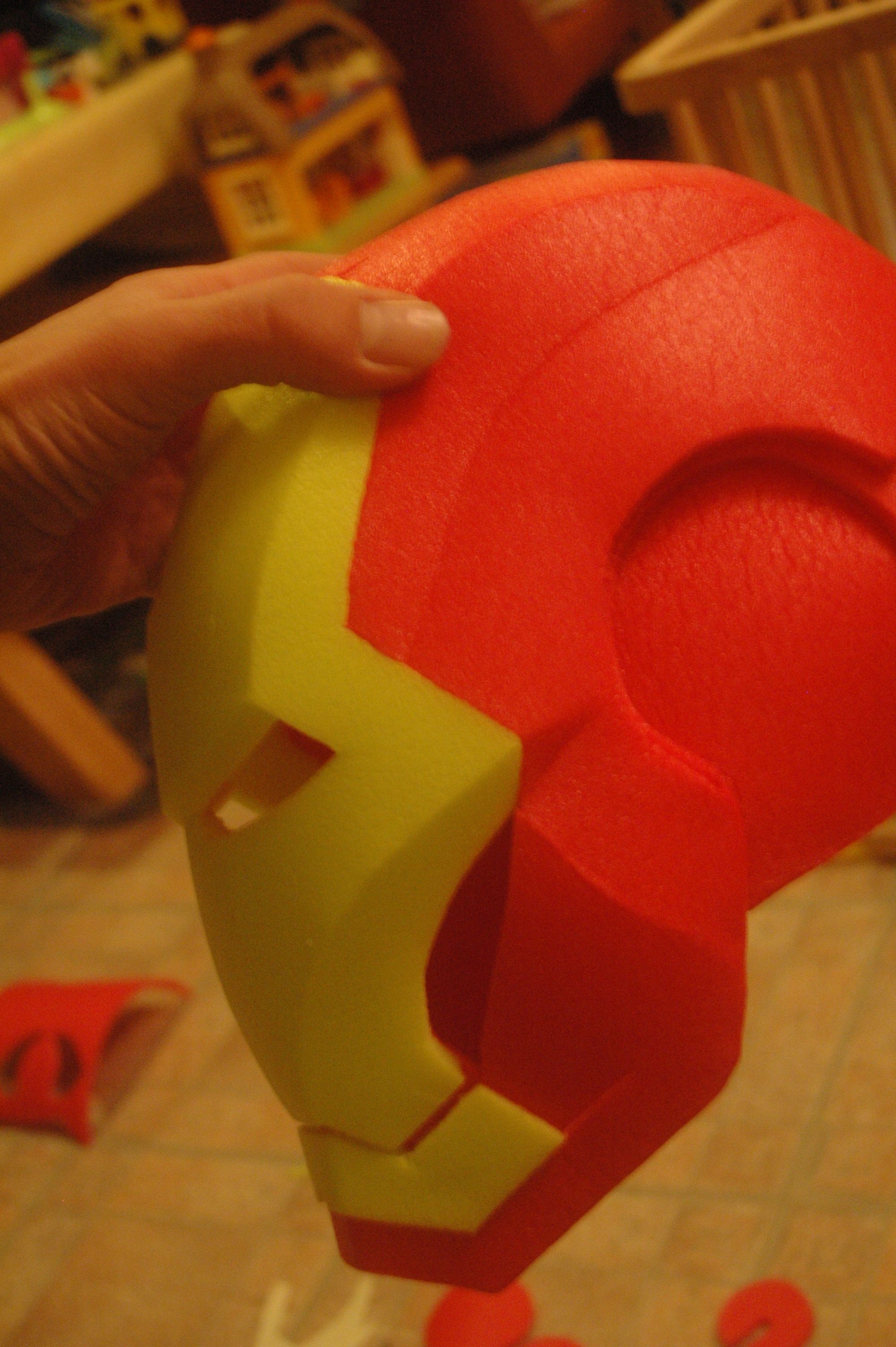

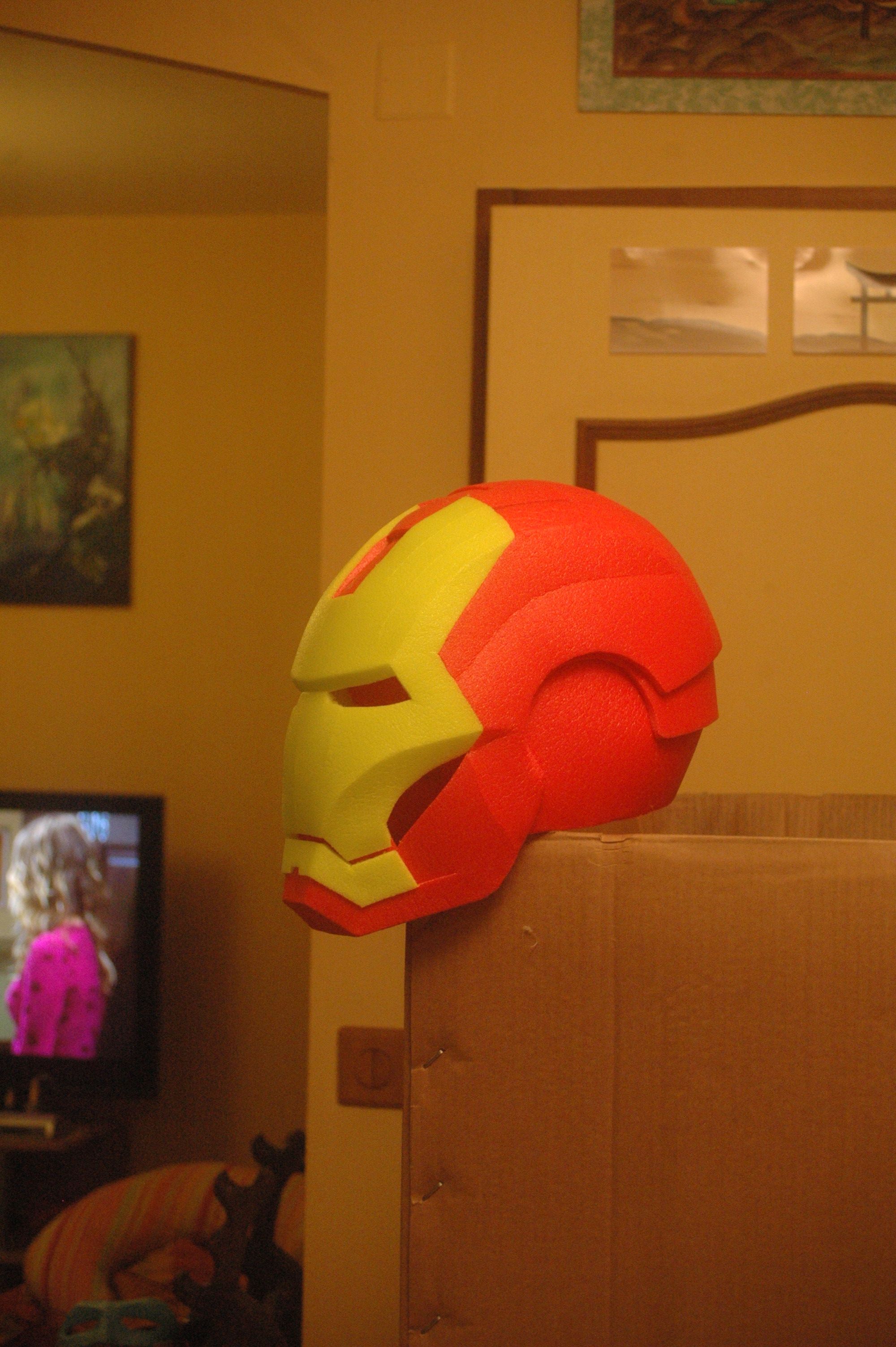

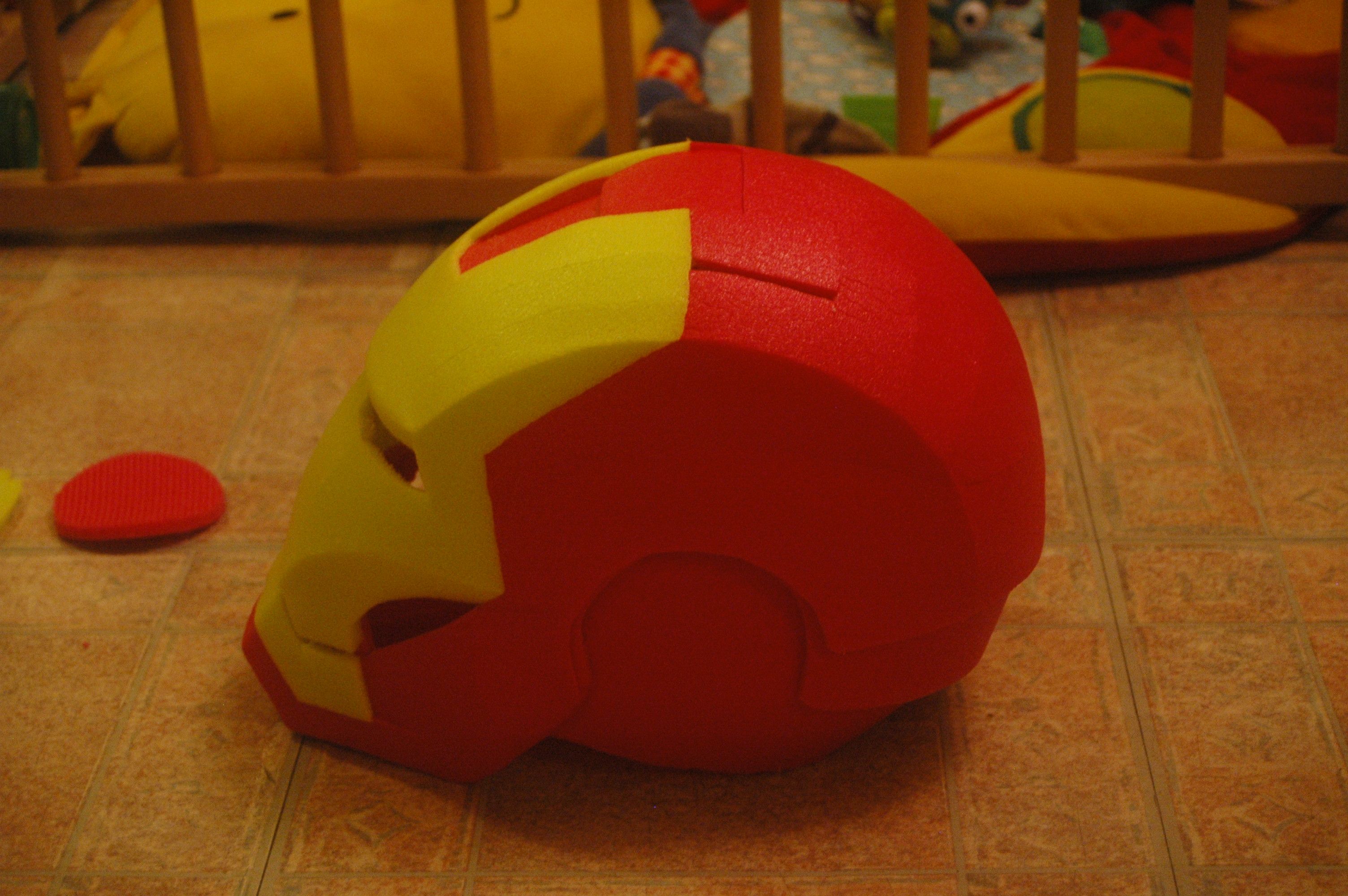

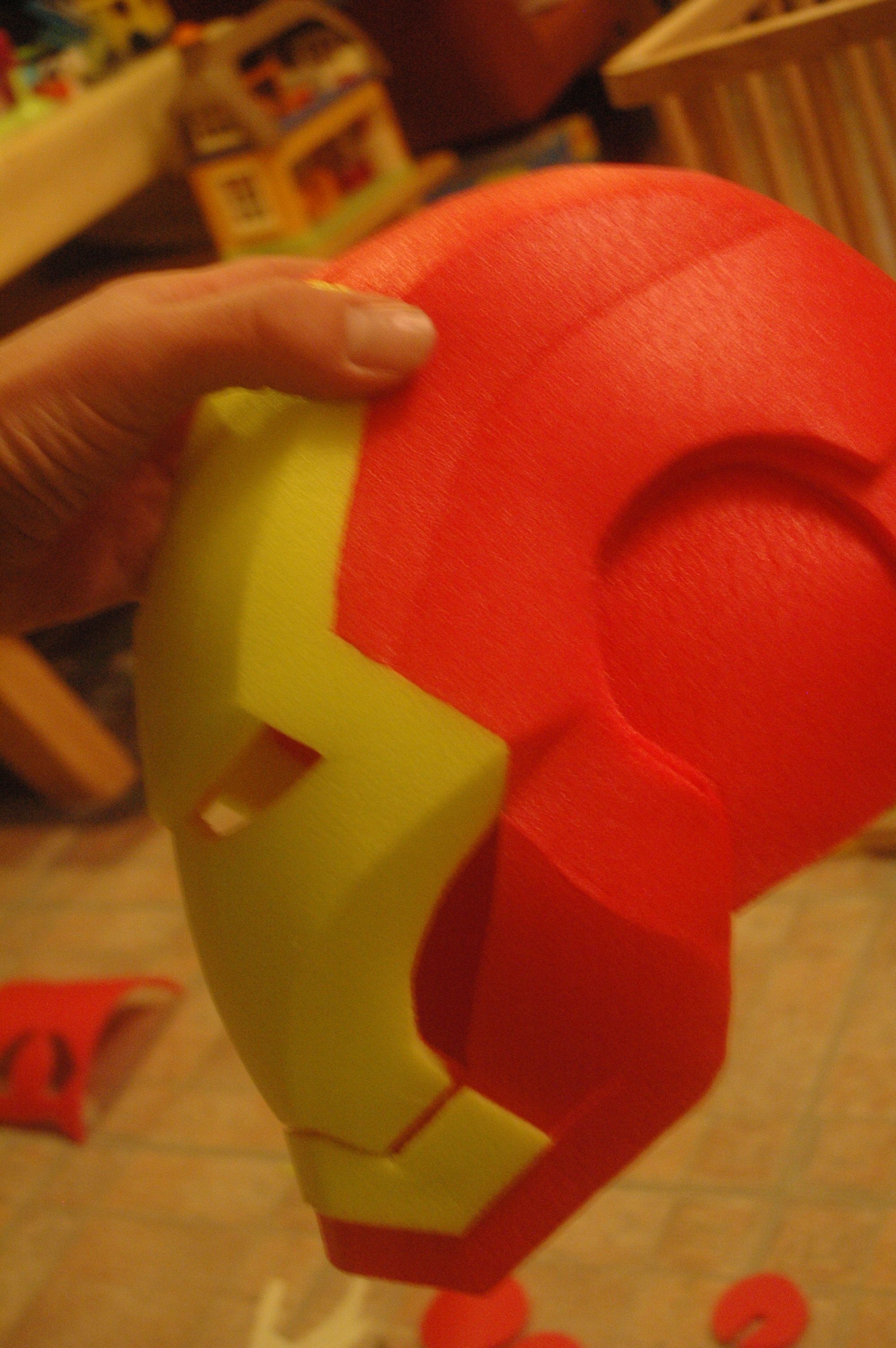

Well, it seems you all like this helmet. Sadely these templates can be used only if your can get foam sheets larger than a standard paper sheet.
To print this file correctly, you'll have to tick "print alignment marks for multiple pages" in "setting / print setting". Then, cut away the top and left margins of each page and tape them together in the same layout order than in the pepakura 2D view to obtain a laaarge single paper sheet. Then, cut out your paper pieces just like they are.

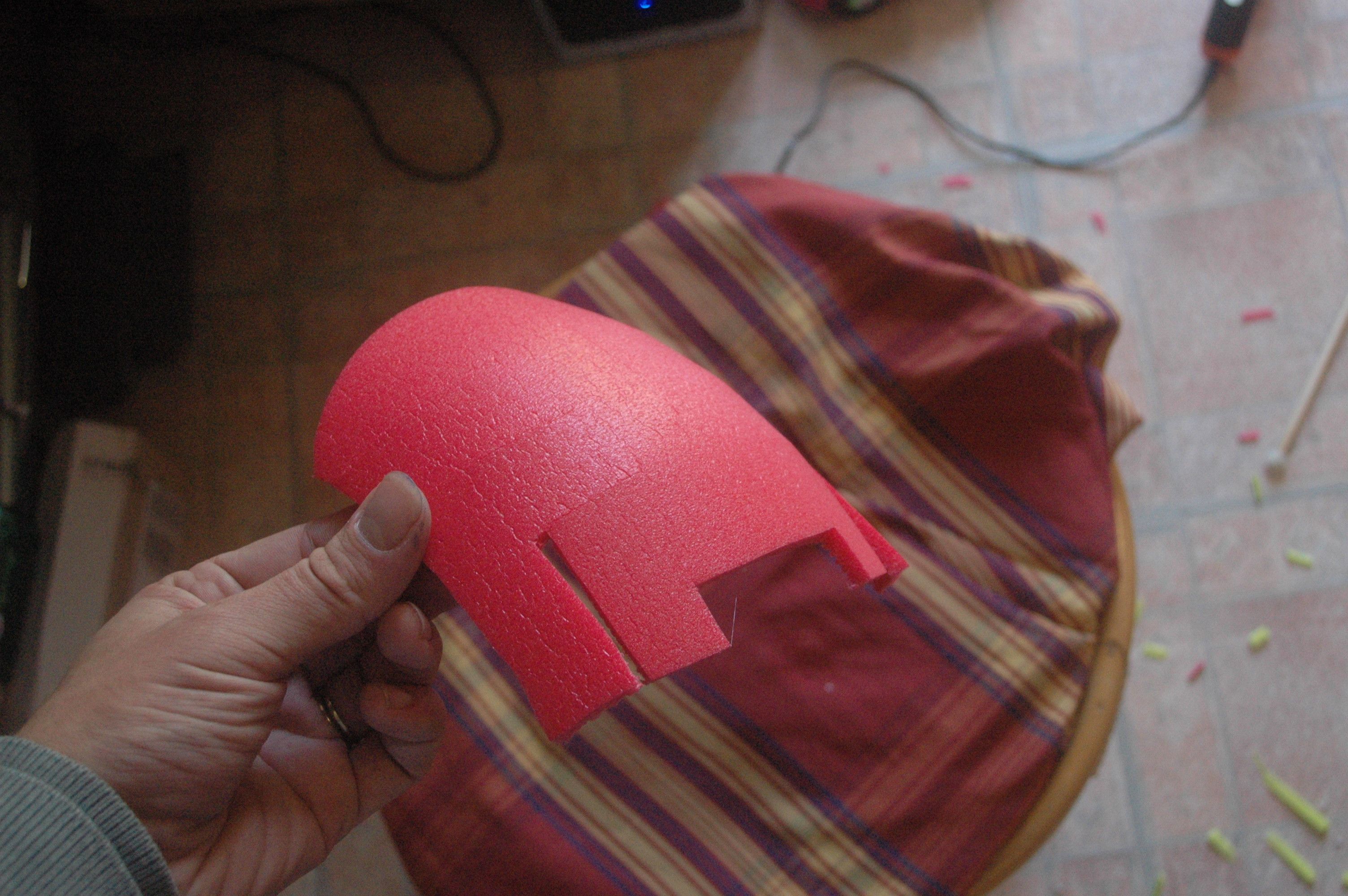

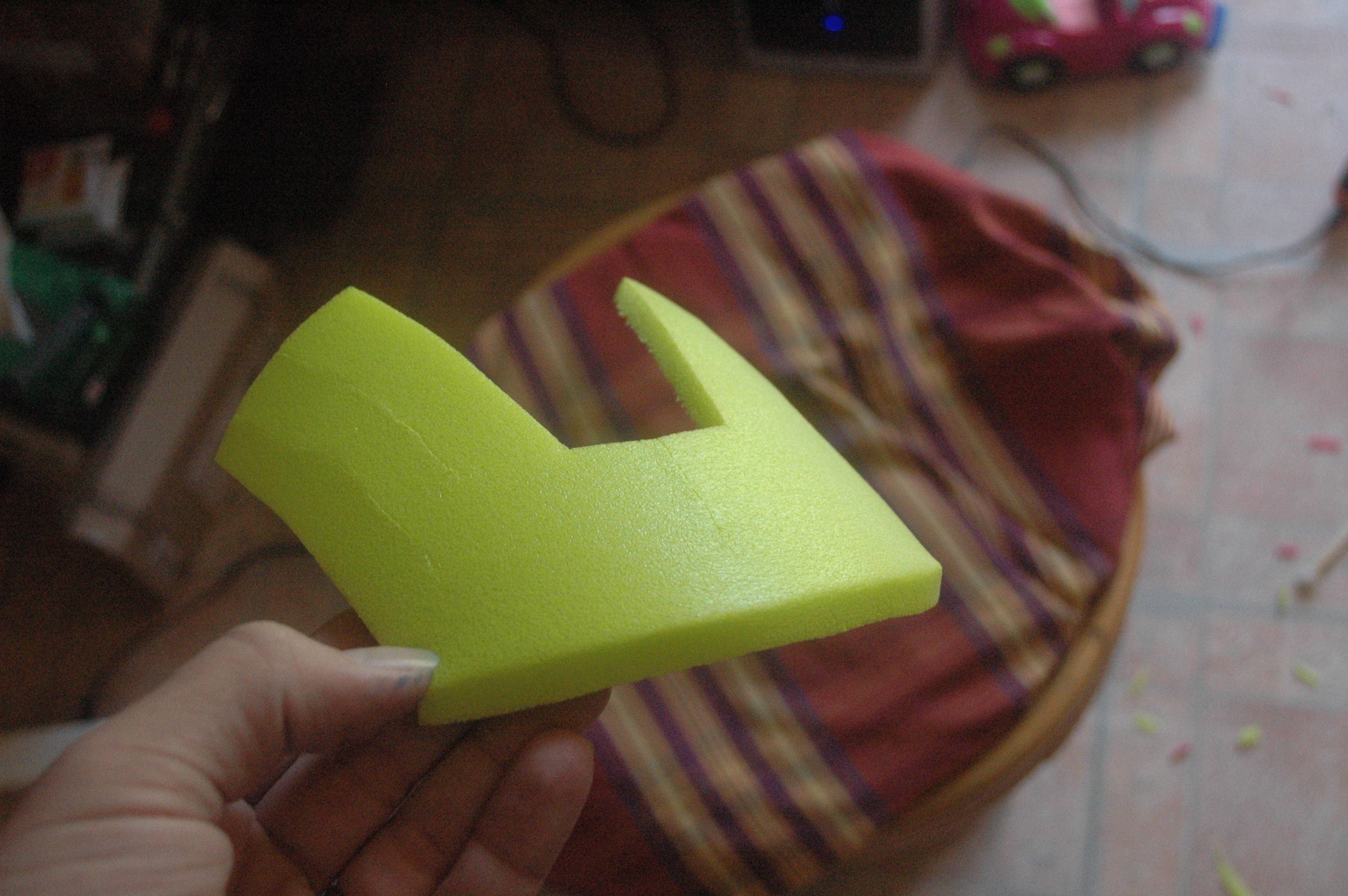

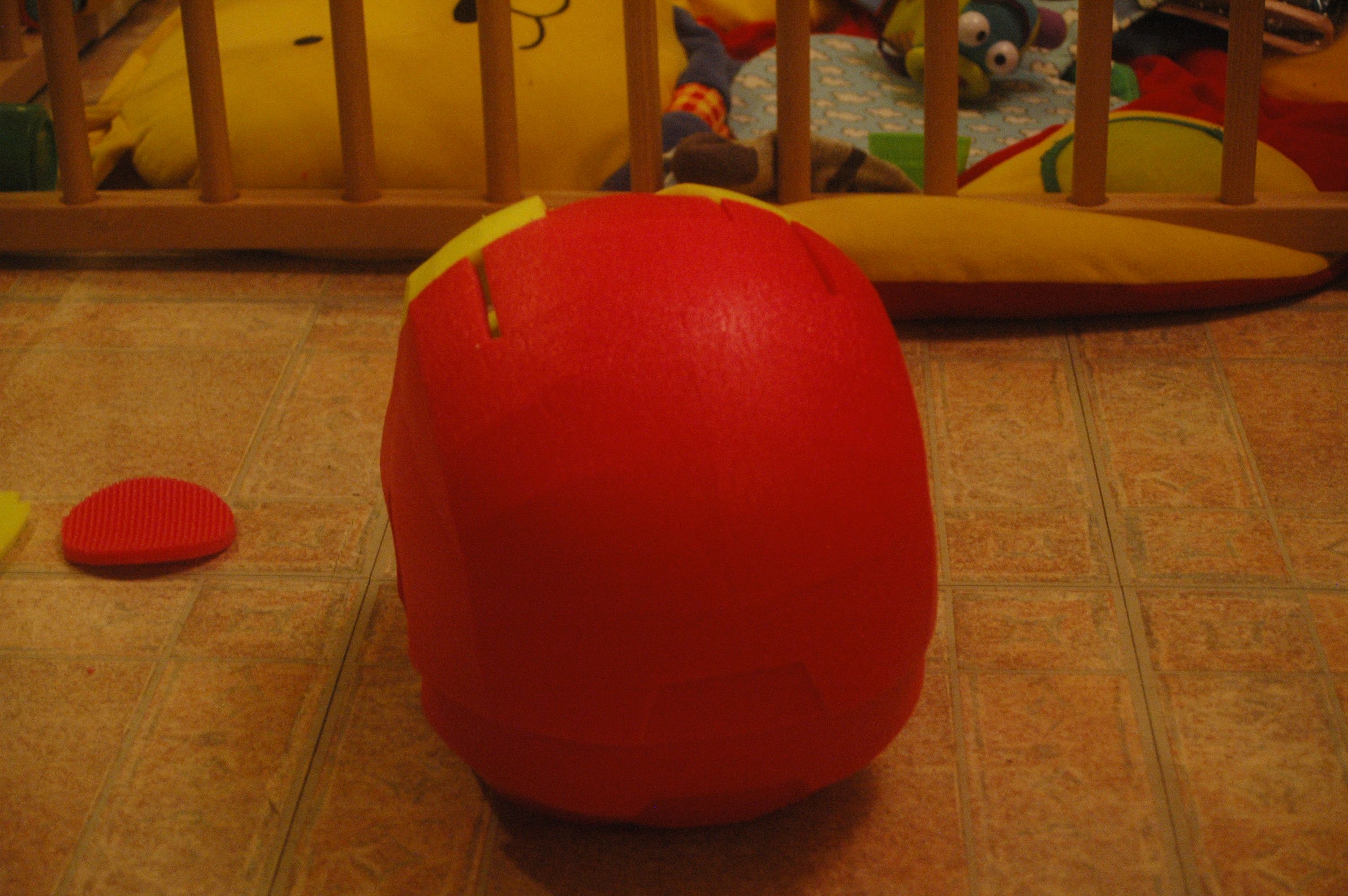

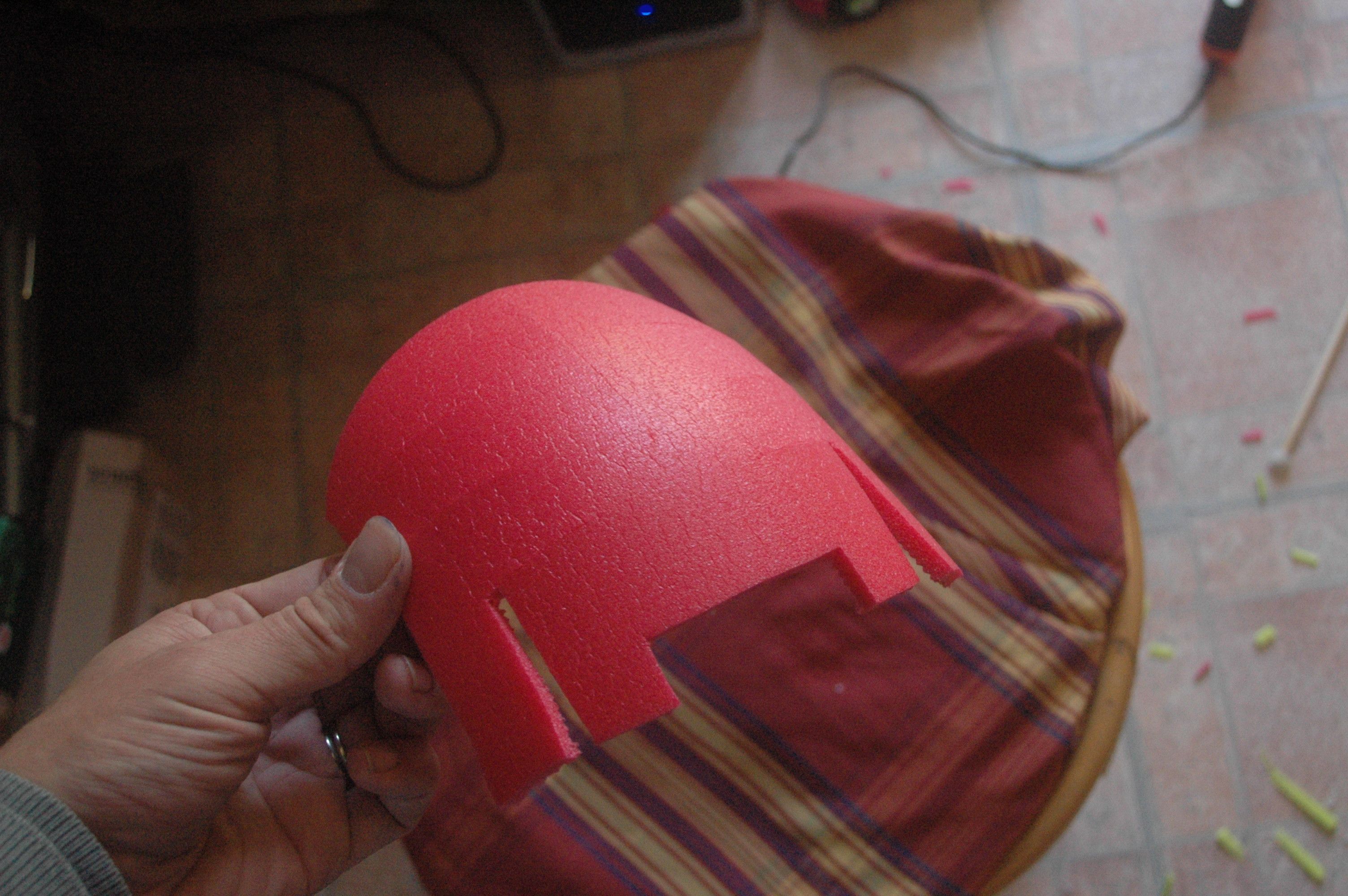

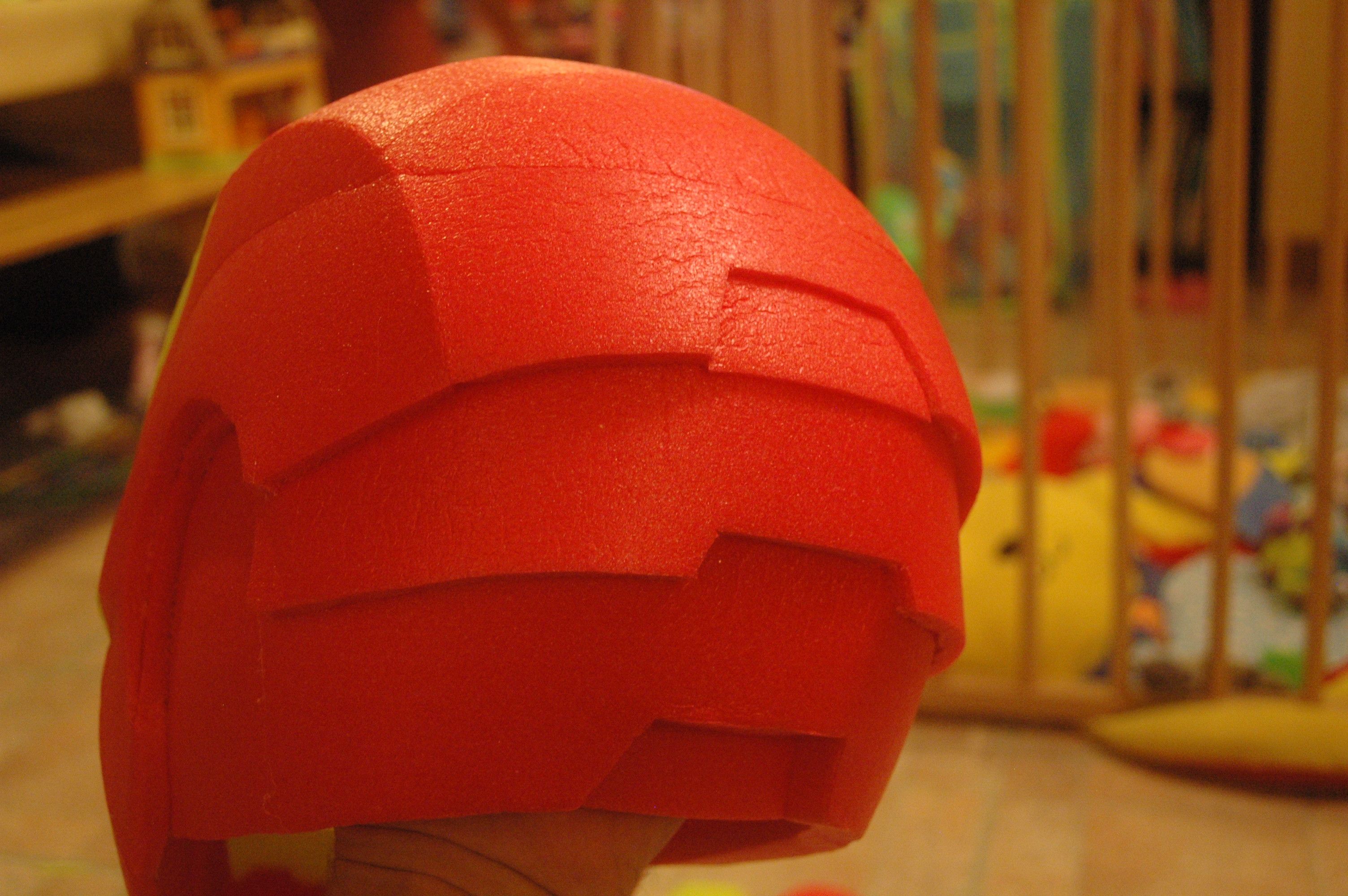

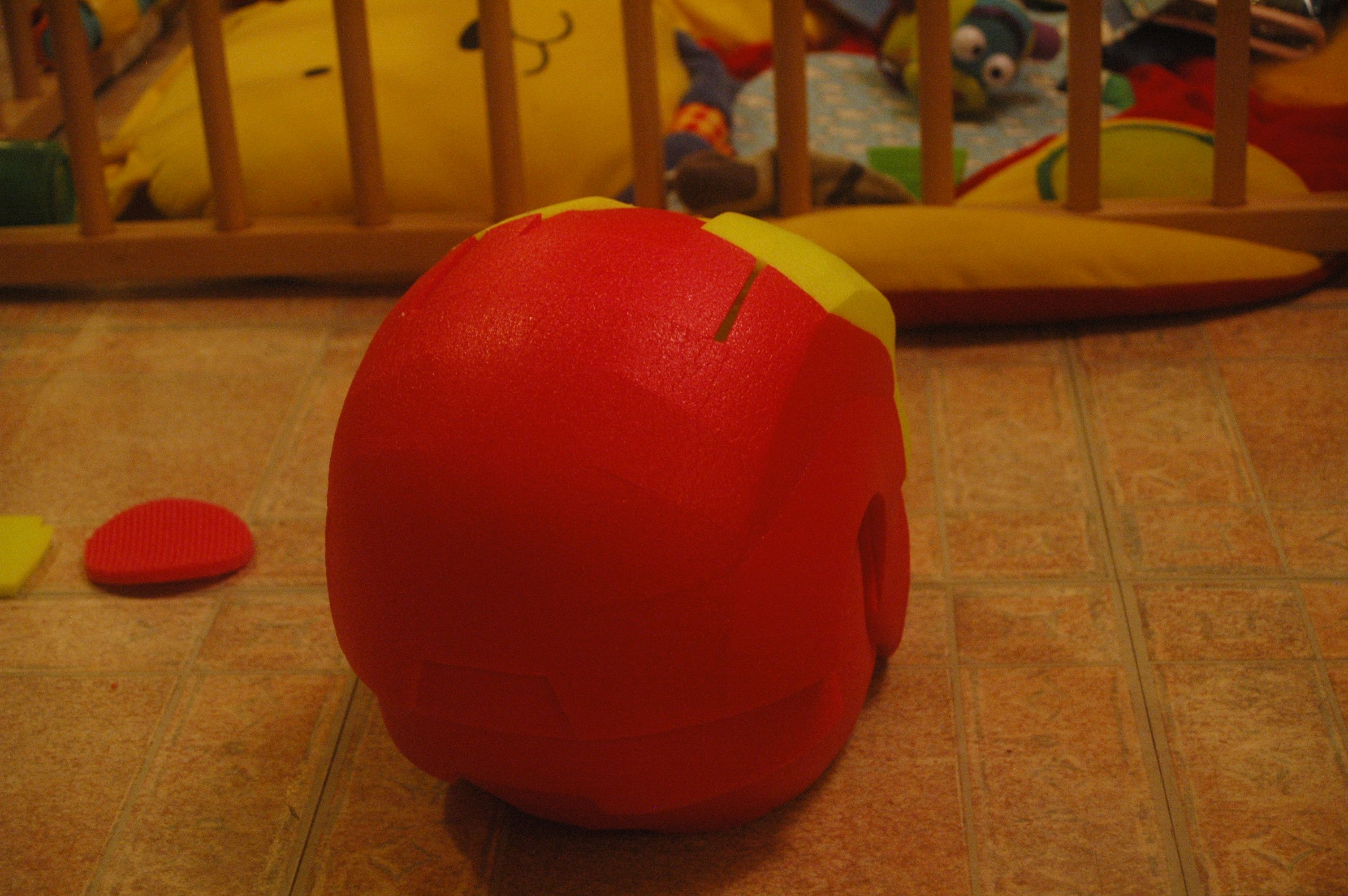

For further infos, completing pdo and helmet needed seven consecutive hours. With two kids and a wife and a job, the real challenge was to find these seven consecutive hours alone at home. I hate spreading my building time in short laps, it resets my concentration. I used my sempiternal 7mm polyethylene foam (i guess it's plastazote because it looks like, but it's writen nowhere).
The guy I'll send it wants to try molding/casting process of it and the rest of the suit to get at the end a full-plastic suit. That's why I especially had to care about each seam and jointure so they appear as clean as possible.

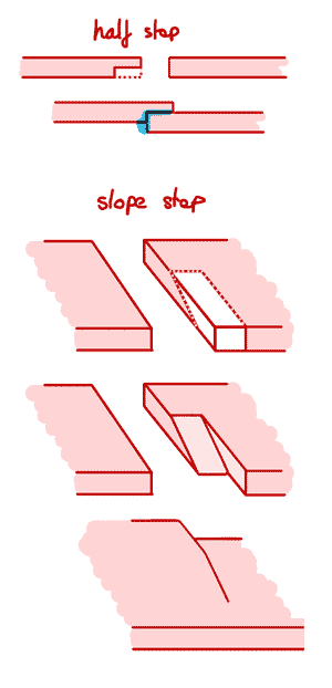

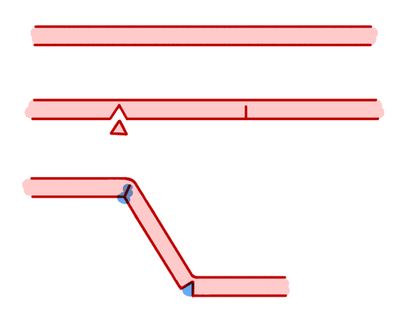

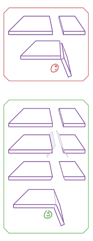

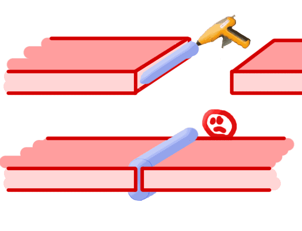

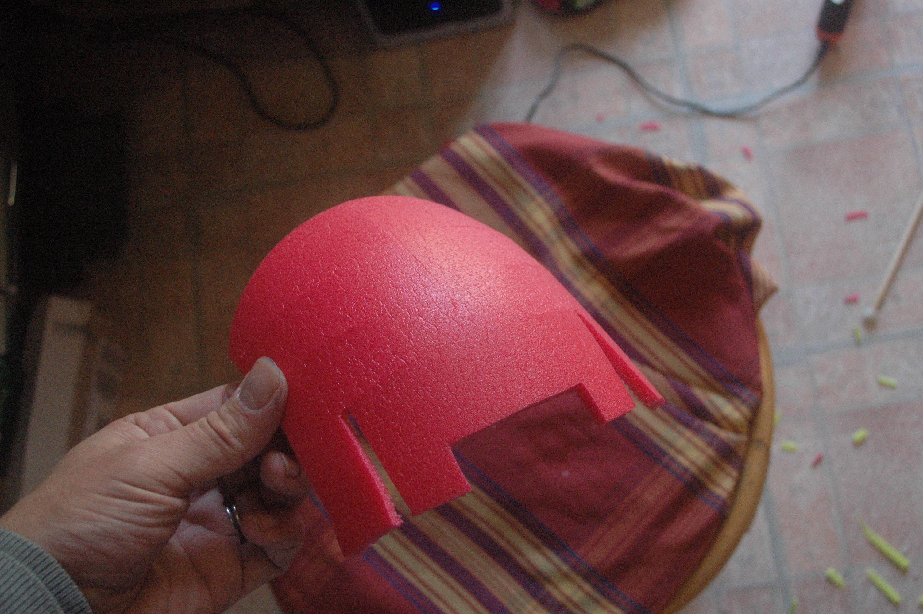

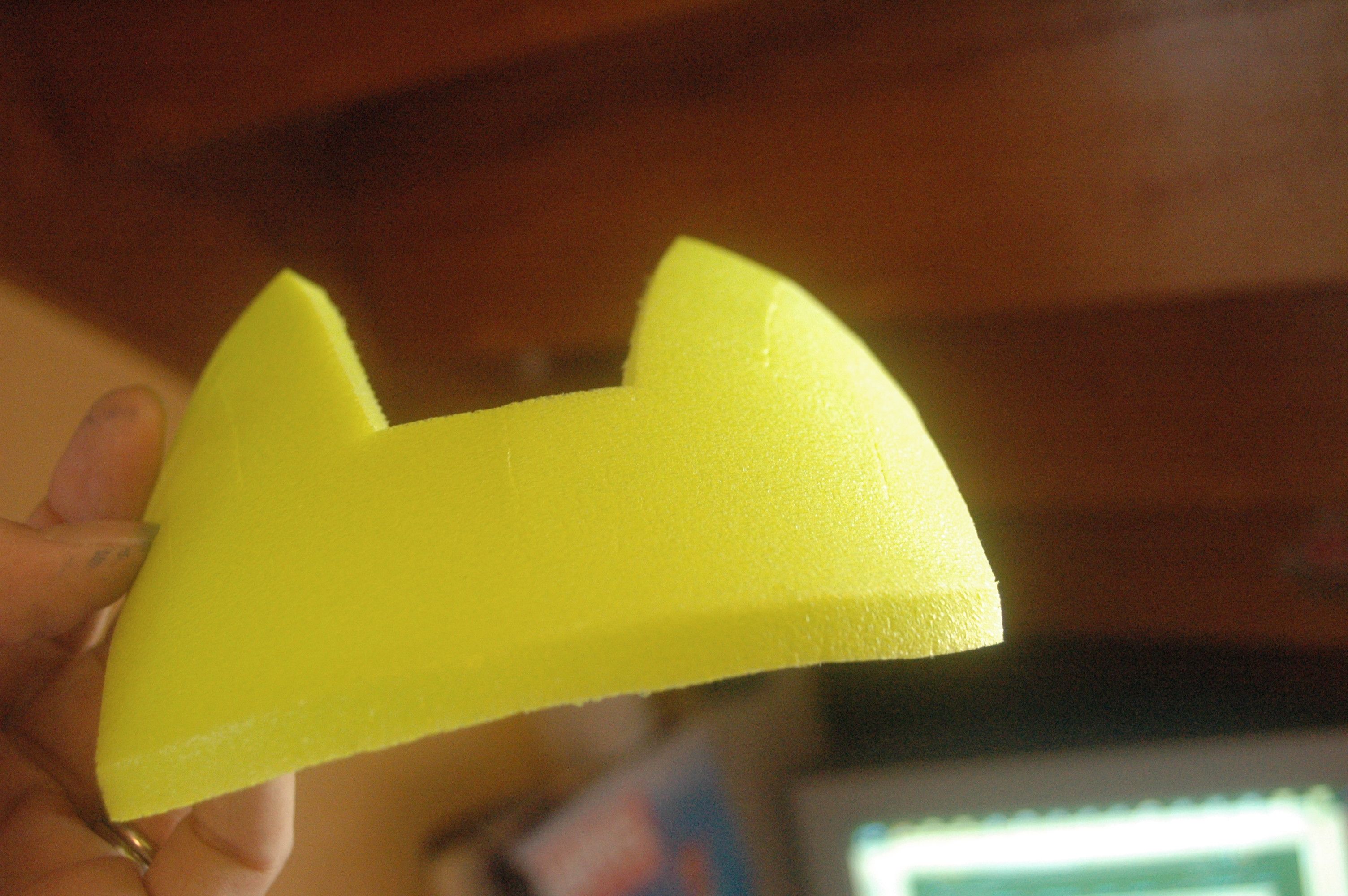

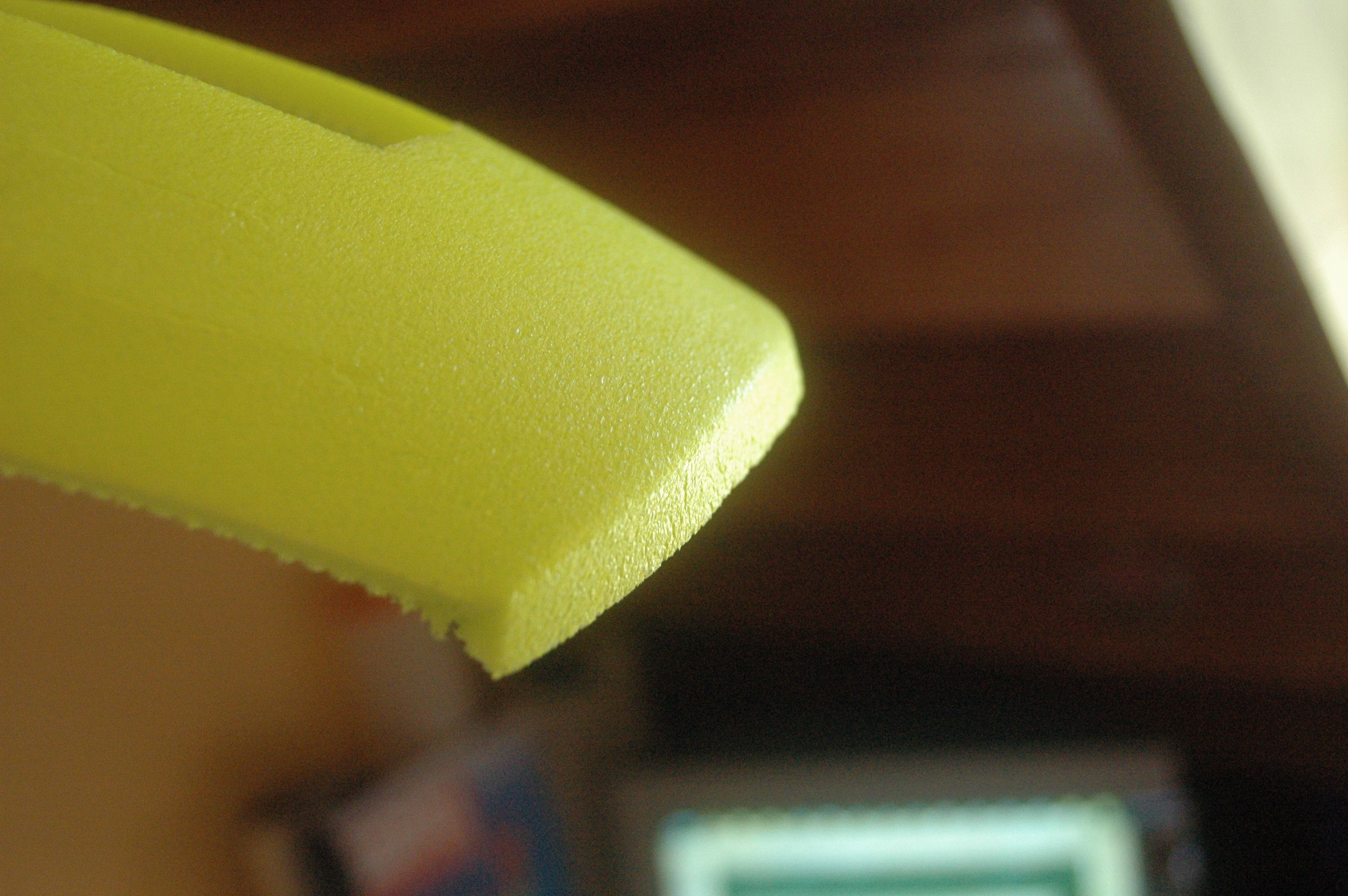

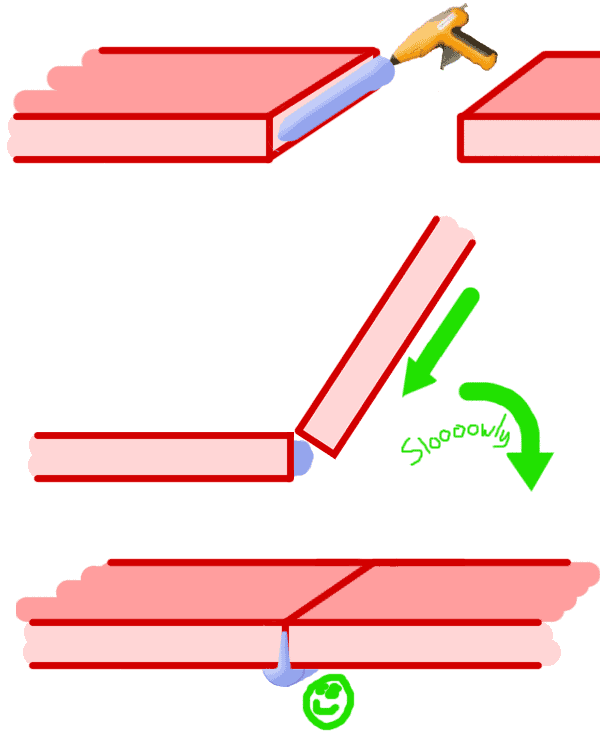

To do so, here's a reminder of the required tips :
Avoid glue overflow
bad ->
good ->

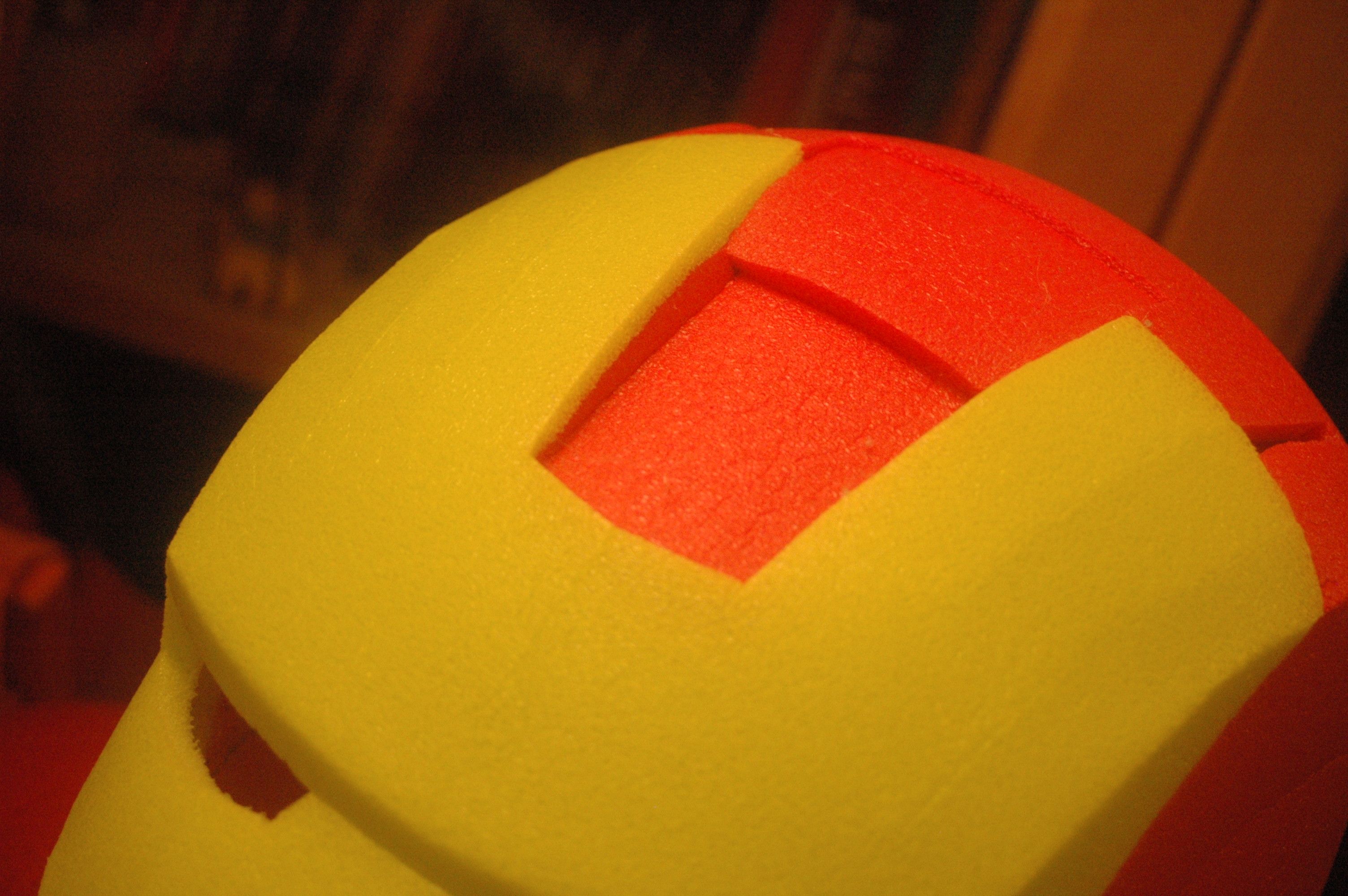

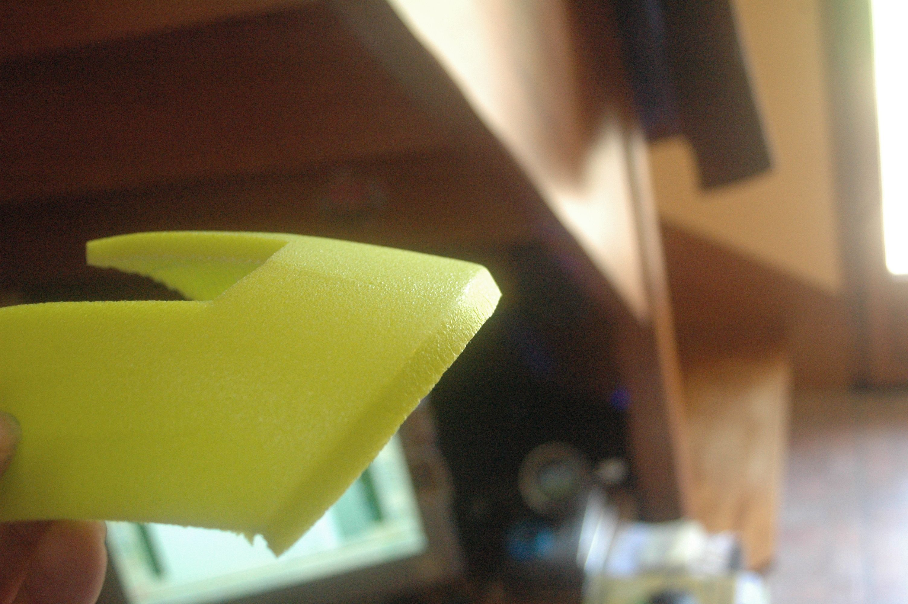

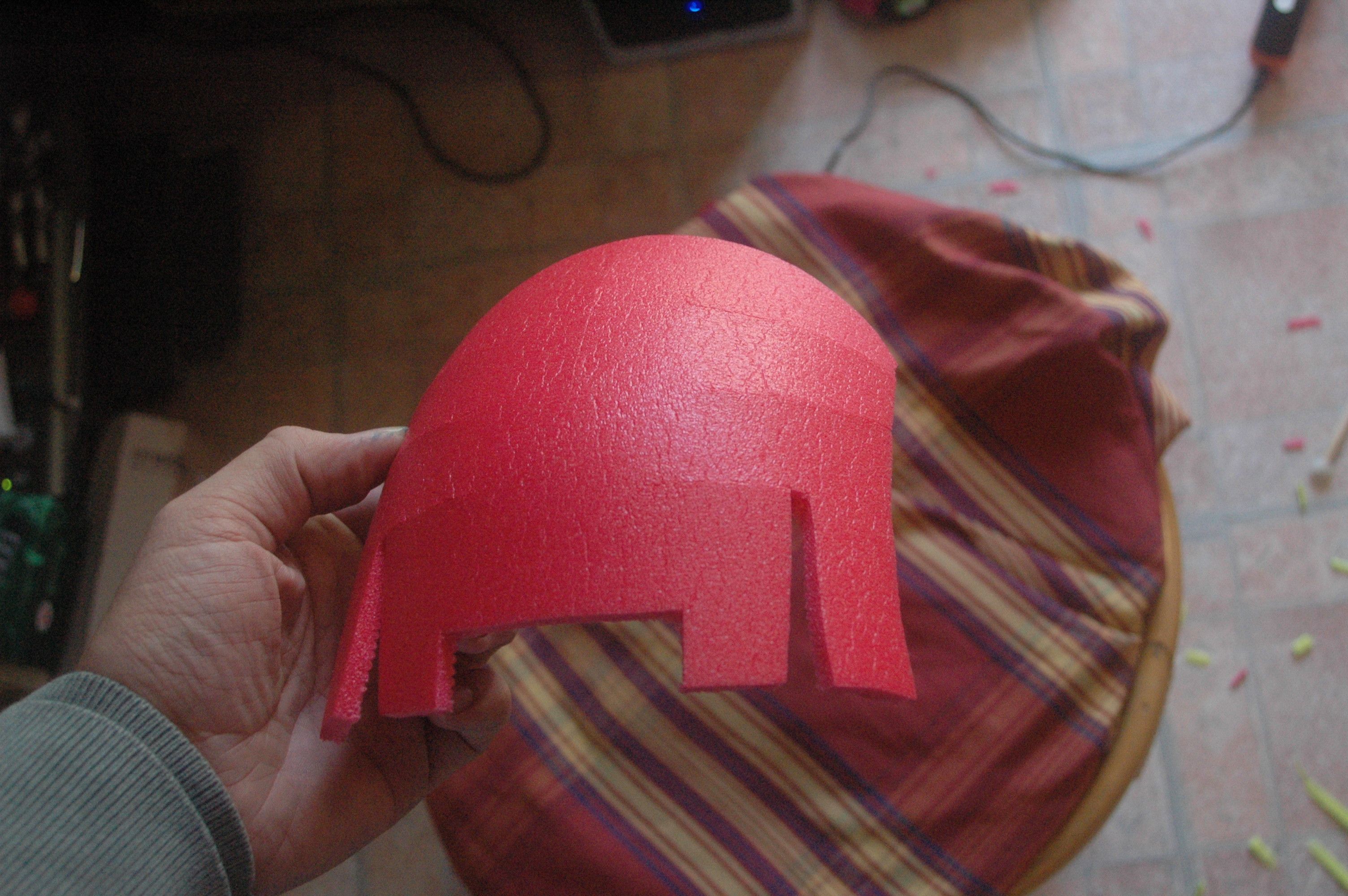

mountains and valleys on a single piece of foam
angle cuts
half steps

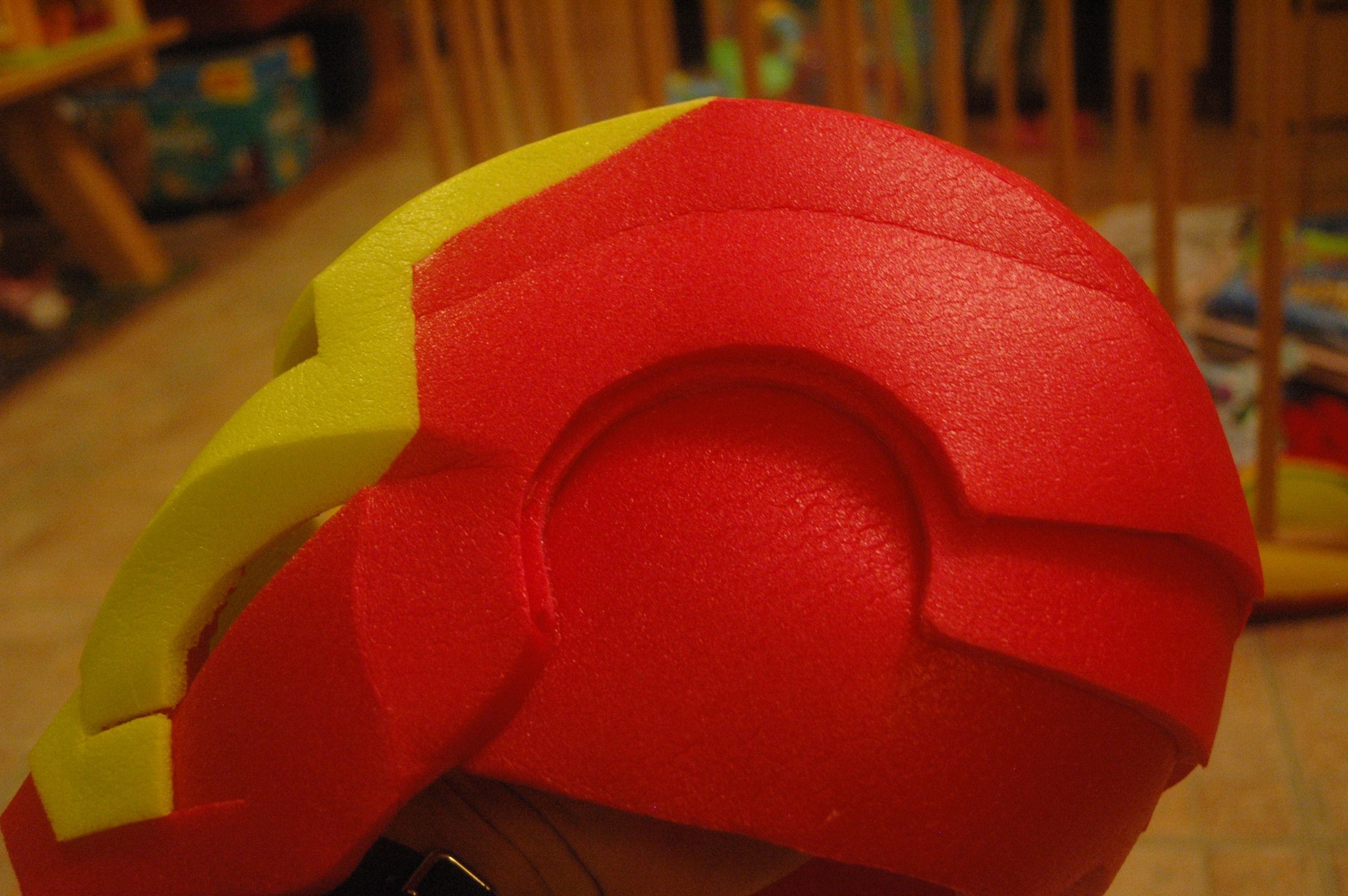

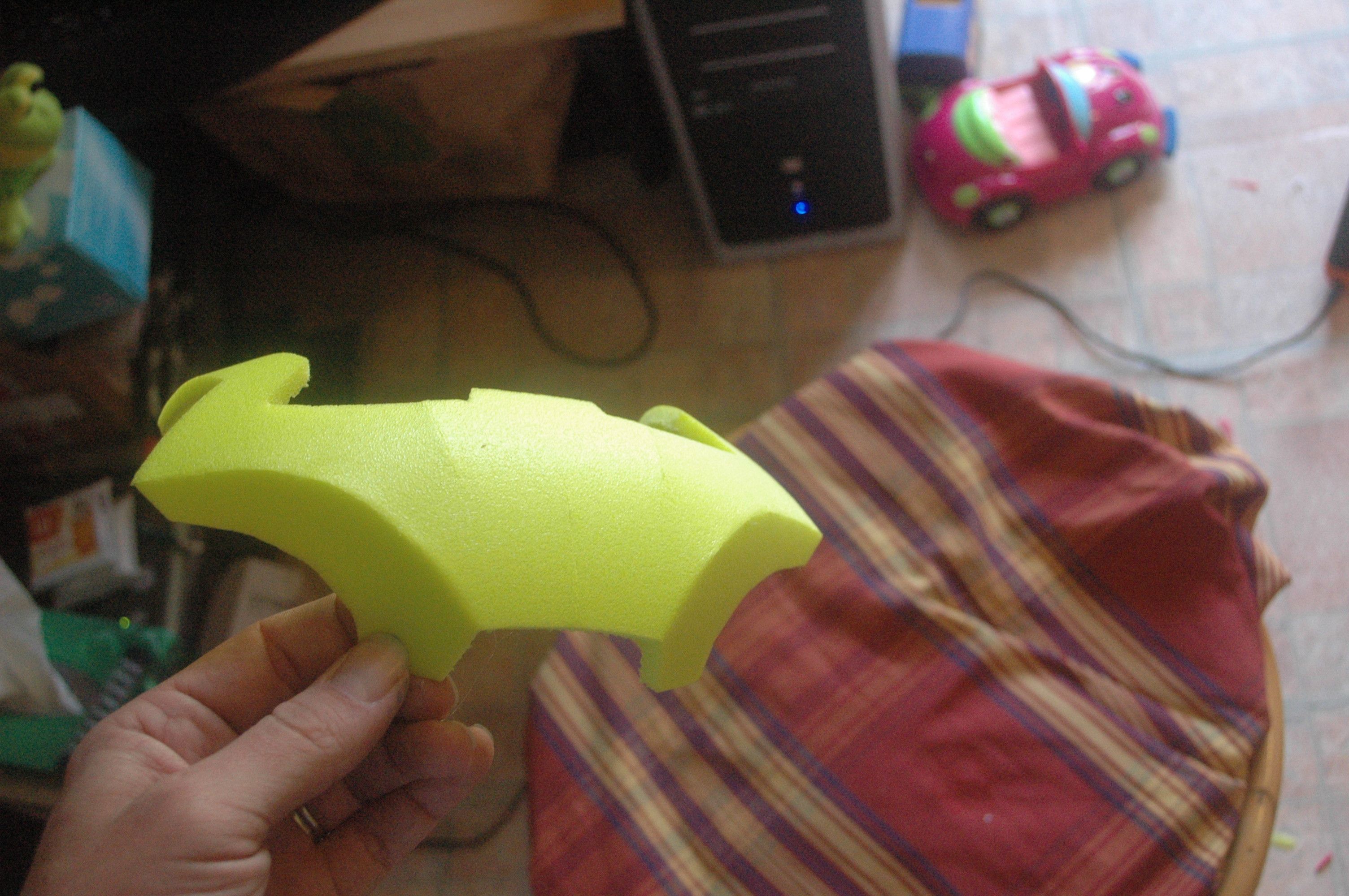

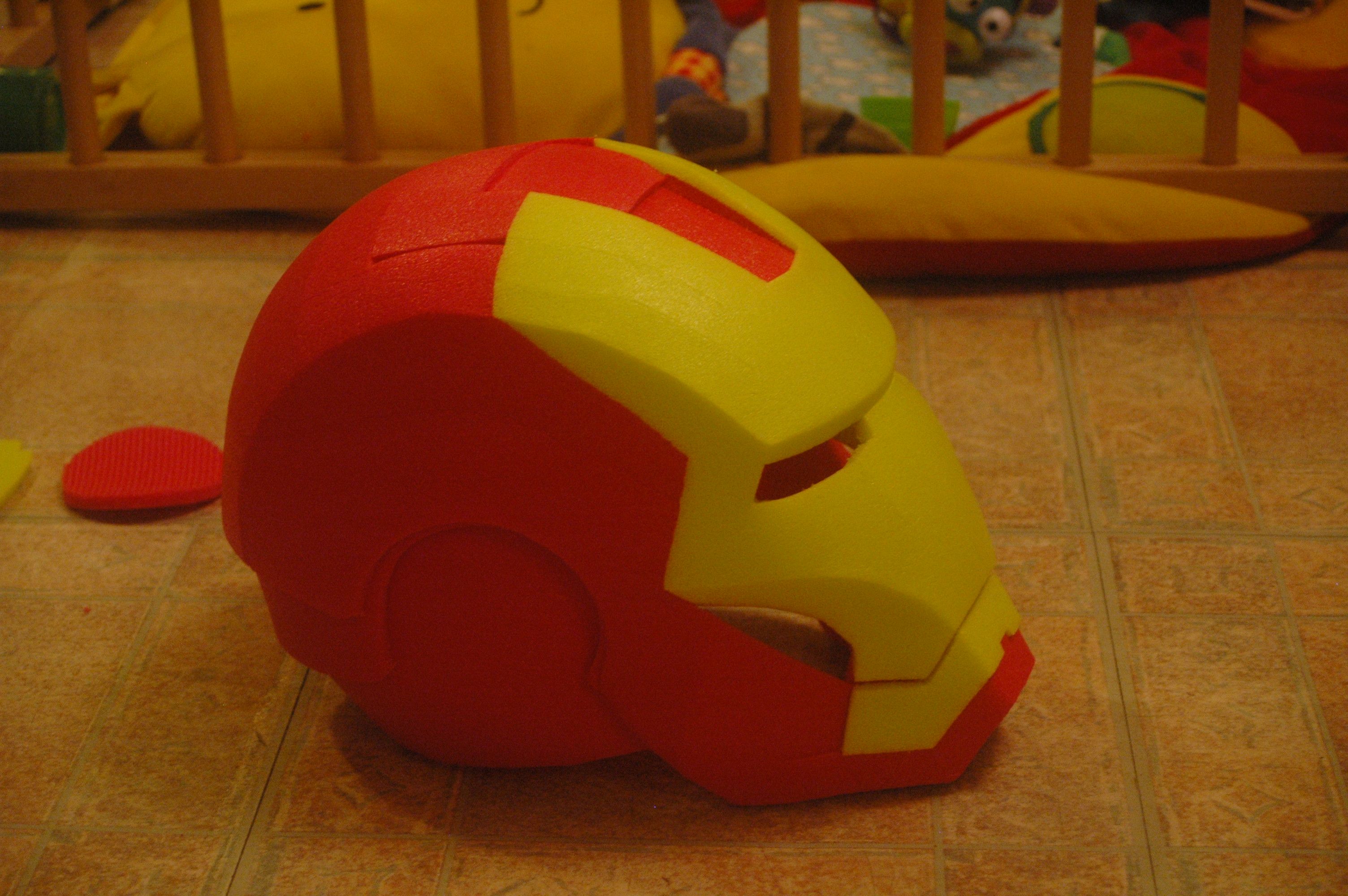

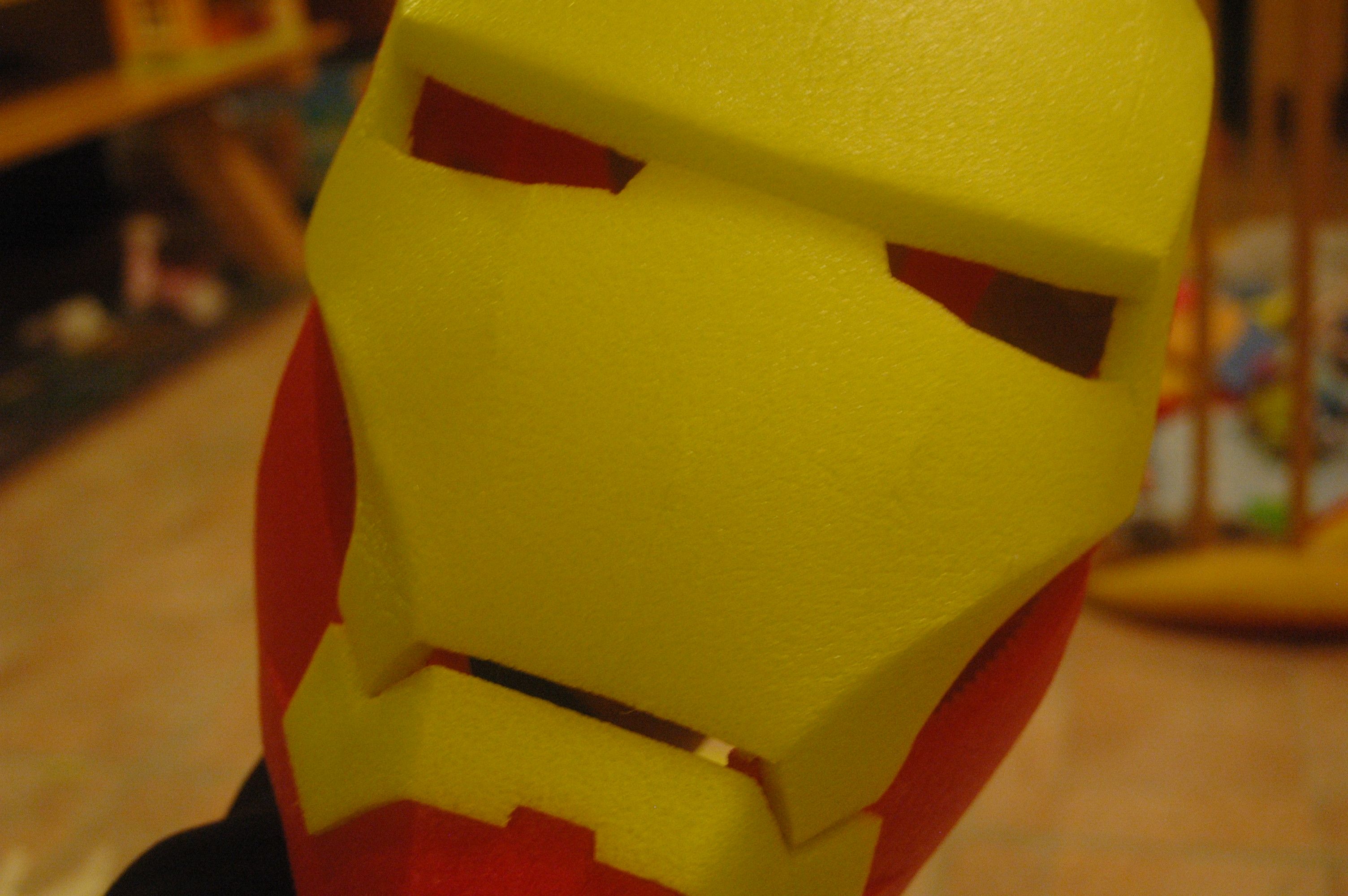

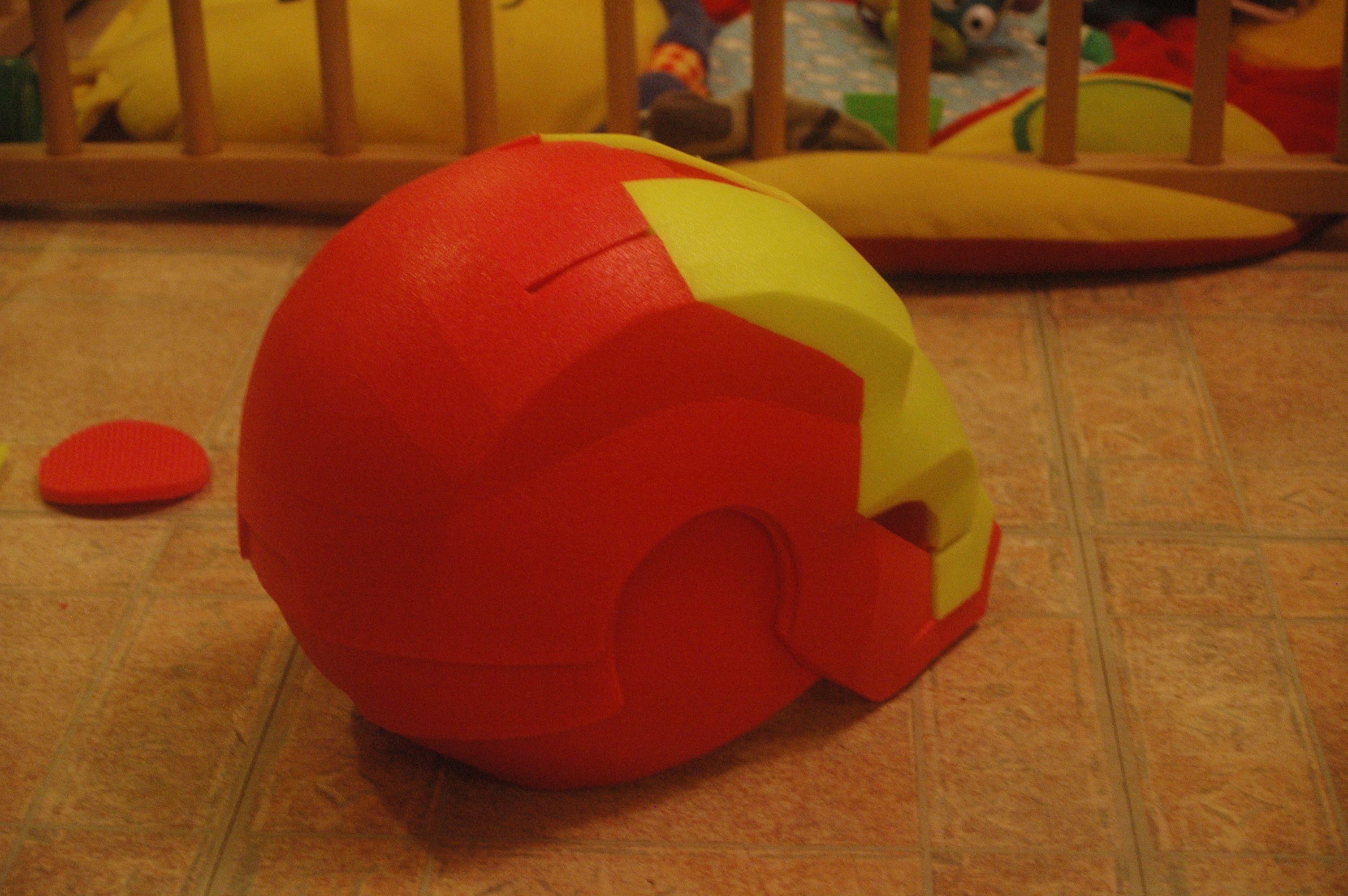

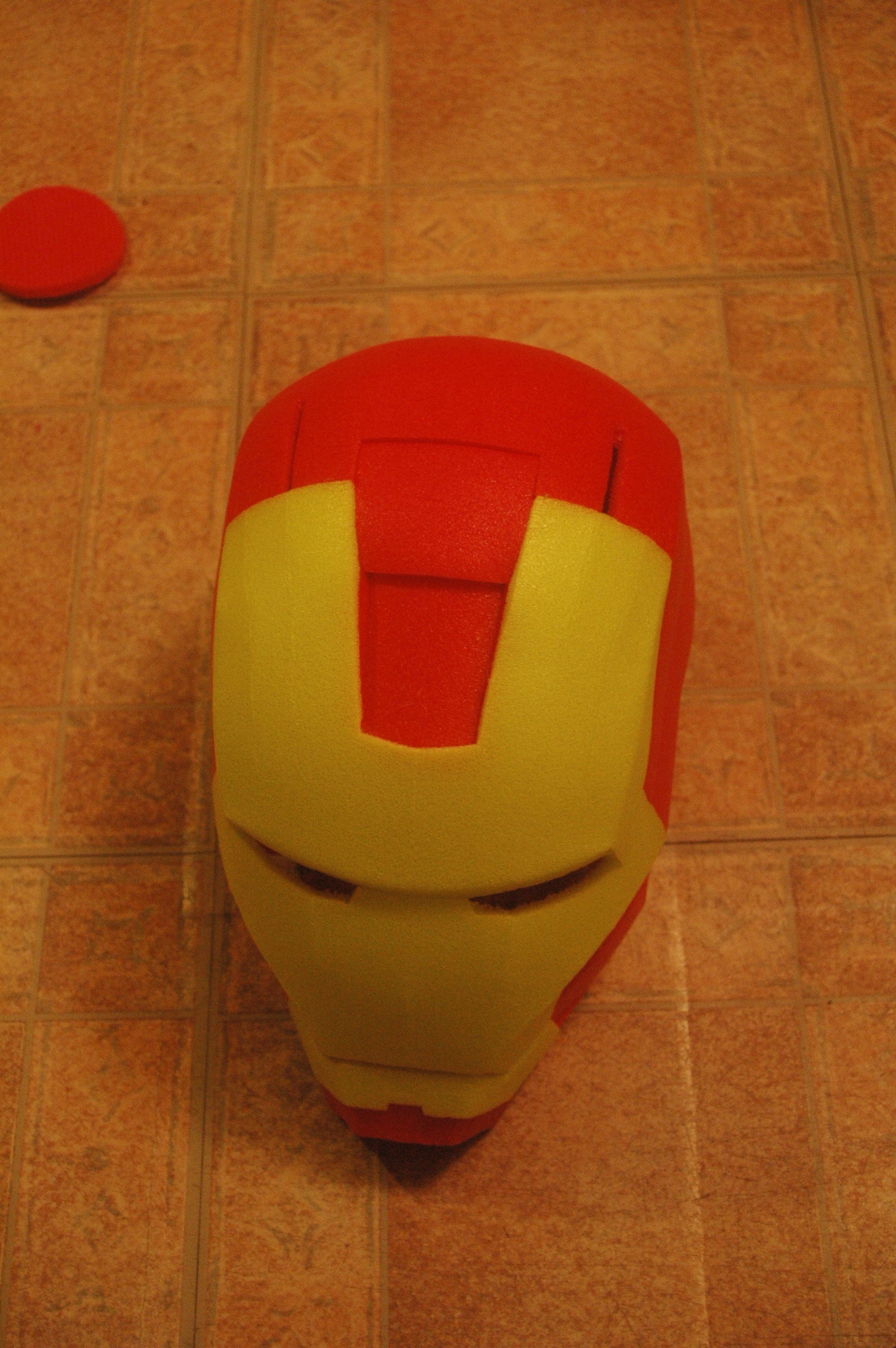

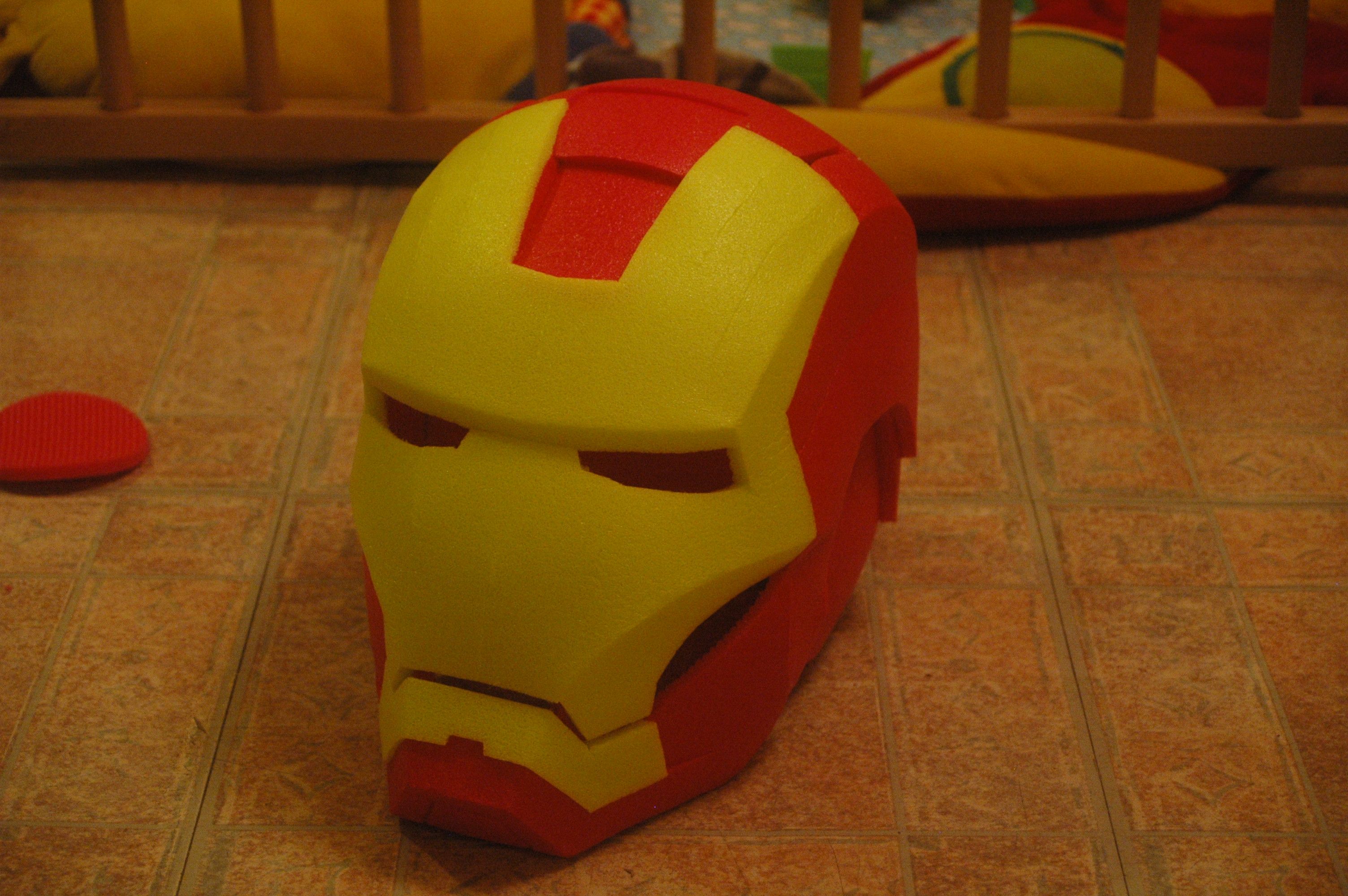

In the case you could be called to think the other side is an ugly failure, here are some additional views :
The full suit is complete and will be parceled soon, I'll take pics before packing it.
