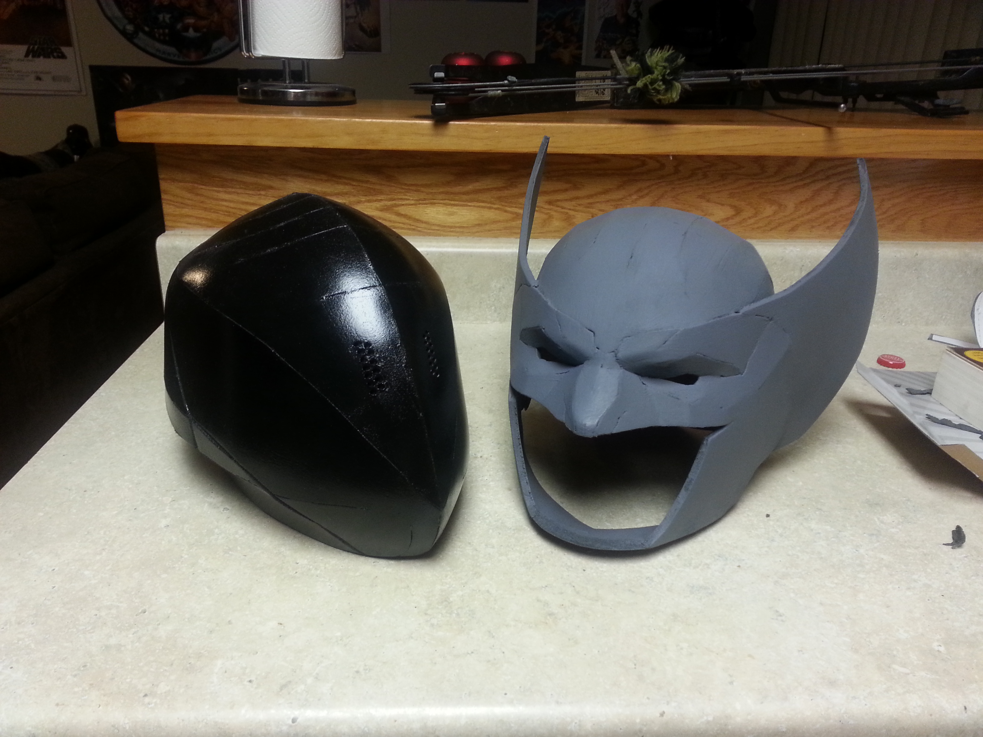

002.JPG001.JPGMore Bondo and sanding.
Am hoping to start building with foam over my uni break and was wondering what thickness foam would you recommend for the Rinzler and Wolverine helms?
I would use 5mm or 6mm foam. That's just because of the wings on Wolvie's cowl and it helps with support and making the angles for Rinzler. But I use those widths for everything since it is overall easier to work with. It all depends on what YOU feel comfortable using when you start. :D

Nice edges on Wolverine, D-mine never get that good,I'm waaaay too impatient!

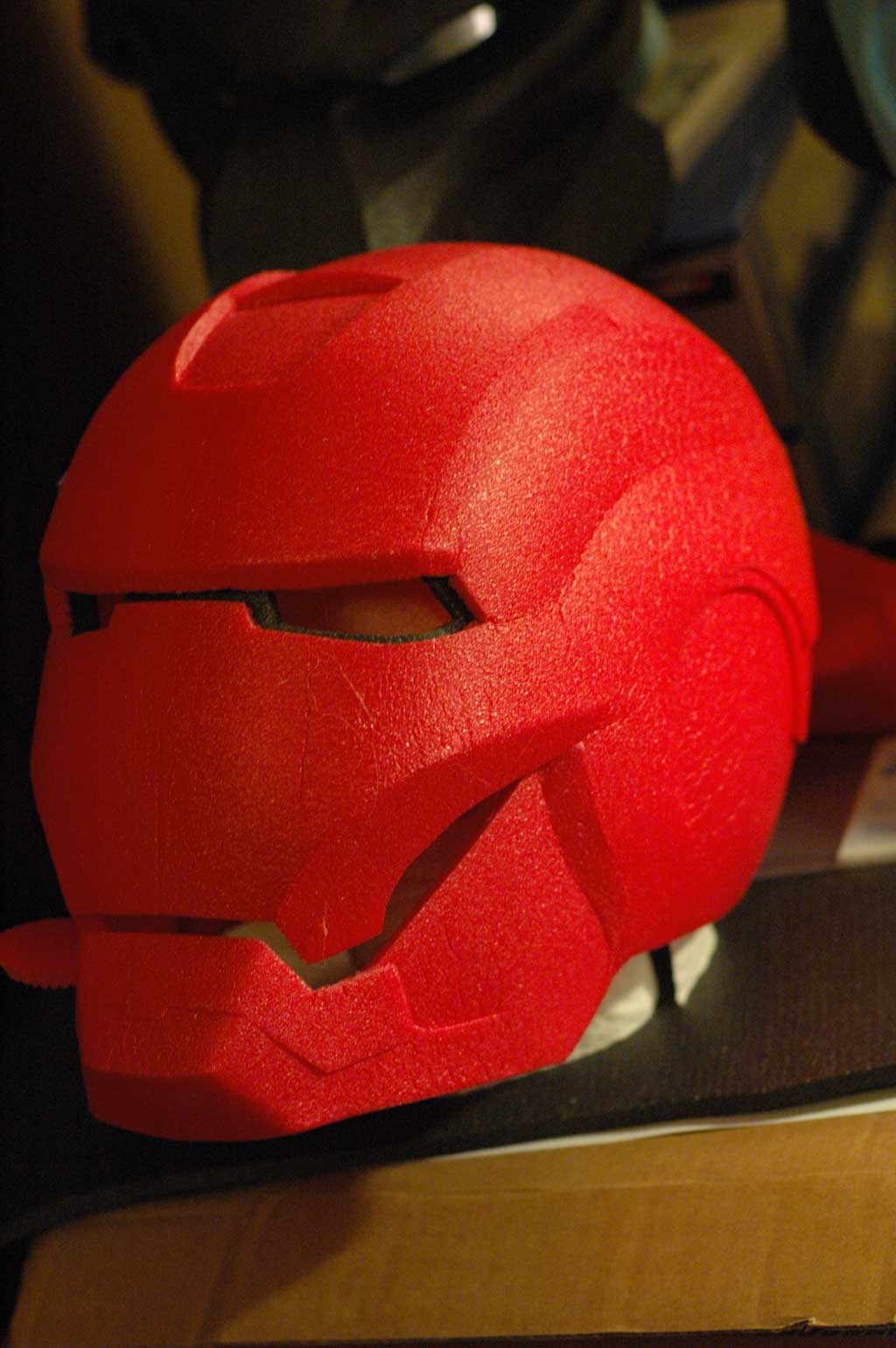

great tips and awesome tricks... I am working on designing a hinge for foam out of 3D printed plastic... if you have any ideas or thoughts let me know... I would be willing to try to print them for you, maybe if we get good enough at it we can sell some of them here.
The main issue is a foam helmet keeps its shape because it's a one piece helmet. Split it in two parts, and you get two distorded parts.
So, first option : be sure to resin the one piece helmet before cutting the faceplate up. Then no distortion of the separated parts.
Second option : your hinge must embed a rigid frame that will sustain the borders of both faceplate and front helmet apperture. Just like a window without glass. This way each helmet part will feel like still connected to the other part, and won't distort. It means several hinge size for as many helmet scale factors. And several hinge models for several helmet models...
Hope you're an optimist ^^

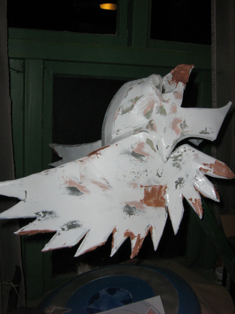

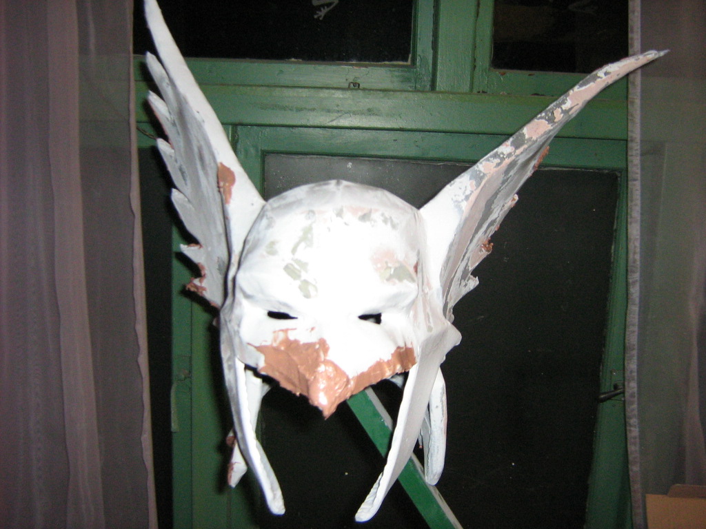

Question: the Hawkman helmet is almost finished, and I want to give it a better finish than simple gold spraypaint. What would you suggest to give it a better metal look? Merci in advance:)
