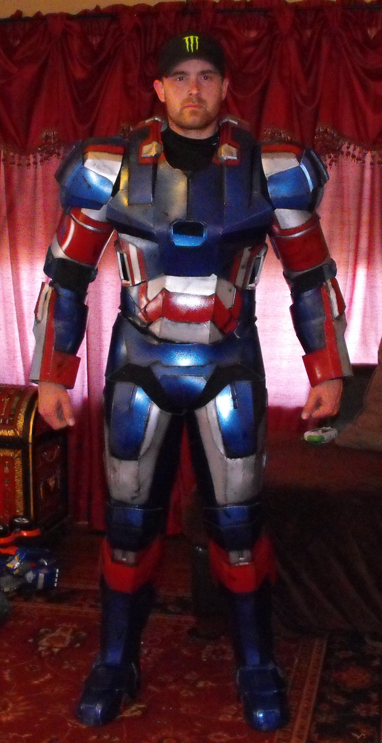

Just wanted to share the update to my IP suit. The templates were great as usual.....

Scale and proportions are excellent, and I like your sophisticated weathering ! I'd be curious to know what you get it with ? Sure now it looks like a real used armor, not like a roughly repainted old toy ;)
Re: FOAM speed building files'n'tricks ►Multi-Hero cowl◄ added.
Thank you sir... I look forward to building more of your releases.... :D

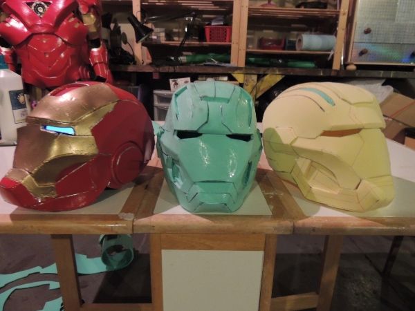

Hey guys right so I've had a bash at the mk 8 helmet firstly thanks for your great unfolds JFcustom I wanna build them all lol so here's what ive got in this photo I have the first Iron helmet I built last year (not brilliant but ok) Then we have the mk 8 that I had a go at building last night :S didn't come out right at all in to much of a rush to piece it together. I really need to learn to be patient so this leads to my third attempt the helmet and the end and its come out really well im very please with it what do you guys think?
