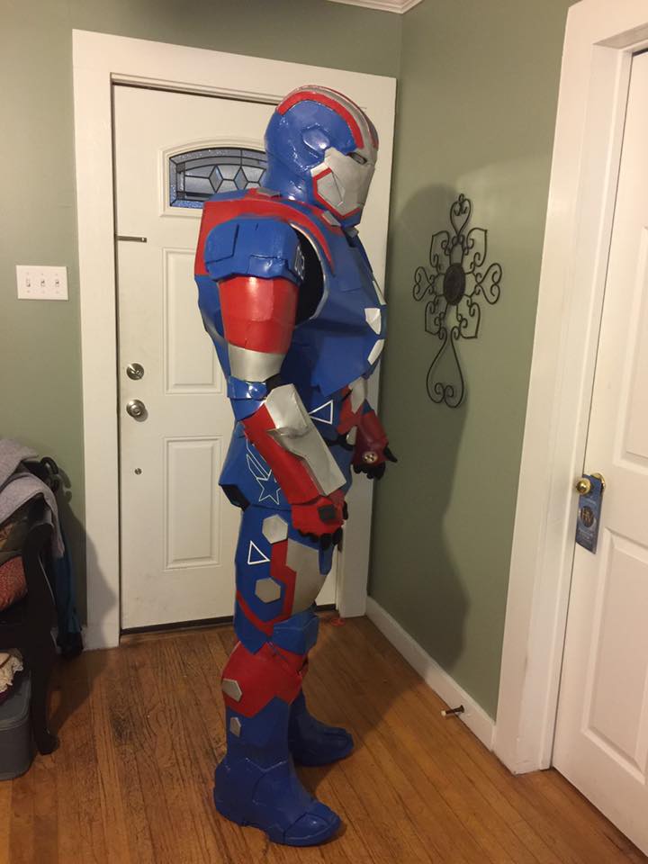

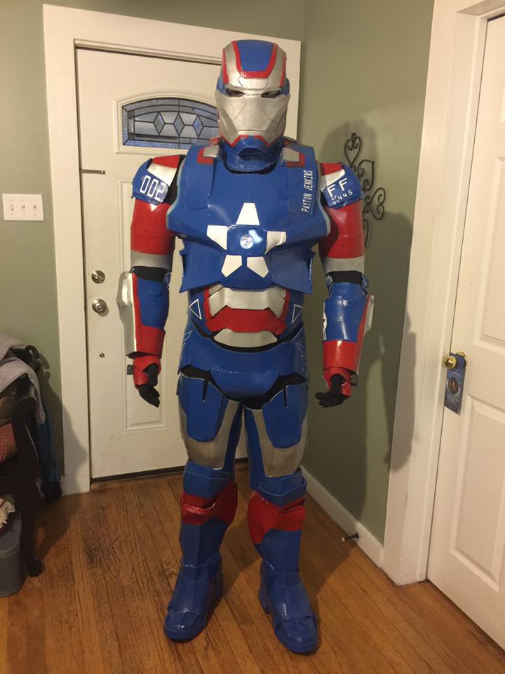

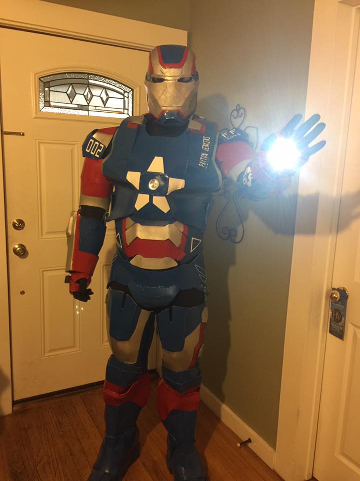

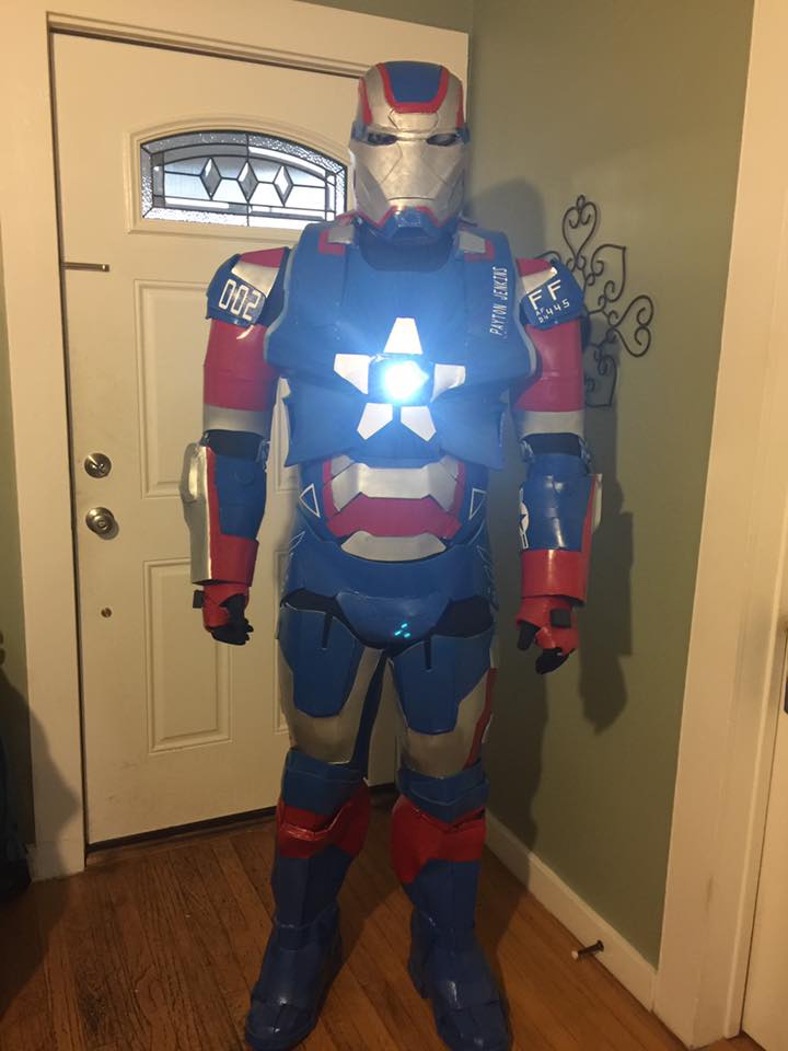

My iron patriot cosplay using JFcustoms Foam iron patriot files. haven't finished the fingers

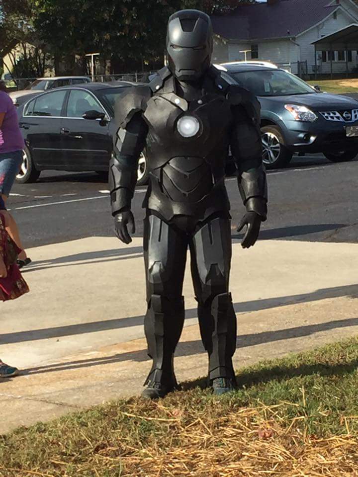

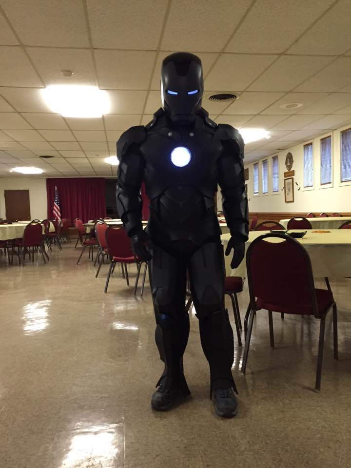

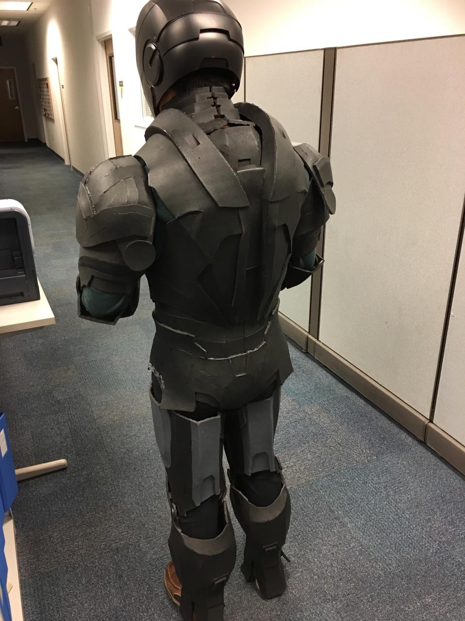

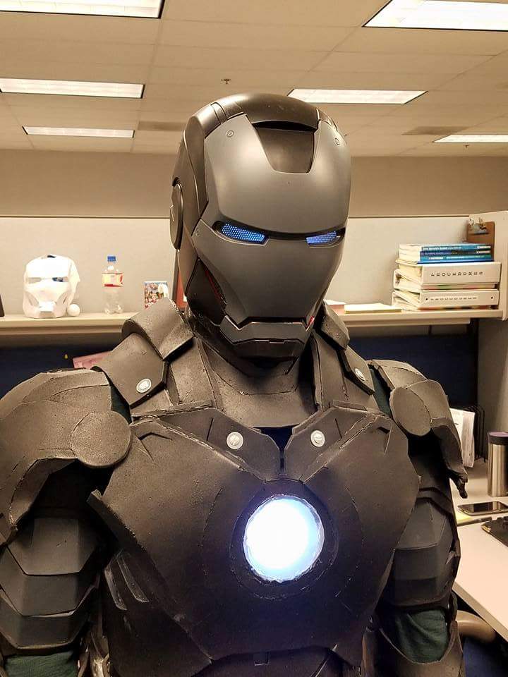

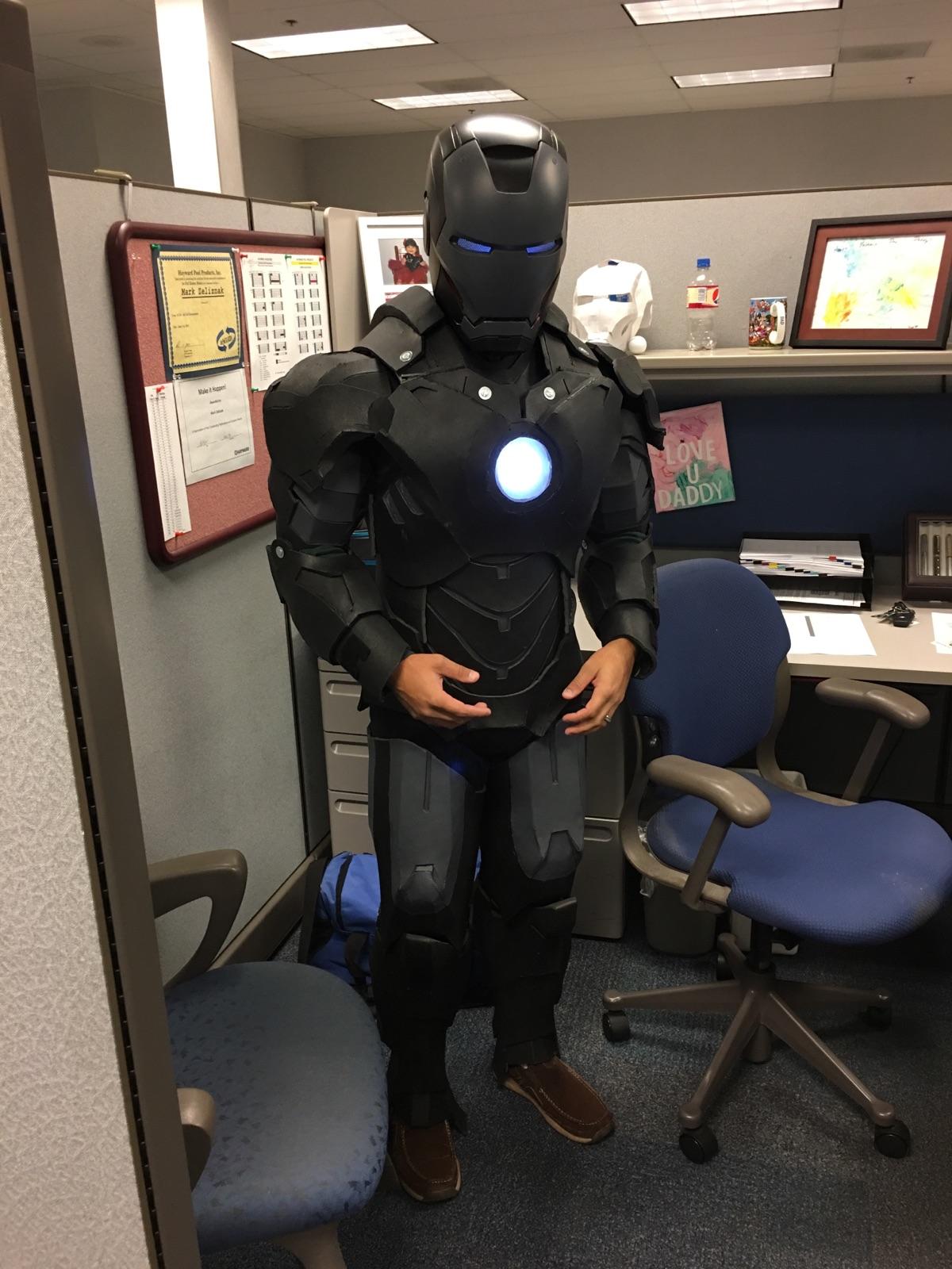

Here is my Stealth Project IronMan MK4 I made using JF's files. Bought the Marvel Legends Helmet and plastidipped it to match the rest of the paint scheme. Did not heat seal the foam, just went straight to plastidip. Used 7mm foam for the entire suit.
