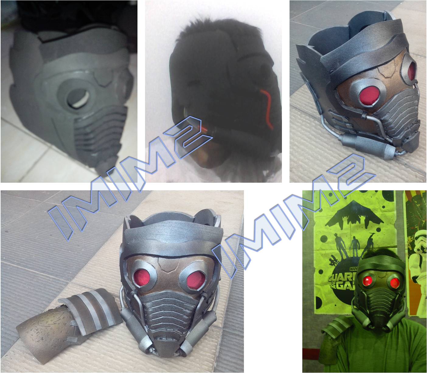

Hi JFCustom,
I just saw GOTG for the first time this week.
I had two days to prepare (or around 12 hours total) to come up with this.
Foam build is fun!!!
Thank you, and thank you Helagak for the shoulder armor
