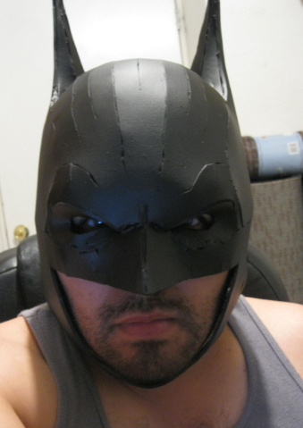

Hi!! just wanted to show my Batman Arkham Origins cowl, I made myversion because I want the eye to look smaller tan the model in here, so I made mine!!

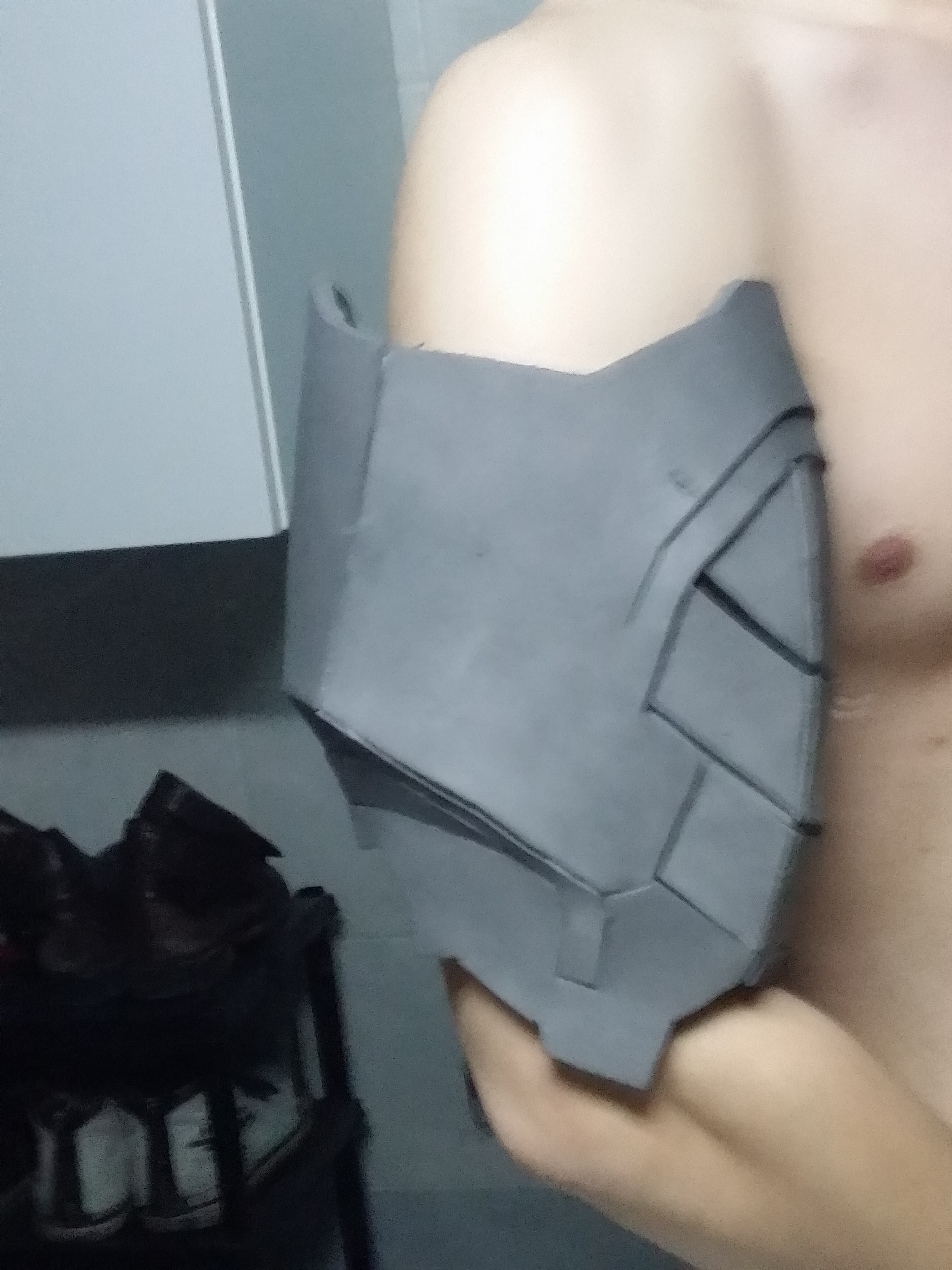

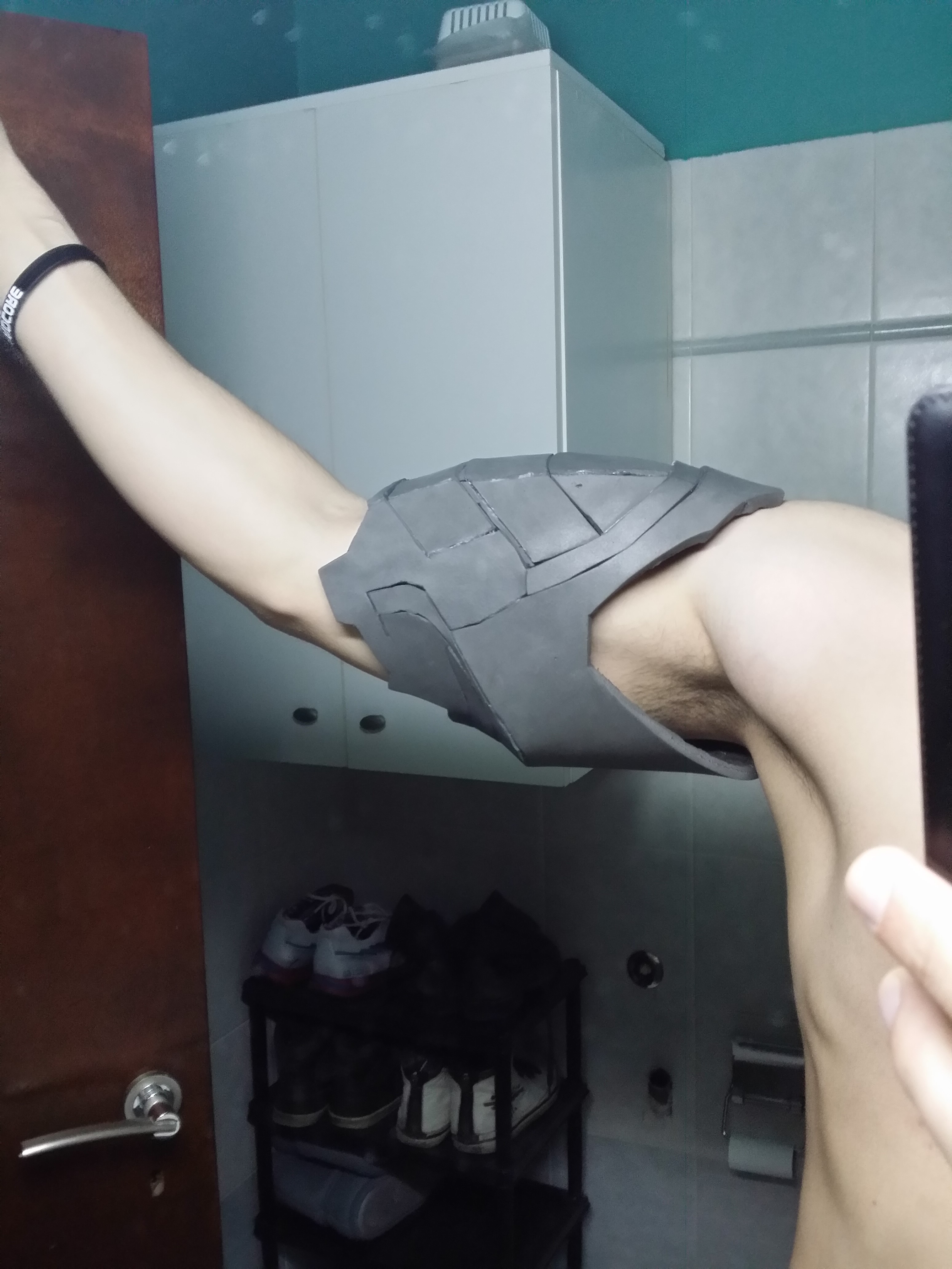

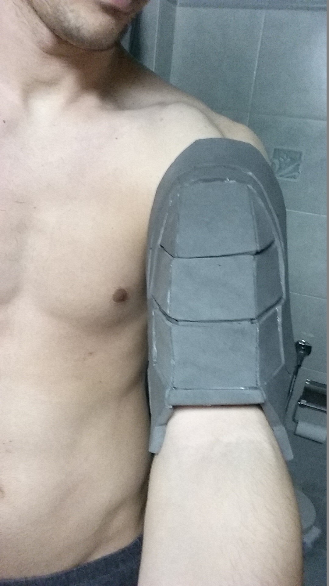

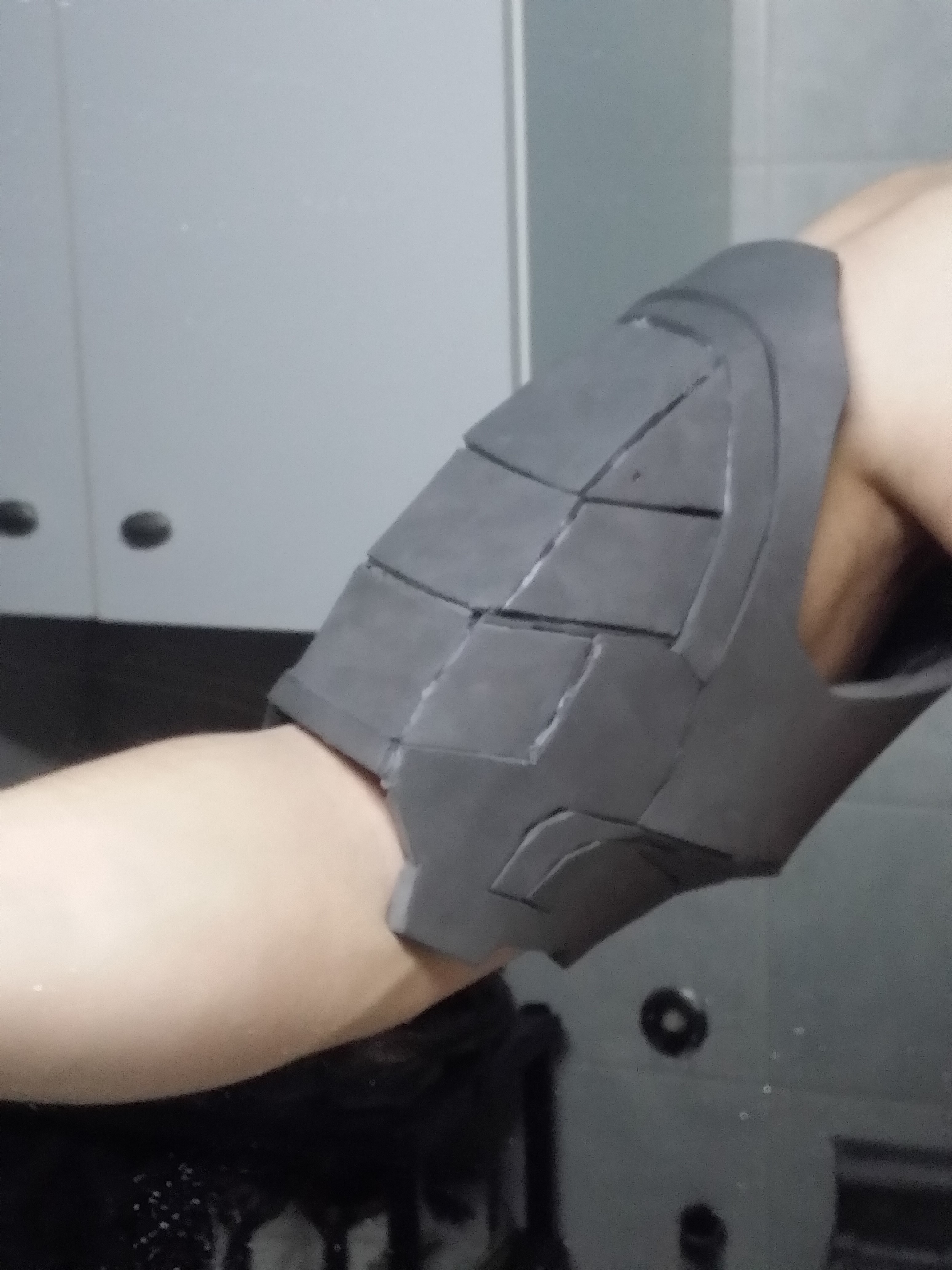

Better late than never as they say ... this is the bicep.. what do you think?

The difference between too big and too small is very fine. If it's too small, it will pinch your skin when you bend your elbow between the bicep and forearm joint. Foam is more forgiving in this regard because it is softer and does give a little. A fibreglass suit will cut you if you pinch between joints. If the chest is too big, then your bicep will hit it and you won't be able to reach your face to eat or drink or even scratch your nose while in costume. My first suit was pep'd and fibreglassed. Looked great, but I couldn't do anything except stand there.

I guess im gonna make the bicep a little bit bigger so its not to snug on my elbow.

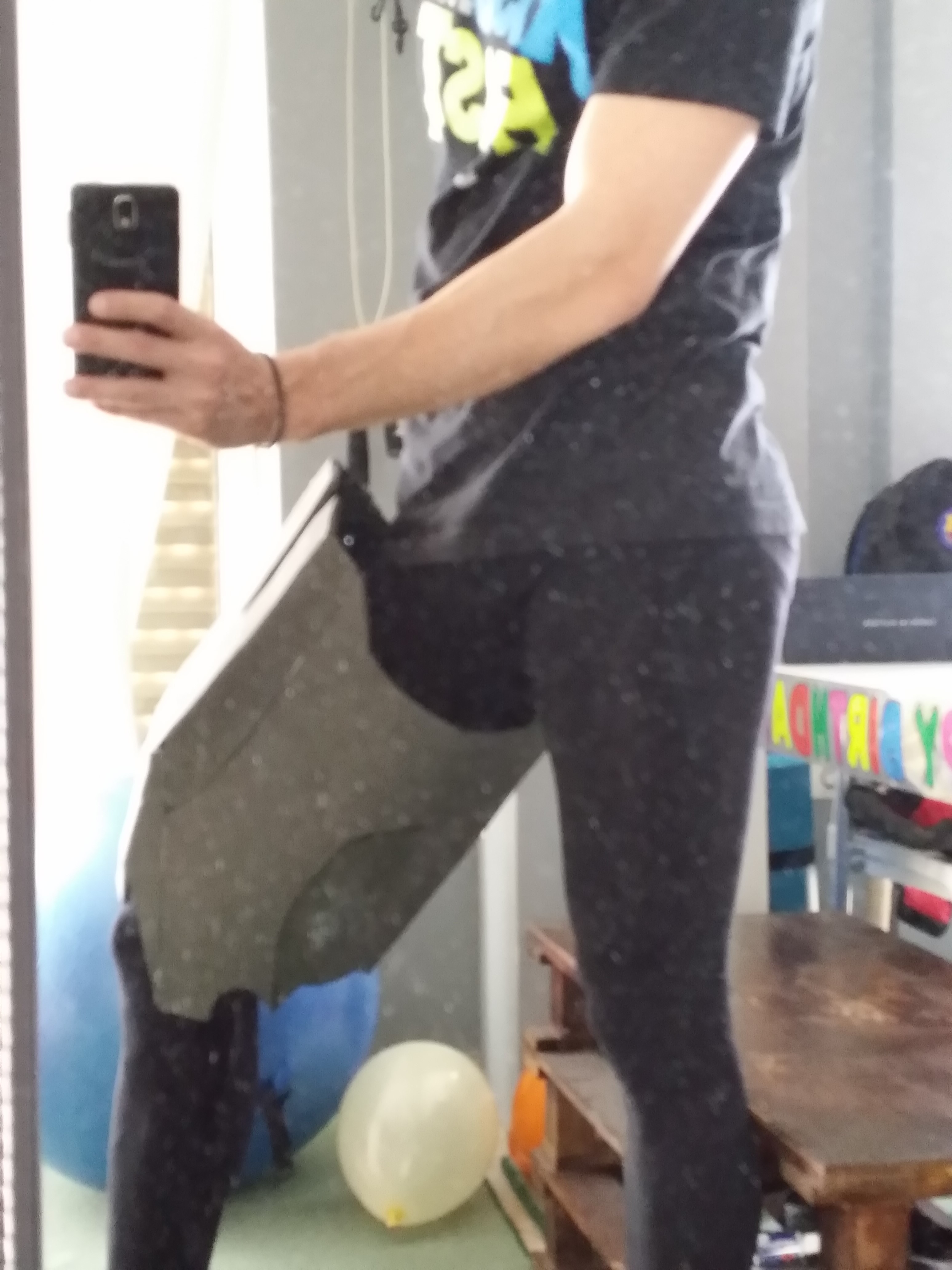

I also tried the thight but i think its waaaay too big. I'll upload a pic on a while so any opinion would be great.!
Thanks again and I hope everyone can understand my lower level English :p
View attachment 320088 View attachment 320089 View attachment 320090
Yep. That leg is MASSIVE. It should fit you fairly snug like this.
If you're unsure about the proportions, I would suggest making it quickly out of paper first (just regular computer paper - no need to make it out of heavy card stock) before you cut your foam. It's more work to print and cut it twice, but it'll save you foam in the long run (and time, since you'll hopefully only have to do the "good" foam version once). I always make a fast paper version first to test the fit before making it out of foam!
