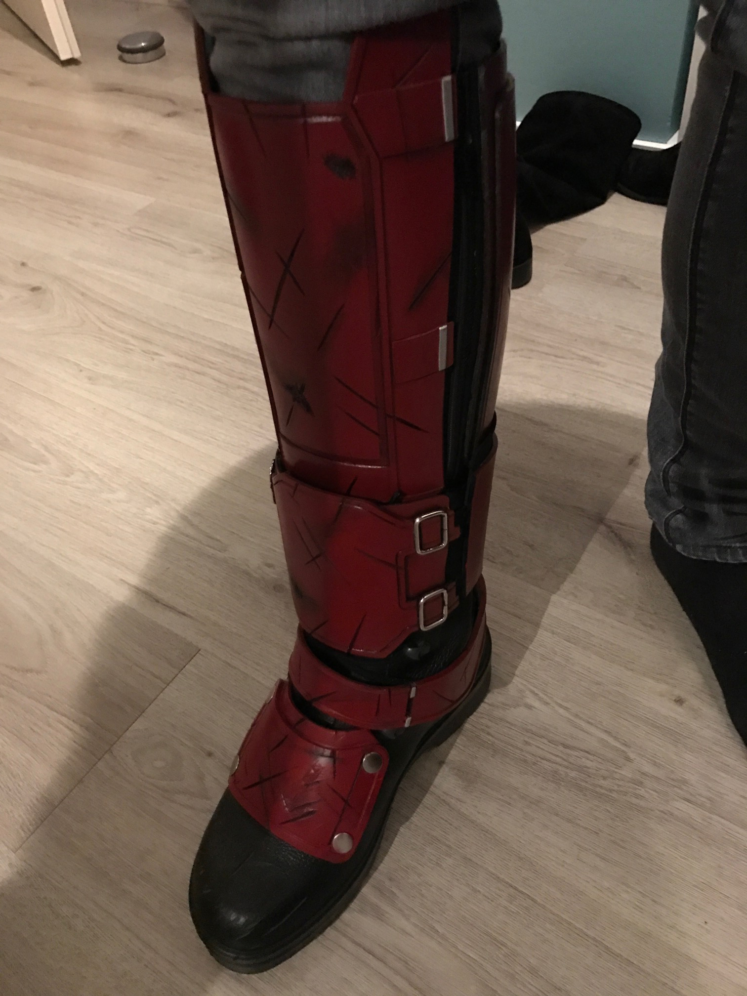

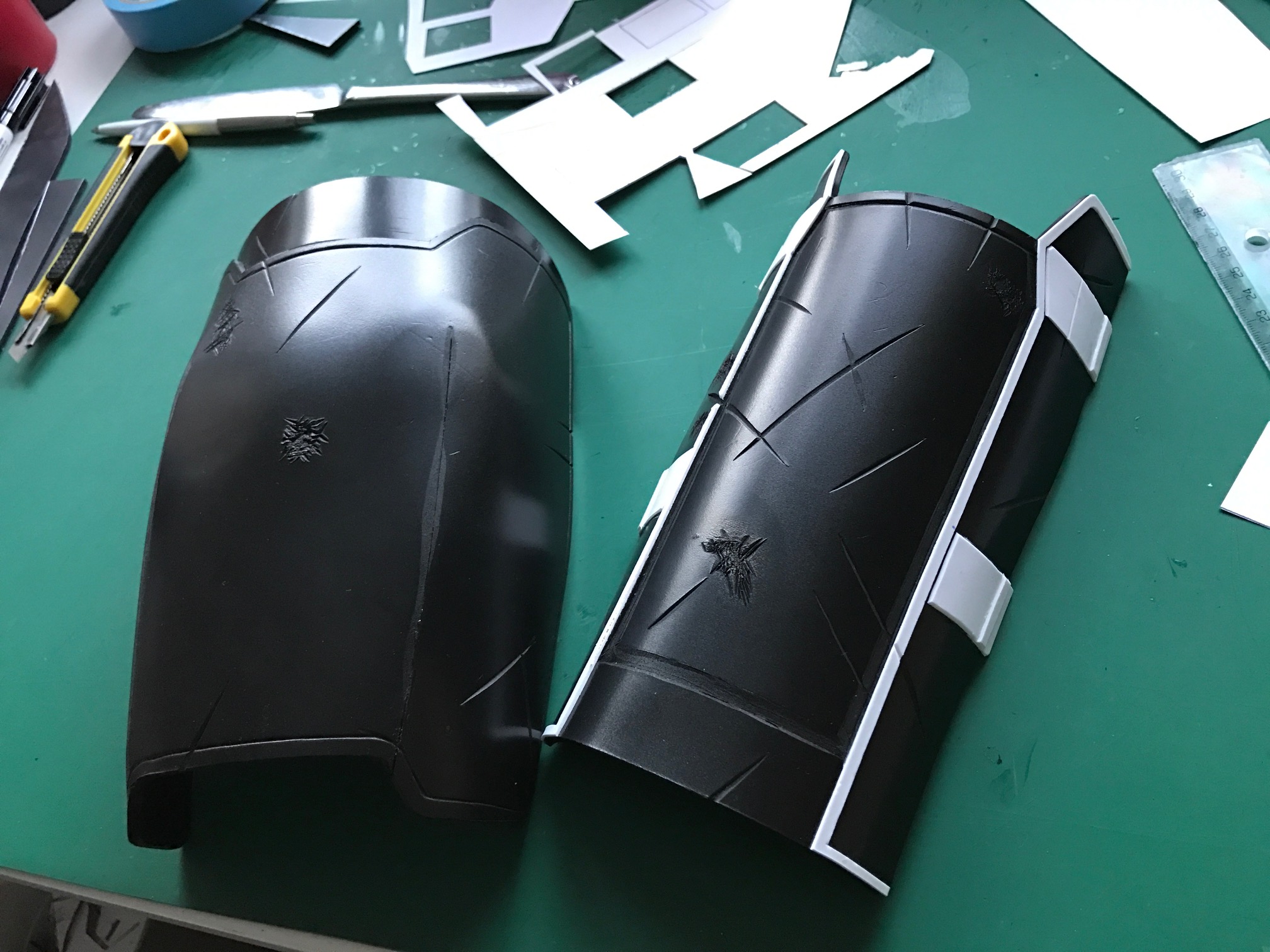

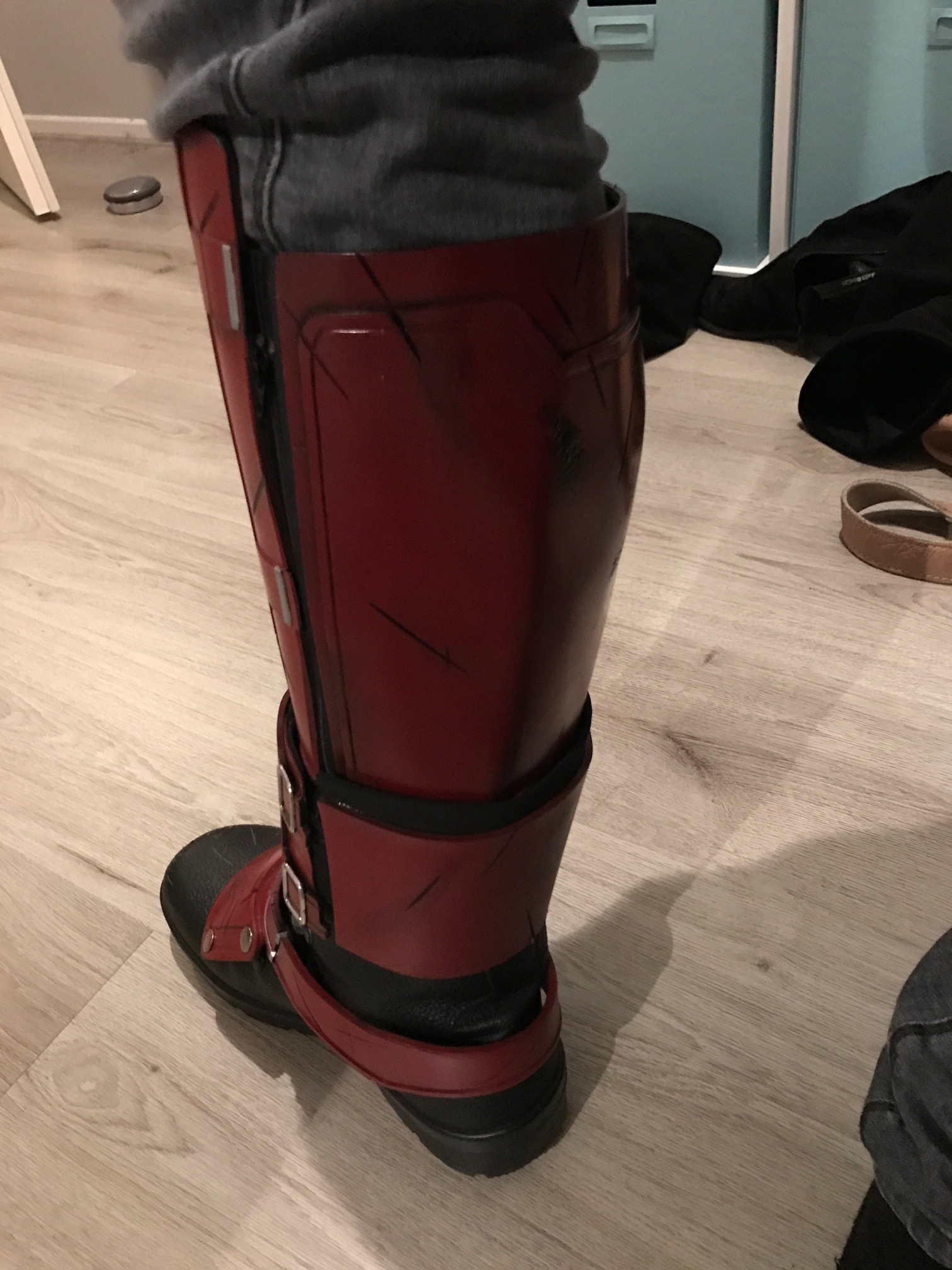

finished one boot. Damn they are really a pain in the butt. And definitly not without flawes. I dipped them but i think painting had been more longlasting. the have about 5 coats but the sharp edges and part that slide over on another will damage fairly quick. But whatever... heres the result:

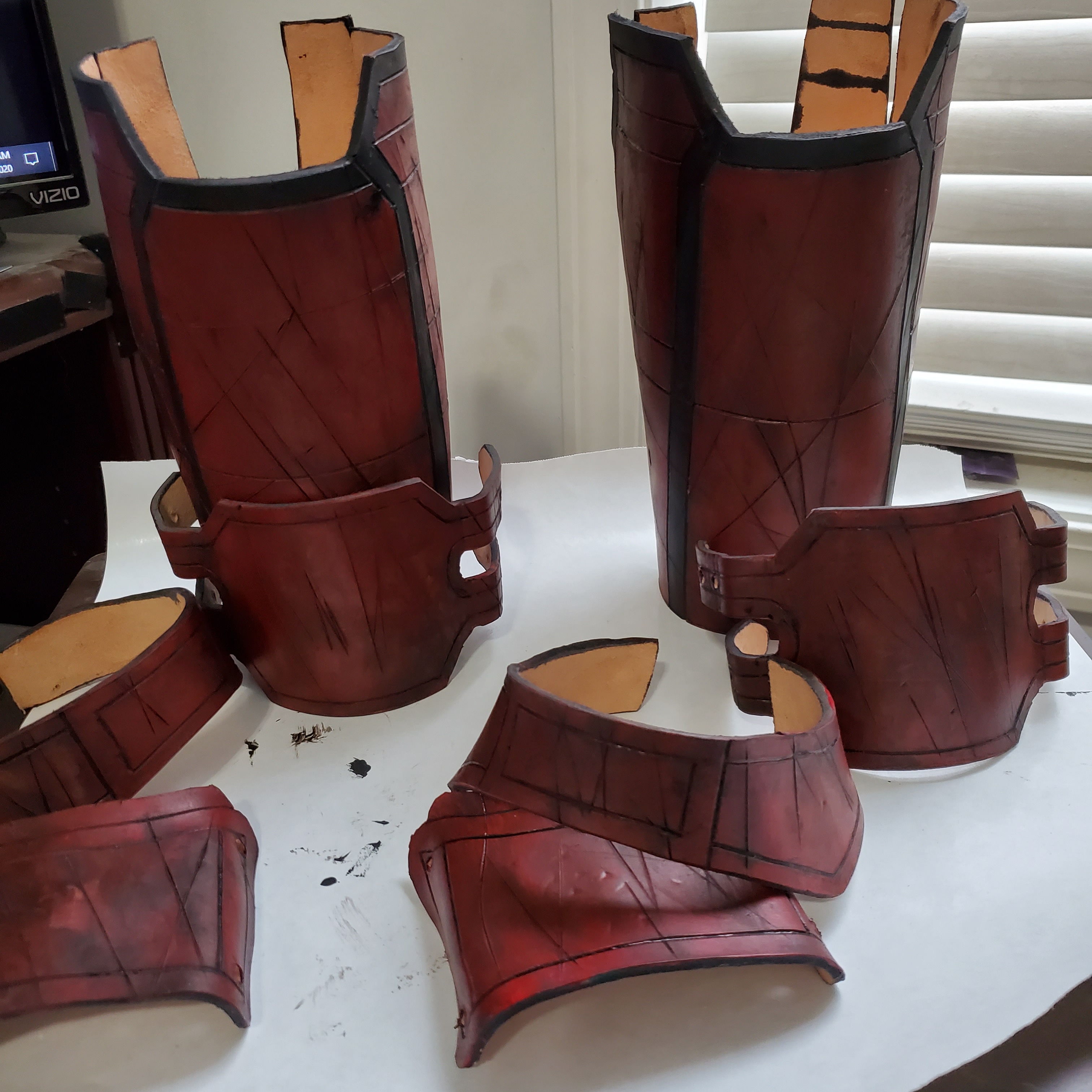

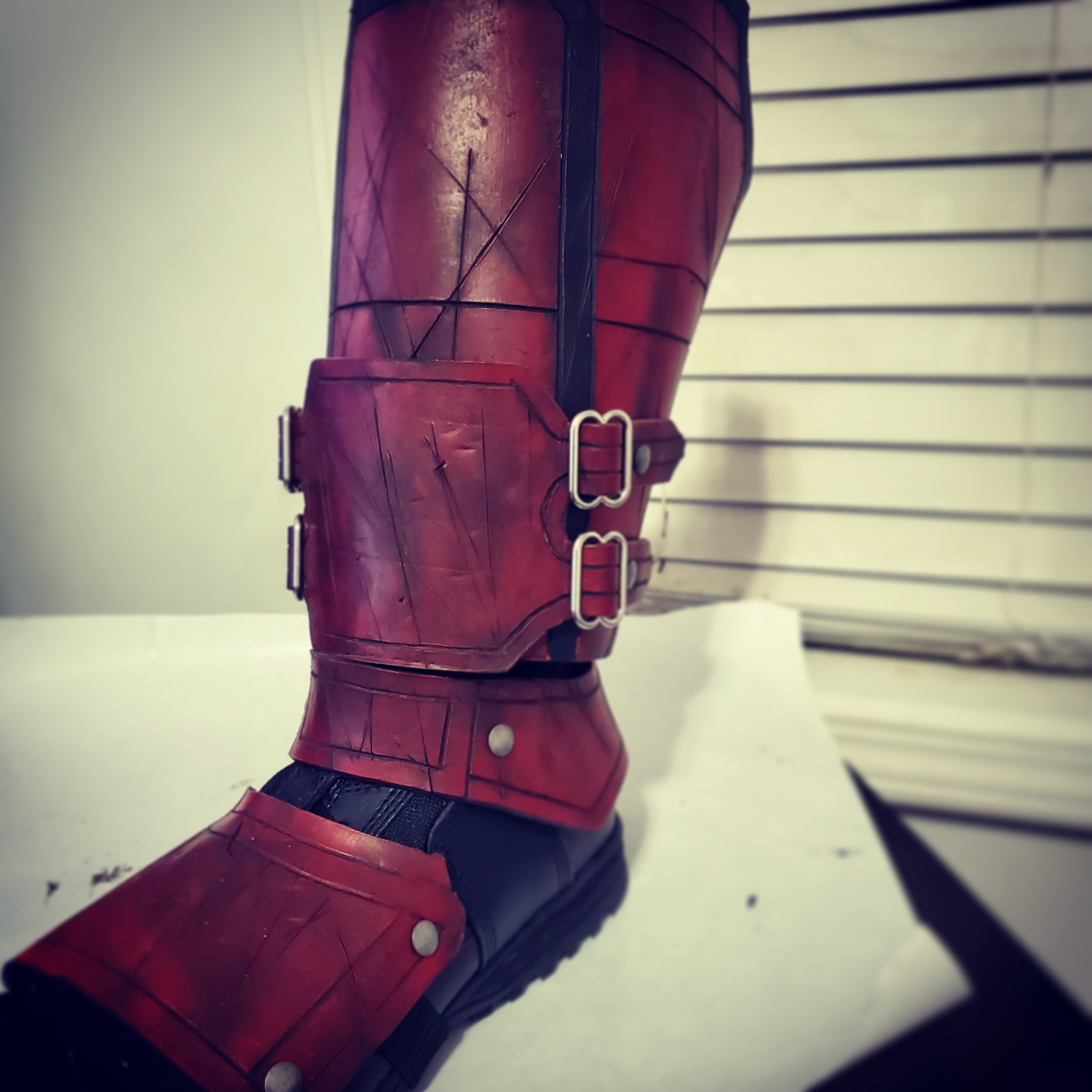

Sorry to revive the old thread but I used most of your templates to make some of the armor out of leather and thought you might get a kick out of. Thanks so much for providing the templates!

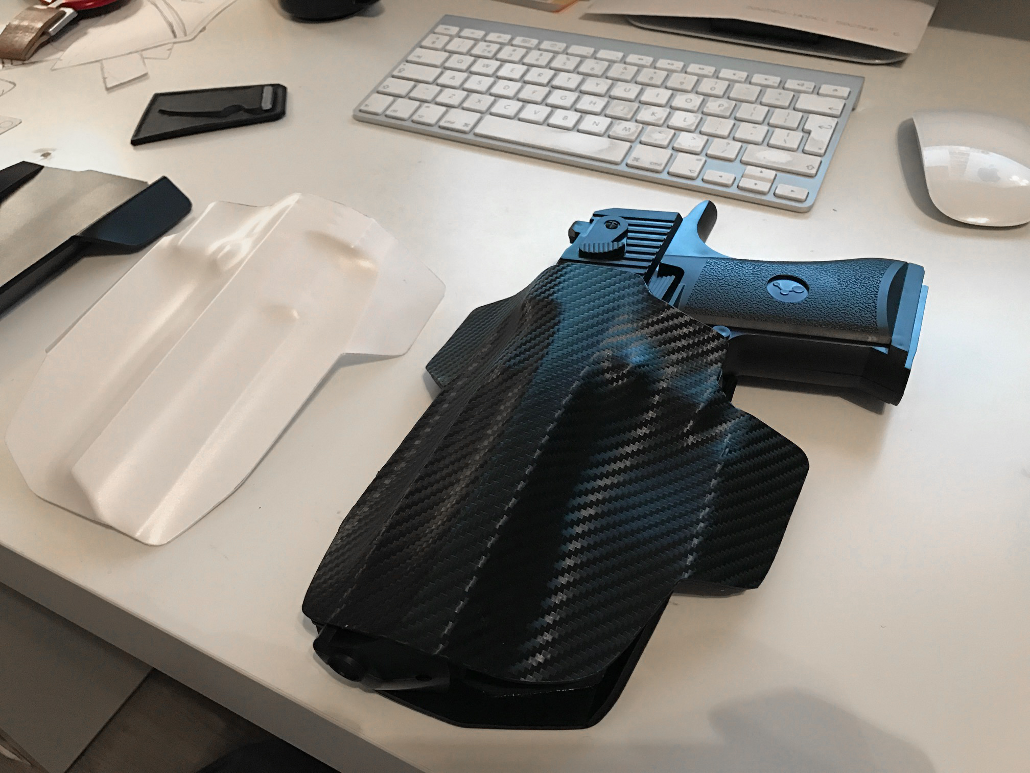

Received my Desert Eagle replicas. So first step.. make the Holster.
This is how i did it:
1. made a raw sketch of the front form, based on movie reference pictures.
2. Vacuumformed the top plate using CollinE83's home method. (Heatgun plus vacuumcleaner.) Material 2mm Sintra.
3. Trace the raw sketch onto the vacuumformed plate. And cut it out. (see the white plate in the picture)
4.Make a paper sketch of the back plate based on the formed plate.
5. Cut it out, heat bend it to shape. (also added some 2 mm foam on the inside for padding)
6. Wrap the outer plate with Carbon film from 3m.
7. Glue the 2 pieces together.
8.. to be continued, i will be adding screws and holes for realistic mounting look.
Result:
Can you please elaborate on the vacuumformed part involving the heat gun and vacuum?
