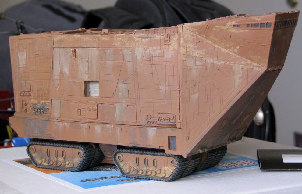

Mid-progress in painting, this reflects 3 or 4 coats of Tamiya X-9 Brown in various lightened and darkened shades. Also layers of Lifecolor UA703 “Rust Light Shadow” and UA706 “Dust Type 2” thinned (about 70% thinner) and lightly dusted over the model.
Some of the paint chipping has started toward the top of the model. Photos of the studio filming model seem to indicate that this paint color was yellow, but it always appeared orange to me onscreen, so I’m using the “Rust Light Shadow” for the chipping which conveys a dark orange color. It’s always intrigued me as to what this chipping indicated. Were the crawlers originally painted and now, after hundreds (thousands?) of years we’re basically just seeing the brown, rusted metal body?

And that’s a wrap for 2014’s modeling season! The last clear coats have been applied and the epoxy attaching the tracked wheels to the body has set up. The clear coats darkened the paint colors and I believe the overall effect is what I had intended.
This was a great way for me to end the year and I highly recommend this kit to anyone interested in the subject and not wanting to go as large as the Cooper 1/96 scale crawler.
