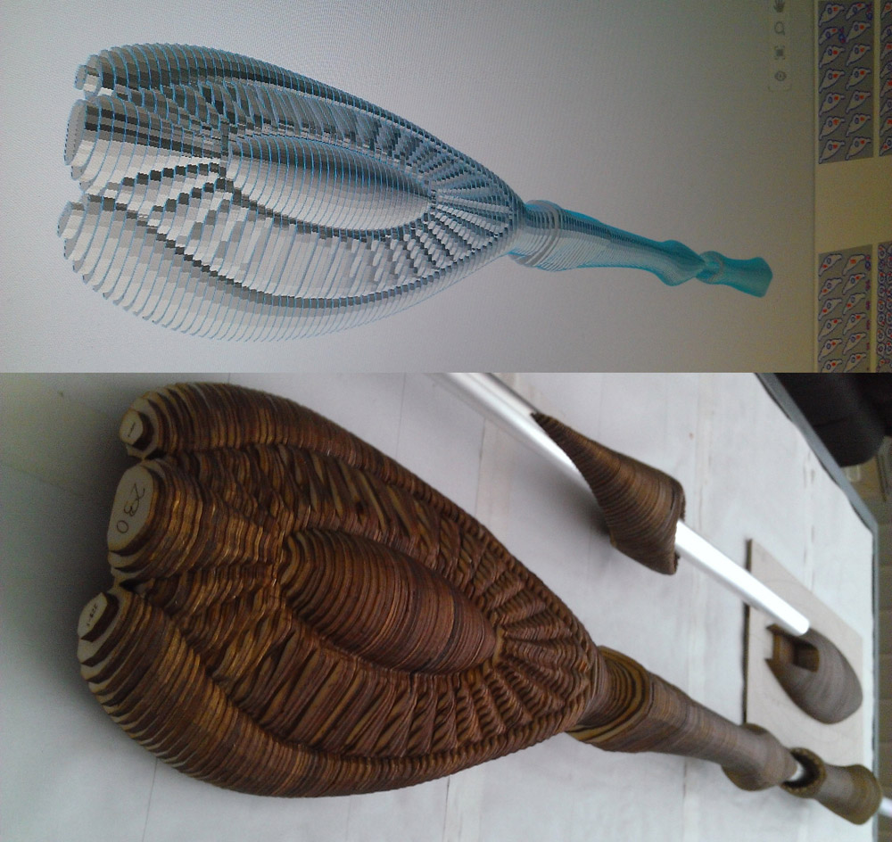

From that info and the obvious web search for reference pics, I photoshopped a 3 side view and modeled a rough 3d version in Maya.
Then I exported it as 3 STL files and used 123D Make to slice it in 3.85mm increments (the average thickness I measured from regular 4mm poplar plywood...not absolutely correct, as it turned out later...)
Did I mention, that I have access to a Lasercutter? :rolleyes
So I used it to cut some slices....well around 400+ slices in total...
sorting out...
aaaaand stacking (I made only half of the head-piece, because I planned on moulding them)
The 2 left over pieces are a tribute to the material-thickness-tolerance gods :wacko
I actually did the Head first as a test in 2,8mm slices and after realising the variation, sliced the other parts in 2,85mm
The 3d models for the parts which I stacked on the aluminium tubes already had a cylinder subtrackted, so the slices had holes in the right place.
