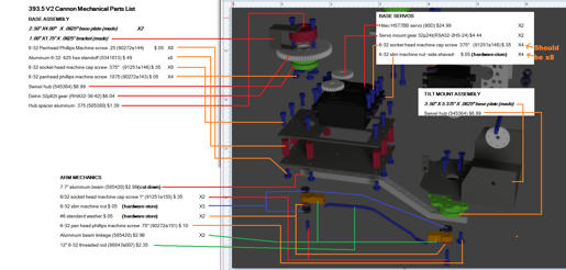

Has anyone tested the cannon using the schematics and servos provided I'm concerned if they're powerful enough for the pan tilt motion
The servos listed were used on a 3d printed version of the cannon, and they worked fine. A pepakura and fiberglass-finished cannon could end up with a lot more weight, then a higher torque servo could be needed (for the tilt function only). The actual cannon section is also happier if it's balanced so that the center of gravity is right over the pivot point. The guy I designed it for just added a little weight to the nose; it just reduces the torque needed a little bit for the servo to flip the cannon up.
I was also wondering how you use the swivel hubs and connect them. I see that the swivel hub uses the bearings so things can glide around but I seem them used in wheels and free non-servo motion. Do you attach each hub to an individual side (which i imagine just makes it swing in a circle without control) or do you bind have longer screws going through both hubs in which this would seemingly lock the swivel hub and prevent the ball bearings from rotating making the swivel hub static and unnecessary.
I've been trying to figure out the design of the cannon and while I think I have a rough idea its things like this that I was wondering if you could clarify
The swivel hubs are absolutely necessary; they work on each end of the cannon's mounting arm to allow the cannon itself to stay parallel to the ground as the arm it's mounted on rotates away to clear IP's head. It's hard for me to explain, but I'll try. First off, the canon arm has to rotate on it's base so the cannon itself will clear the back of IP's head when it tilts up. If the swivel hubs were not incorporated, the cannon would end up cockeyed, when it needs to stay level even as the arm rotates. The main cannon arm and the control arm next to it are set side-by-side and are identical in length. The main arm is powered by the drive gear to rotate out, while the secondary arm (and its mounting points) are what is forcing the cannon upper assembly to stay level.
Swivel hub in the cannon assembly's base: Lower half is bolted to the base frame. Upper half is bolted to both the main cannon arm and also the main drive gear. That main gear is meshed to the servo gears that drive it, preventing the swivel hub from spinning freely. When the servo gears are powered, they then rotate the main drive drive gear, causing the arm to swing out away from behind IP's head.
Swivel hub under the tilt mount assembly: The lower half is bolted to the other end of the main cannon arm, while the upper half is bolted to the tilt mount assembly. The only thing keeping these pieces from spinning freely is the secondary arm (the purple one below) that runs parallel to the main control arm. This secondary arm is what forces the upper assembly to stay level relative to the lower base assembly, it creates a parallelogram with the main arm and turns the upper hub to compensate for the turning of the lower hub.
Hope that helps a little at least. It wasn't the most elegant design, but adding a secondary servo to do the same job would have added too much weight up top.
