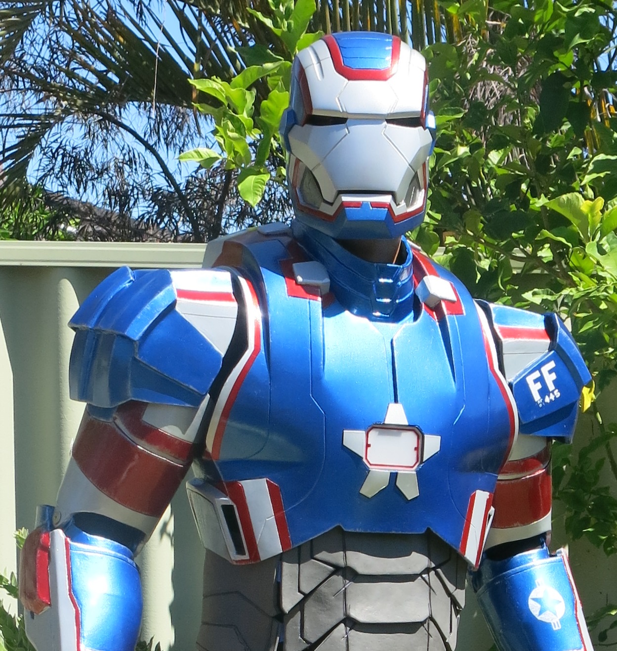

what color paint for the blue did you use? doesnt look like foam, so you did a great job there!
amazing work dadpool!
thanks Torx... its a standard automotive metallic paint, it's called "winning blue" here in Australia, the code for it is pj8430, it brightens up alot in the sunlight, in shade it darkens a couple of shades. it was the closest to a gunmetal blue i could find.
