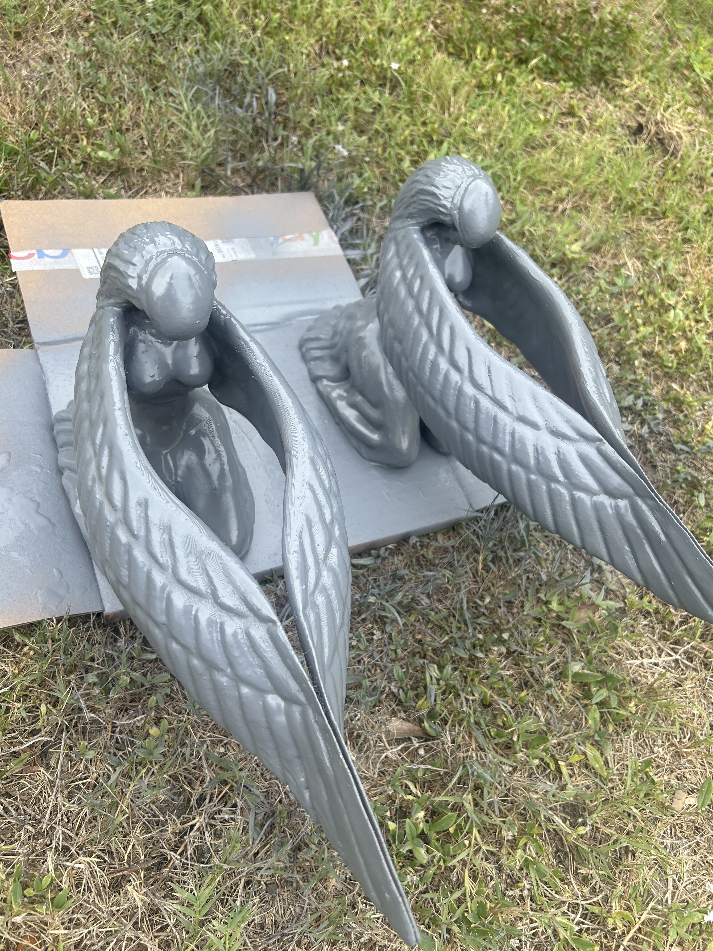

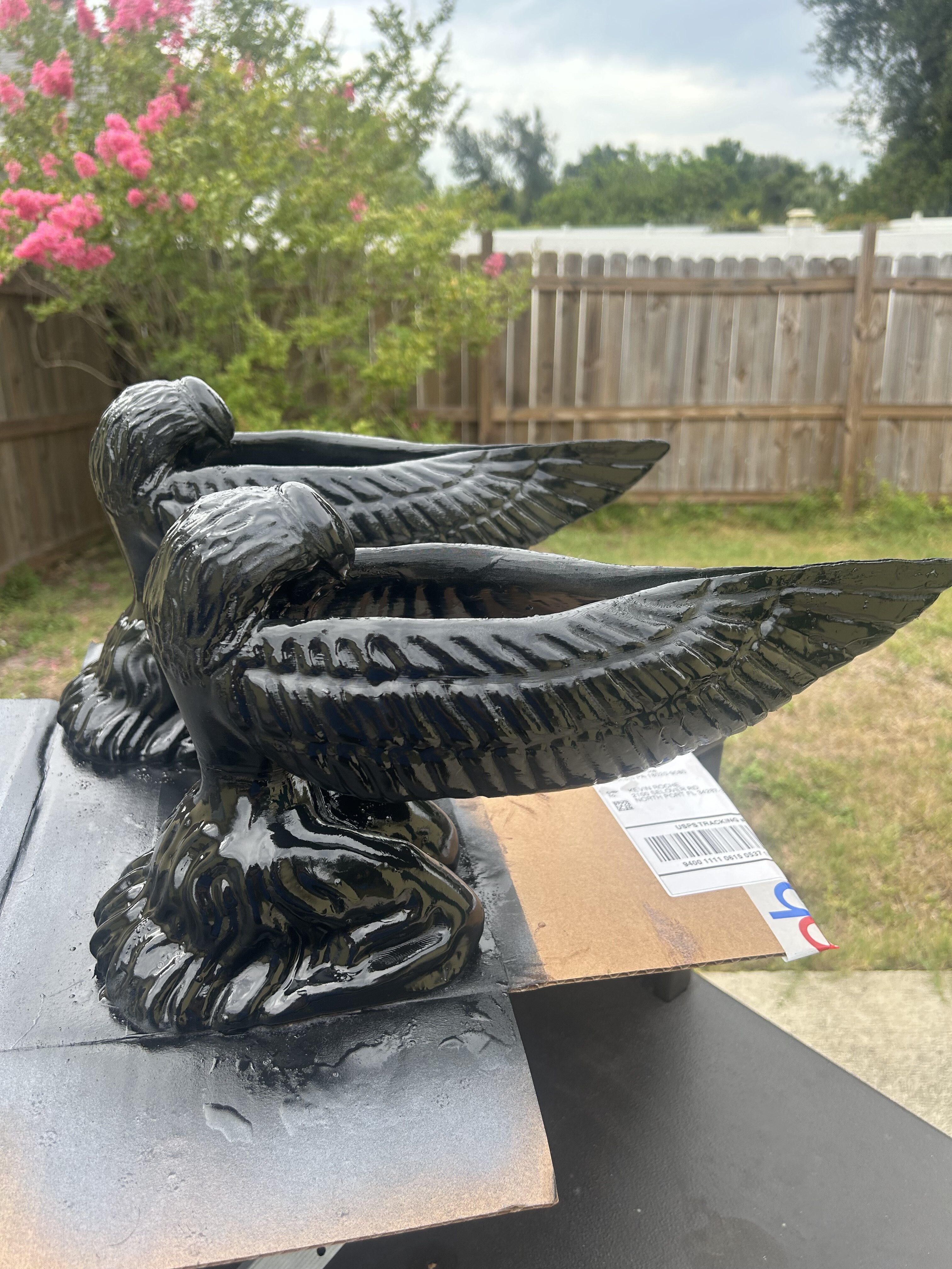

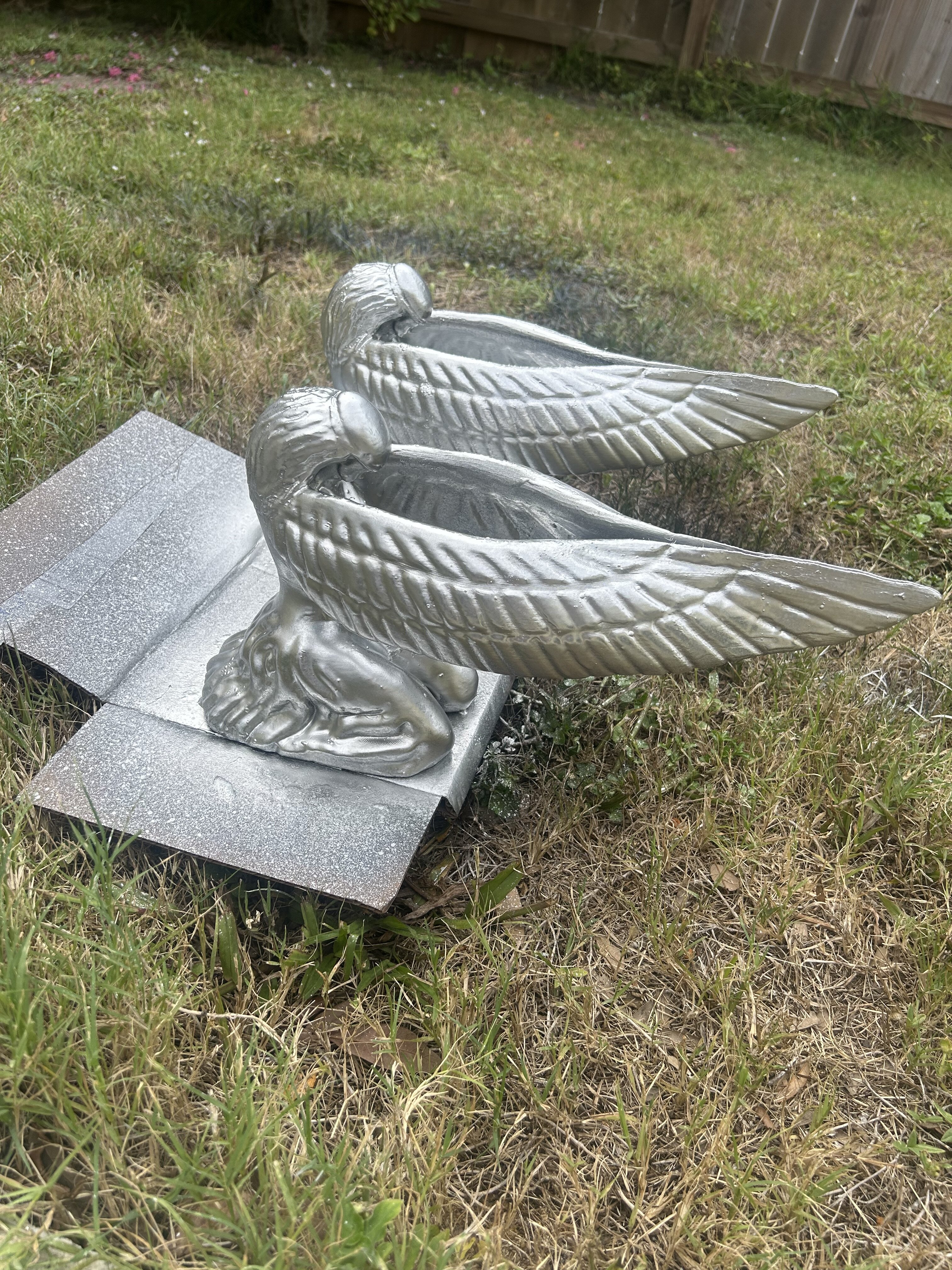

Can't wait to see. Just do it now. No need to wait. LolFirst test for gold finish
Im using Spaztix base black under spaz tix mirror chrome
Need to let it sit and polish the chrome finish tomorrow and then I will try the gold
Too bad these aren’t accurate but definitely worth a finish and possibly the results I’m looking for. The photo looks bland but it's much shinier in person.
View attachment 1937388View attachment 1937389
Most clear coats destroy these chome paints. If you dont get good results try oil based poly. Its not as hot.First test for gold finish

Yeah definitely don't do anything clear coating one top. I tried that test. Looked horribleMost clear coats destroy these chome paints. If you dont get good results try oil based poly. Its not as hot.
