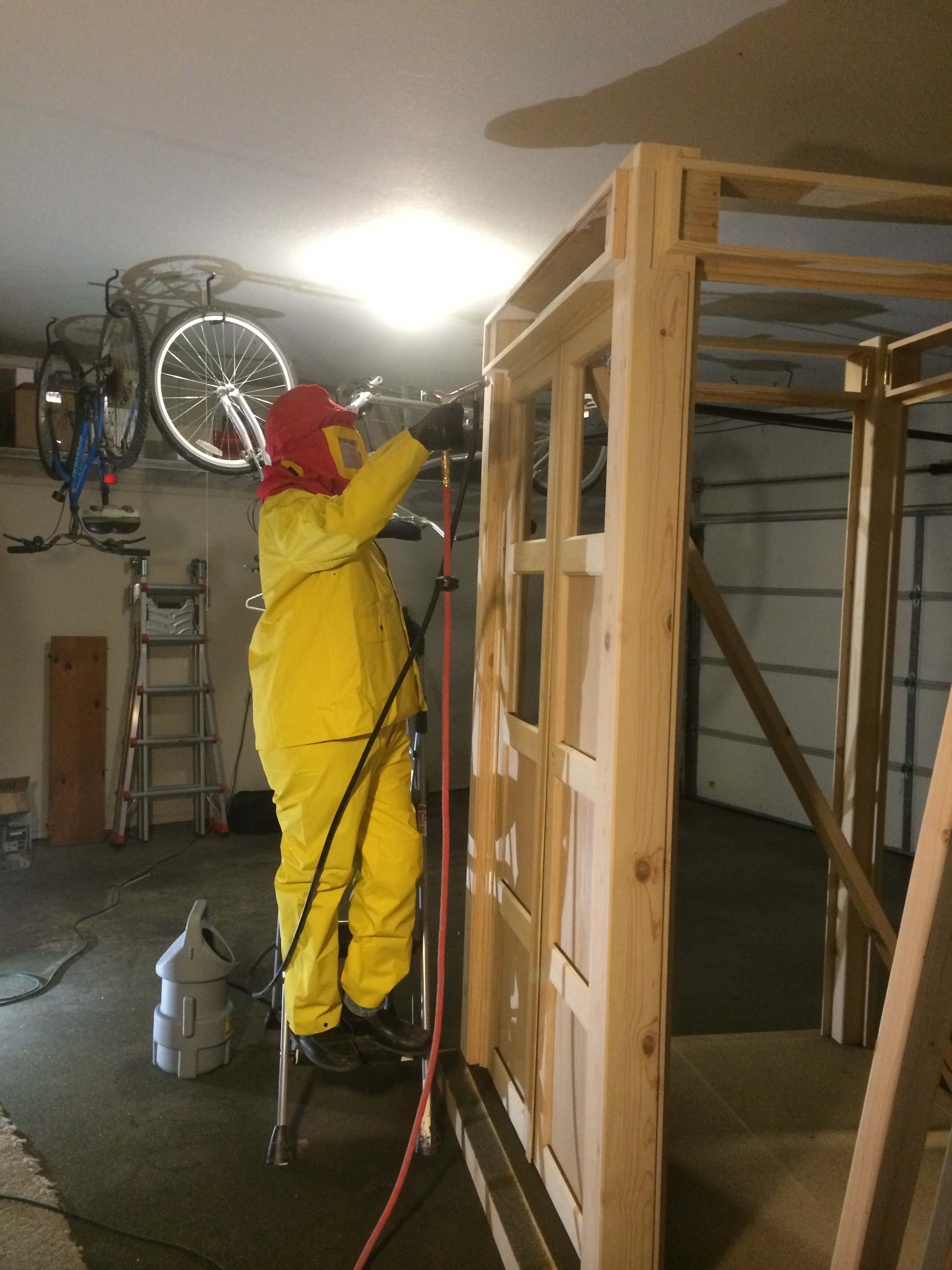

Time for sand blasting. One of the things about the BBC prop is that the wood grain is very visible. Being literally out of time, I was contemplating skipping this step because of how time consuming it is. But I decided that I would kick myself later if I didn't take the time to do it.
@Rebelscum did his. @MattMunson did not, but was pleased with the results.
Decisions... Decisions... I am glad I did.
It turned out it was a lot easier to take the TARDIS apart and sandblast the posts and panels on a saw horses. BTW... if you ever get a chance to do sandblasting in your garage, you are going to "enjoy" weeks and weeks of cleaning up. It was freezing outside which is why we did it in the garage. A friend of mine, Sam, helped with the sandblasting. Ok... he volunteered, and so I didn't refuse his help, but I think he was a little overwhelmed once he started, and I totally took advantage of the "free" labor. (I gave him treats!)

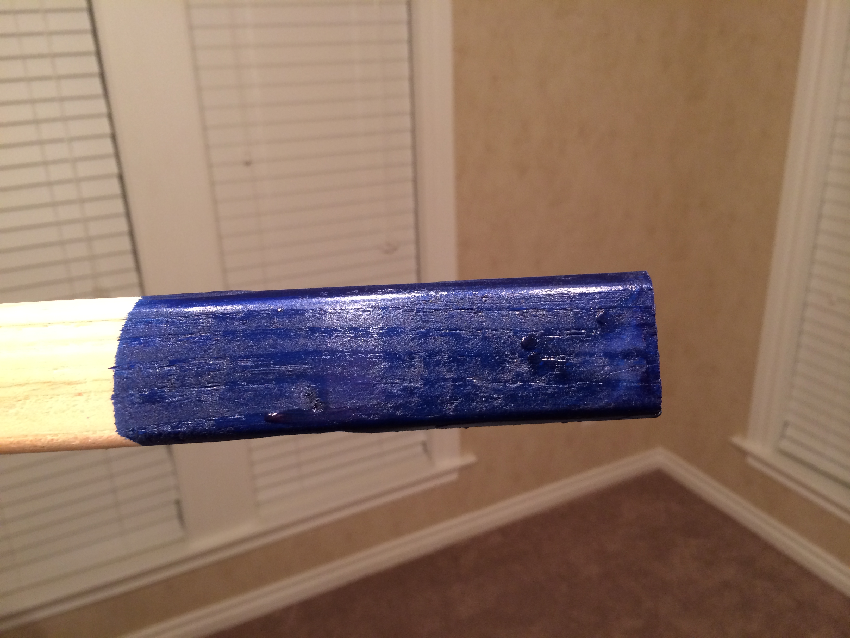

Now, I am doing some final sanding with a sponge sander, and steel wool to remove and smooth the surface as much as possible before painting... VERY IMPORTANT, or the paint will be very rough and will not adhere as well to the wood.
I used: 97-98 Subaru - 55A Sydney Blue Fast-dry Acrylic Enamel SS from O'Reilly Automotive. It isn't cheap stuff.
You will need a gallon to be safe. I used an paint sprayer that I bought at Harbor Freight.

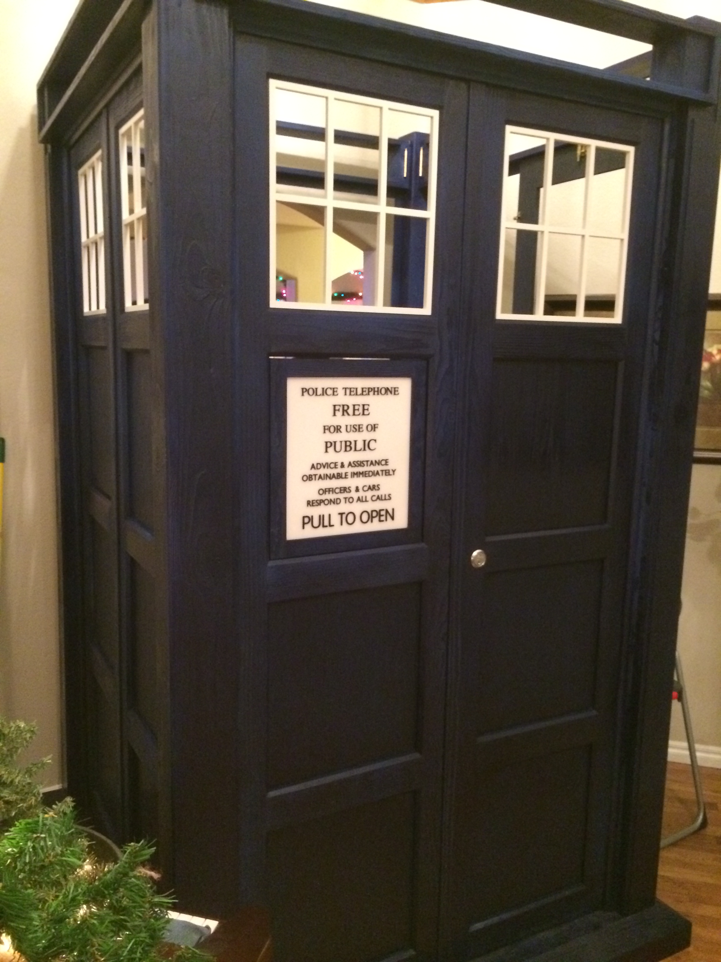

And now the reveal...
Here is a top view... (without the roof... still have to build it)
There is still a lot to do yet. The windows, signs, hardware, roof, lamp, lighting, sound, and making it smaller on the inside... I mean "bigger".

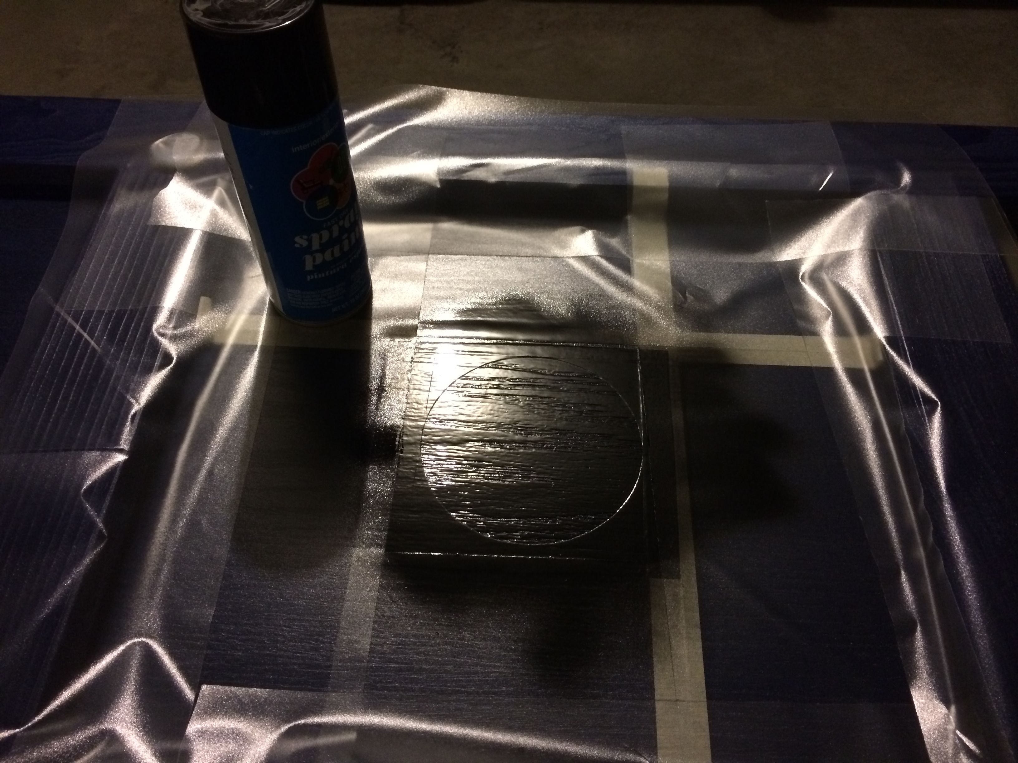

What we have is two templates. The first is the black circle that is painted first. The second is the mask template for the white paint. The face detail was too small to keep, so I will do that part by hand later.

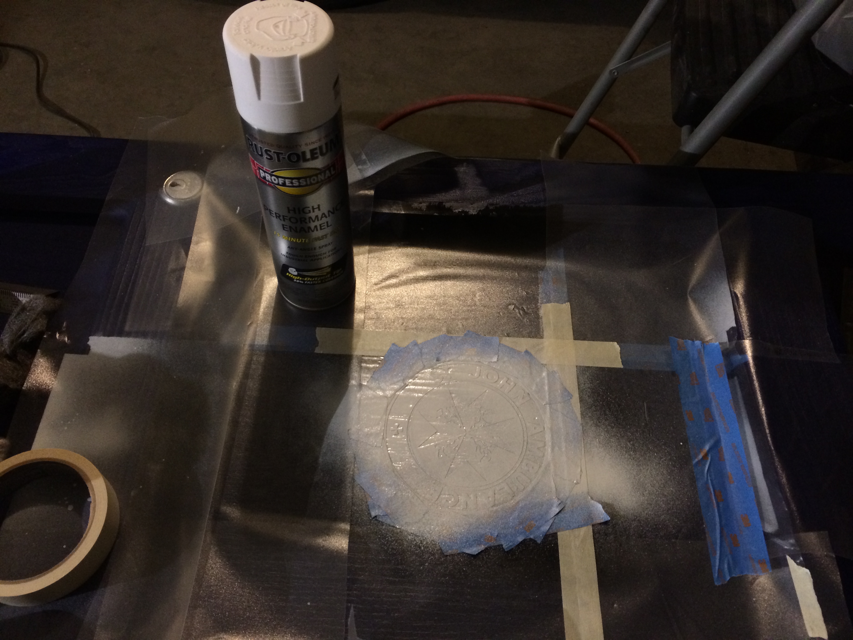

I used the masking tape as a guide when lining up the vinyl. Once it was laid on the door, I masked around it to keep from the over spray. ONE WORD ABOUT PAINT... Cheap was NOT a good idea here. I had to REDO this door a couple of times for different problems I had. Since the paint was not drying quickly, it would want to lift the vinyl and bleed through. When I did the white paint, it was very obviously NOT good.
Since I was using enamel based paint, I decided to buy both black and white "quick dry" enamel paint from Lowe's. This worked! Peeling up the vinyl left nice crisp lines.

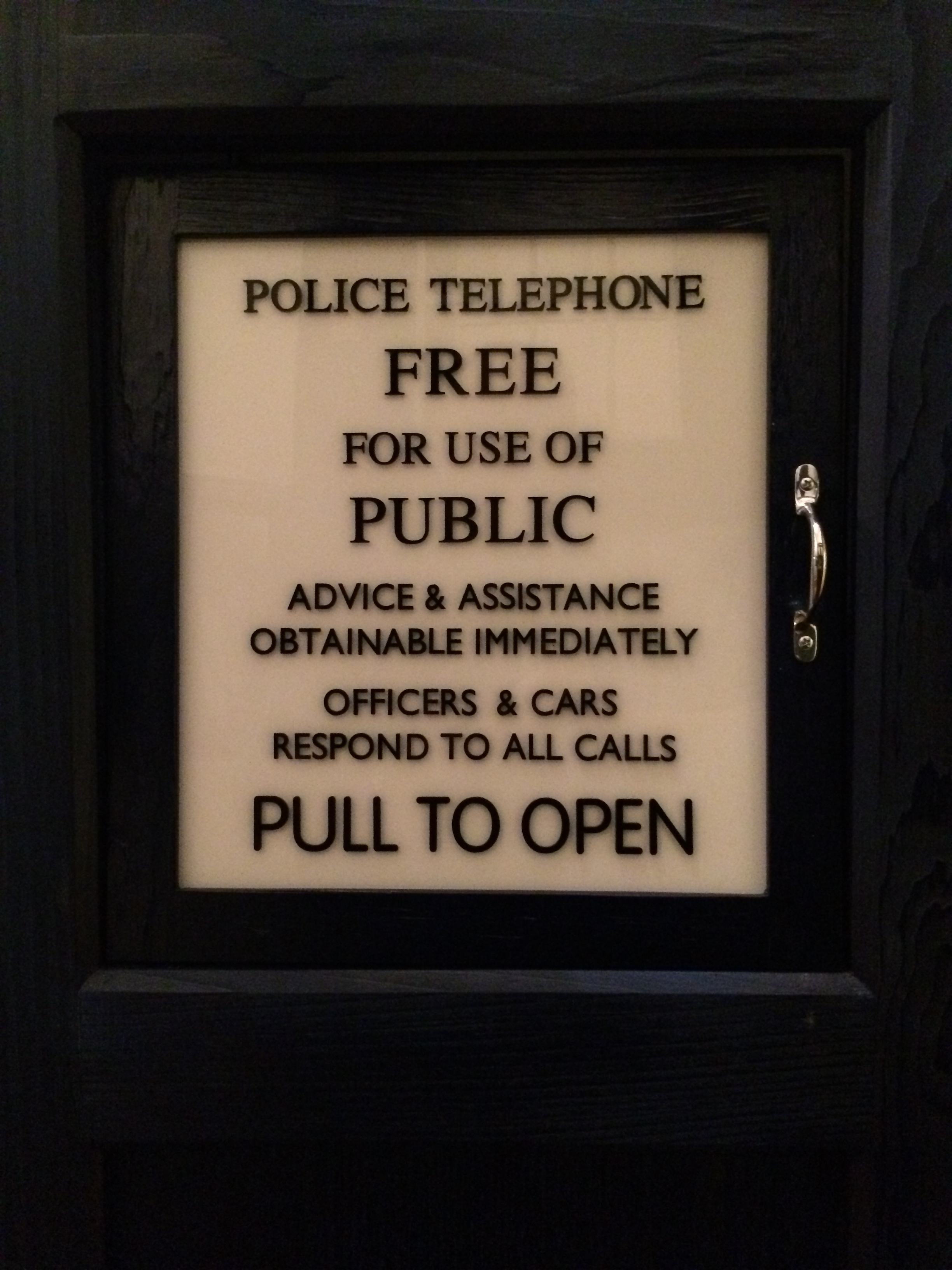

Here is the final sign on the door. The face detail was added with a fine tipped Sharpie.
It isn't perfectly the same, but it is close enough. I am glad I didn't notice the difference before I painted it, or I would have spent hours and hours trying to make it "perfect".

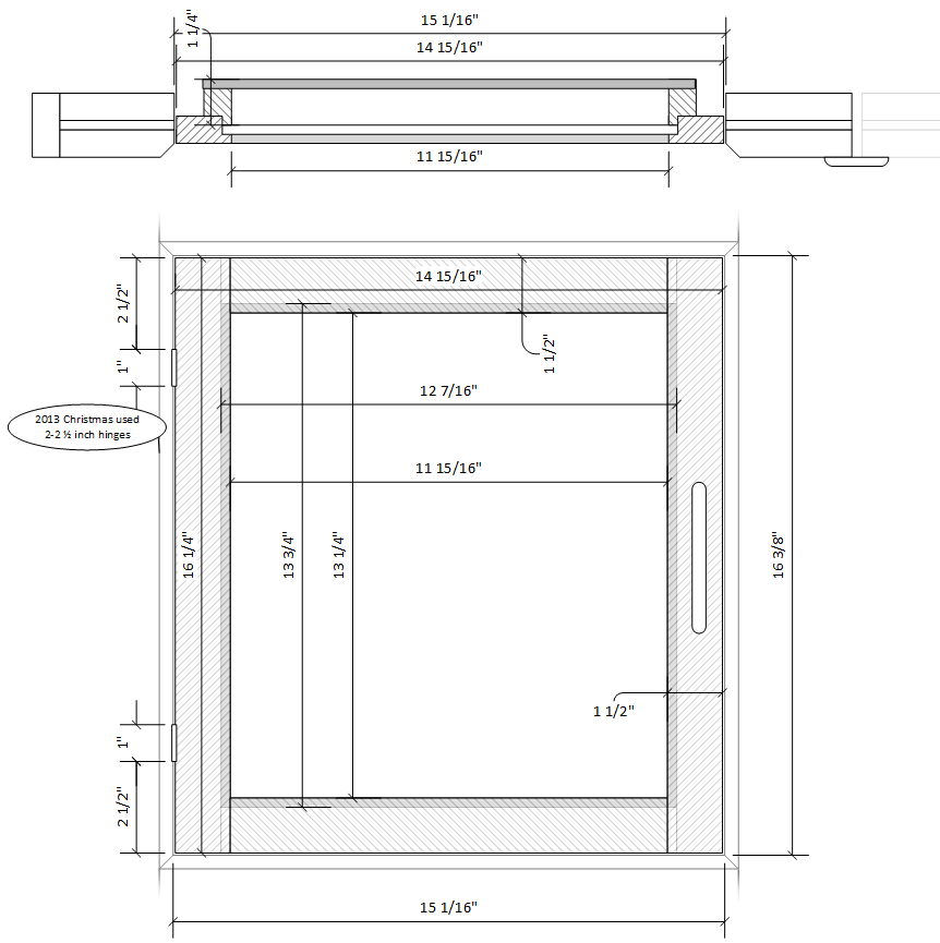

Working on the light box for the back of the door sign, what I am wishing to duplicate is as you see pictured in the Christmas special 2013. - Got to love PVR's!
You can see the sign is lit from behind the door from a light box that is approximately 1 inch deep, and inset from the edge of the door.
Start with cutting the rabbet in the pieces for the frame, and laying it out in the back of the sign.

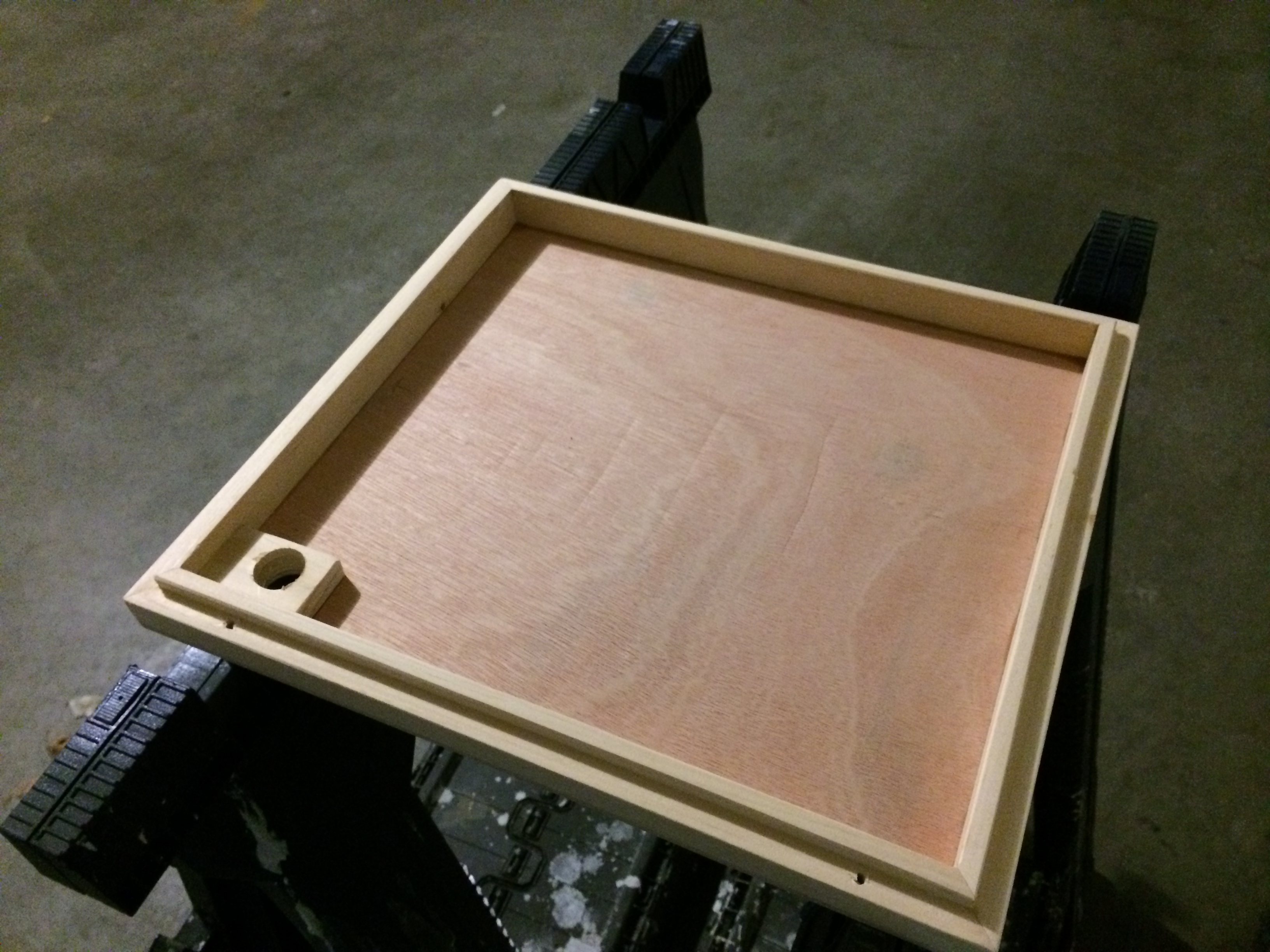

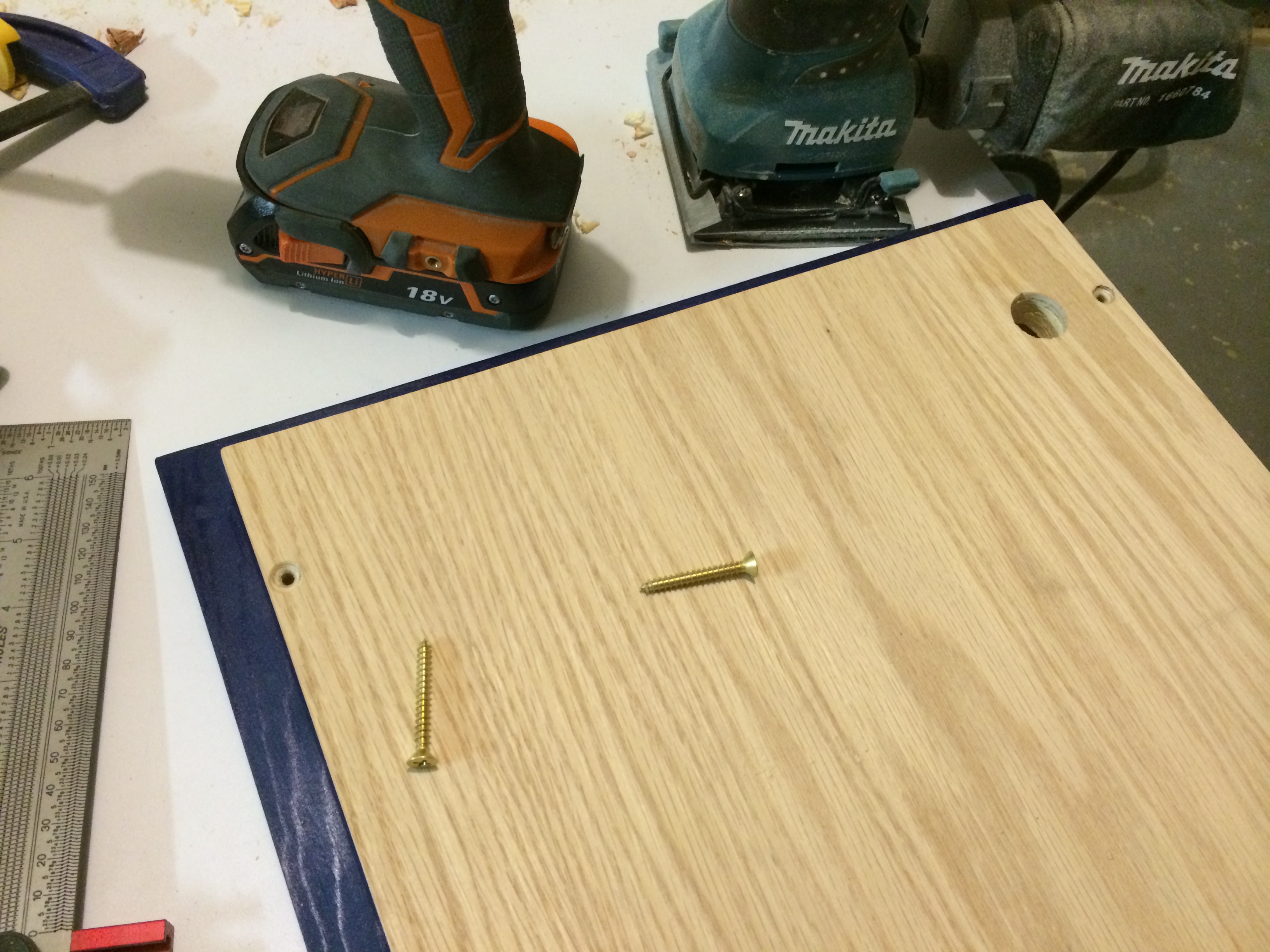

I glued on a piece of oak plywood on the back from a window cut-out. When it was dry, I used a flush router bit to trim it to the frame. I added a small block where the XLR jack will be mounted, and cut a hole for it.
I make sure it fits, and pre-drill the holes for the brass screws to hold the back in place. I paint it white on the inside and blue on the outside.

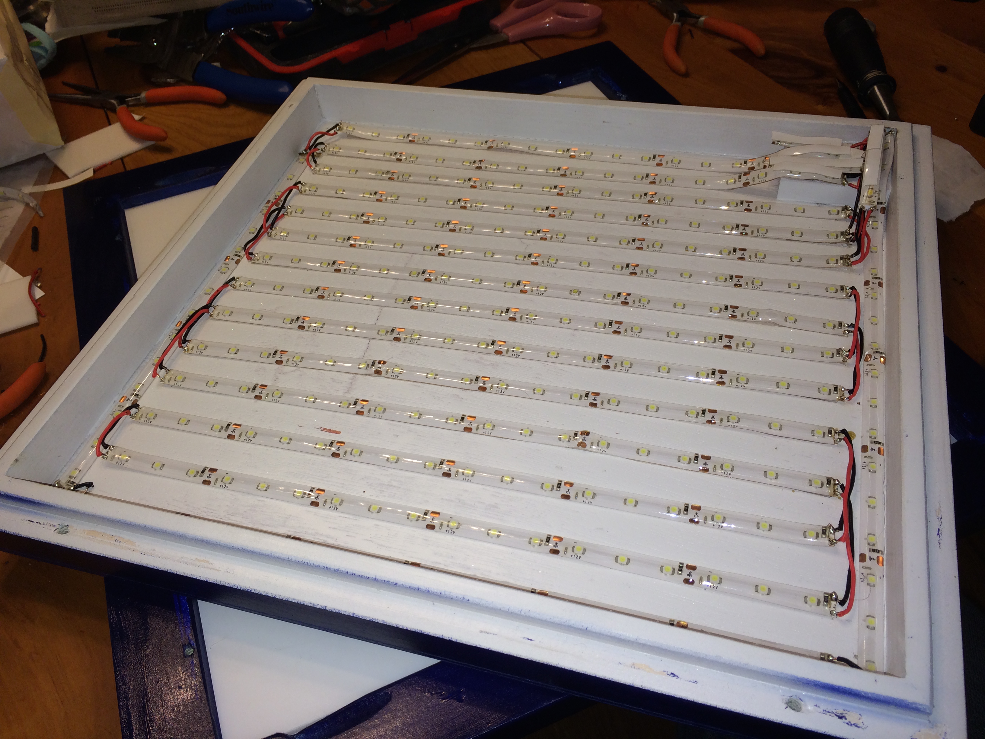

Now I lay out the LED strips, and solder them together.

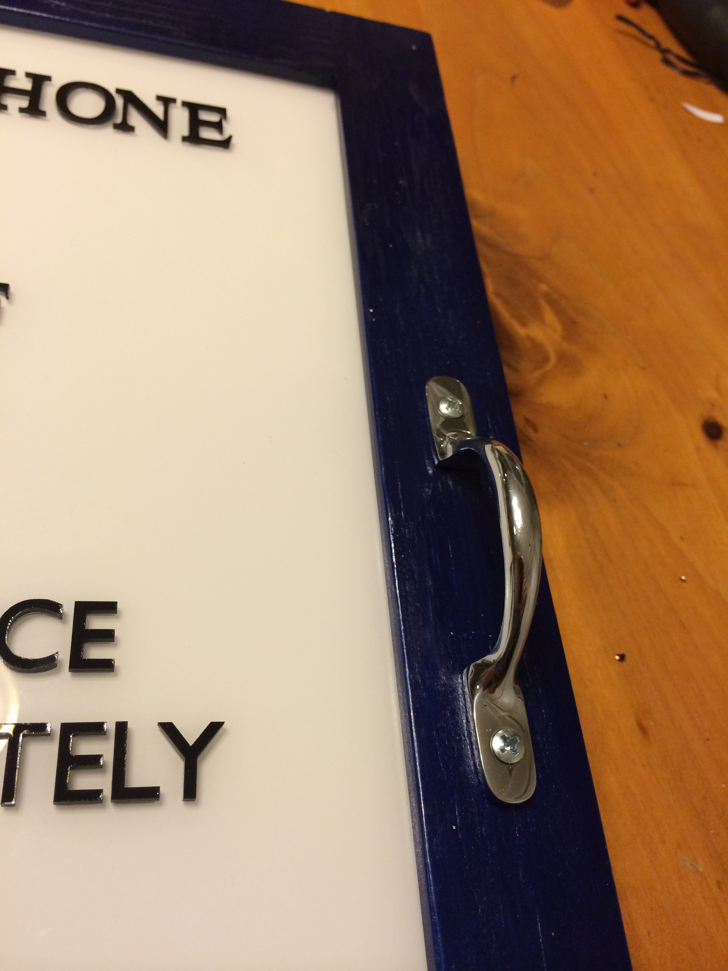

This might be a helpful picture for someone wanting to match the hardware in the U.S. Do you know how HARD it is to find these "simple" door handles? If you lived in the U.K., you will be fine because you can order them off of Amazon U.K. I've ordered from Amazon U.K. before, and they will ship Region B videos to the U.S. with no problem. (Region B only works in the region of the world where the U.K. is.) But you CAN'T order $5 door pulls and ship to the U.S. from Amazon U.K. I could only find one U.K. hardware store that shipped internationally. Housegoblin Hardware.
NOTICE: In U.S. Dollars at the current exchange rate: $5.58 hardware + $47.18 International Shipping = $52.76 Delivered
I had to find some different screws for the sign door because the ones provided were too long.

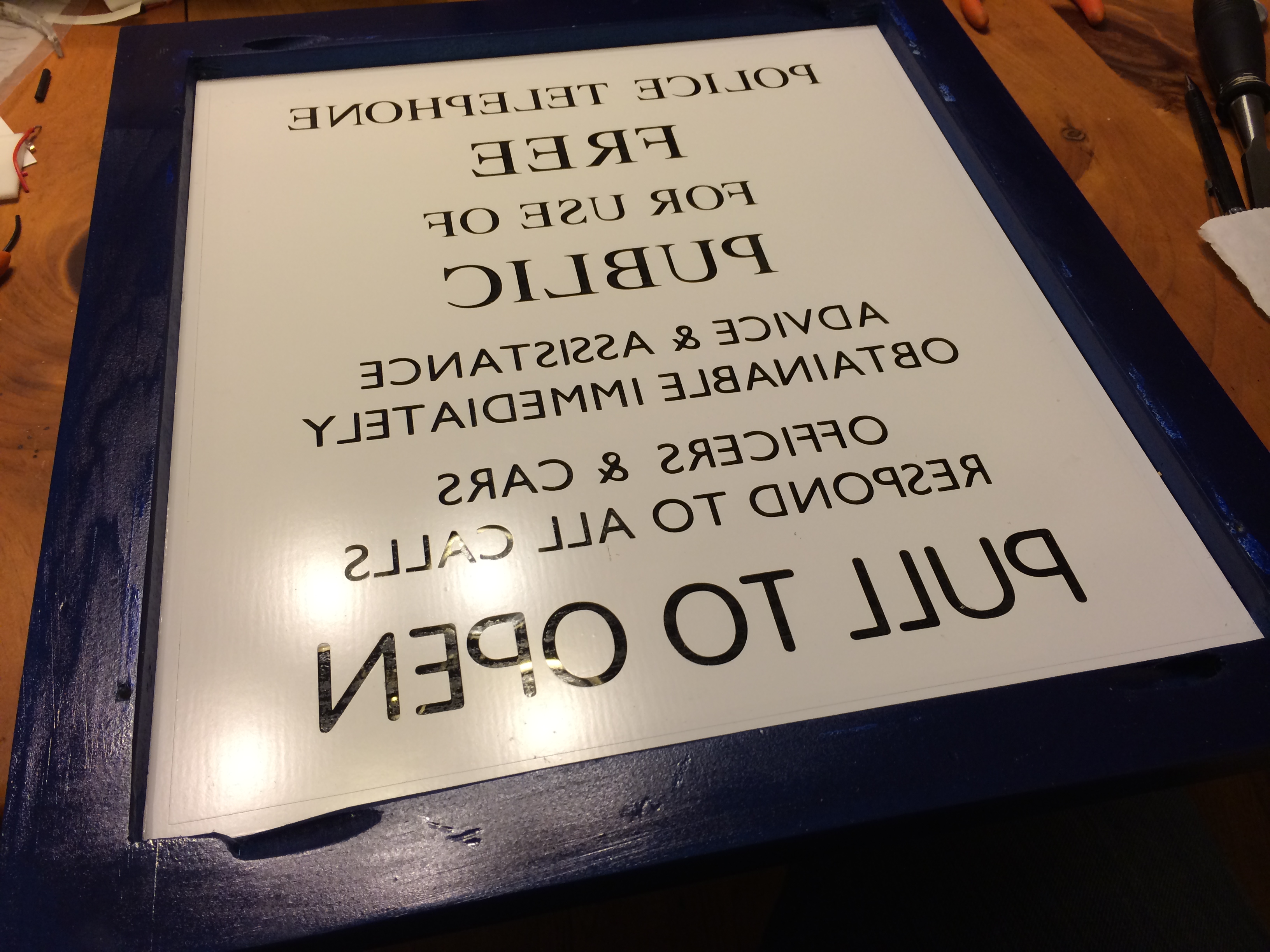

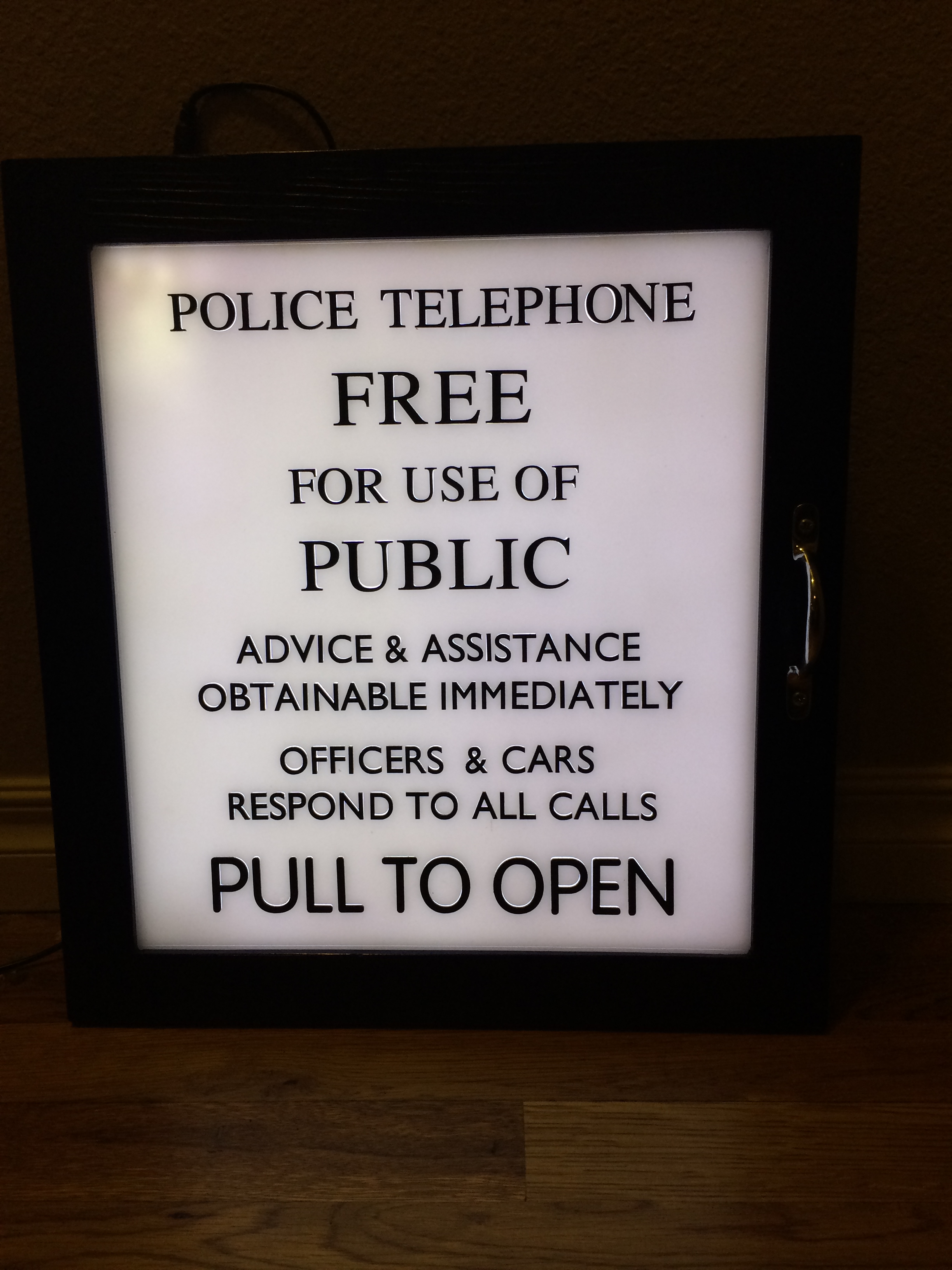

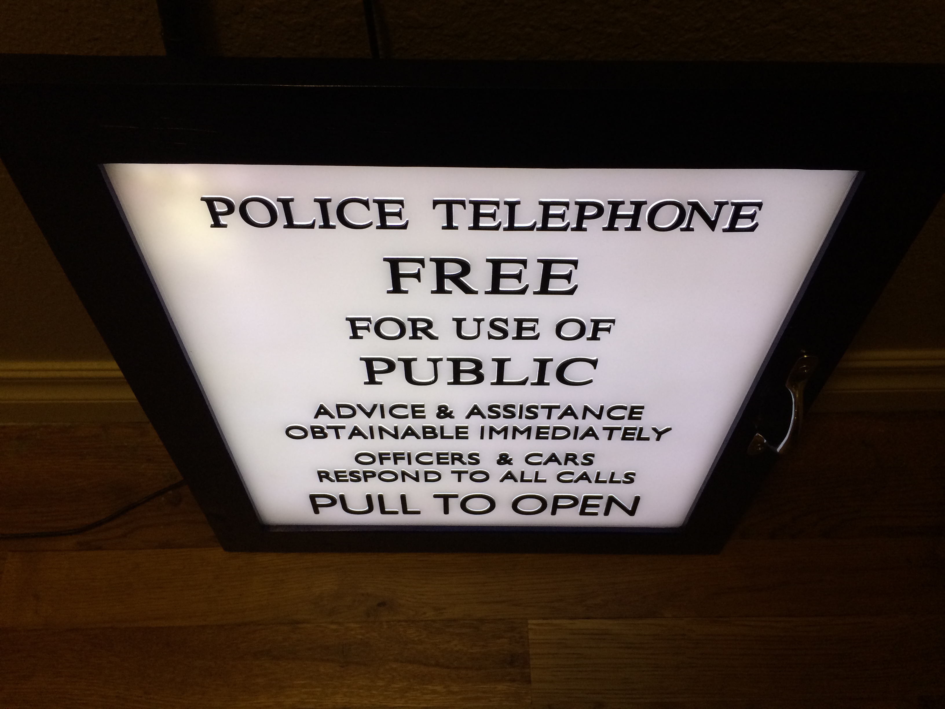

Here is with the light.
Unlit...
Lit...

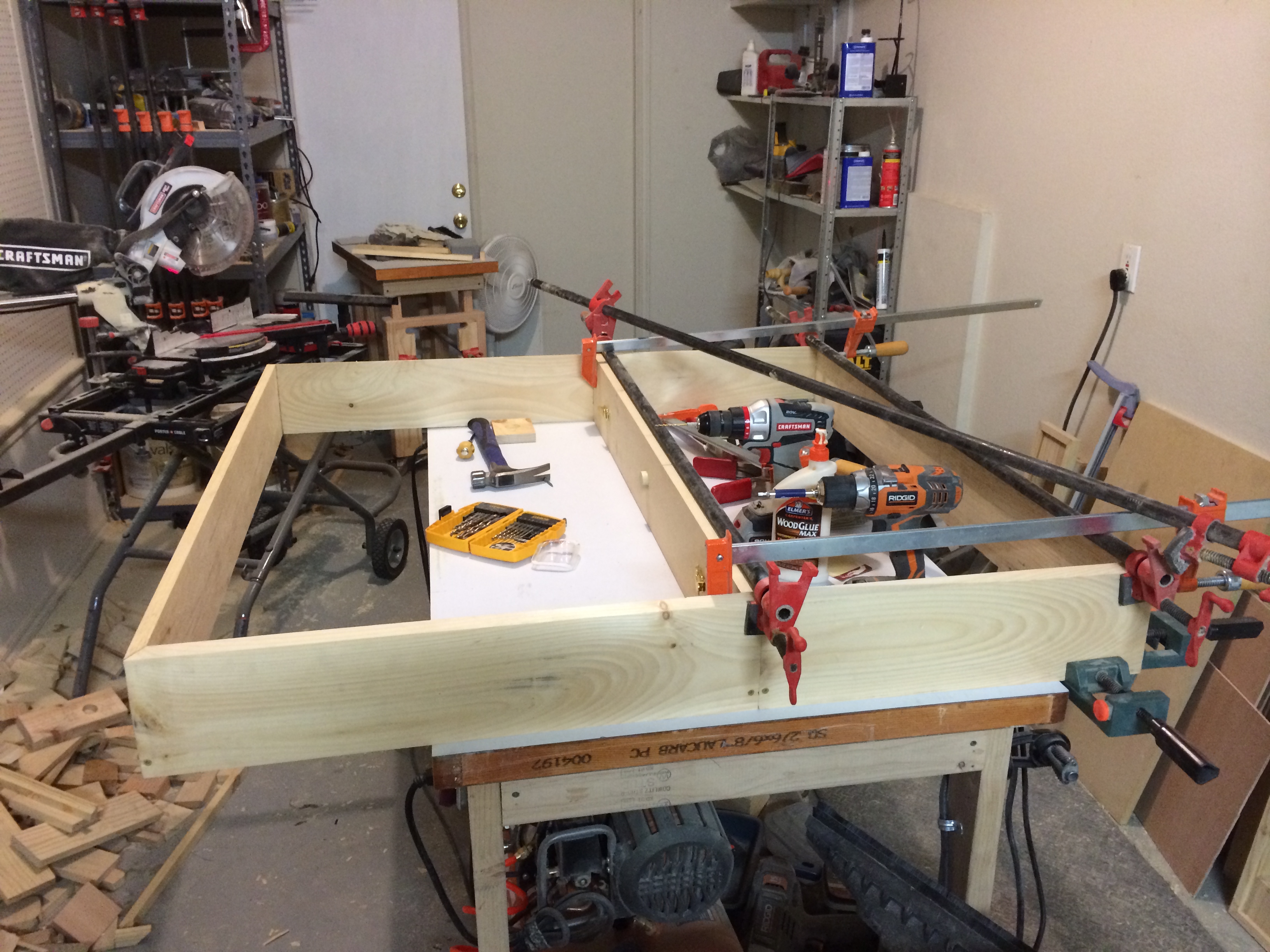

My plans require the top to be built in two halves so that when I tear it down, it will fit in one very crowded car (in theory), or perhaps partially in a second car. It basically has to fit in the door or trunk.
I am starting off building the top part of the tiered roof. From there, I plan to build downwards, and then upwards. I am using the same kind of doweling system as what I used in the base.

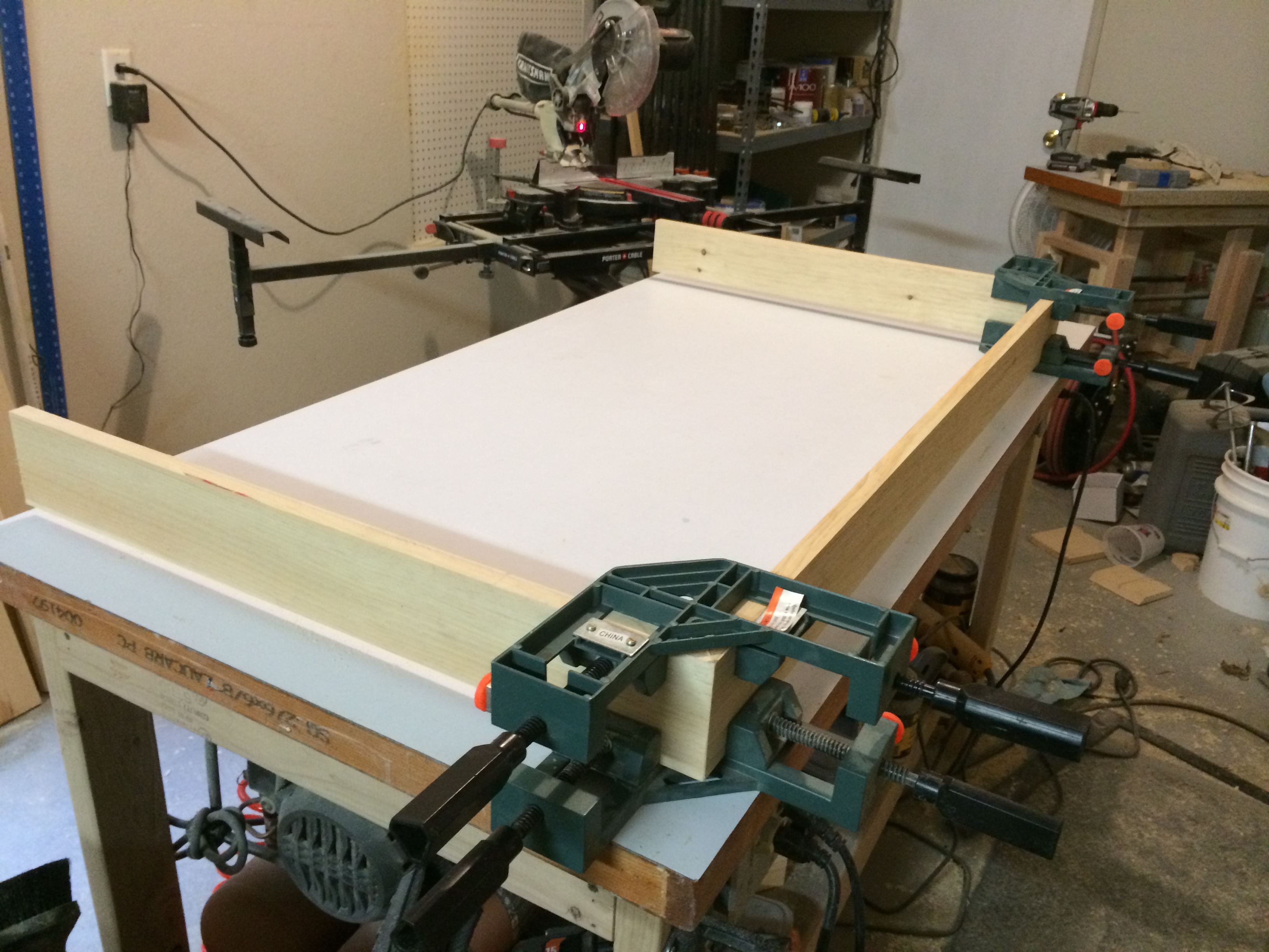

Next, I added the spacer around the parameter.
I glued up the bottom part of the roof that will get attached to the spacer.
Now, I attach it once the glue dried.

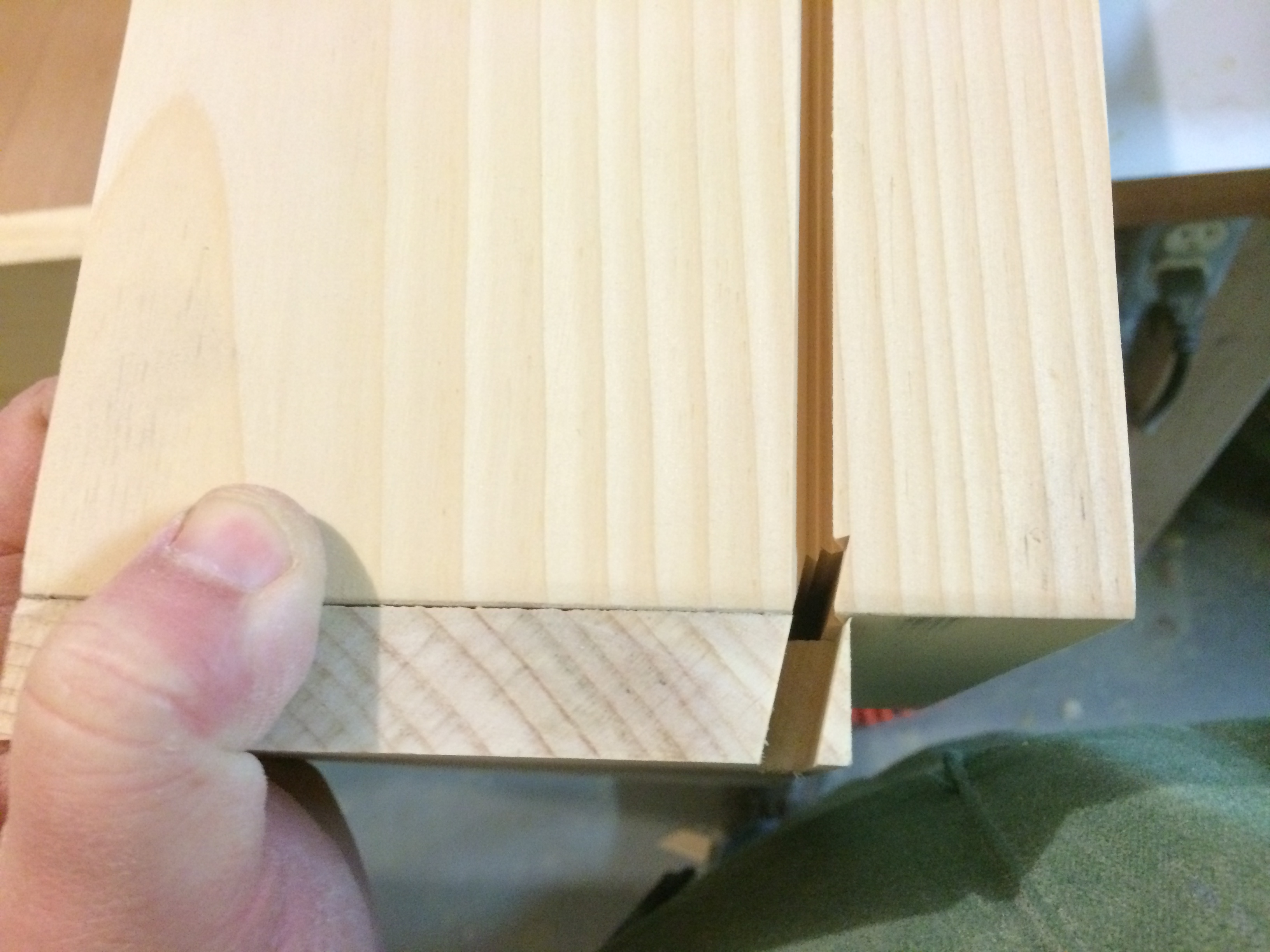

NOTE: Unless you glue these 45 degree mitered corners perfectly, the final assembly will not go so well. On working on the other half, I ended up having to break the joint and reglue it.

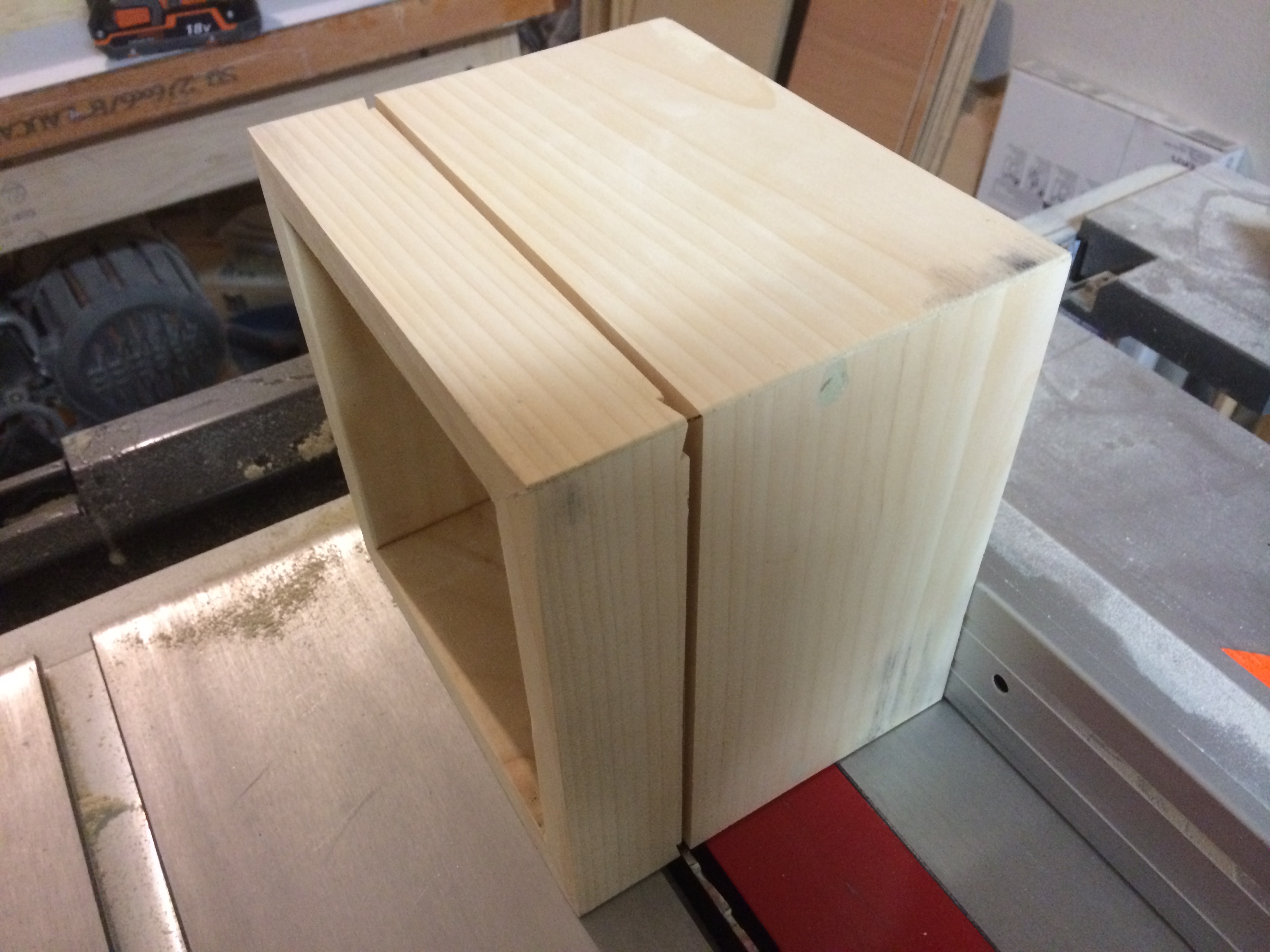

I built the center box for the lamp to plug into. Setting my saw at a 12.5 degree angle, I cut the groove for the roof.
Using a scrap 1/4" oak plywood, I test to see how it will fit.

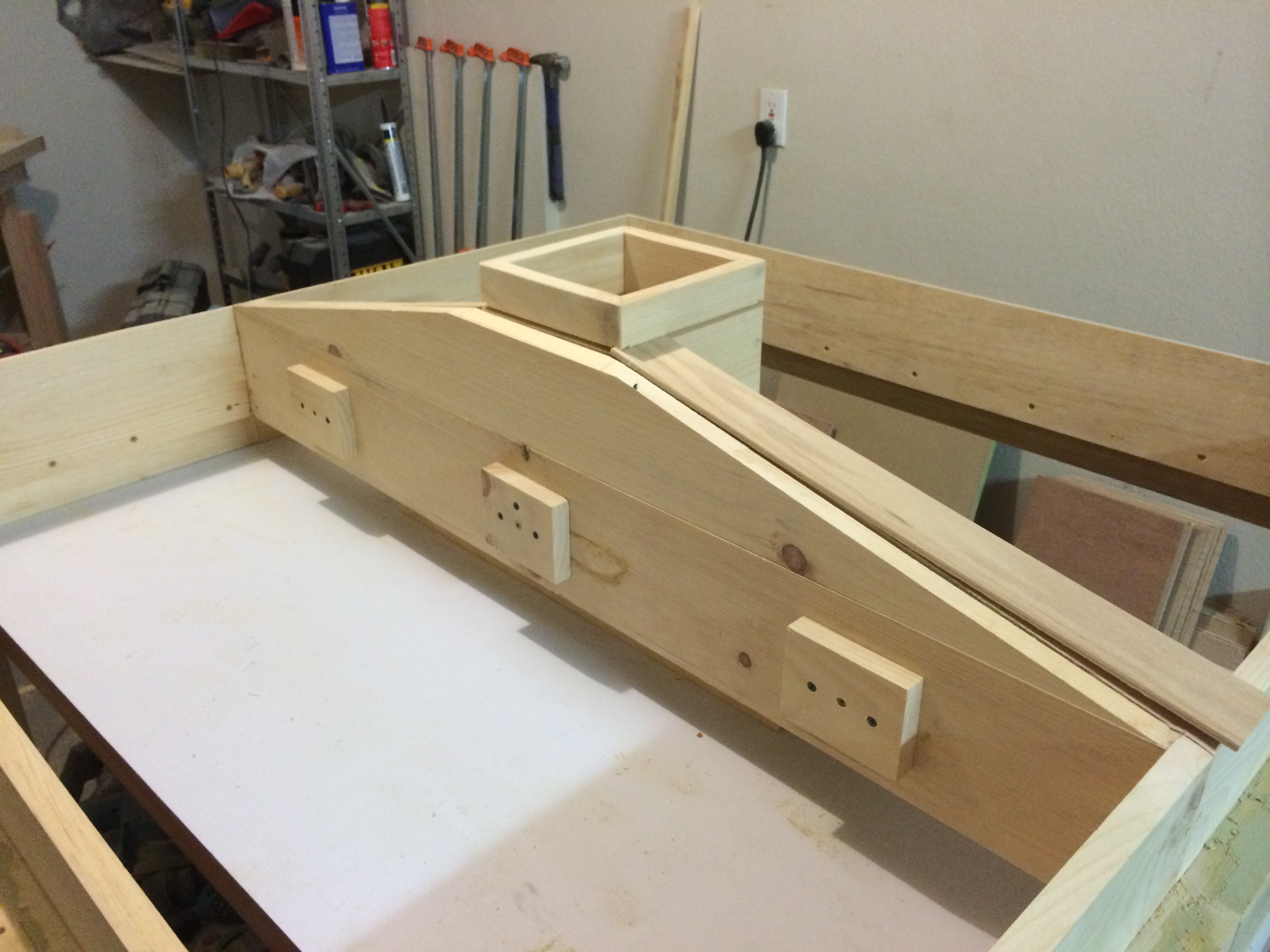

Now, I have to make the angled pieces of the back that will attach to the center.
Let me just say this was probably the trickiest part trying to figure out the angles and making sure the pieces could fit together without obvious gaps.

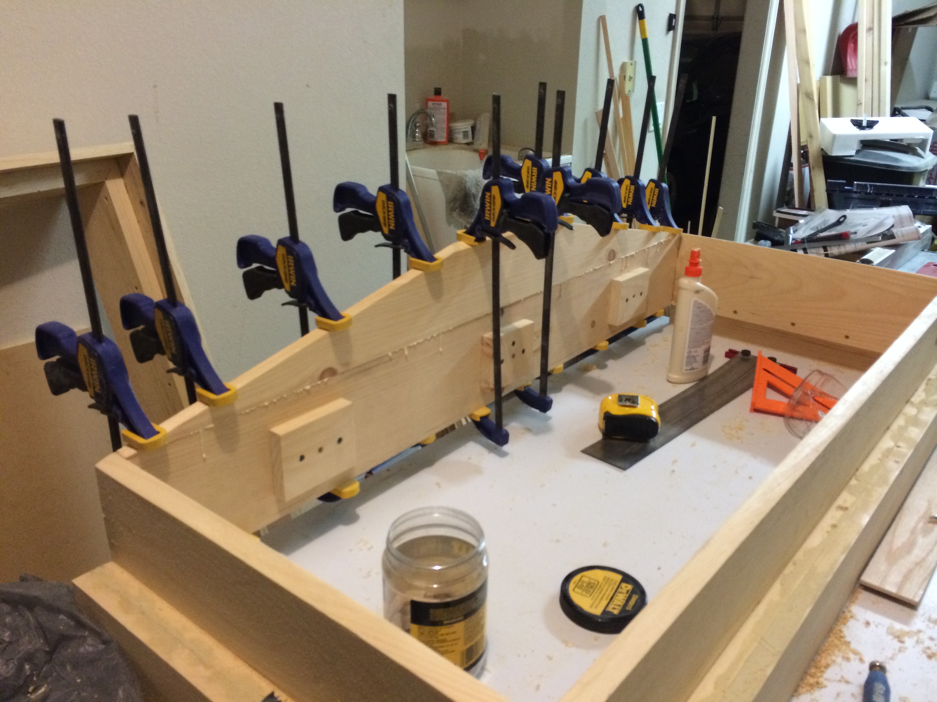

Now... it seemed best to attach the "wings" using a dowels, and using a jury rigged clamp to hold it together while the glue dried.
