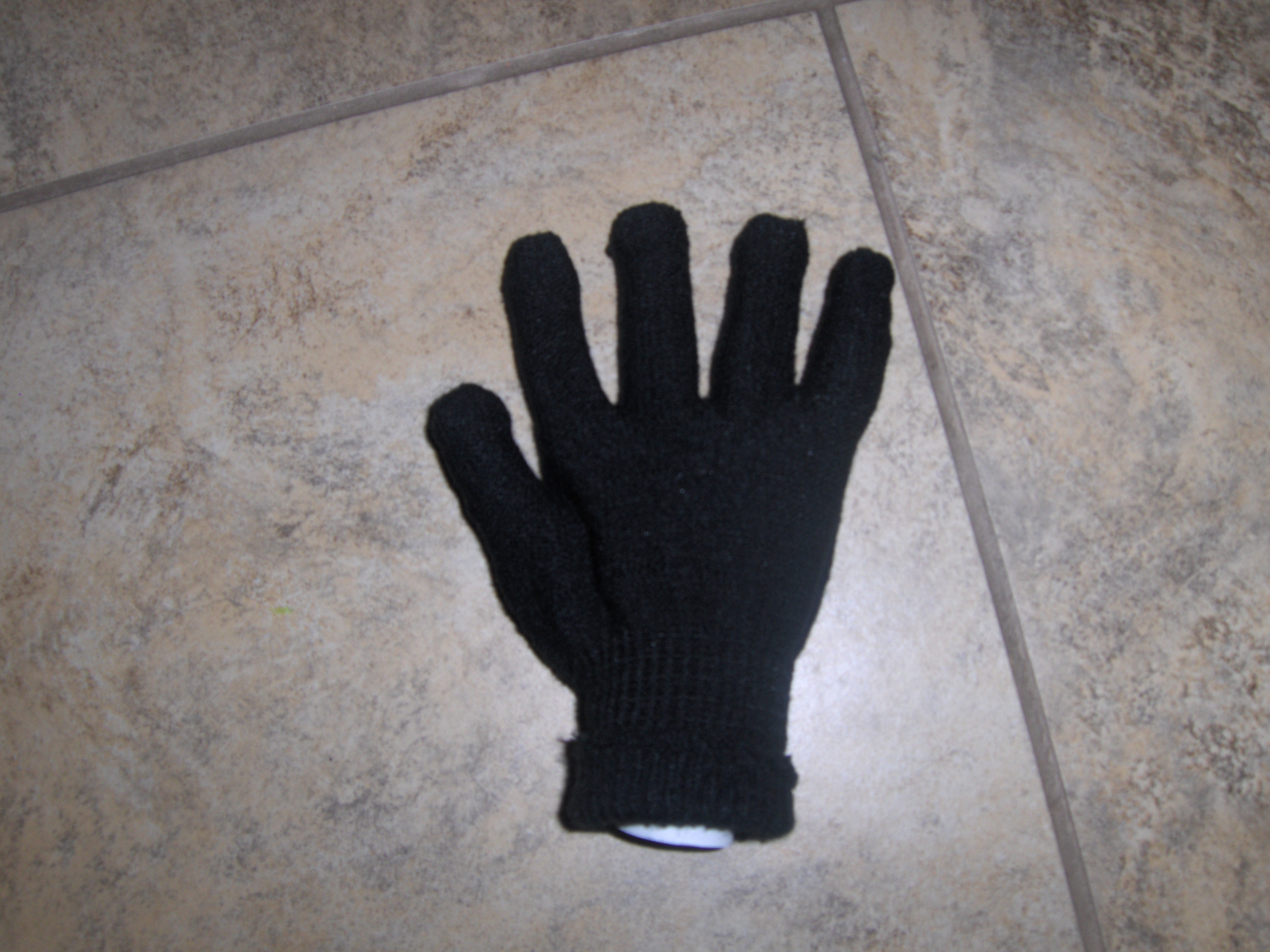

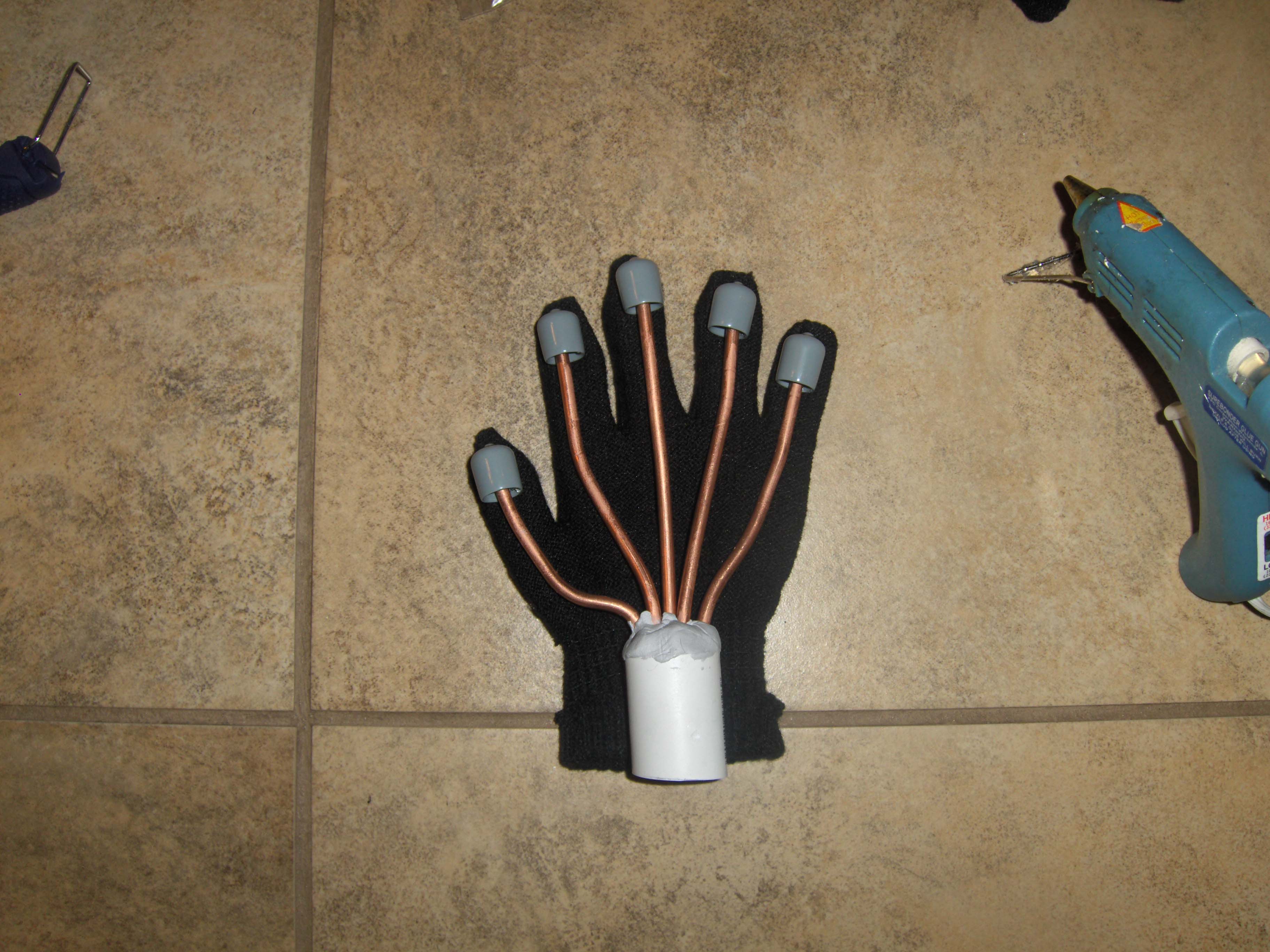

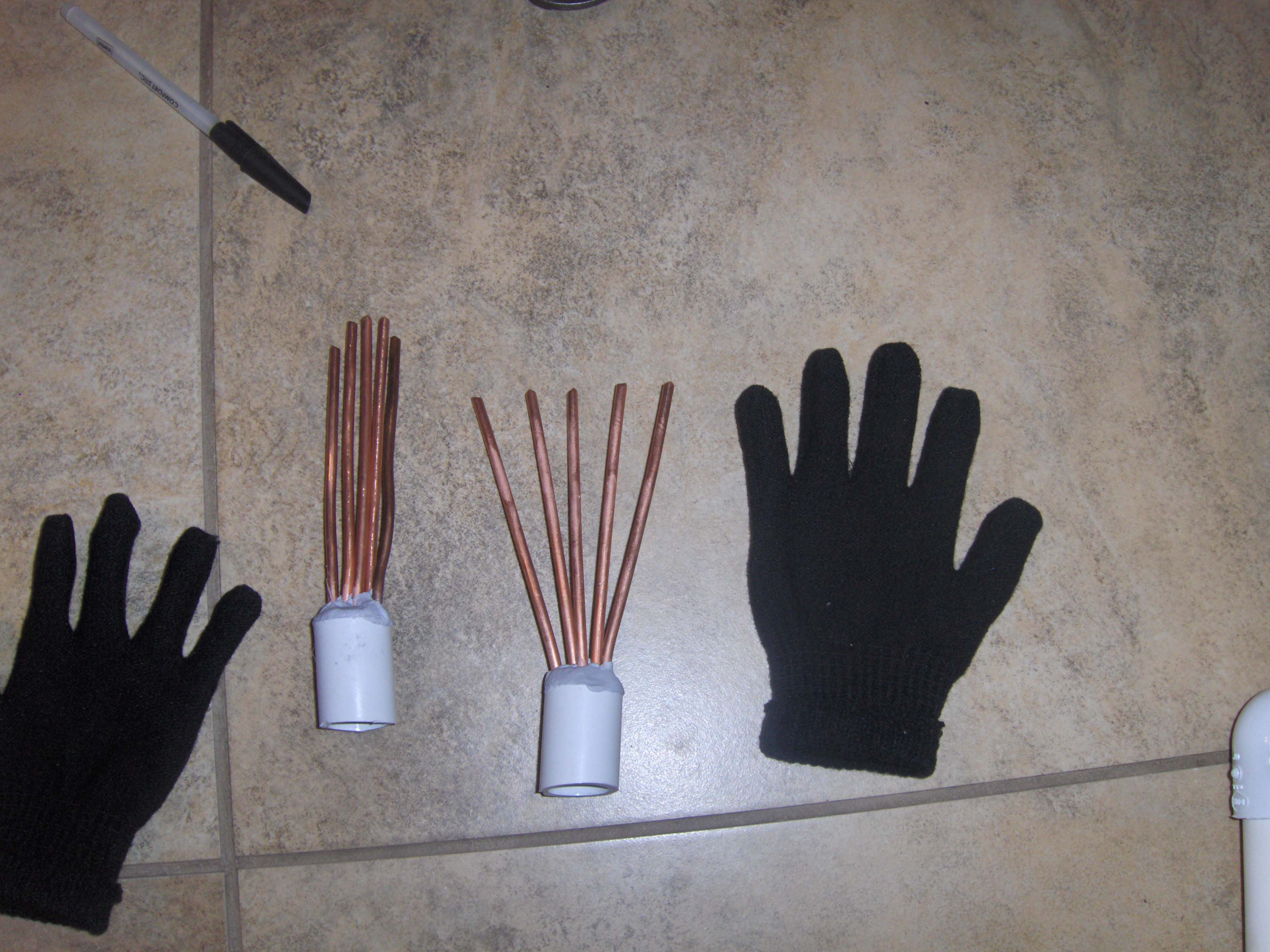

Here's what I did for my Jawa hands. I used a 1/2" schedule 40 connector, medium gauge copper wire, some rubber caps, and 5 minute epoxy putty. I bought a pair of children's gloves from Target for $1.00. I then cut the wires to length and hot glued the rubber tips on. The wire is held into the pipe with 5 minute epoxy putty; they won't budge no matter how many times you re-position them. Just be sure to pack the epoxy in there good as to not leave any air cavities, The first time I tried this I didn't pay attention to that and since you have to use so much force to bend the wire, I cracked the putty after it hardened.

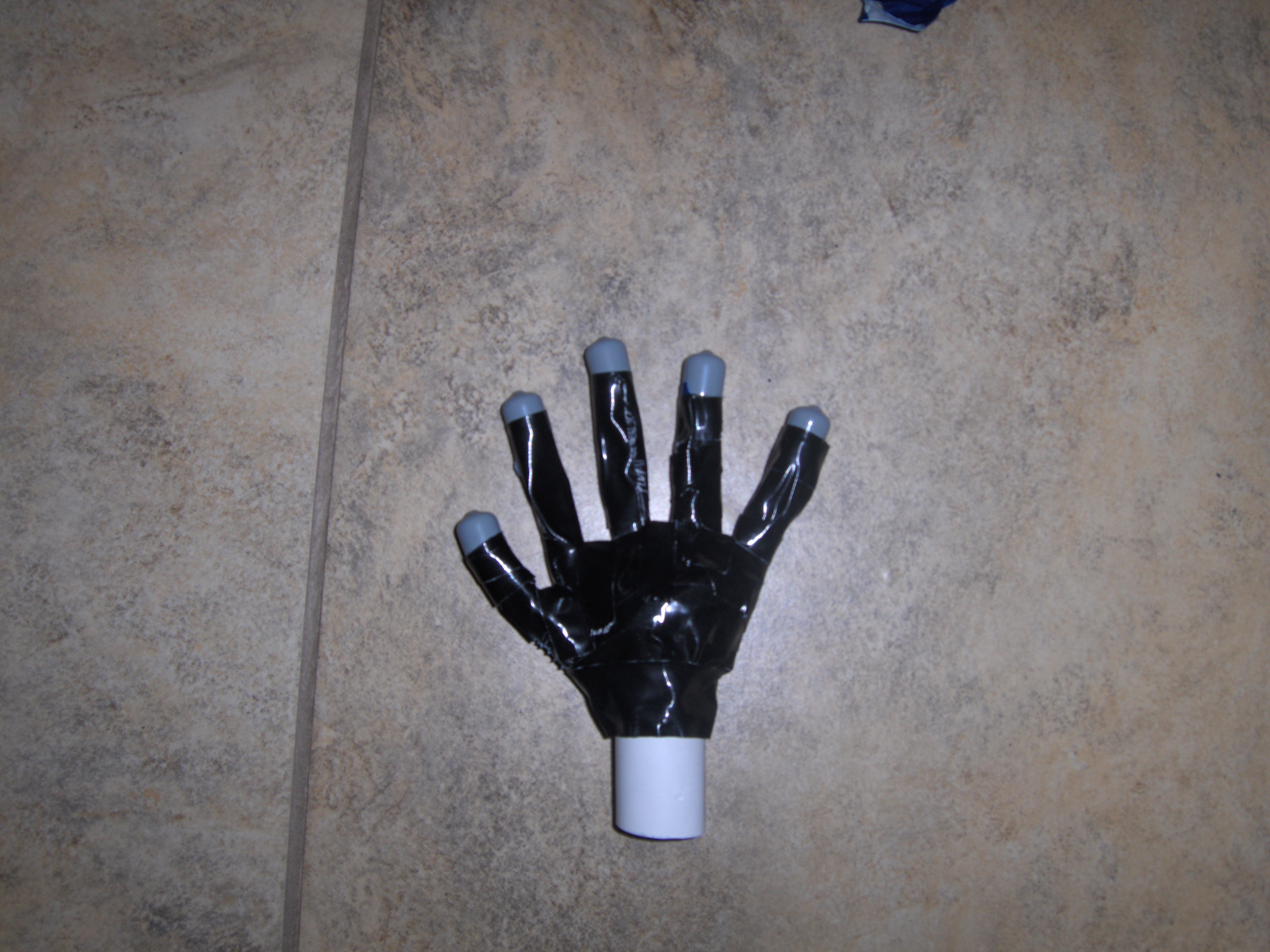

I then loosely wrapped each finger with duck tape to bulk them up, don't wrap them too tight, they'll be hard to bend. I also built up the palms and wrists (not pictured). The gloves fit nicely and they feel sturdy.

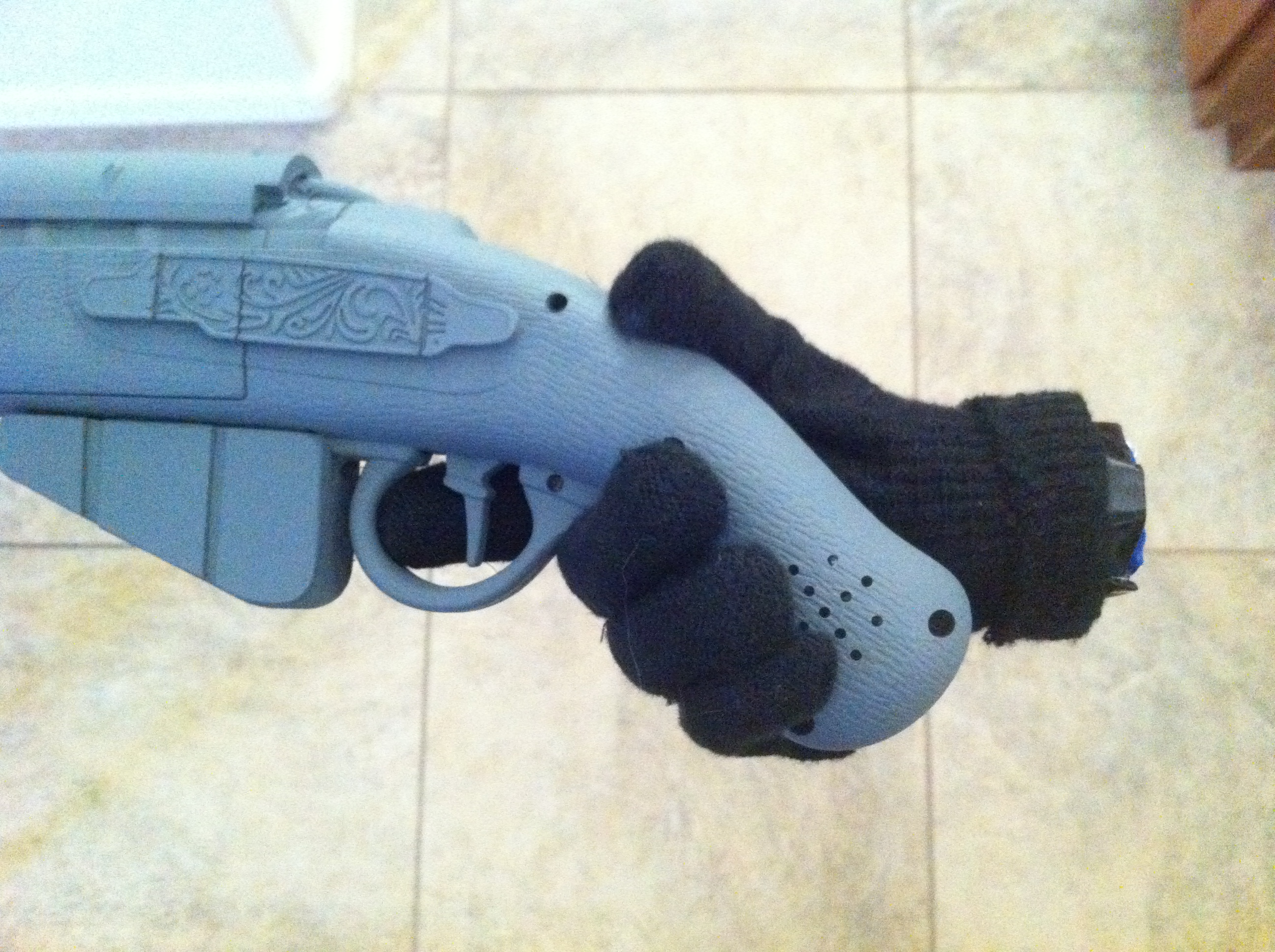

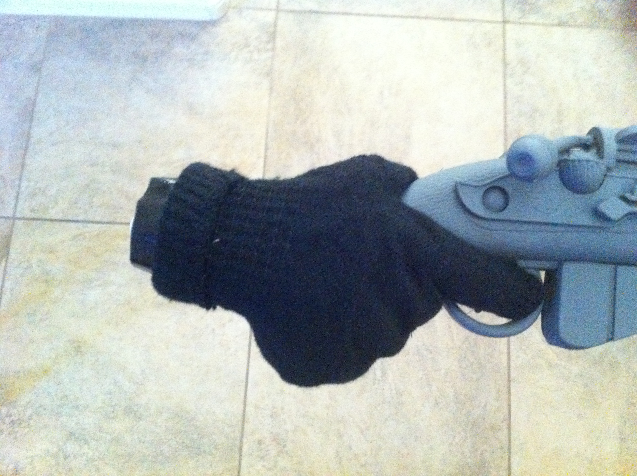

After that I finalized the grip, it held the blaster perfectly. I'm real happy with how these turned out. I used pliers to bend the fingers to the right position, that's how thick the copper wire is I used. They won't move a bit. There's a hundred ways to do hands, but this worked the best for me and I never had to worry about the blaster falling out. I'm sure with your creativity you'll find a way to refine this so it's even better!
