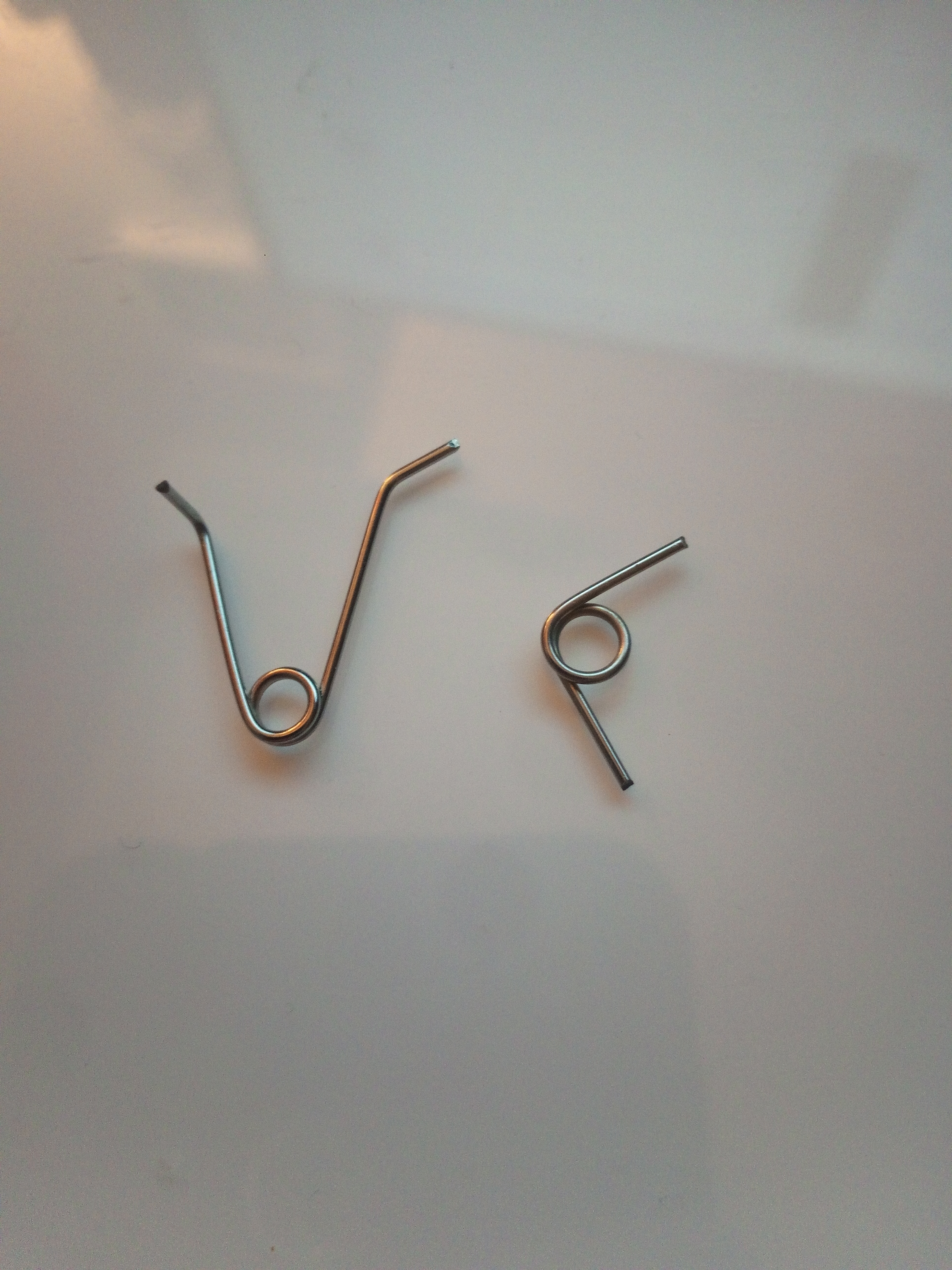

Hi. I found the original spring wasn't up to the job after shooting the thing after a while. I used the spring from a safety pin. The spring that needs replacing is the one that hooks around the little arm that sticks up off the trigger and turns the barrel. The safety pin spring is easily cut using wire cutters and bent using two pairs of pliers. Measure using the original spring. Once in place you might need to oil all the moving parts but mine feels way more solid and doesn't slip at all. I might buy a bag of pins and do a upgrade for the Tomenosuke crowd. I love my gun so it was such a pain when it started to slip. Hope this helps.

Hi Lusky. Thanks for taking the time to post. I like many other Tomenosuke owners have had issues with cylinder rotation. I originally attributed the problem to wear and tear on the star shaped component on the ejector rod, however, it seems that the spring may be the culprit. If you're up to manufacturing some more springs, I'd be interested in purchasing several of them from you. Otherwise, I may attempt to make some of my own. Thanks again for your efforts on solving this very common problem among Tomen owners. I own five blasters, and three of them suffer from cylinder rotation issues.
Hello. The spring is deffo the issue. I have a set of springs but the more complex one is usually the culprit. I have a set of them you can have to try. Where should I send them? The more complex one might need a re-bend with a pair of pliers to get it to fit correctly. I put the gun back together and it slipped so it needed a slight adjust but there is a video here which shows the process. I tried the stuff here but it gave up again after a pile of shoots. My version is holding strong.
This is the tutorial for putting them back in. The image is my set ready to try.
