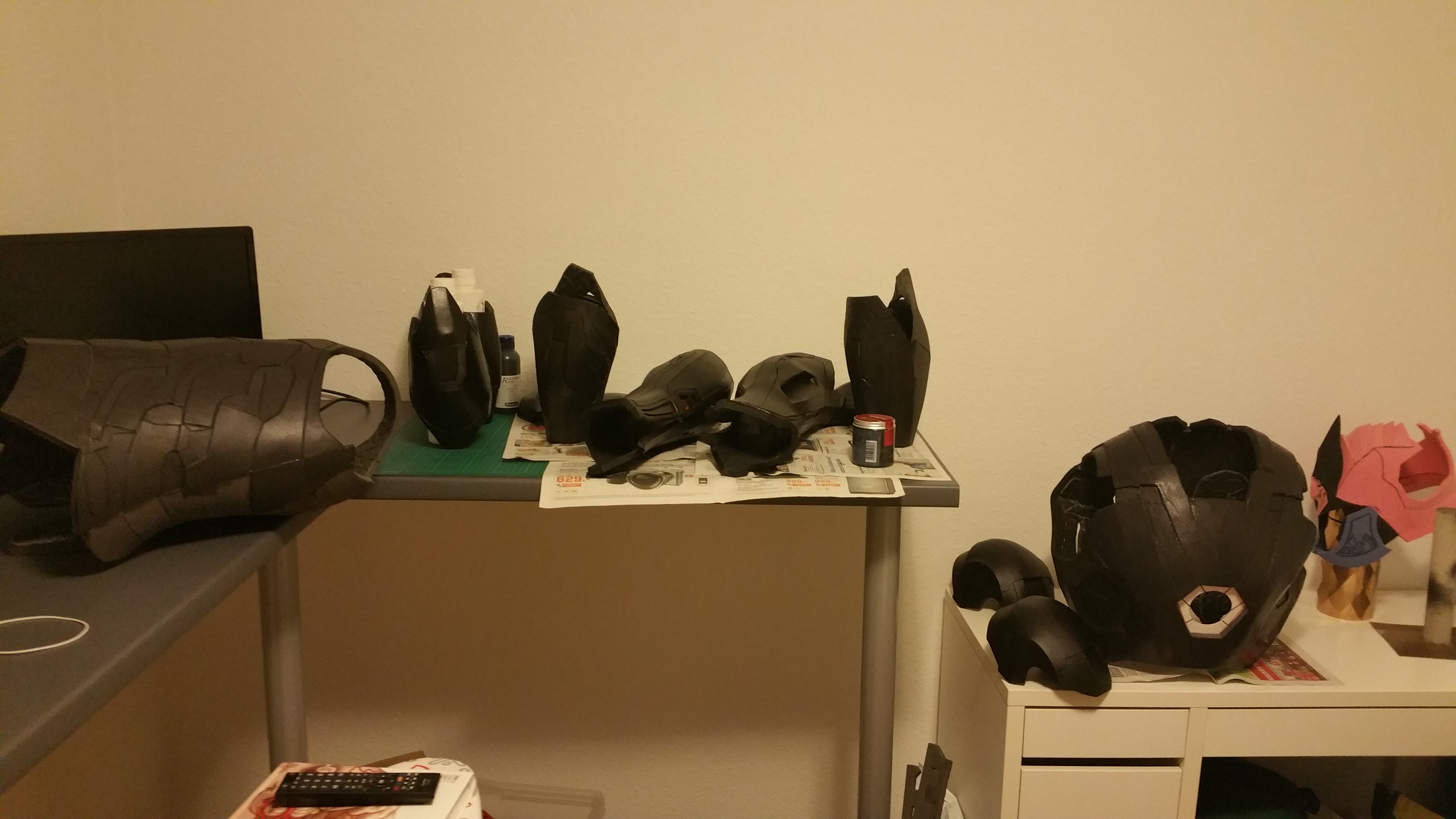

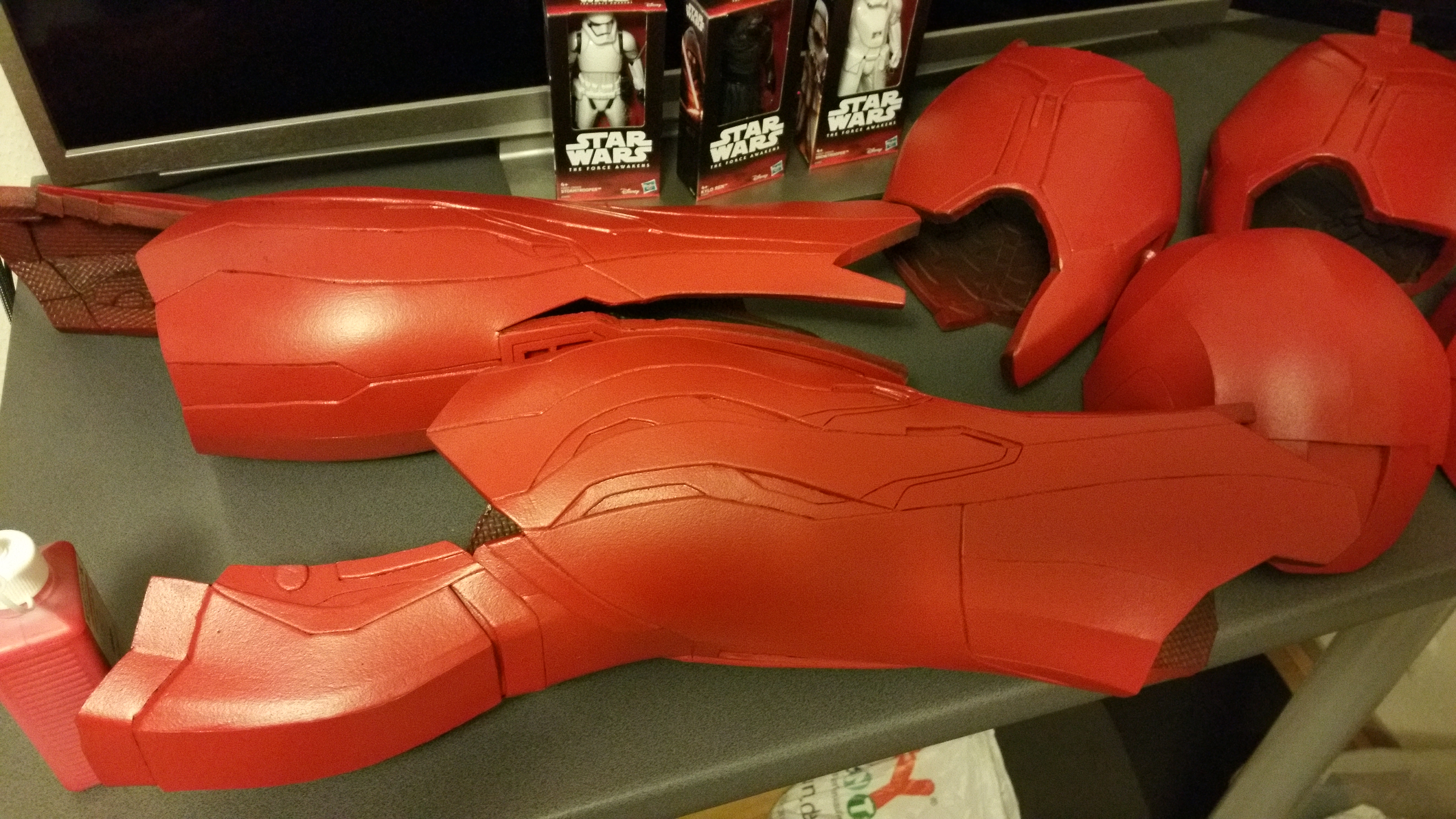

Sorry had a long break. I'm on the sealing stage. I'm using acrylic emulsion mixed with black acrylic which also works as a primer because the red I chose is lighter than usual uploadfromtaptalk1448325297376.jpg
Really nice progress my friend! Im really happy you are finishing the suit so quickly! If I only had time to continue mine! :(
I also hope your paint will dry, I always have trouble with paint not drying for hours when used under 15°C! Usually paint needs about 20-25°C to dry, but well see! Hope to see more Updates! :)
Gesendet von meinem A0001 mit Tapatalk
Thx im using graffiti spray paint. It dries quicker than normal enamel spray. After 1 light coat wait 30 mins and then do the 2nd. Usually it's enough because the color is so strong. And €3.50 a can is super cheap

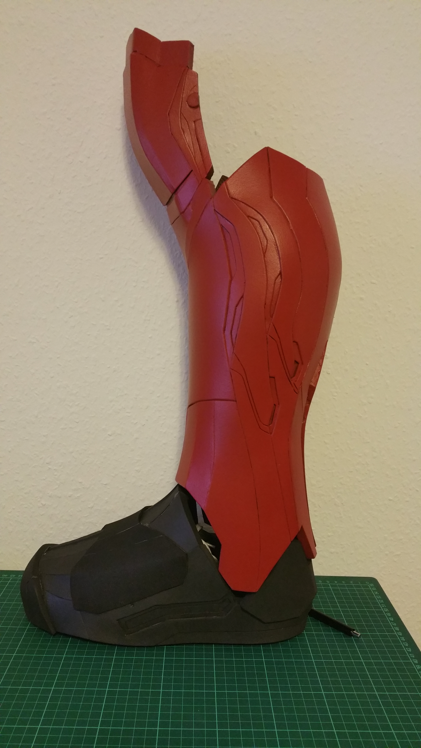

Here's how it looks after 1st layer of red. It looks too bright because my phone enhances the lighting automatically
The boot is made of 12mm eva. Even the bottom is sealed with eva. The black upper piece is made of 3mm craft foam. I put my sneakers in it to make the boots wearable. uploadfromtaptalk1448840101448.png
Damn, those details are so clean! I'm trying to hold off on getting into foam builds since I want to fiberglass, but man that looks good!

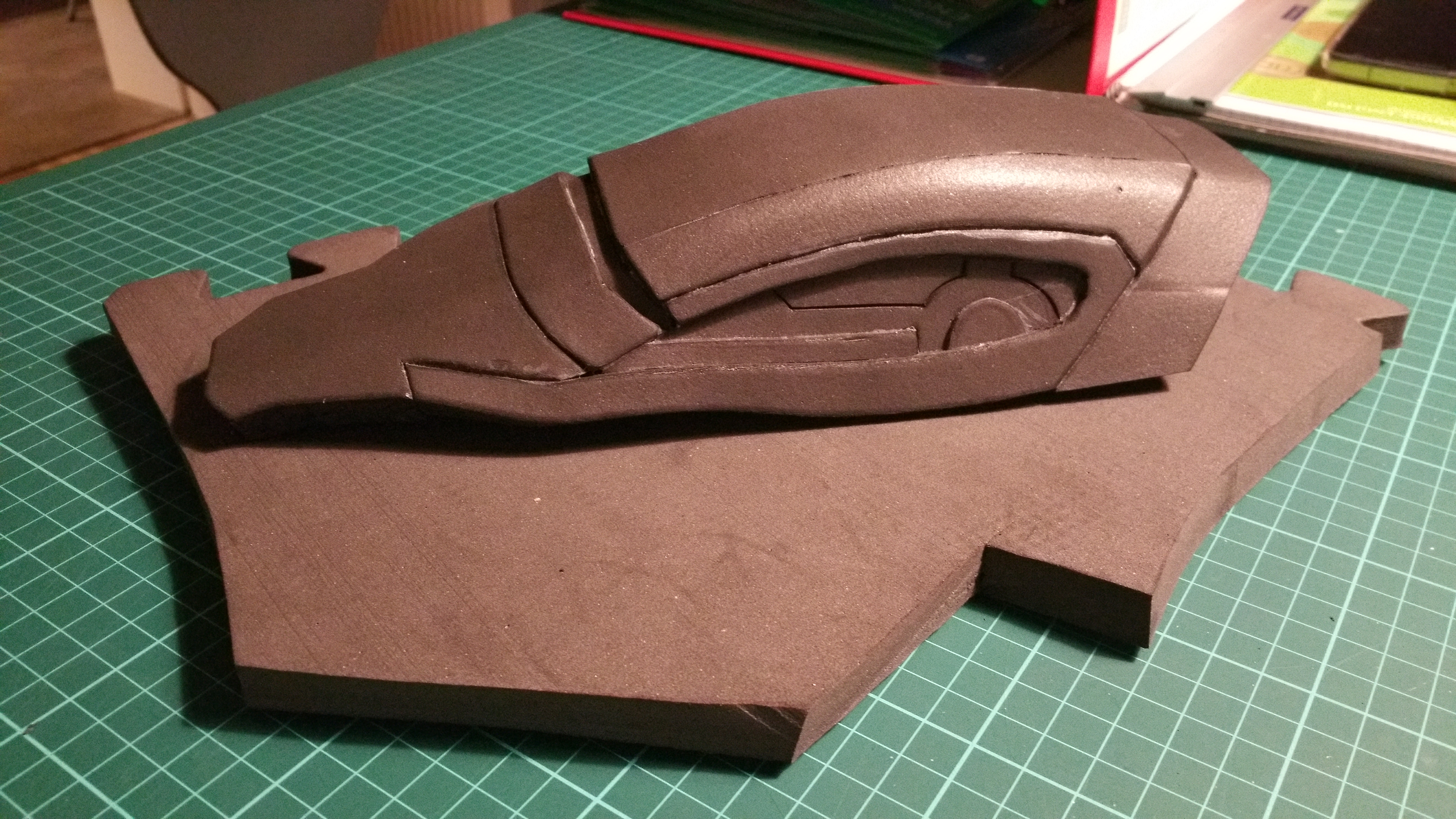

As far as my build is concerned, every file has been modified for my needs. There were some trimming, adding lines, connecting pieces before tracing on foam, etc. Also most of the edges where dremeled down to get an even fissure.

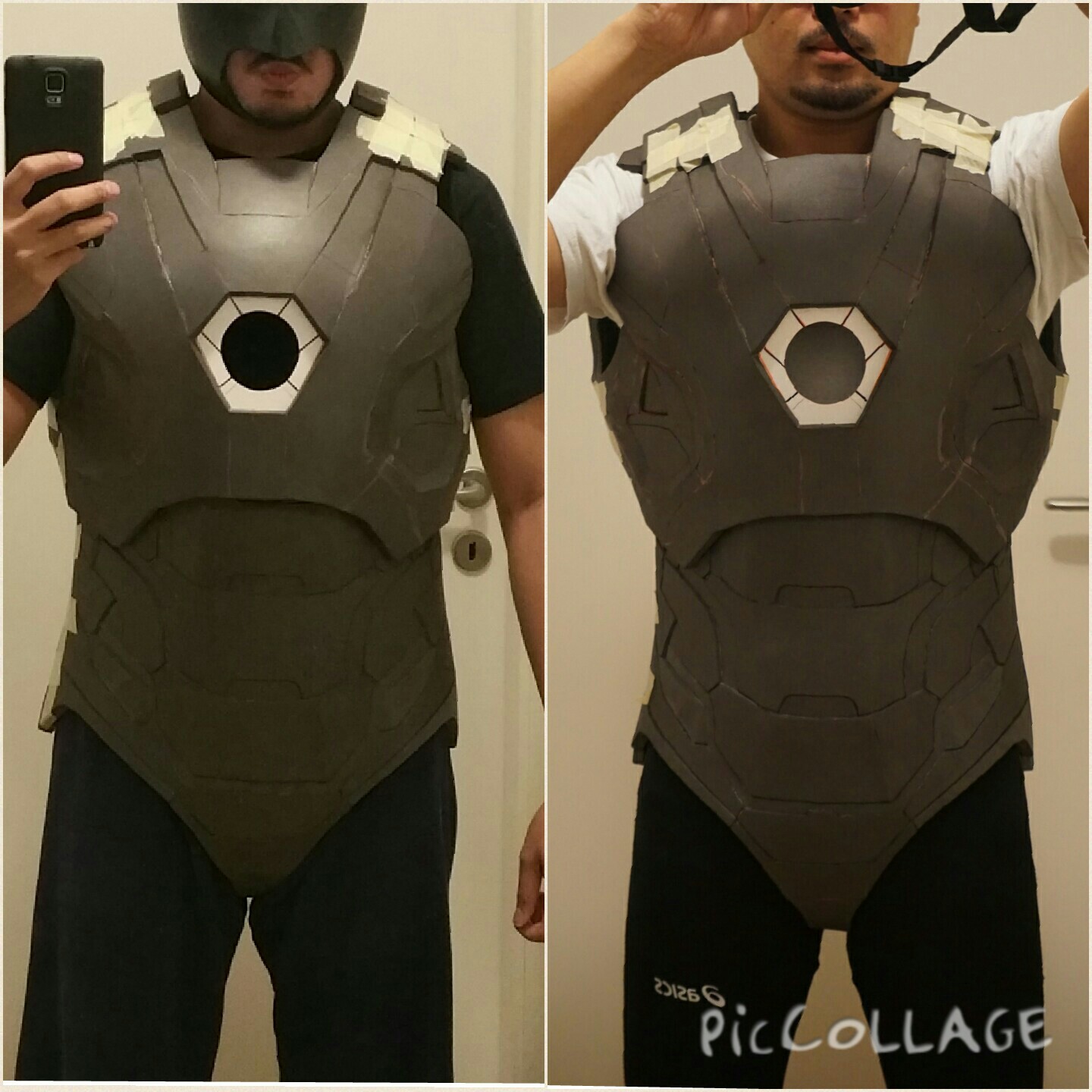

Here's an example before and after I trimmed off the torso and abs so it's sexier [emoji23]
Re: Ironman mk45 Veronica [WiP]
No problem dude, I'm just giving ban what I learned from others [emoji39]
You are right. I'm mainly using helagak's files. I'd recommend the do3d files (which is awesome btw) if you want to print it in 3d. It's so high poly that pepping it would take too much resources. But maxcrft is also selling the foam pdo which is easy to use while maintaining high details.
lolololol, I totally understand! Get that iron hourglass look, dude hahahaha!
I'm really trying to maintain the slim look while still achieving those curvy "superheroic" proportions. Seems like no matter what, I'm going to probably need to trim and modify to get my desired result. I'm super jelly of your build, man. You've been moving through your build pretty quickly,too! Are you going to add lights, electronics, etc to the armor?
