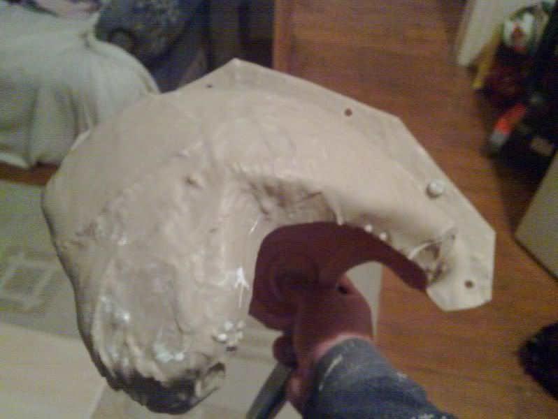

Lmao Dericrw!!! I know right! Im looking at the shoulder bells, scratching my head, thinking how is that even possible?! If I tried that much detail with curved, etched lines I would have to redo it a hundred times and STILL not have it that perfect.
What did you use to cut those lines in the shoulder bells Fingaz? How did you lay them out to be accurate with each other? Beautiful work....absolutely amazing.

thanks rowdy,i'd like to say i had a magical elf do them,but i'd be lying.
nowt no simpler than,a pencil,bradawl n a needle file.draw the lines on,run over them with the bradawl cutting the line,the carve them out with the needle file,about 15/20 mins for the pair

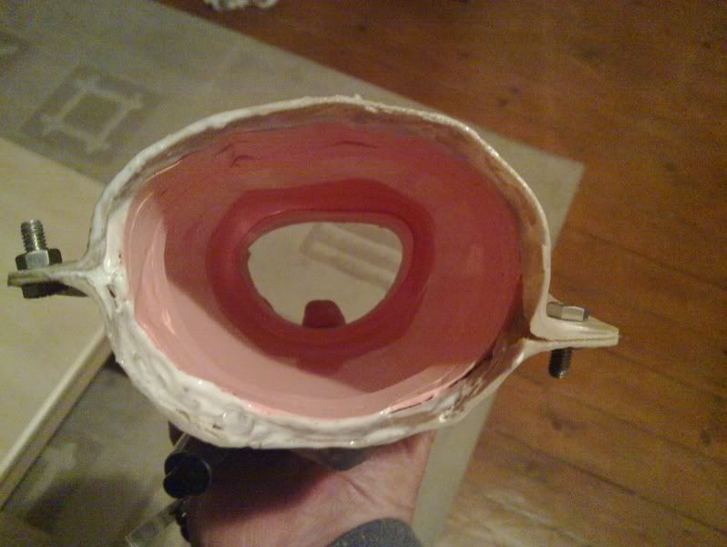

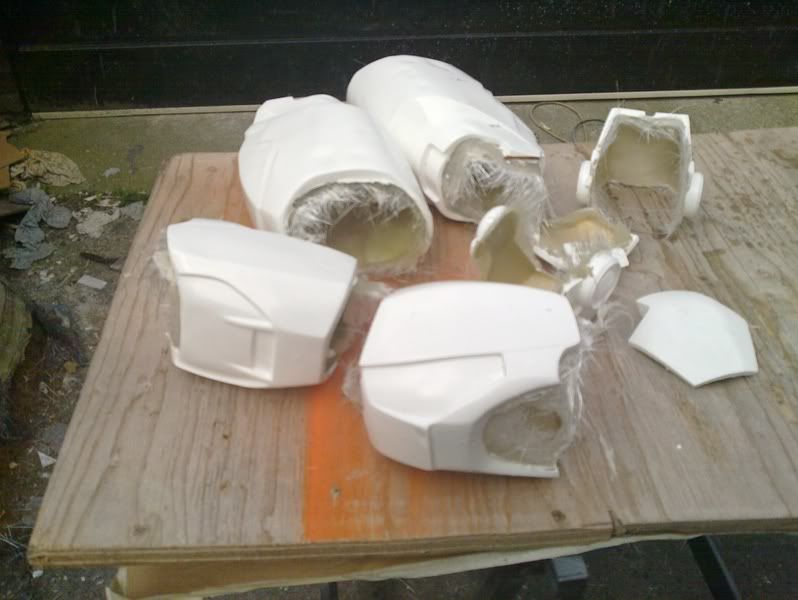

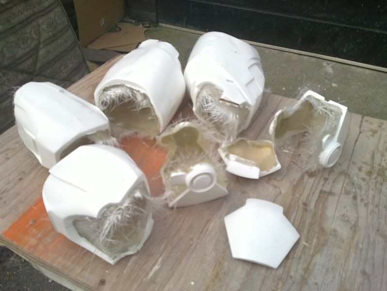

been slow on progress,but finally got a little more done now.
made the molds for the bicep,elbow guards and handplates from silicone.
then today polyflo 120 n 60 arrived from
MB Fibreglass supplies online UK & Ireland - mbfg.co.uk ,great service n if you call them,ryan's very helpful,even look up your build n give advice(y)thumbsup:thumbsup
never know my luck, might get a few 3 samples if he's reading this with my nxt order lol:lol:lol:lol
so afternoon spent casting,bicep mold needs thickening up a little,as a few depressions,very minimal fill,overall very happy with results,ready for paint:):),n a damn sight lighter than the pepped pieces,happy days

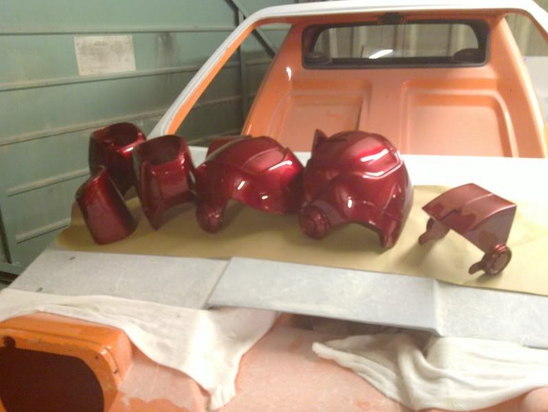

hi mate great build! may i ask how you got such a good finish?
primer, paint, wet sanding, clear coats??
i'm soon to be painting some casts of a stormtrooper bucket i'm working on, any tips would be really appreciated. all the best mate! fellow UK fella!

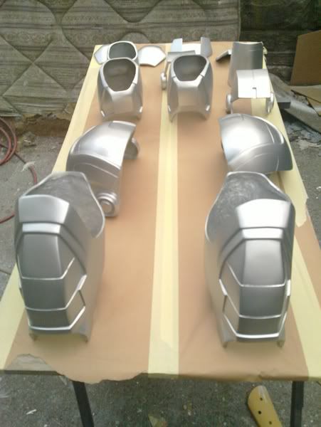

thanks terra1,

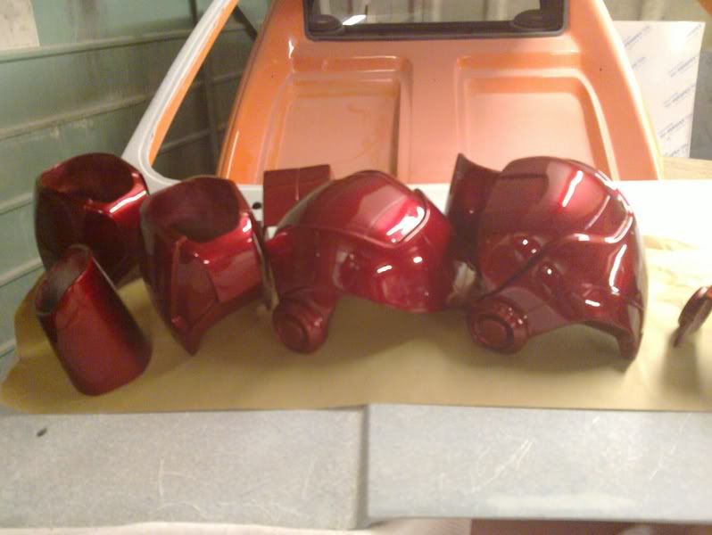

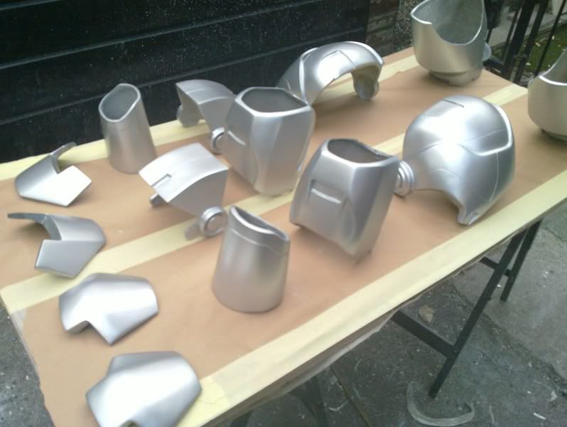

tips,i'll try:
primer ive been using 2k or cellulose high build depending on how much levelling rqd,lightly dust coated with matt black then wet flatted with 400,a light flat with 600.then onto base coat couple of coats of silver base dusted lightly,4/5 of red candy left 20/30 mins gone over with a tack rag to remove any dust settled on the piece.then clearcoat 1 light grip coat next heavier coats for gloss however many needed for it to settle right.just using some prospray lacquer at the moment 1 good wet coat n it settles beautifully:):)

Just about to paint my Mark III so it's nice to see how you've handled this as I'm going with a Candy Blood red over Silver.
As you've worked with car bodies for so long I'm guessing you've used a spray gun rather than cans?

hiya steve thanks very much,we're nearly neighbours only 30mile down rd from you,if yr passing i'll get kettle on.
its painted with my trusty devilbiss sri gun.ive painted candy blood red in past its a nice n rich.if you need a hand give me a shout.

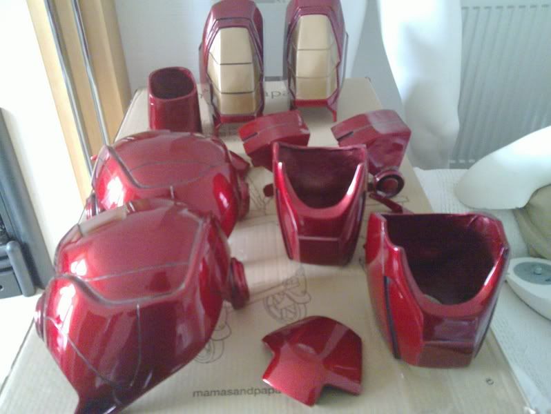

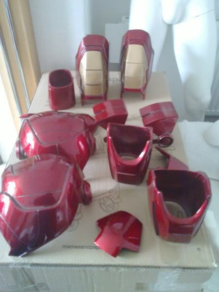

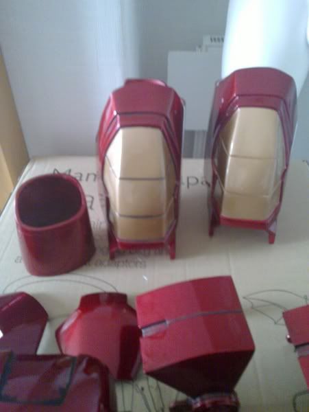

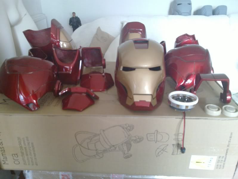

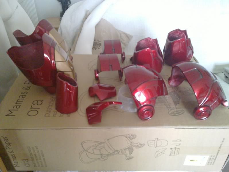

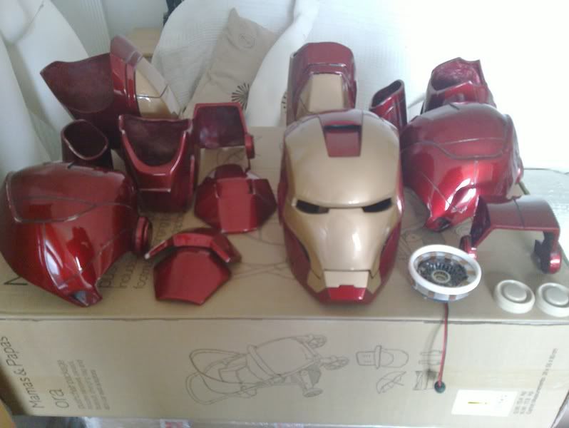

well done a bit more molding n cast another set of arms from molds out of gel,coat resin n mat.although this molding lark is all new to me im enjoying it:)
got the arms painted,weathered n worn i couldnt be happier with them:)
unfortunately the chest lets them down a little:wackoso its gettin a major touch of rework (pics in nxt few days)
calves getting reworked with new pivots same as shoulder n elbows.
i'll get there in the end:lol
