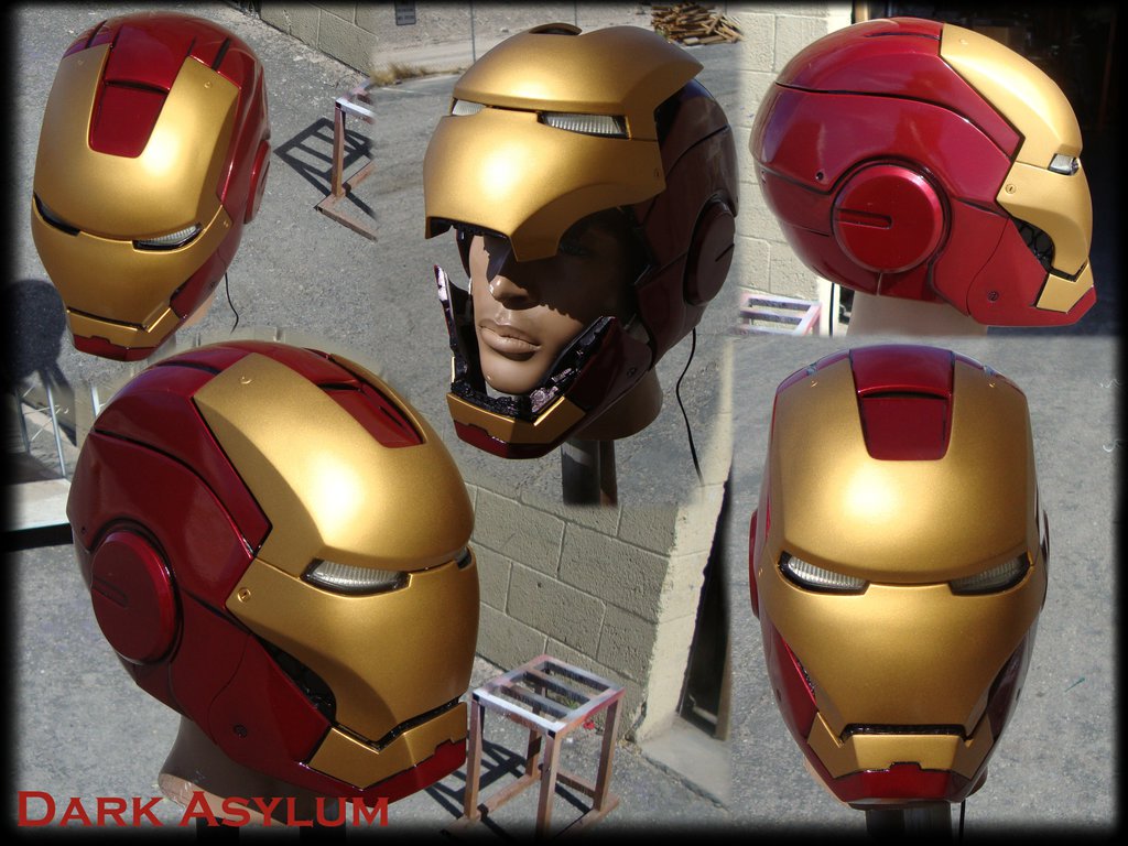

Mild progress on this one I actually updated a bunch of parts just not everything made it into this one it was more or less going to be just paint restoring but some part especially the hand and back were pretty worn on so rather then wasting time sanding fixing and repainting I just replaced them completely and the new ABS stomach needed to be tested out.

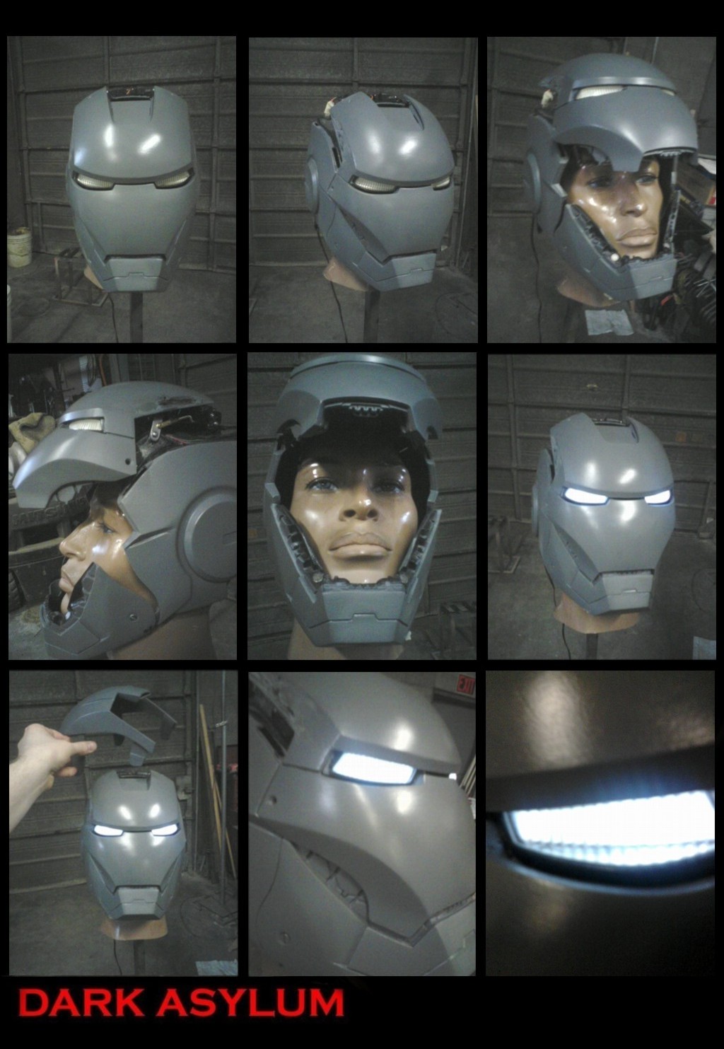

Just adding to this long lost thread last update was still a few years back the last Automated Helmet from over a year back or longer all new molds and tweaks I didn't get a chance to share before....
just a rather overly complicated duel servos running 4 lever arms and 6 way channel relay with reverse limit switches and jaw cables plus ran on 6 volts operating system and 9 volts cooling fan for luxury
