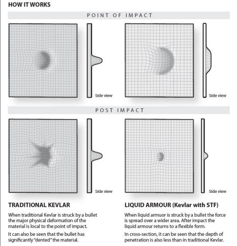

is possible, I show you the bullet-proof 'custard', or the Liquid Armor; It is a non-Newtonian dilatant fluid, works by absorbing the force of impact of the bullet and responds by becoming more viscous. the molecules are joined together when there is a collision.. It is liquid under low or normal pressure and solid under high pressure. This liquid is made with polyethylene glycol and the solid part is made of nano-particles of silica. This liquid is soaked into all the layers of a Kevlar vest.
The suit works using a viscous compound which, when attached to traditional Kevlar, absorbs the force of a bullet and responds by becoming thicker.
The pioneering technology has been created by a team of scientists at the global defence and security company BAE systems in Filton, Bristol.
This new fluid moves like a liquid until it hits a hard object in a few milliseconds and the fluid harden. The fluid is a colloid, ie physical-chemical system consisting of two phases continuous, normally fluid, and other dispersed as solid particles usually. The particles repel each other, but the energy of a sudden impact fills the repulsive forces between the particles and come together to form lumps called hydroclusters. When the impact energy is dissipated, the particles start to repel again returning to its initial state.
