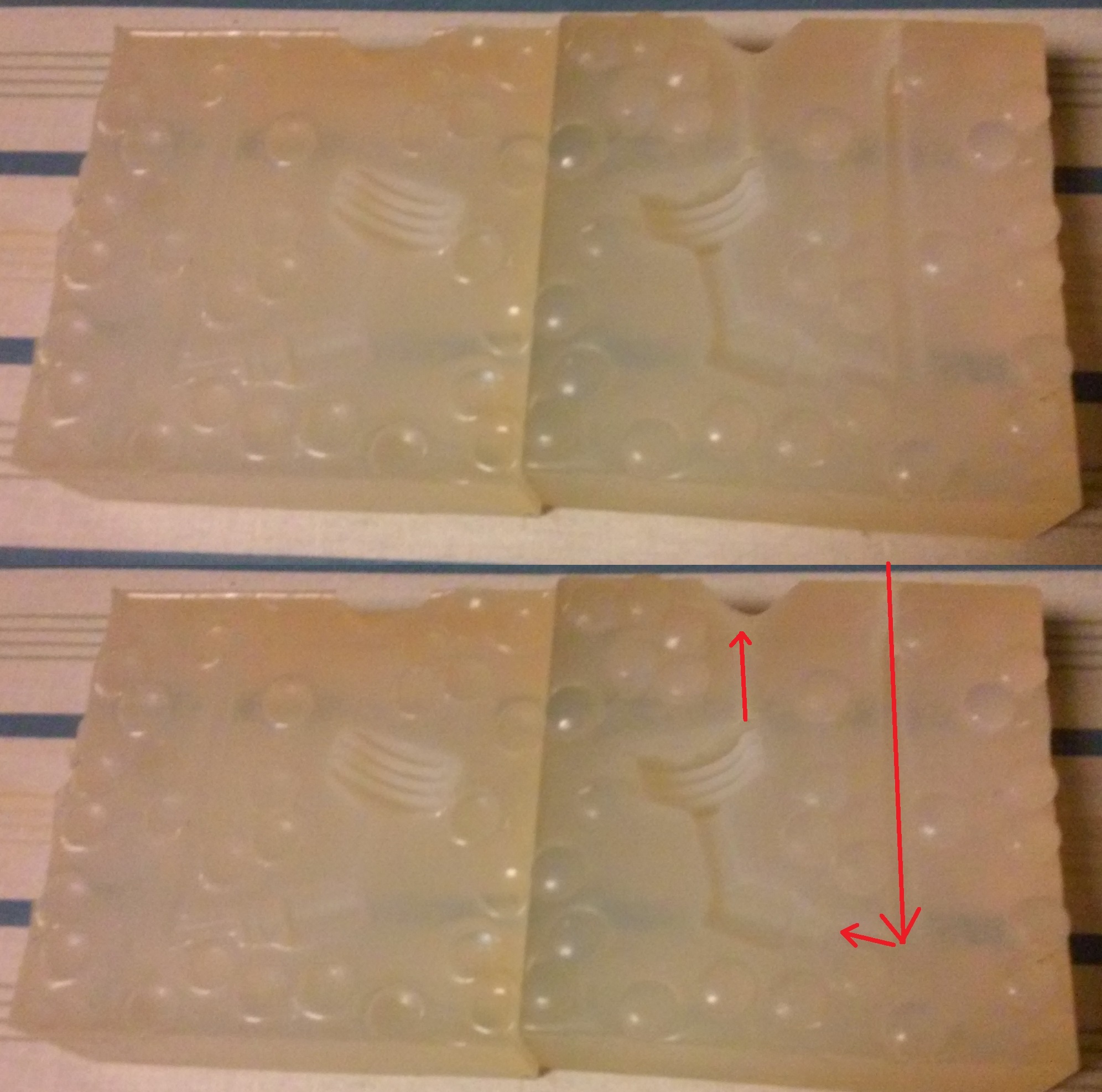

I forget what thread it was where someone asked to see this.
I lot of people make a mold where you pour the resin in through the top and it fills up like a glass of water. I am sure everyone has noticed that bubbles can churn around in a glass of water as you are pouring. As we know bubbles are bad. :unsure
This process reduces bubbles. With a syringe shoot the resin in where it flows through a runner that comes around under the part. Note how the gate is attached at the bottom. The arrows indicate where the resin flows. The mold fills and air makes it way out without churning. I have had many times where there are no bubbles at all depending on the shape of the part. The funnel shaped cut at the exit is a reservoir that will flow back if the resin has shrinkage. The finished part you see came from this mold. The part has a heat sink quality to the shape and the air made it's way out.
So if you are feeling ambitious give this process a try.

should note, wear eye protection! Ive had to inject plastic into molds for super tiny detail castings and more than a few times has the material literally explode out of the mold when my thumb was a little to ambitious with the plunger.
How do you go when you reach the end of the plunger? I have used a syringe to inject resin into molds several times and with mixed results. Small parts seem fine. Larger parts, not so. The good parts is, liquids can't compress easy, so the air shoots out, but I found if I squeeze the plunger too much, it generates bubbles. There must be a small amount of air trapped in the syringe?
Also how runny is your resin? The stuff I use is thick like honey. Think of how resin is just when it starts to kick, and that is what I have to work with from the get go. And so an injection system that forces the resin into the mold would be ideal. I kind of thought if it is possible to load tubes like those used for caulking and use a caulking gun to inject them.
My train of thought is to load the tubes with mixed resin and degass the resin in the tube. The issue here is that you can't fill the tube, only quarter fill and have up to four ready to go to allow expansion during the degas.
Has anyone done this?
I have only used that on two molds Neither one had the correct size opening for the syringe. If I was smart I would make a mold of the syringe tip so I could form a clay plug of the right size and use that while making the mold of the part. I guess I could just cut the tip off of one of them too.
I did not fully read the previous post. I have degassed resin inside the syringe by putting my finger over the tip and then pulling back on the plunger. But I have only used it on small molds so I do not know about the caulk gun idea. I don't know where I would even get empty cartridges for that.
That's a nice idea. I've done injection before, but it's usually top down. HAven't tried from the bottom up. My to do list is getting longer.
If it's getting thick already then maybe you are waiting too long to deliver it to the mold. Consider what you are doing and how you can speed it up. Also, I will at times put the resin in the refrigerator. When you use resin I am sure you all notice it gets hot as it hardens. If it is chilled then it can buy you some time. When drawing resin into the syringe the turn it over point up like a doctor and get the air out. When you shoot the resin nothing is forcing you to push the plunger until it stops so if you know there is air in the syringe then stop before it gets to the air.
