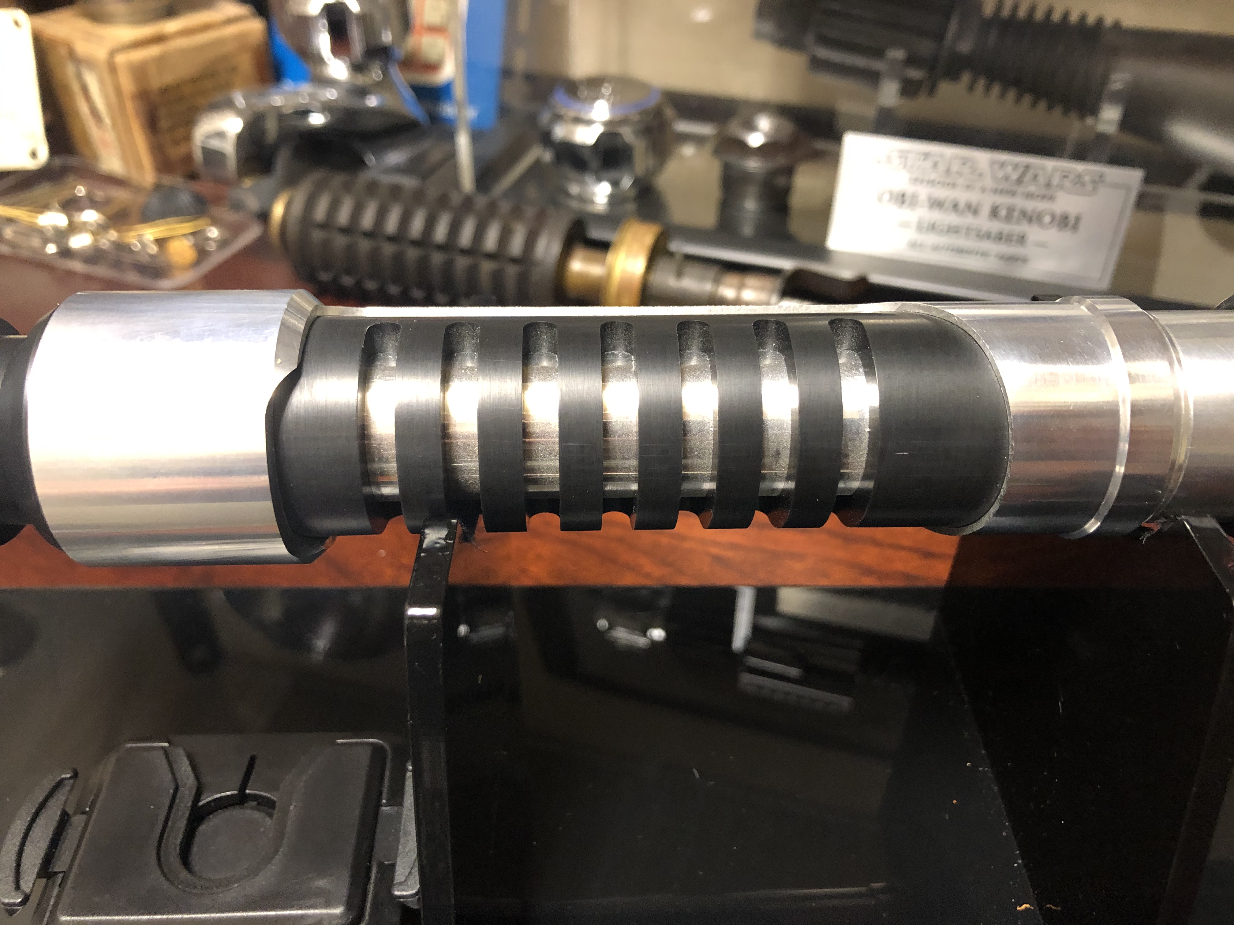

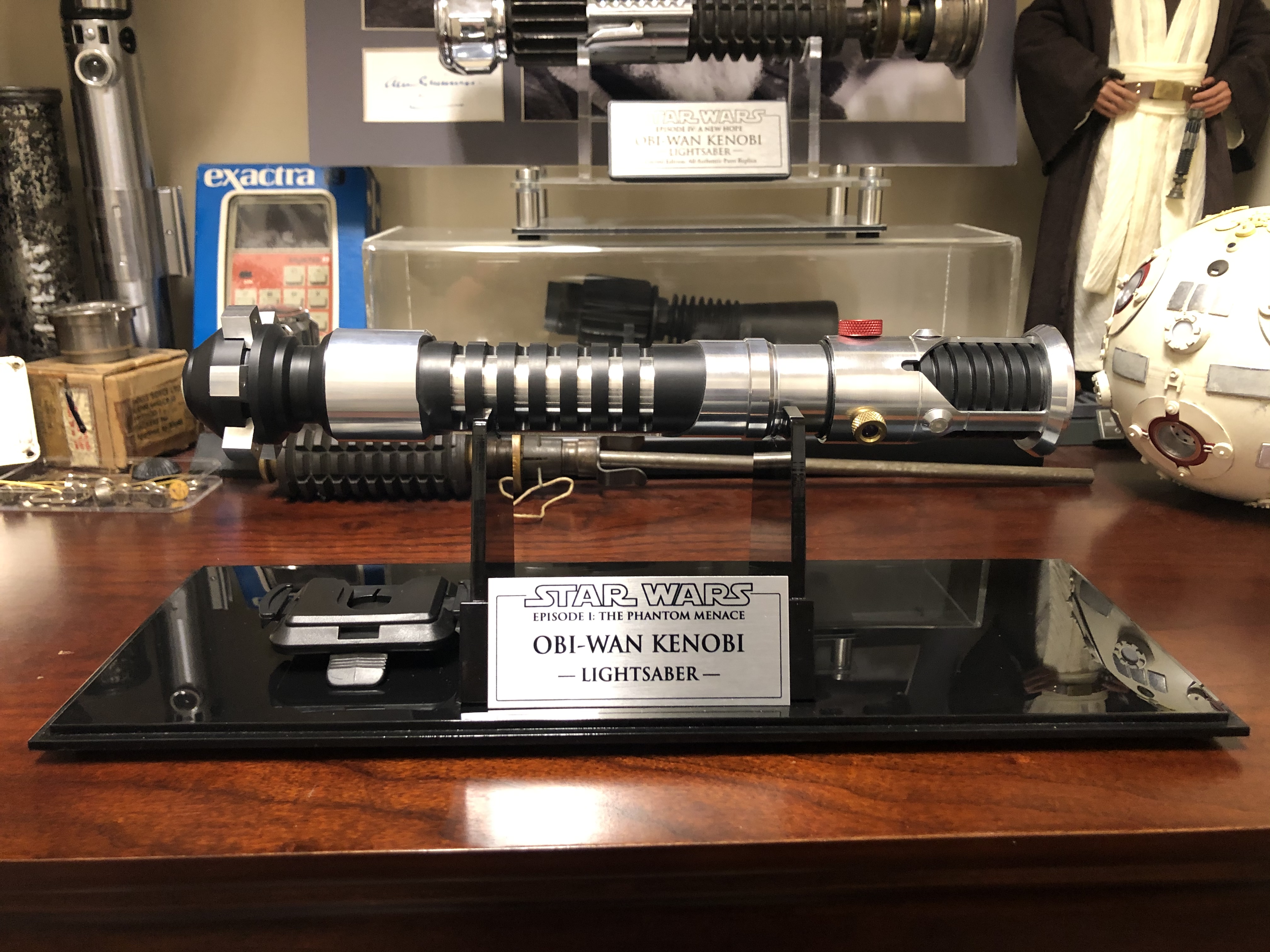

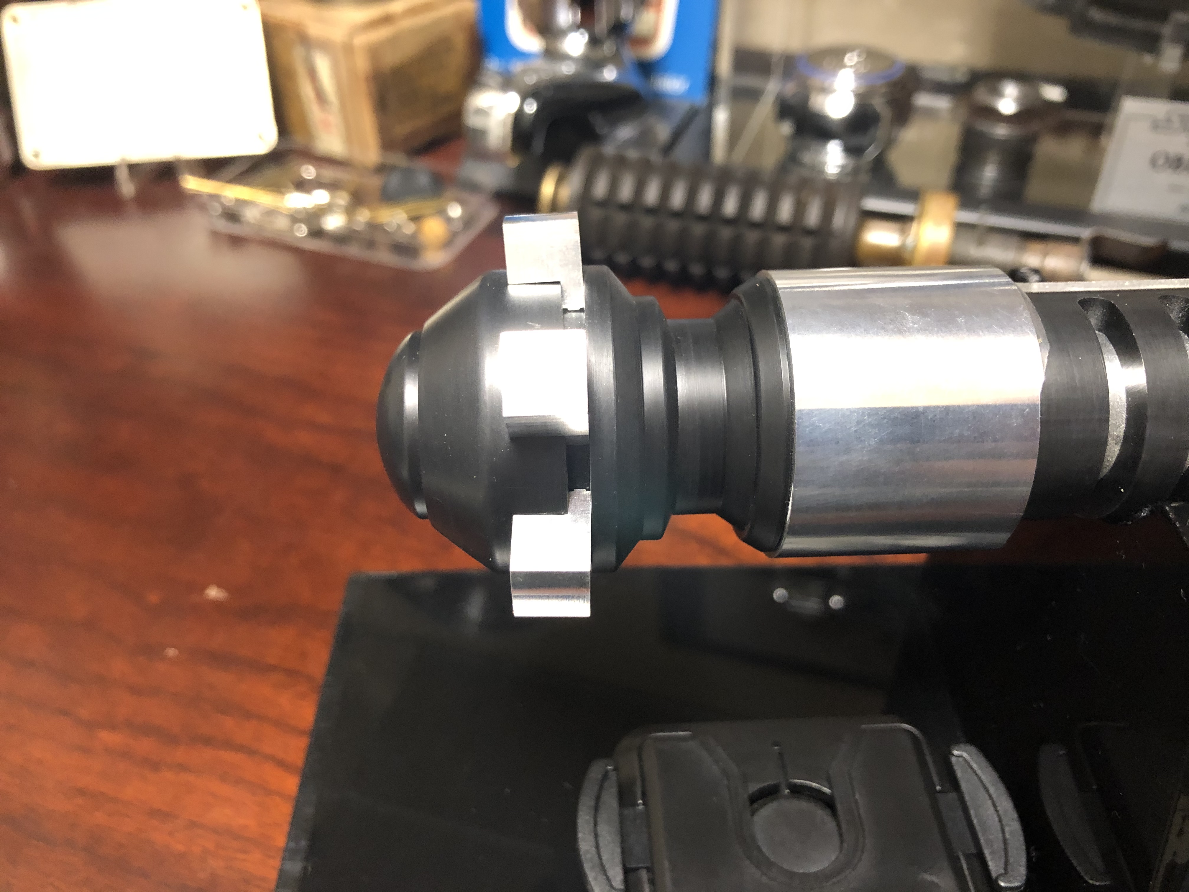

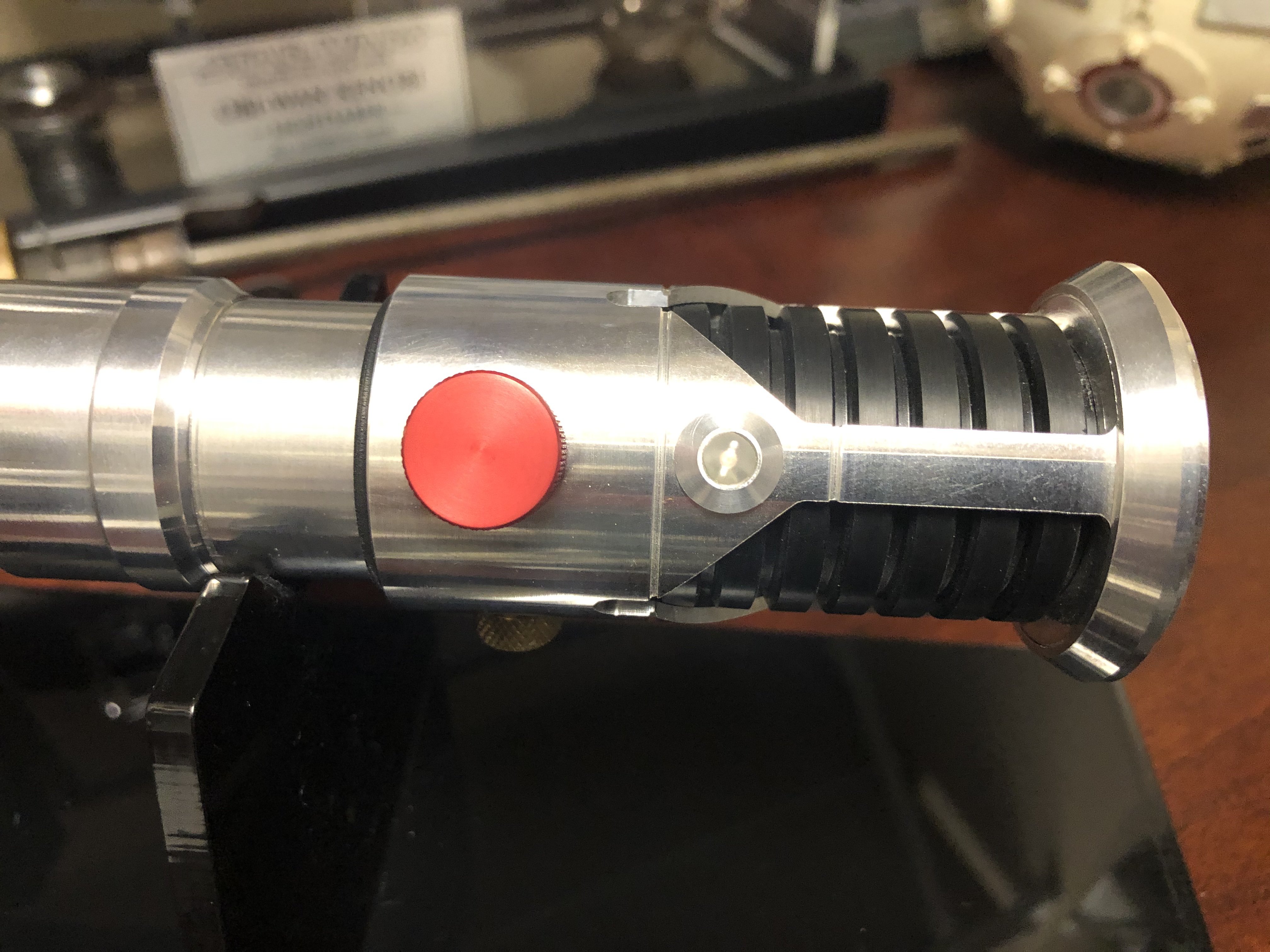

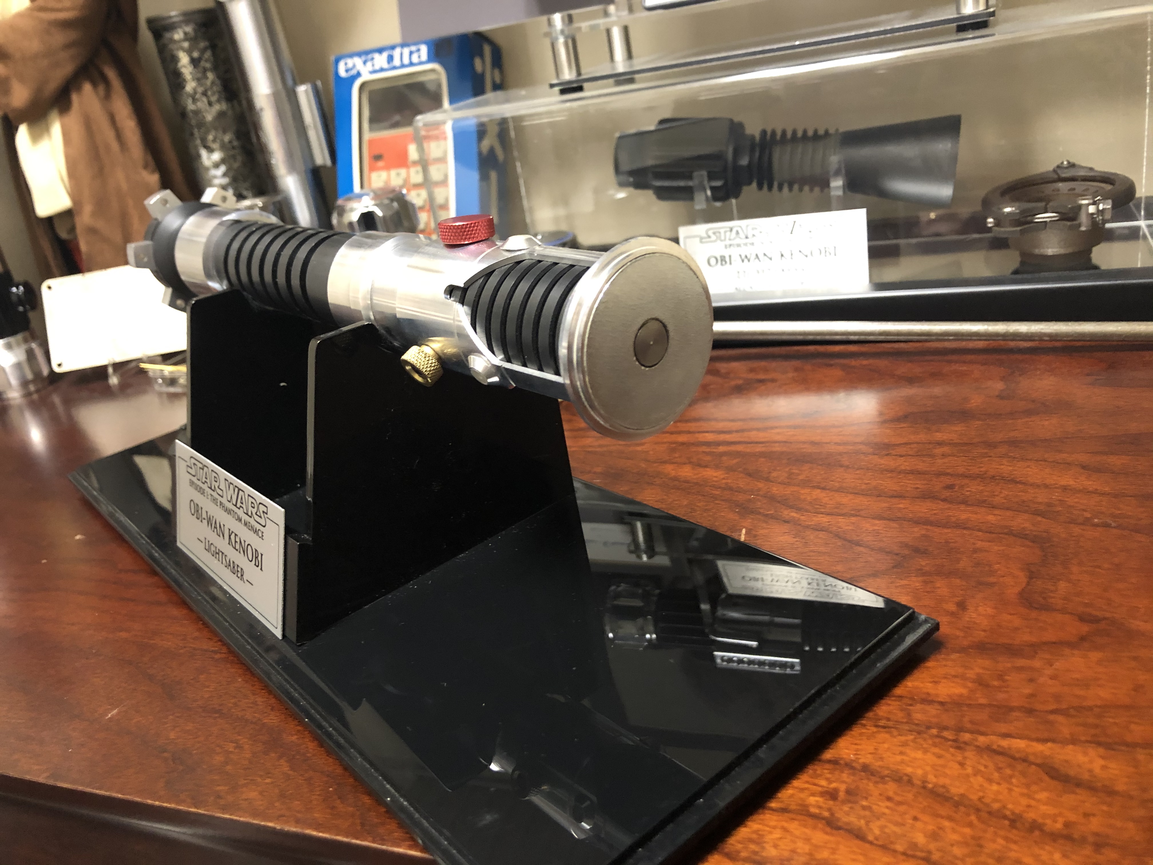

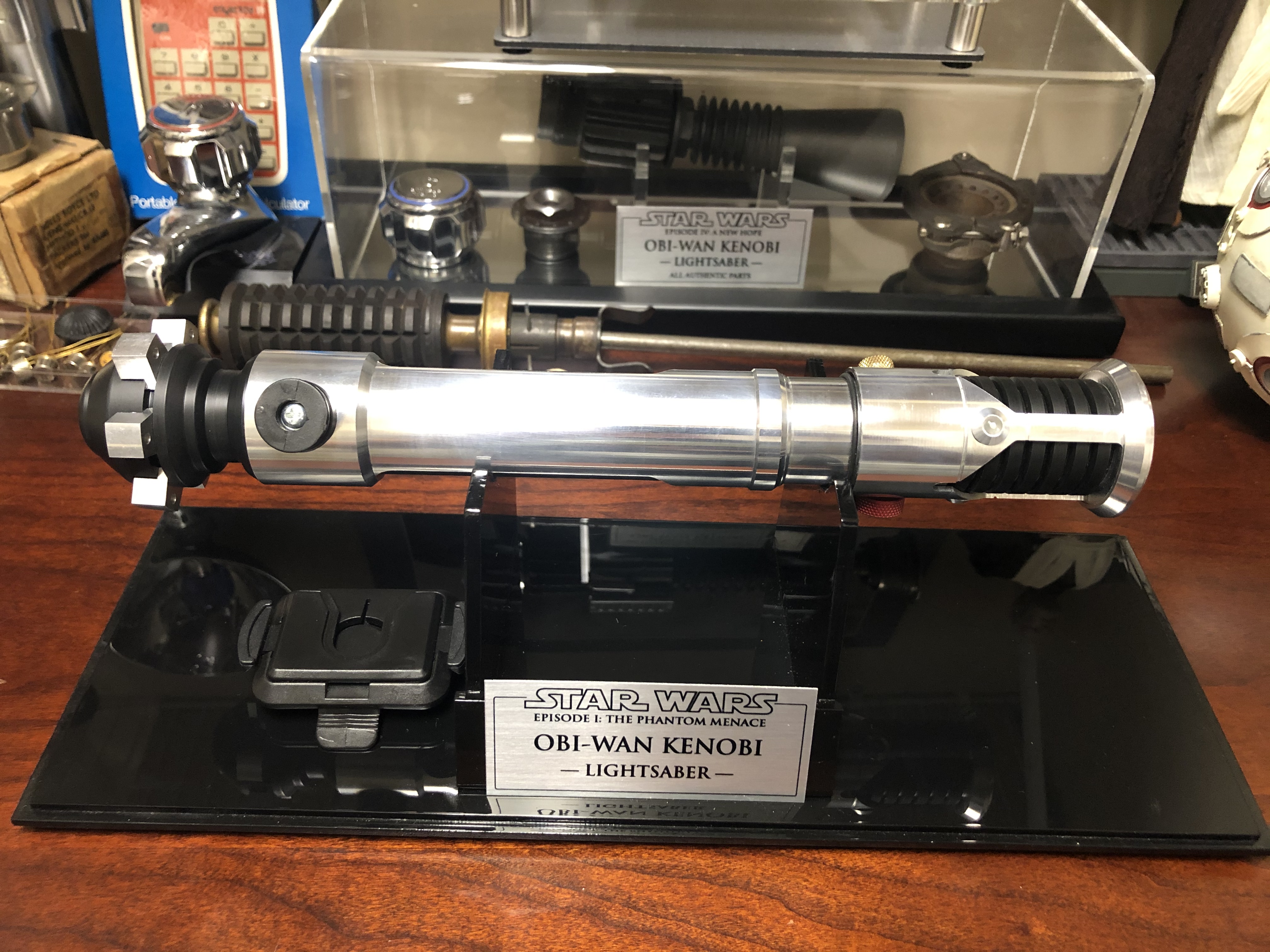

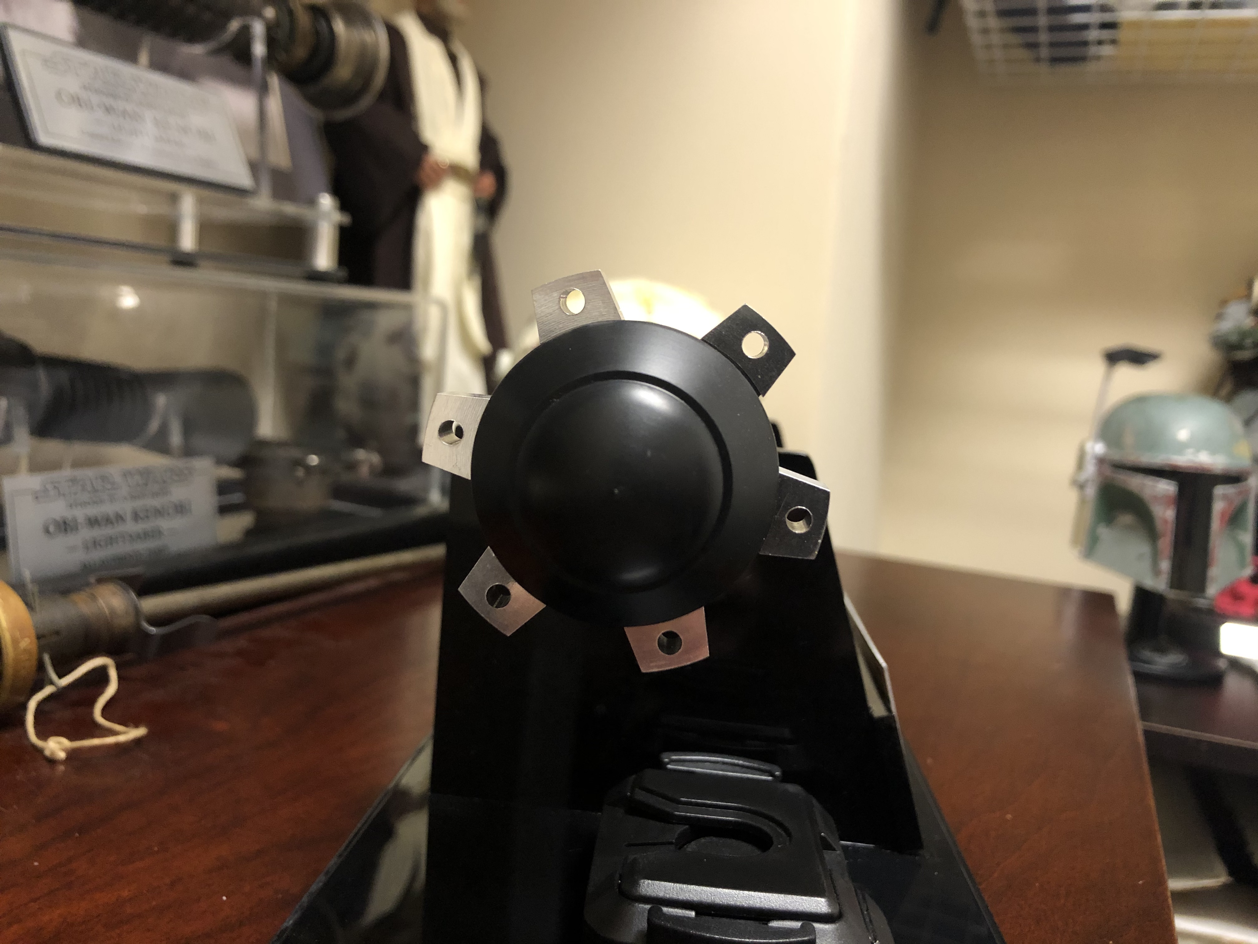

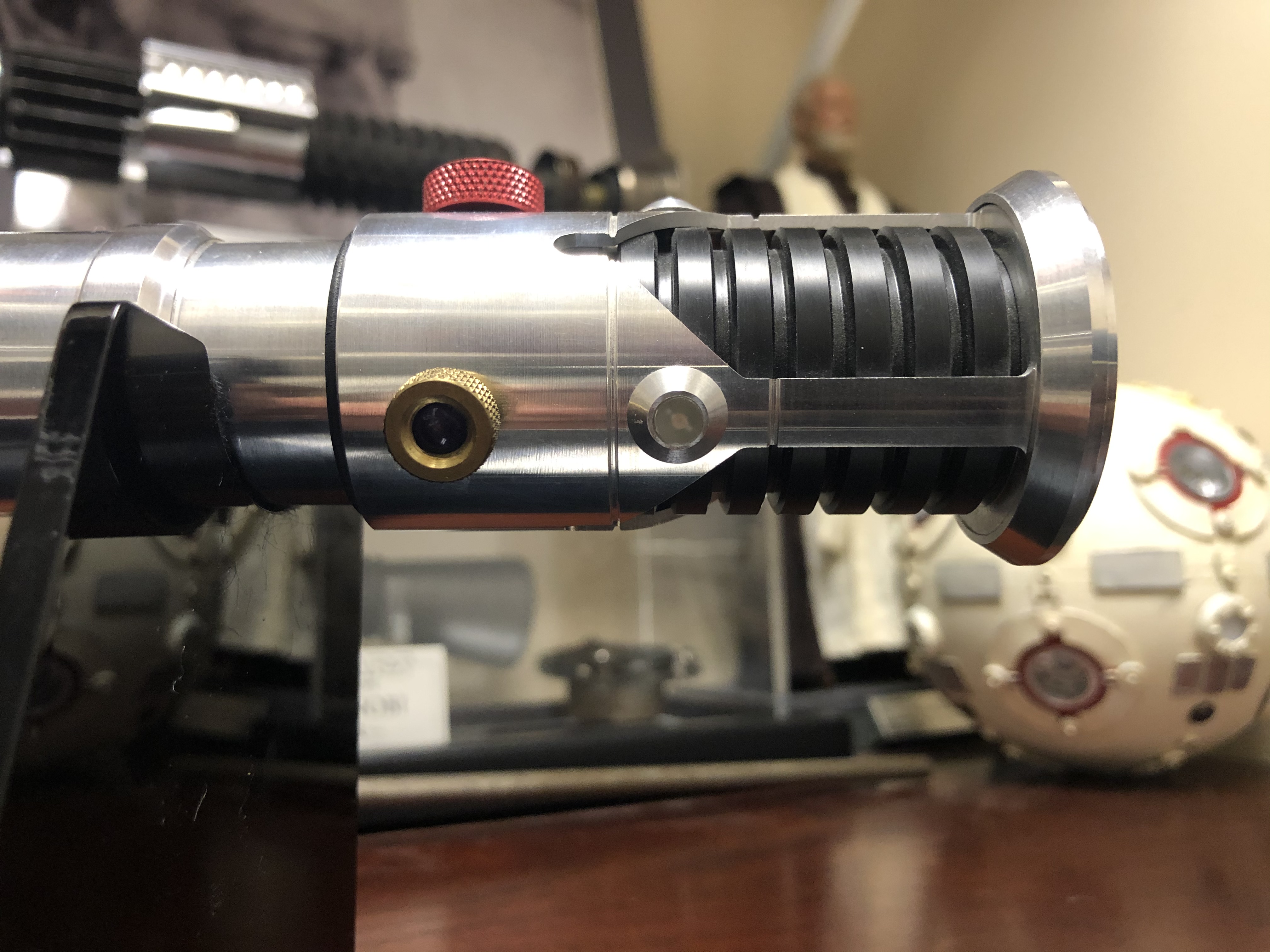

Here are some pictures of the aluminum and delrin run from years ago.
I need to replace the o-ring, but as a display piece, it’s amazing.
after the machining... looks like the powder coating on the pommel. (y)
* still not as hard (easily scratched) as AL.. but looks good.
