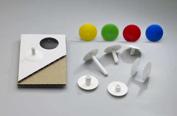

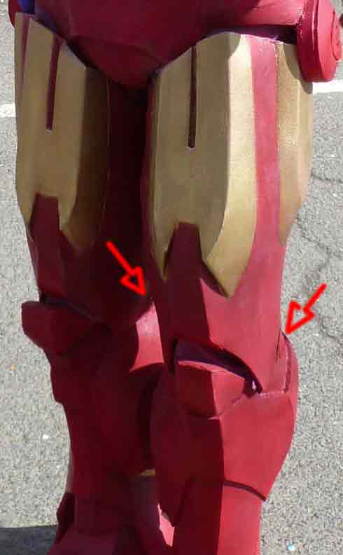

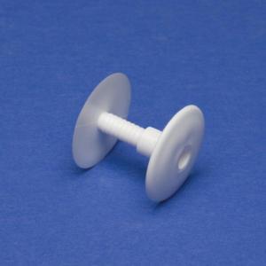

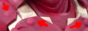

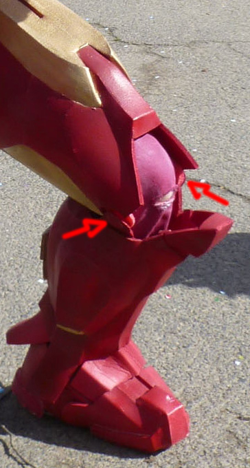

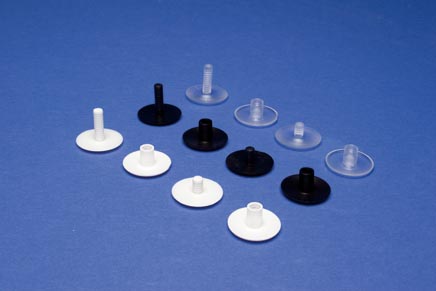

Joining articulated and some sealed parts :
I used to work as graphist in a publicity agency, and we had always somewhere in the office a couple of useless and sun-faded color charts.
And ?

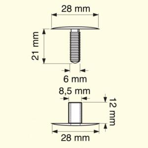

And I kept thinking that the potential of these pretty little plastic juncture clips were heavyly underexploited.
So I ordered a pack of 100 pieces, as it almost doesn't costs anything.
You can find some here or here or here or here... of various shape, color, diameter and thickness.
And I promise you some discret and incredibly easy attaching for mobile parts (knees elbow toes...) as well as sealed parts such top chest, flaps, handplates, spin and so on... depending of the pressure when cliping.
I am looking everywhere for these clips in the US do these have a particular name?
