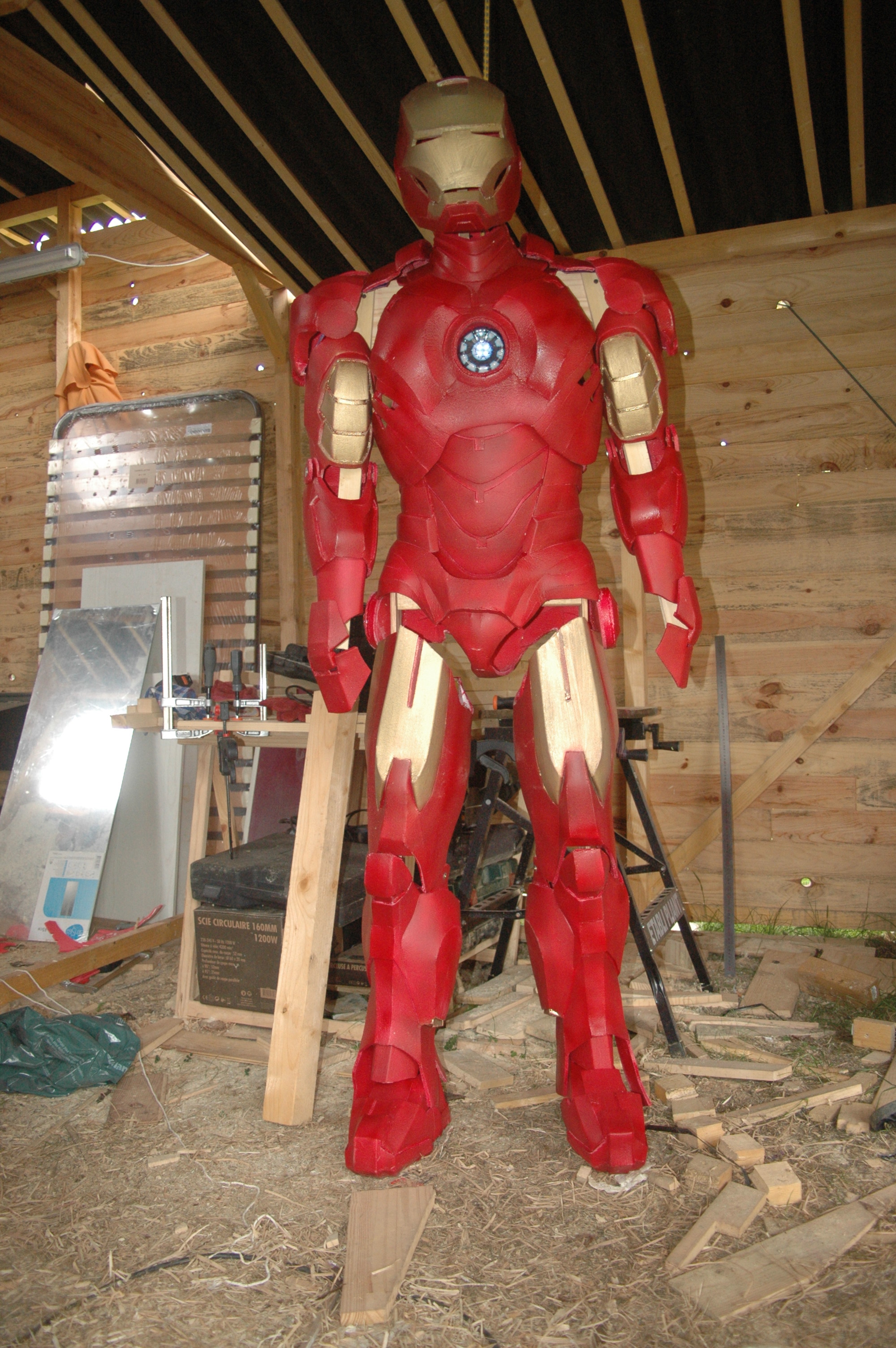

my 3yo daughter's school carnival's day was aproaching, and it would happend just the day of my birthday. Parents who accompanied where invited to disguise too, so I decided to release myself, making an old dream come true.

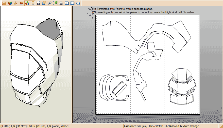

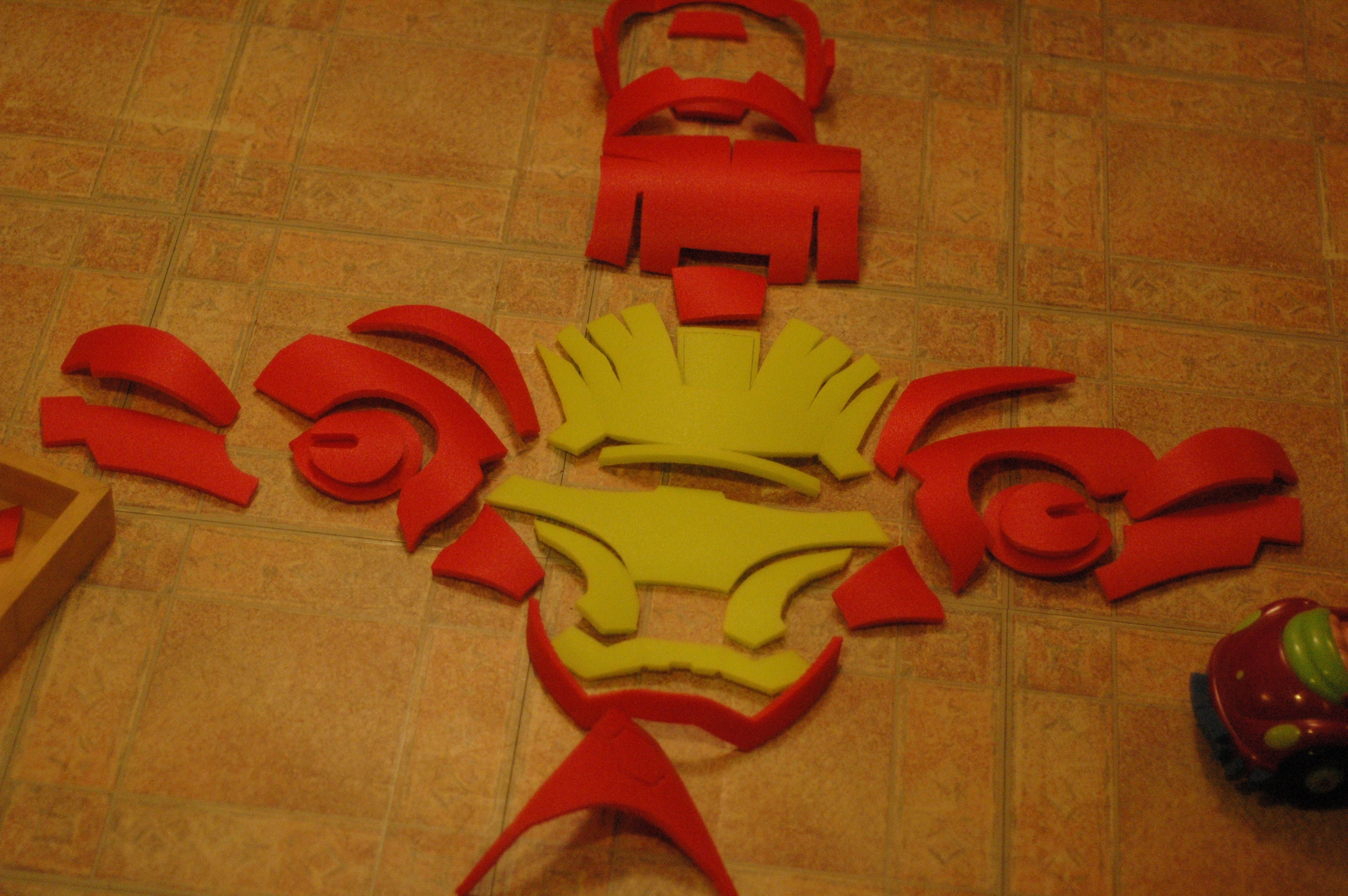

So, I surreptitiously picked up robo3687 iron man mark 4 foam pepakura templates (robo3687 you're my personal Jarvis), took an half-day for shoping, whole day for revising and modifying pep files (I prefer taping multiple sheets together to have larger pieces of foam rather than cuting and regluing many small foam parts, this way it seems I save a lot of time) and began cuting and gluing (my fingers and) yellow and pink 6.5mm PE foam... With the instant agreement of the original modeler : here are Robo3687's files, foam unfold JFcustom .

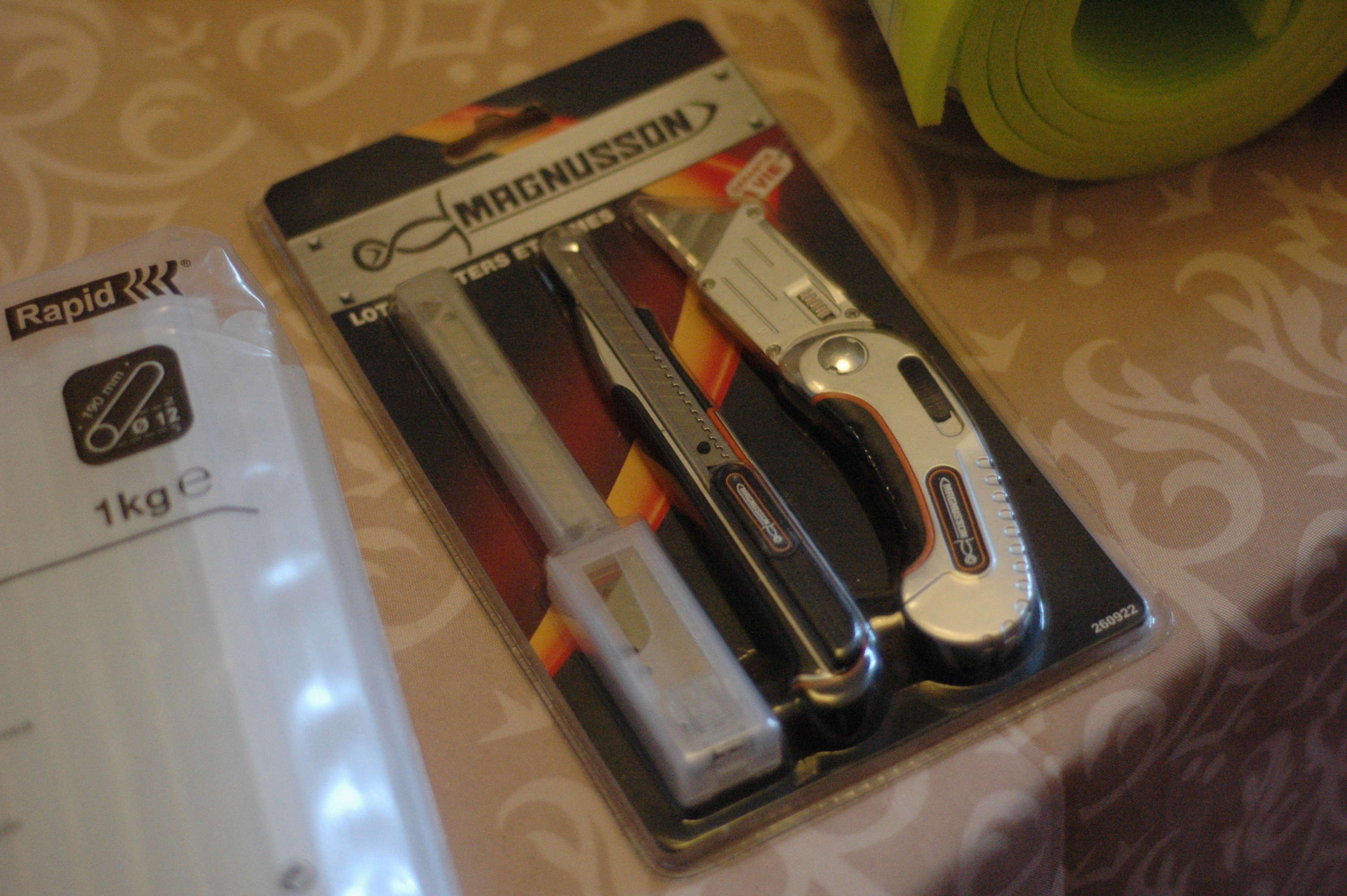

Glue, brand new sharp cutter :

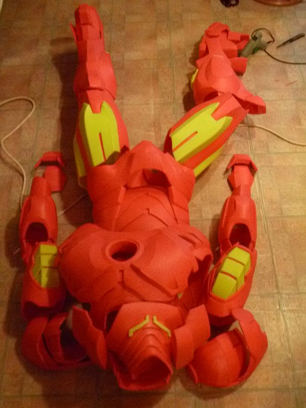

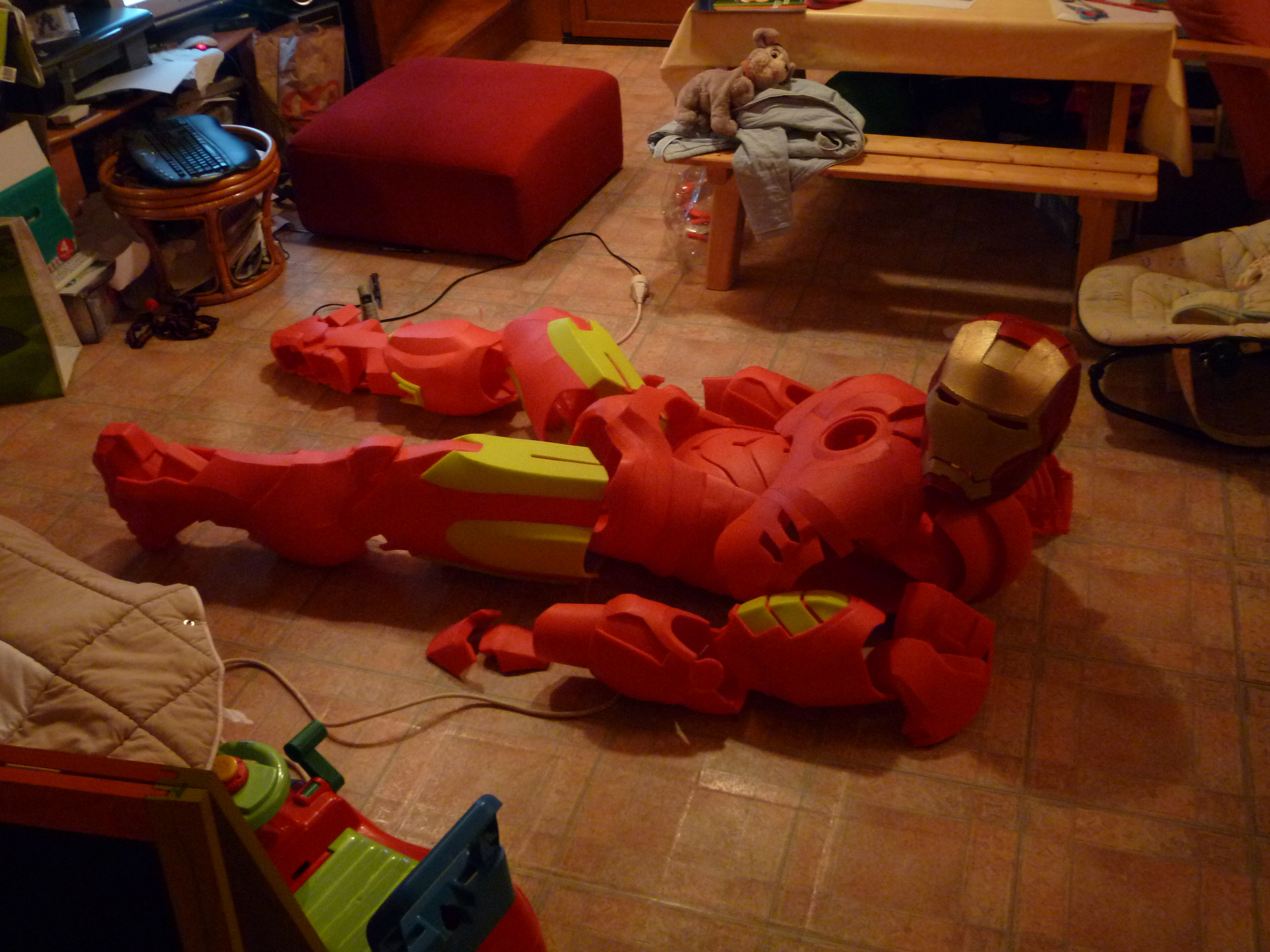

Seven pink and one yellow :

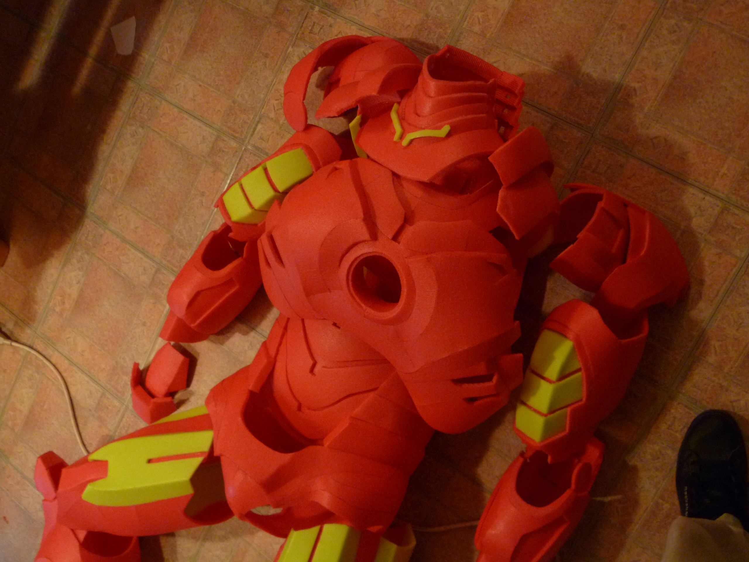

Two coats of Sikafill TM, and first coat of paint :

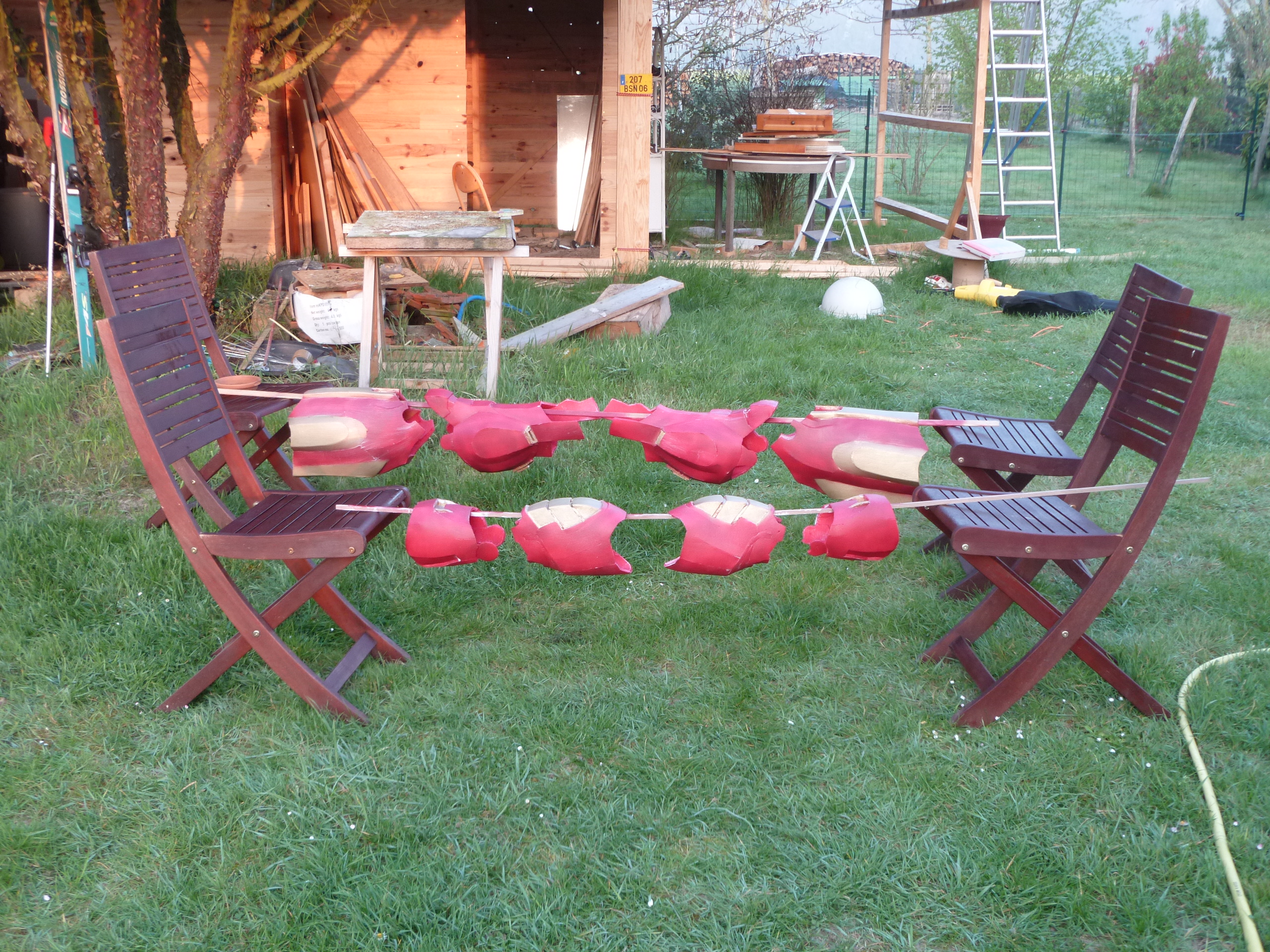

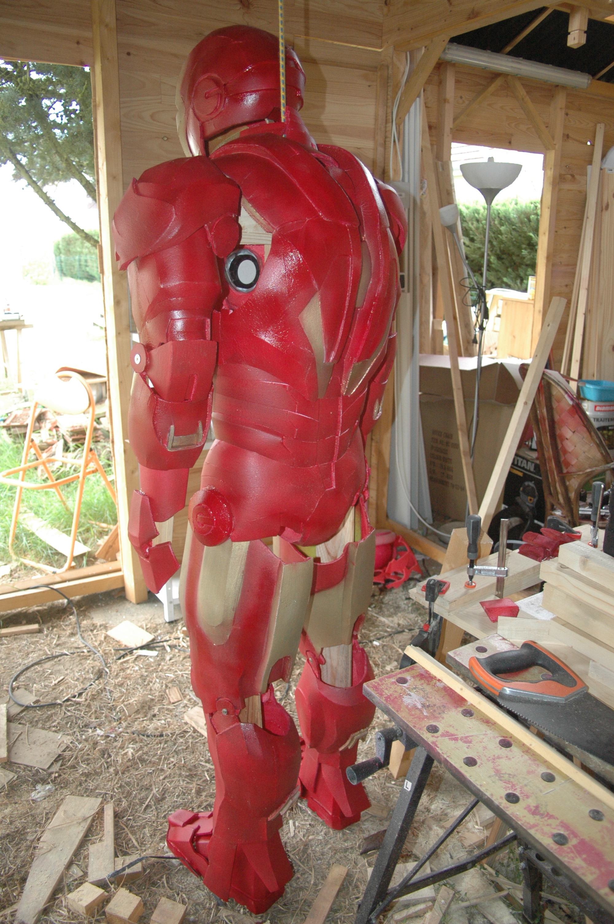

Second coat of paint, more accurate, and let's try it out :

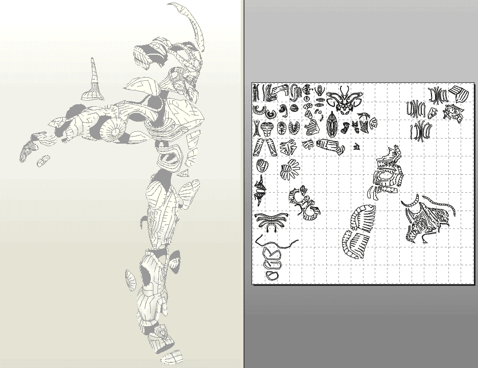

And after that, my next realisation and work on unfolding and building this foam-pep Guyver will be the object of a new post...

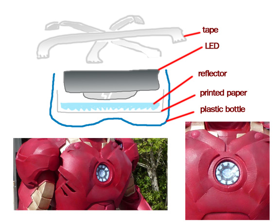

my cheapest operational ARK reactor for moneyless
- you need -

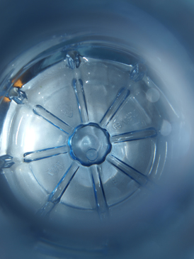

An Evian bottle bottom, 2 inchs height :

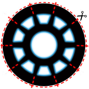

One of this kind of pics, of your choice, printed on the thiner paper you can find, cut along the dotted, and then oiled for a better transparency :

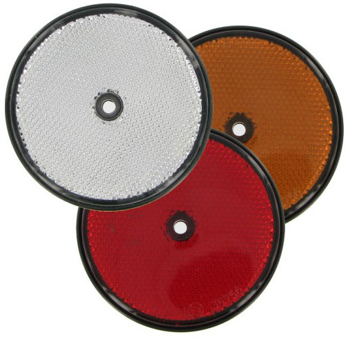

A 80mm white round reflector, as you can find at the front of caravans or trailers (keep only the transparent part, of course, but better is to specify it however) :

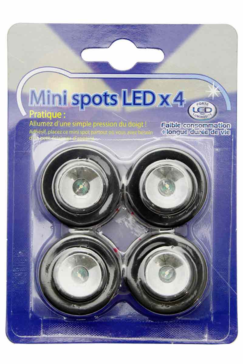

A led(s) push-spot
and a roll of tape
- HOW TO -
Fill your bottle's bottom with
1. pic of the ARK, printed side turned down,
2. reflector, rugged side down, slicky side up in front of the leds,
3. led spot, lights turned to the reflector
4. cross tape your bottom's bottle to keep all inside in place.
5. Insert the thing in your chest, it fits perfectly, and holds alone.
Push, it works.
Price : 2$

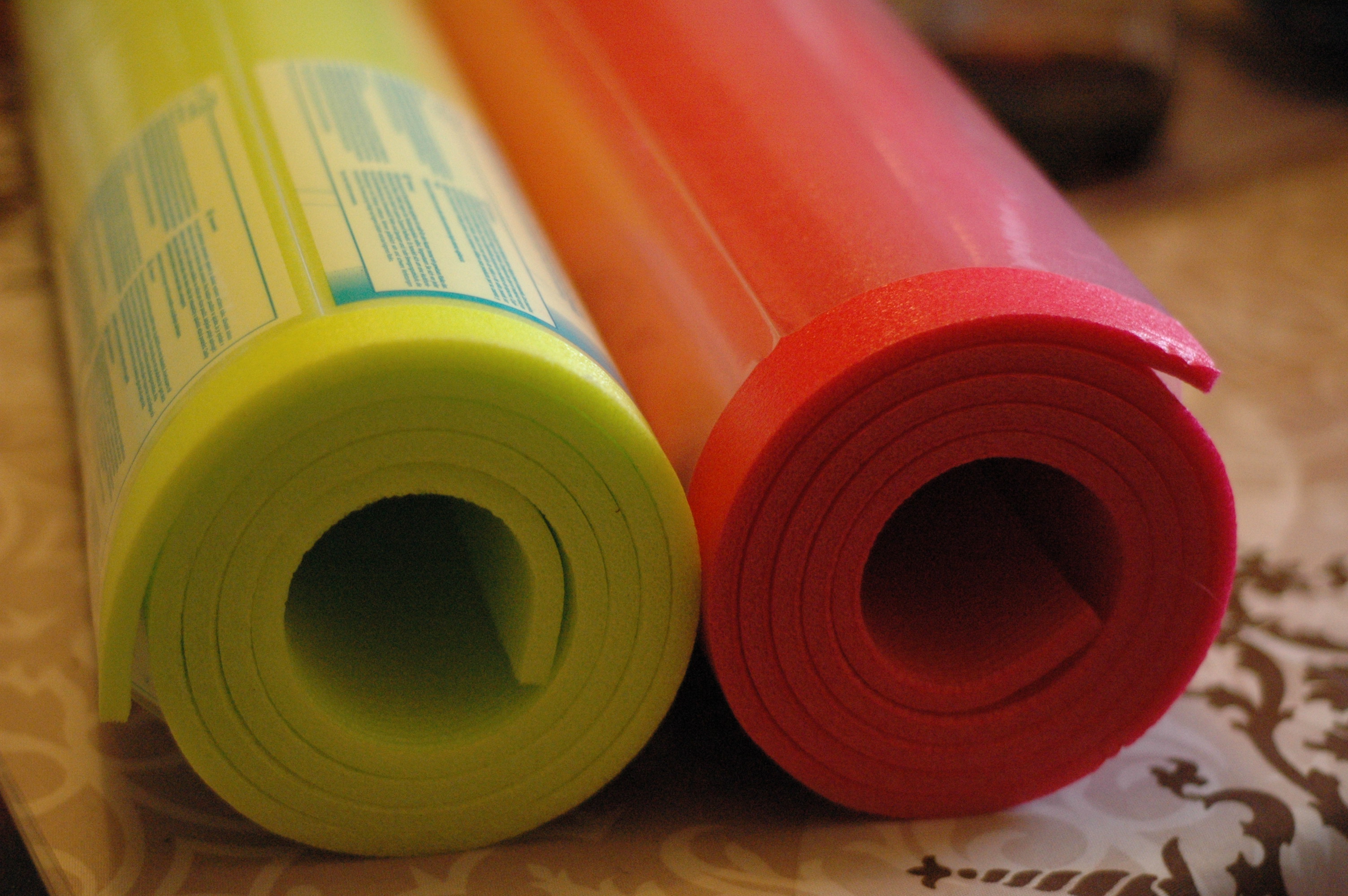

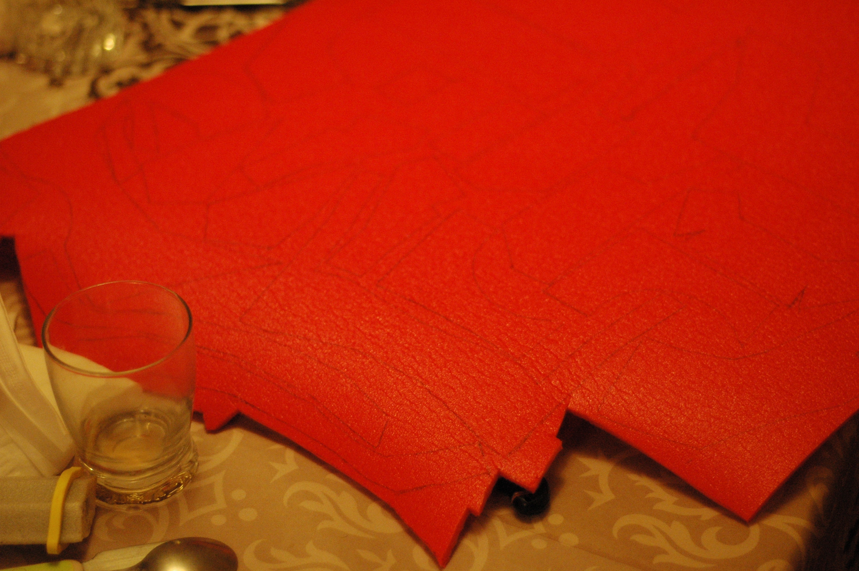

Well, what paint did I use... I picked four cheap 10$ red Technoral acrylic sprays, color chart RAL3004, and one common 6$ golden spray that I half used for chistmas decorations.
I got the foam at Decathlon, a discount sport articles store chain supllier of Oxylane products, sold as fitness mats. A kind of 140x50cm polyethylene carpet, 30 Kg/m3, 6,5mm thickness.
7 pink ones >>here<<
and a yellow one >>here<<
2.95EUR, meens about 3.75$ each.
Note that these paints do not hold on foam, and once dry crack on a single bend. Add that this foam is not completely slick. I had to apply in the hurry a couple of coats of Sikafill, an industrial flexible waterproof coating to seal roofs, to harden foam and make it smoother, fill gaps and hide few trivial bonding failures. And moreover, paint adhere on perfectly.

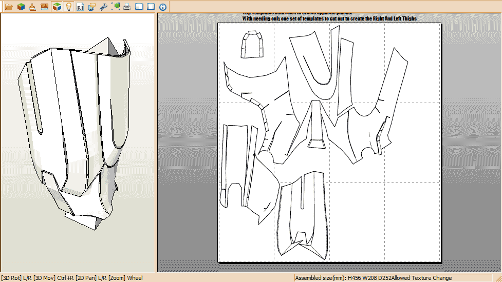

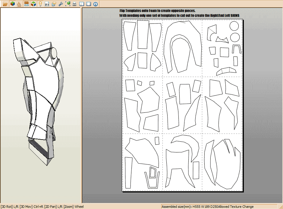

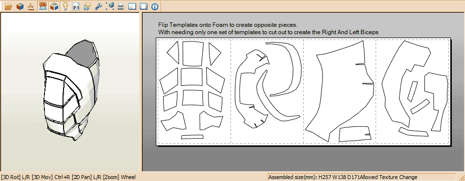

On all pep file I found, it's always the same : objects are cutted in a profusion of smaller parts that always fit on a paper page. A4 or Letter. And of course it is, because pepakura is originaly designed to realise objects whithin paper itself as soon as a sheet comes out of the printer. You can't print a larger piece than a sheet of paper.
But,
I build with foam, not with paper. Paper is only used as a mask for cutting foam, because sadely my 1.40m mats can't be insered in my printer. I know, I tryed.
Here's the hint, illustrated :
an unrefined biceps :
a JFcustomized biceps :

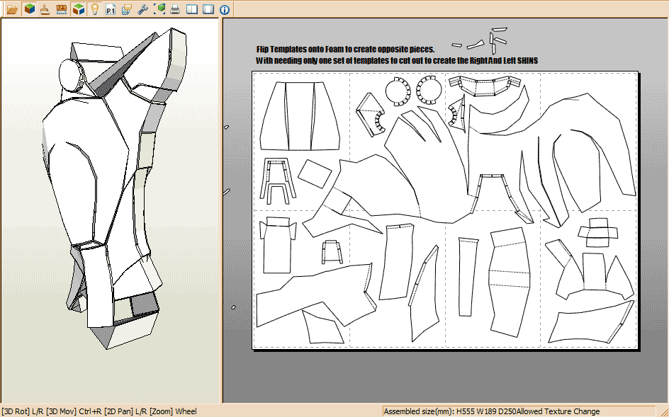

an unrefined shin :
a JFcustomized shin :

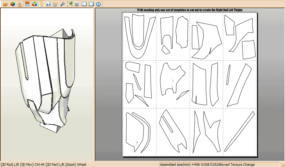

an unrefined thigh :
a JFcustomized thigh :
and so on...
1. print your sheets
2. tape your sheets
3. cut your paper masks
4. cut your foam from the masks
5. you get less and bigger foam parts, you save gluing time, and less junctions means nicer curves an inproved "anti-aliasing".

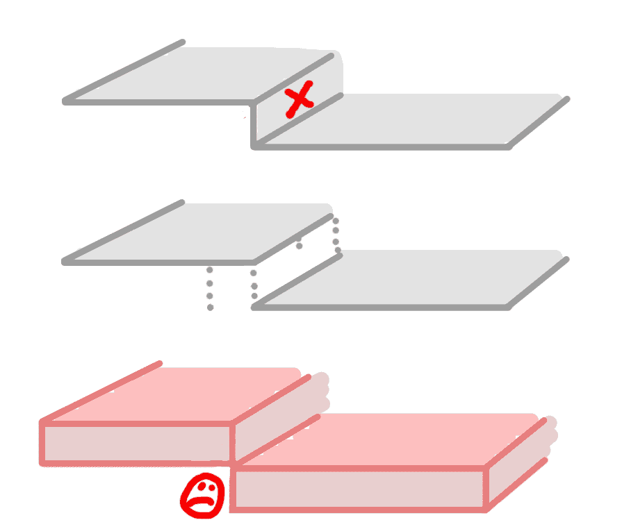

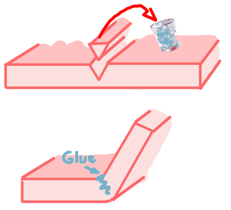

As you could have noticed, an other trick is to keep some of the small rush parts of the original paper pep files, in order to enlarge some foam pieces to be sure to have enough overlap surface to glue parts together, while foam thickness keeps compensate the deleted part in the first pic below :
Before :
After :
And this way for marking edges (shown from under) :
