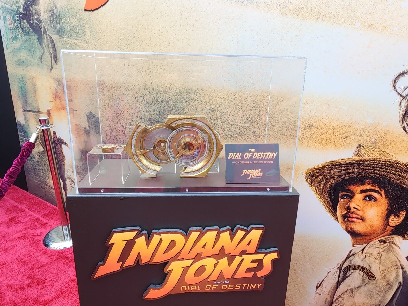

This photo: Every Velvet-rope post at theaters near me have at least a 14" base. I drove around to measure them all. Could be forced-perspective trickery but the size of the base of the rope-post in this shot and this film-model would mean the base isn't 14" or the film model isn't 8".
If this film model is 8" tall, that would (probably) make the rope base 10-11" and the placard 5x7 and not 8x10, which yep could be the case.

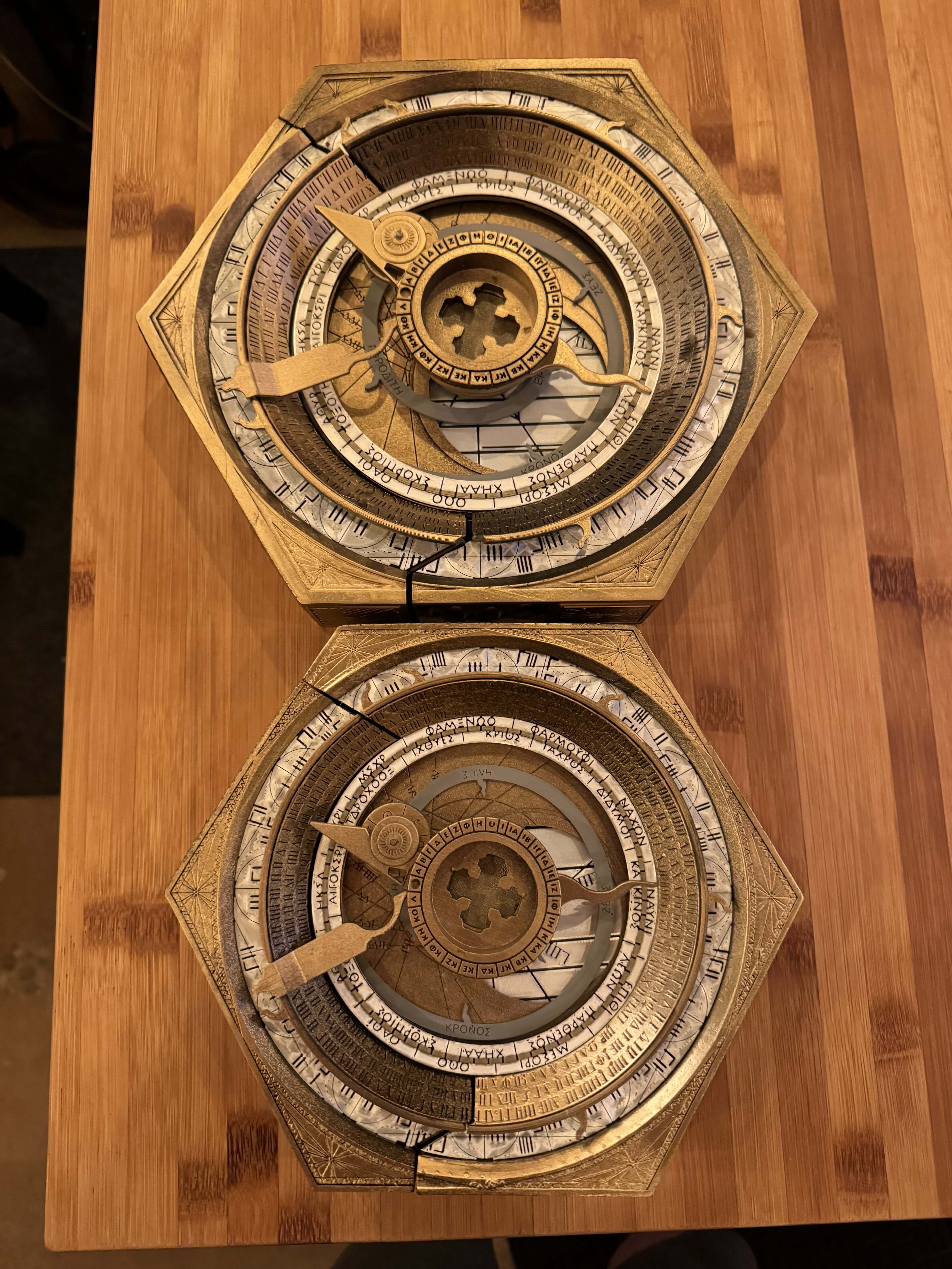

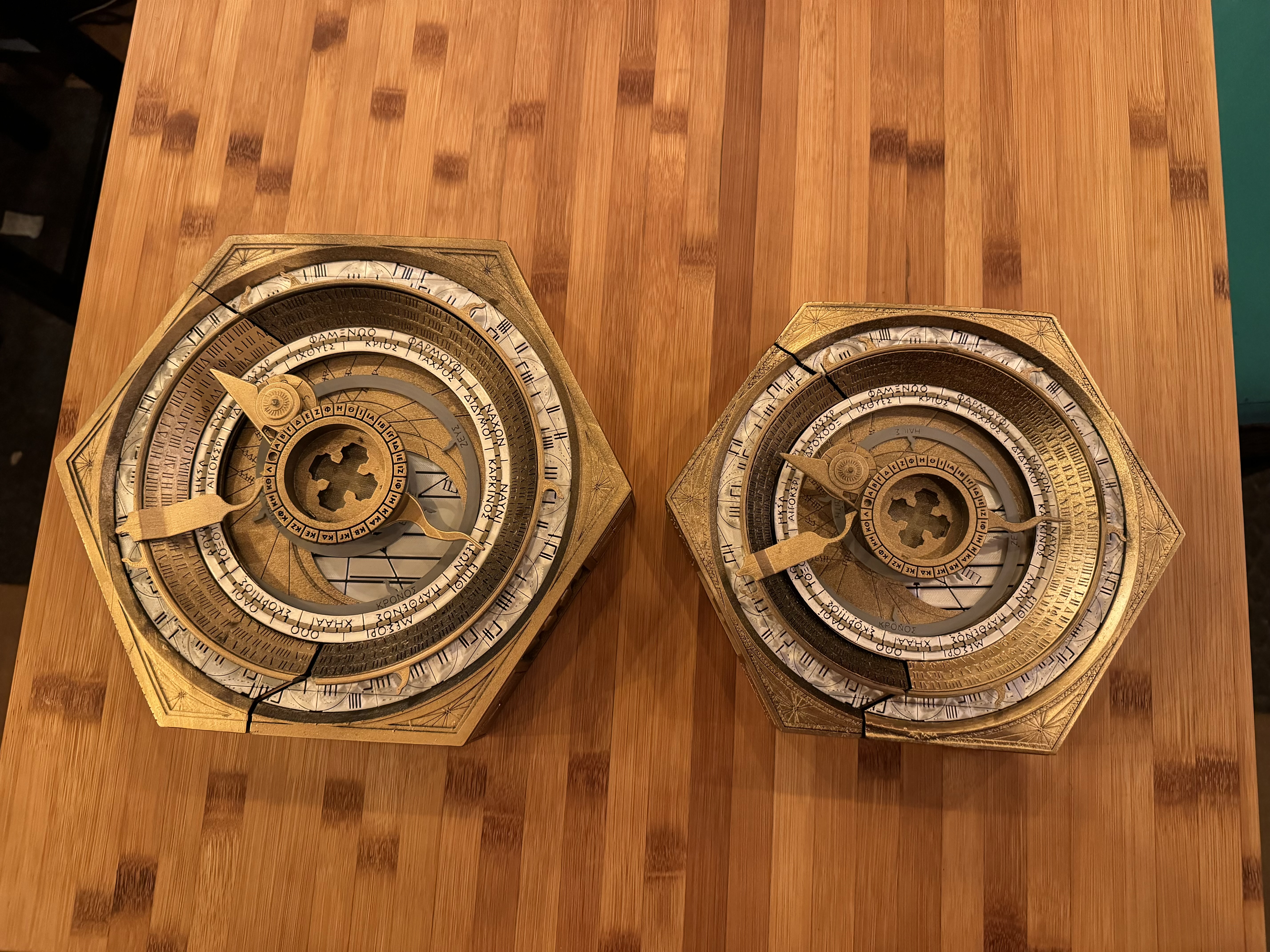

He felt like the 248mm x 284mm x 48.6mm build size more closely fit what he saw in the case.
After watching the movie and special features a few times, I've been building them at a ~240x210x41mm size basis and it definitely "feels" like a better size in relation to a common adult hand and more importantly the messenger bag.
I'd love it if a definitive size was settled upon by smart folk, though.

Around Halloween I pretty much switched over to the smaller build size. Coincidentally when I sent this 210mm resin build to the same person that attended the premiere he still felt it was smaller than the premiere display but right for the on-screen prop.
Apologies, I'm aware feelings aren't measurement! ;)
When I settled on 210mm as a basis for the smaller / regular sized dial I based that on the average size of two german pocket-watch style compasses that I had and used the compass diameter to scale the rest.
I think the measurements of the Disney World prop earlier in the thread also support a smaller size but I think it may be a little small.

I used this, where the hand is roughly at the same distance from the camera. On my hands (which seem to be pretty average) the distance between knuckle and first joint is like 5.5cm for index finder and 6cm for middle finger. Based on that and doing the same on the screencaps as well as the prop promo video the result is pretty consistent at 5" for the sides' lengths and a resulting good 9" for the height.
That would make the inner display height roughly 18" which also fits with my measurement of about 45cm from waist to roughly the position of the display upper egde meeting his chest. He is 4" or roughly 5% smaller than me.
Using his eye distance and comparing it to the height of the display, it would be a max. of 18" for the display height, with an 14" as a minimum and 16" for an average eye distance. 16" is also the number if I take an average head width of 6". That points to the dial not being (much) higher that 8".
Completely unscientific, but maybe someone can ask Peter to measure his eye distance or the width of those glasses.

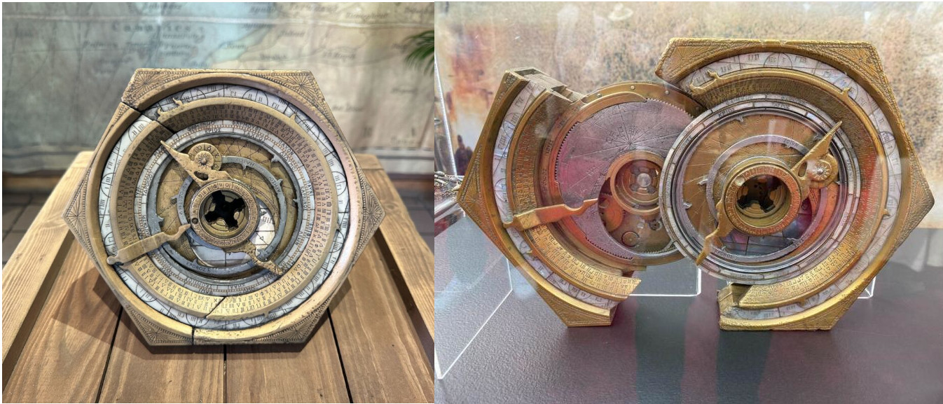

There were more than one dial in the movie. The one from the Den of Destiny in Disneyland was smaller and had slightly different features, like different hands. The paintjob was different too. So my guess is there is a stunt dial and a close up and functional version like from the idol or the skull were back then.
The paint job is very different depending on the scenes.
For example, when Voller first pulls out the Dial in the prologue, the circular pieces on the face and the piece under the middle section are just flat white. And are flat white for most of the film.
Then, we get a short view during the finale where it looks more mother-of-pearl.
The nightmare of replica-fanatics - inconsistent paint jobs and props!
A quick reminder its been revealed (I believe earlier in this very thread?) that the one from Disneyland was sculpted and built for Disneyland. Yes, there were likely different props for hero/stunt, but the one at Disney should not be used as reference for either.
Going through all the screencaps and only talking the later full version I can see two models, the Voller „hero“ one and the Archimedes „stunt“ one. Main difference is the outer hand which has a shorter first bend on the hero so it goes between the other two, while on the stunt one goes lower and would probably collide with the other hand. The hero also seems to have a more pronounced „chain“ seperating the inner mother of pearl ring.
Nowhere in the movie did I find the Hollywood Studio version where the outer hand has three levels. But taking influencers, fingers, wristwatches and phone directories as reference I can now confidently say that all versions are roughly the same size as the Hollywood Studios one.
