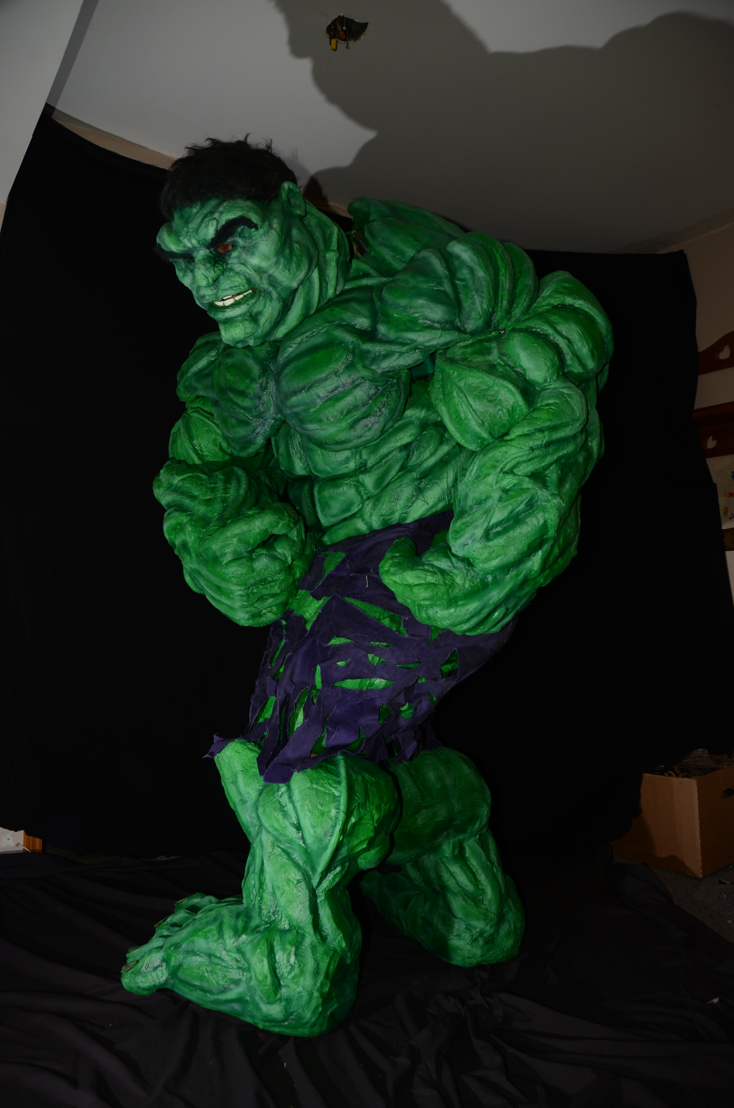

i did a hulk last year i posted my progress on deviant art ill link it to you may help get you started. good luck . looking forward to seeing another hulk.
had alot of fun with it it was for a 6"6' guy
made from regular cushion foam . started with a morph suit and went from there . was my first muscle suit. it gets easier the more you do and if you do yourself you can customize it .
