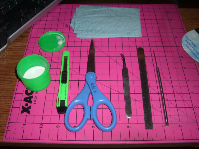

I cut and score as I go...cut out a few pieces with scissors and/or a snap-blade knife (stopped using X-acto knives a long time ago, snap blades are far more cost effective) and then score my lines using a small 6" metal ruler and a straight stainless steel pick. The pick doubles as a glue applicator too - just a dab on the end out of my glue pot, a quick smear on the tab, and then wipe the pick off on a folded-up paper towel. Metal tweezers are an excellent tool to apply pressure to the glued tabs, makes the glue set very quickly.
Here's a pic of the tools I use 99% of the time:
And yes, my name is on my scissors, because my wife and my son both have a habit of walking off with them when my back is turned. :lol
