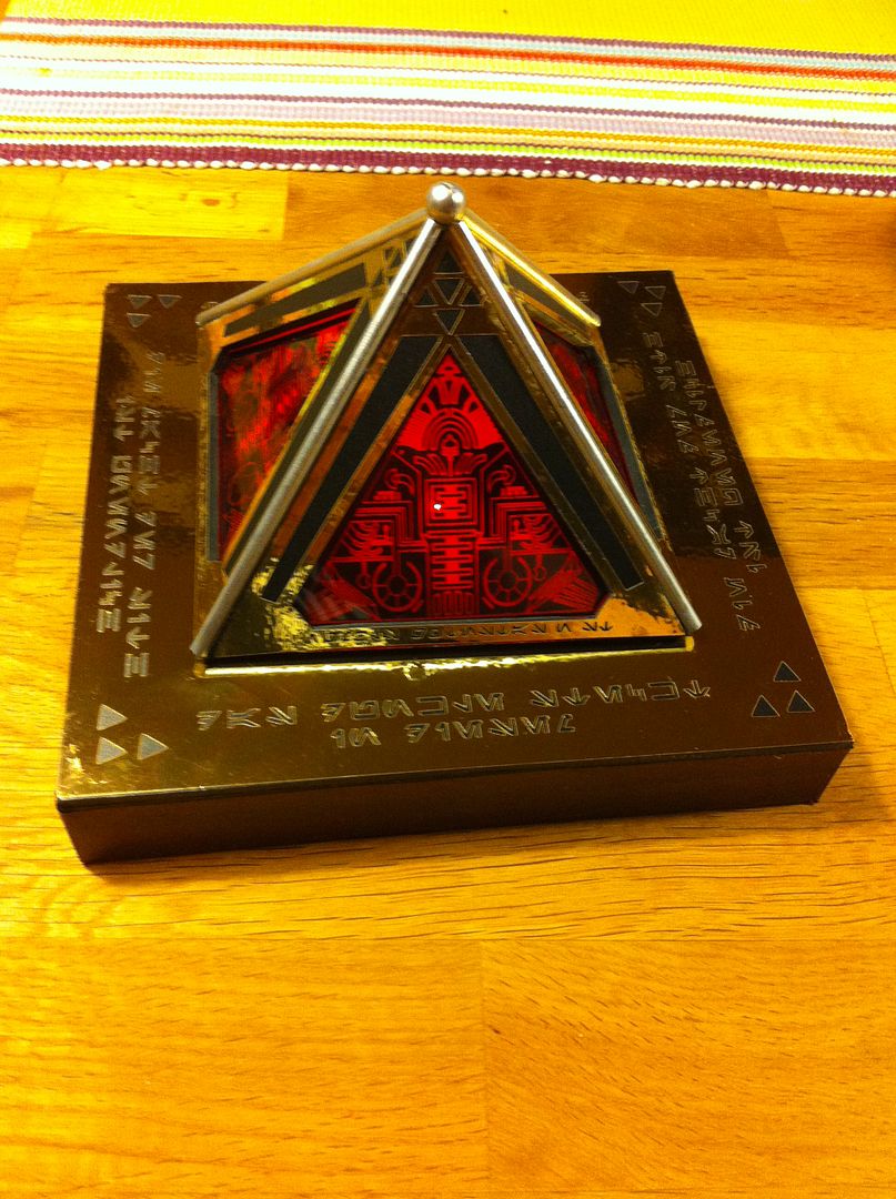

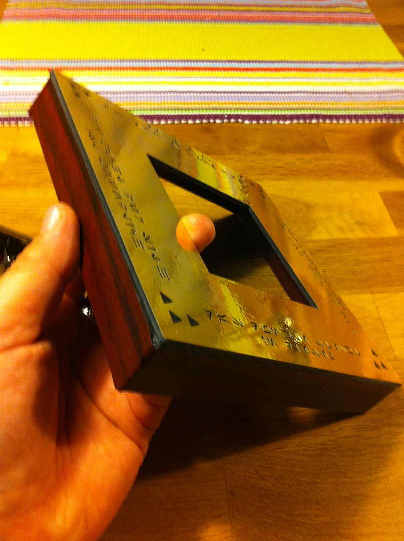

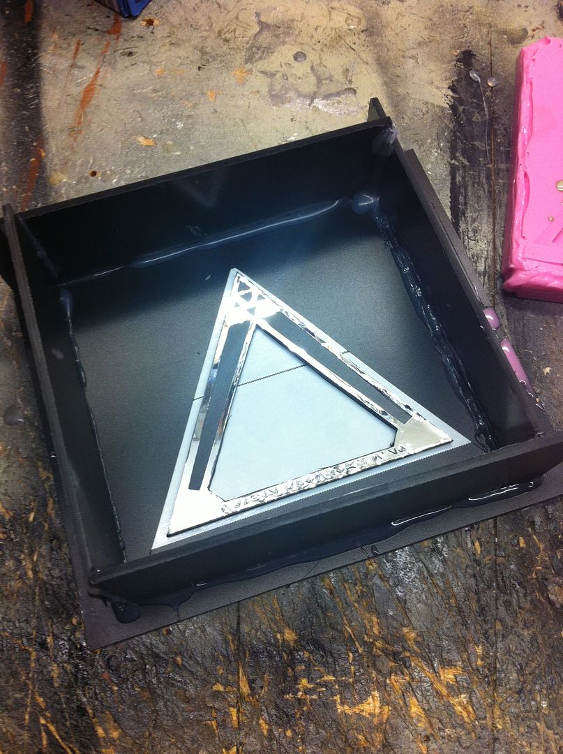

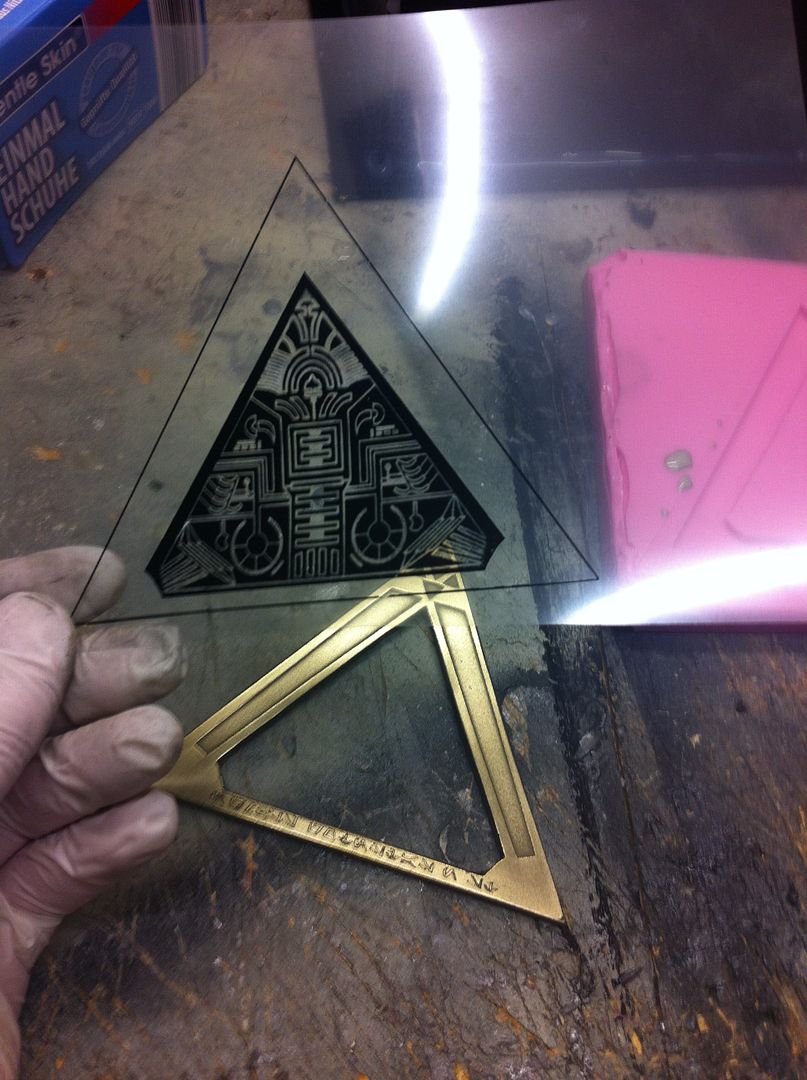

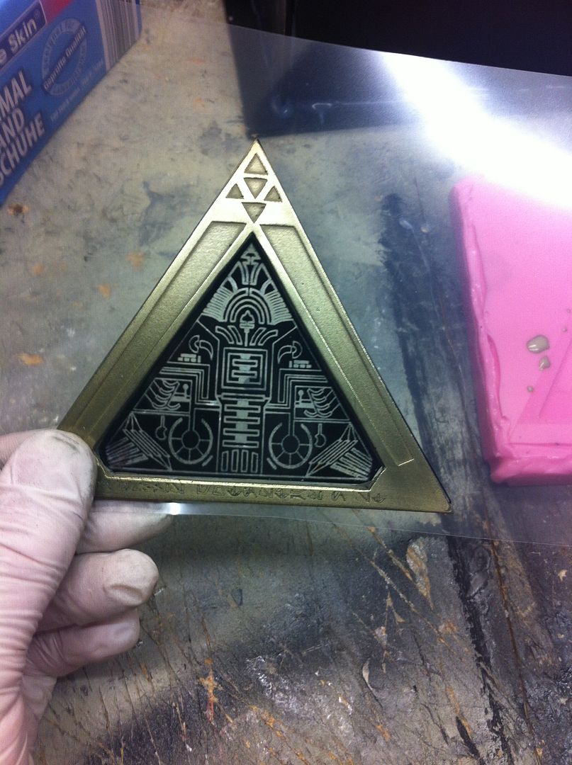

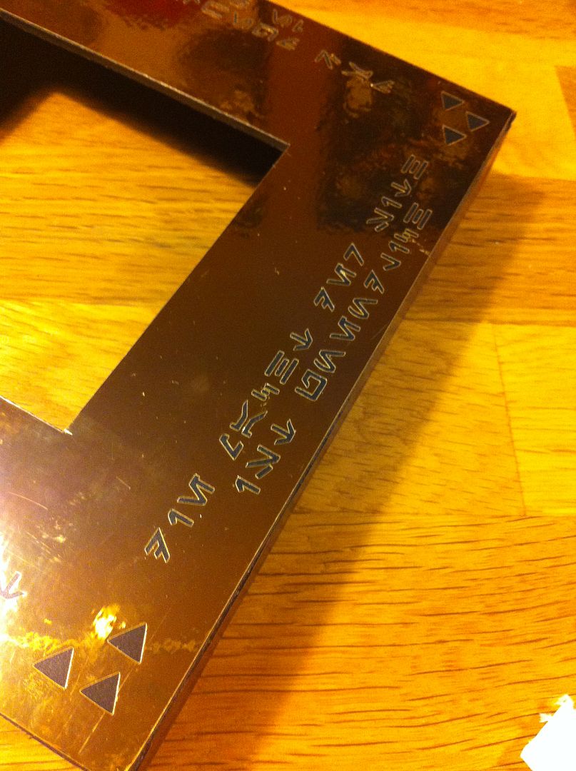

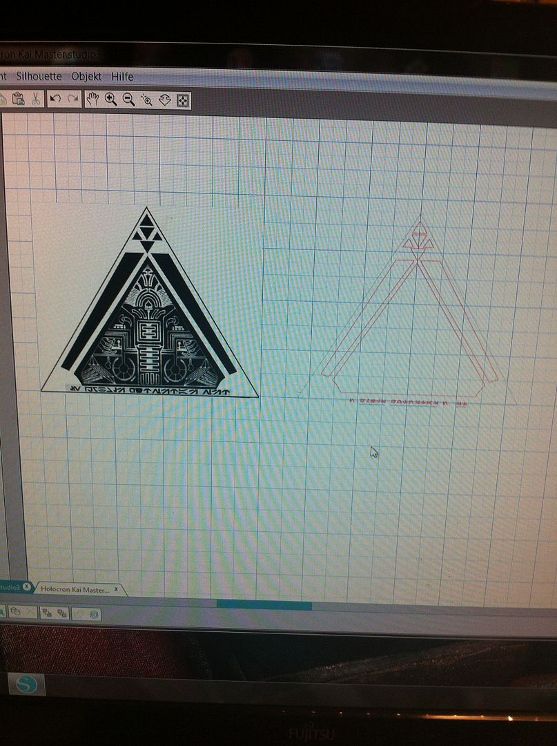

there are some awesome Holocrons around bud I want to build my own one. I use a file from the net and make a cutting file for my cameo silhuette plotter.

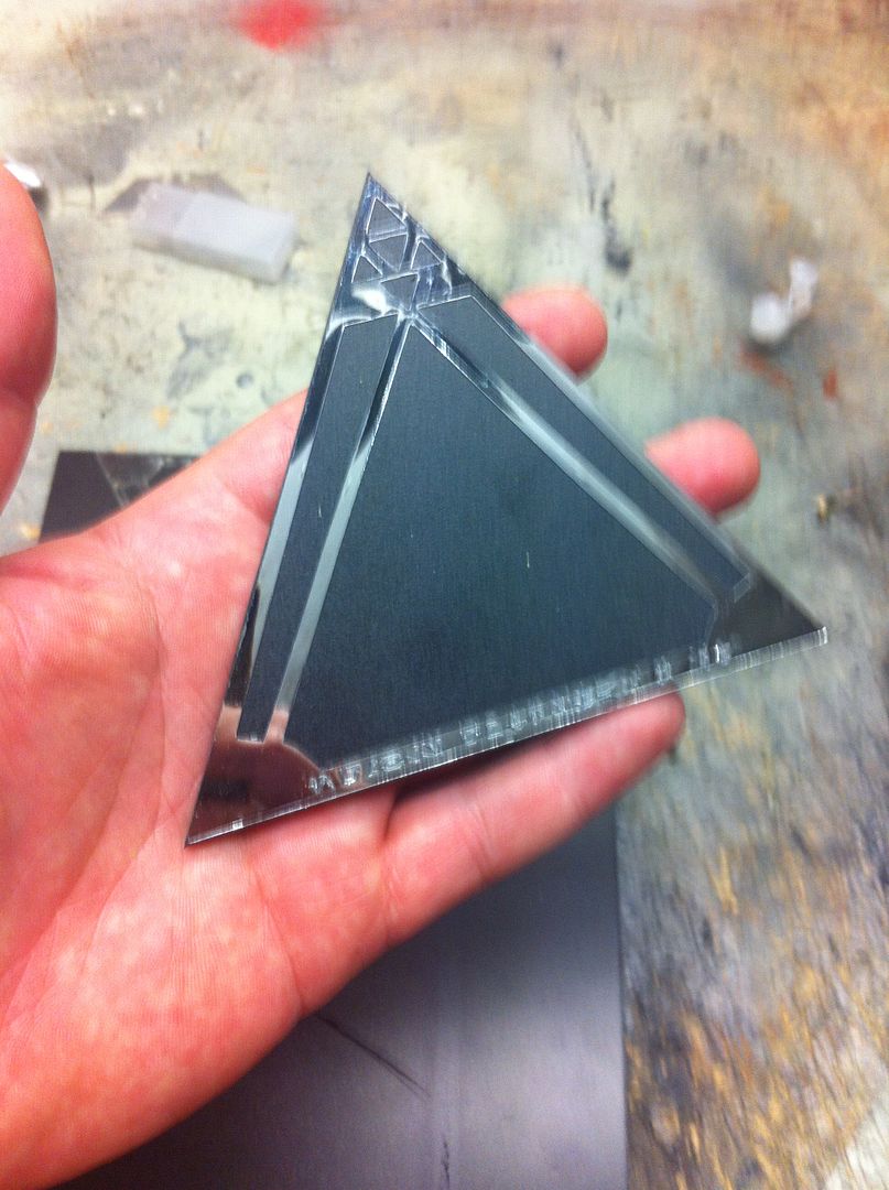

I cut thick chrome foil from my local home depot store and stick it on a foam sheet.

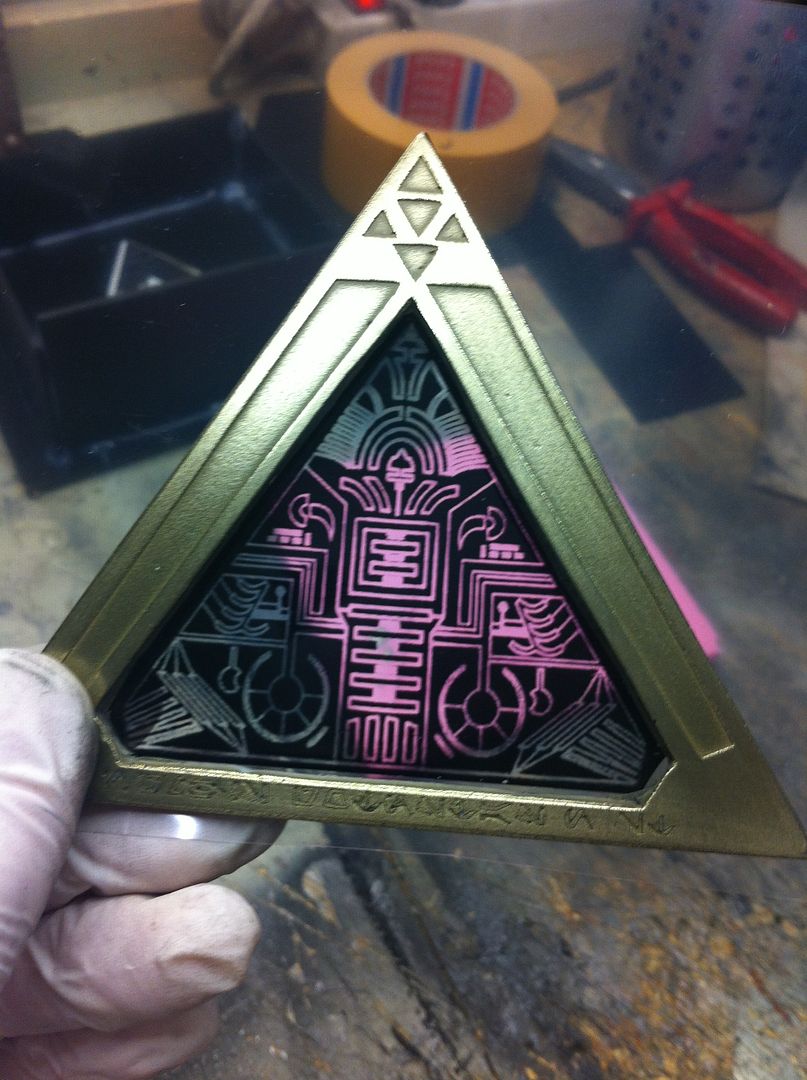

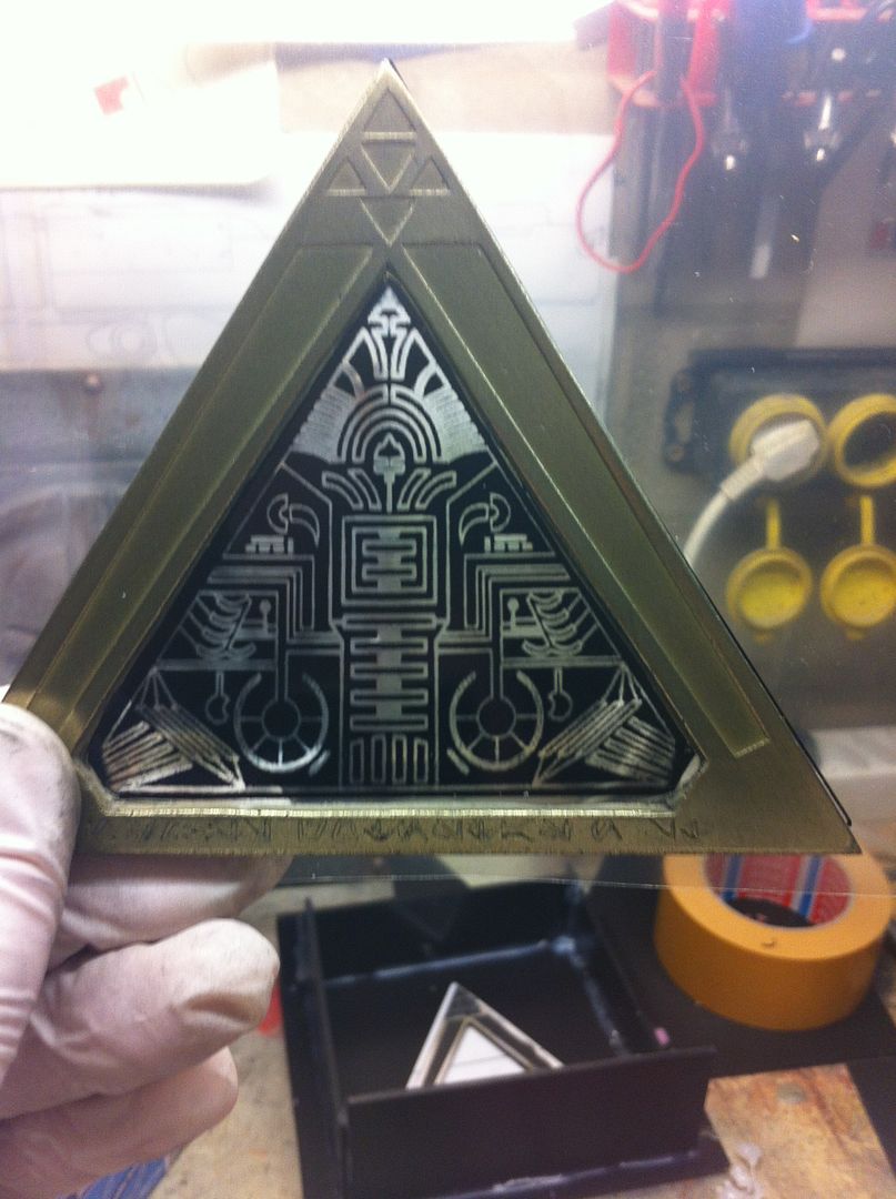

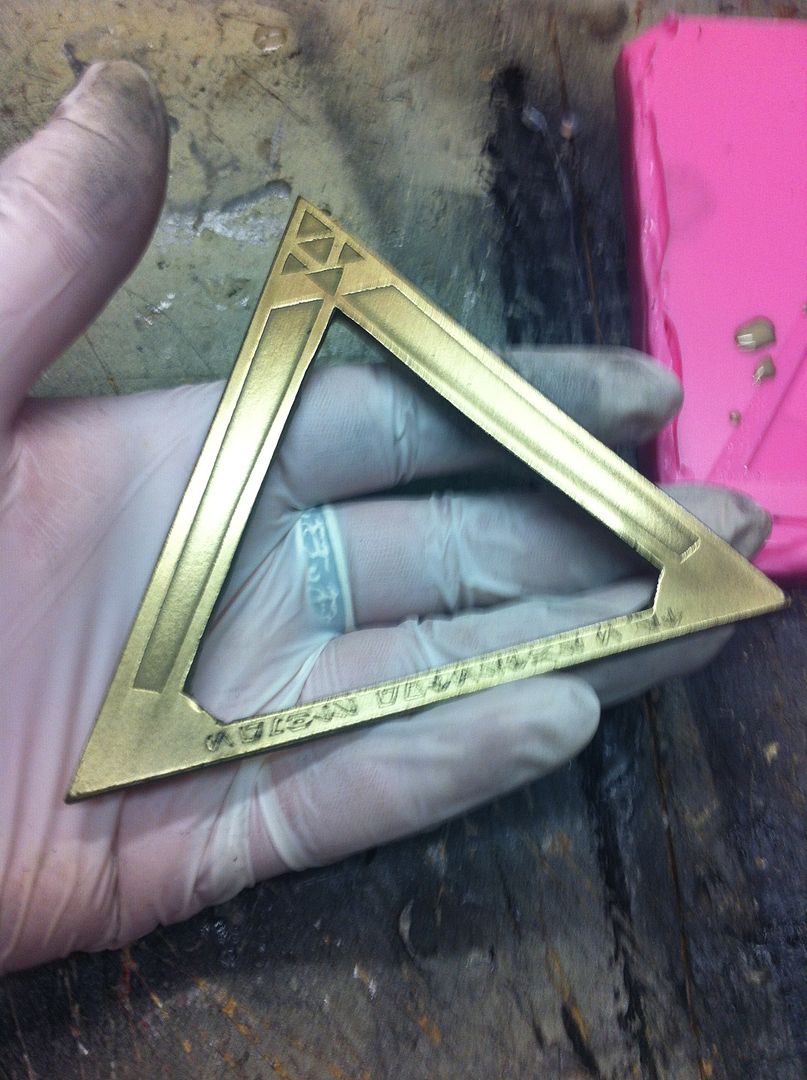

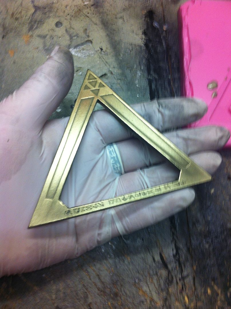

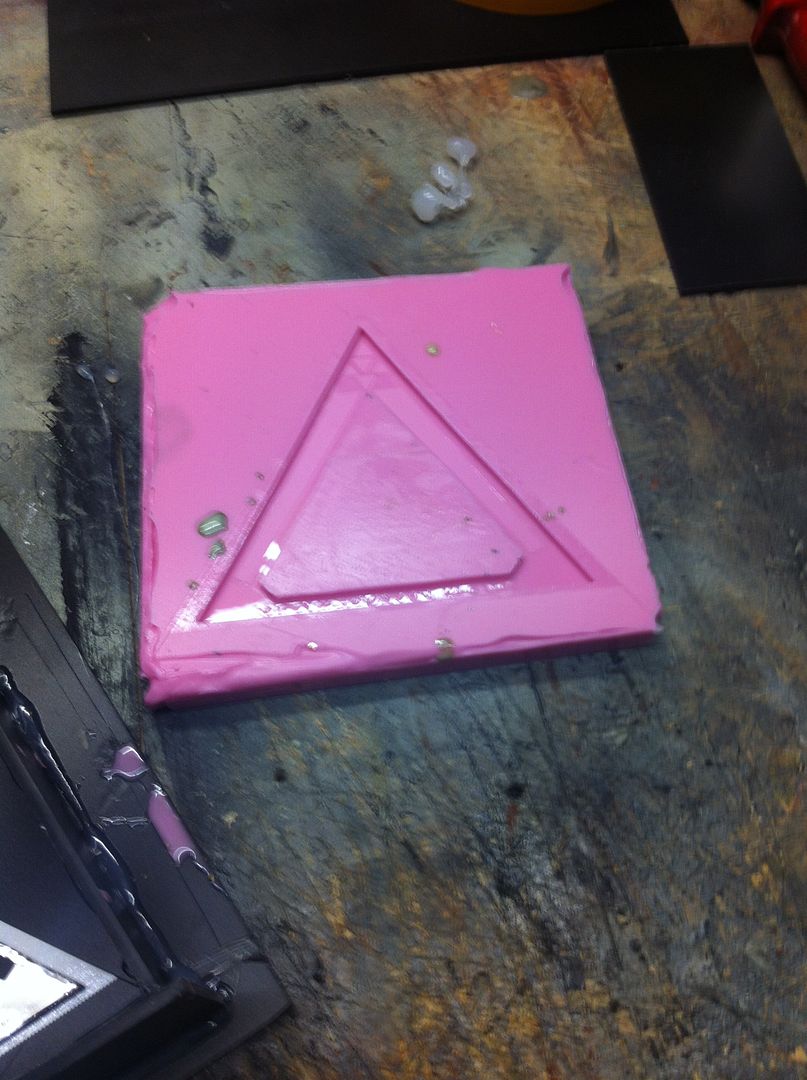

Now ! making a mold and cast the tile with cold cast resin. I use brass powder
After casting I polish the tiles with steel wool ... nice effet

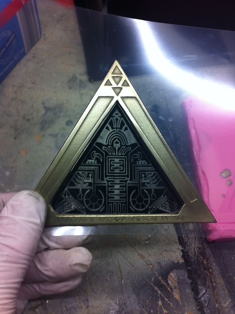

For the inner detail I print it on overhead foil ....works great

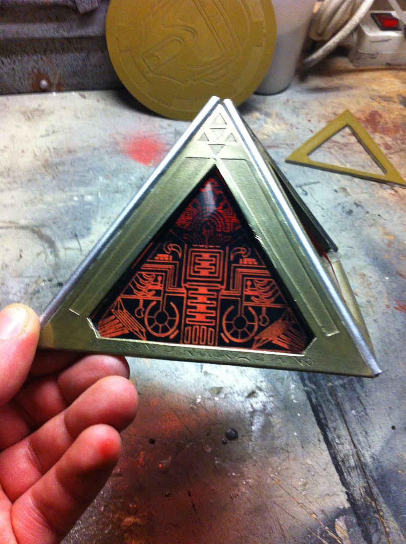

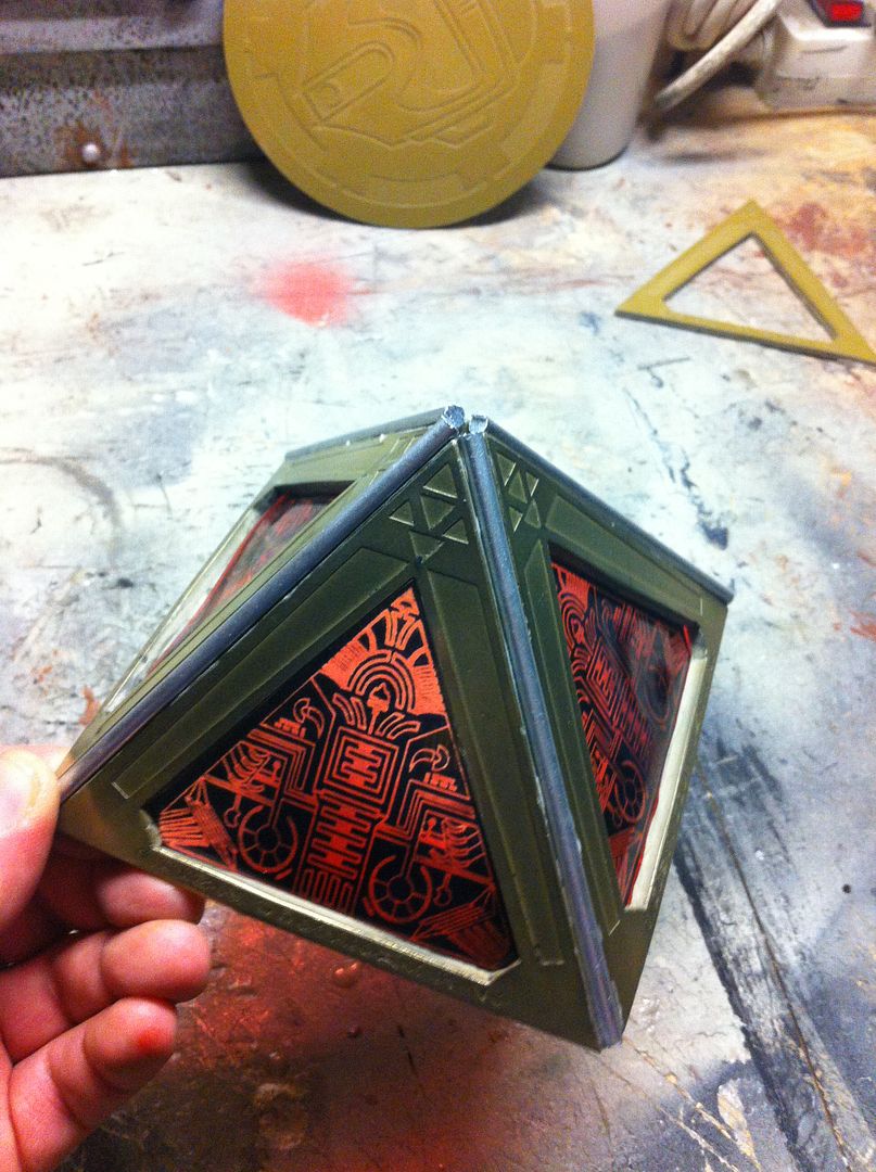

here we are !

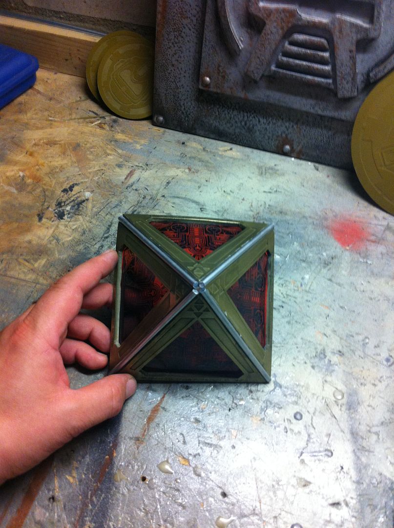

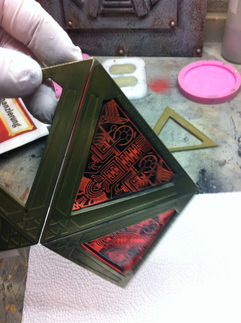

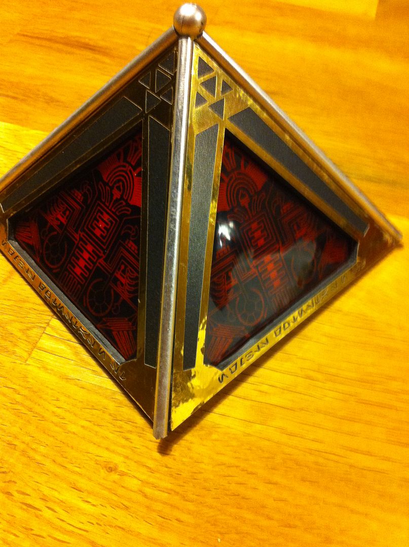

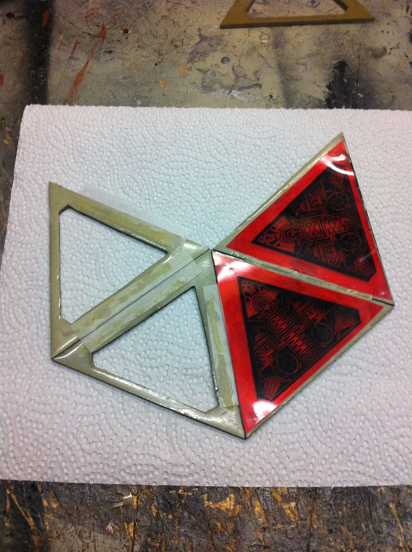

Now I fix the tiles with sticky tape ... I also make a update for the details and colored the inner details with a Iphone app

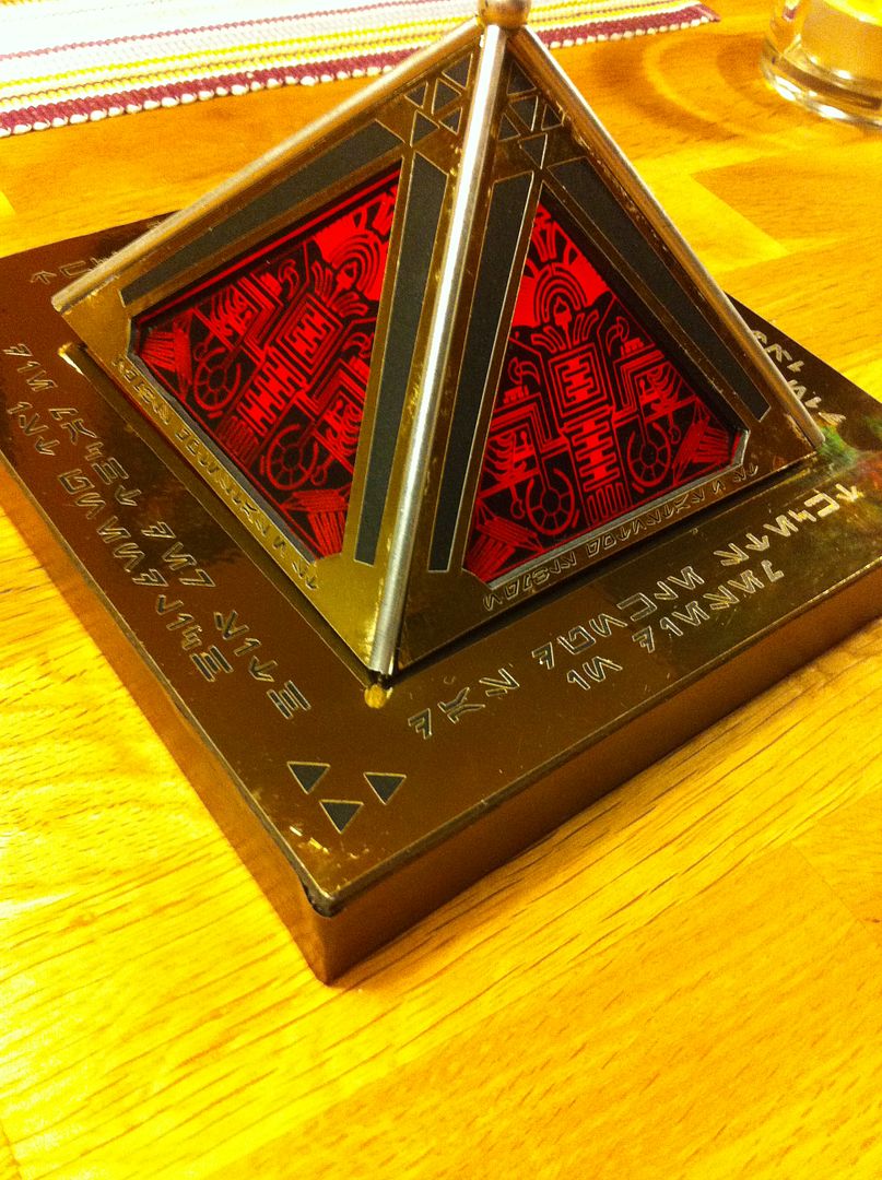

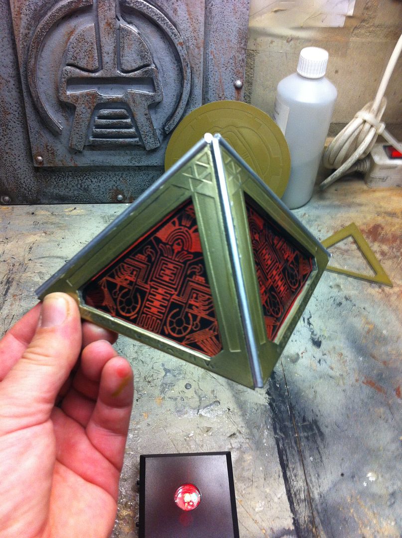

then I glue acrylic sticks in the gaps and this hold the Holocron in place

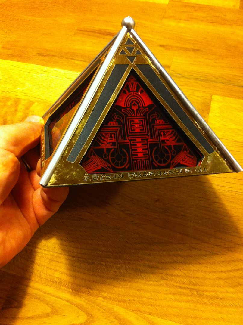

... and done

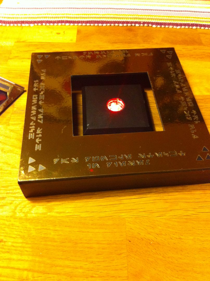

for more effects I use a LED Base with changing lights
So ! what do you think
have fun
Kai

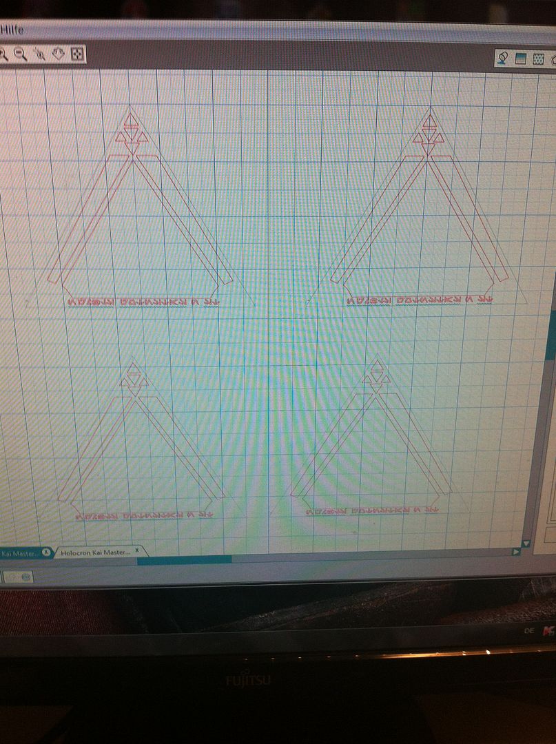

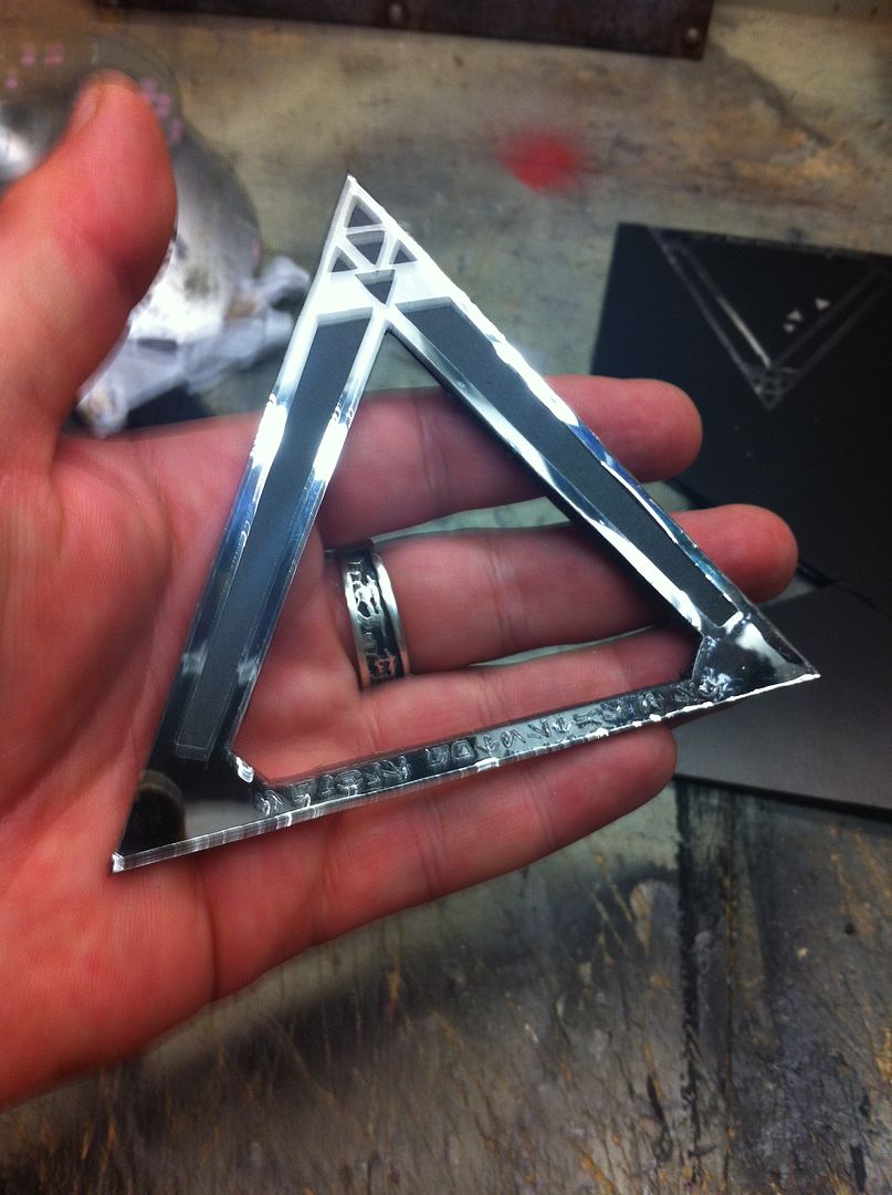

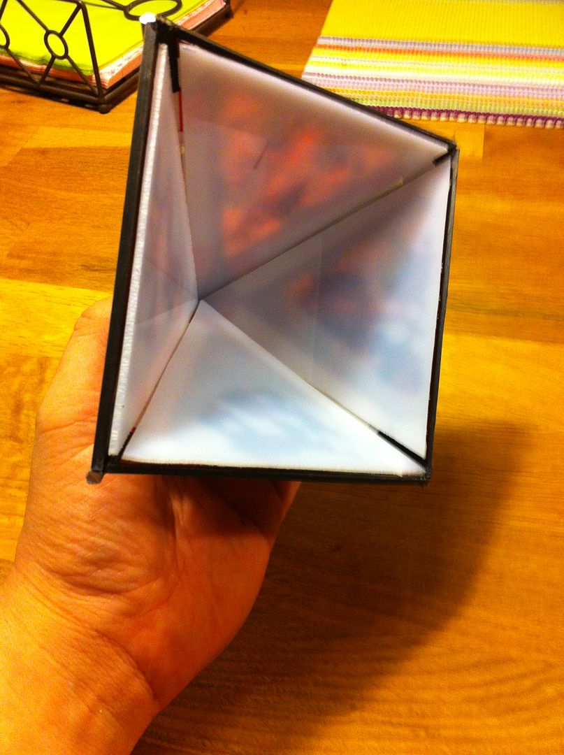

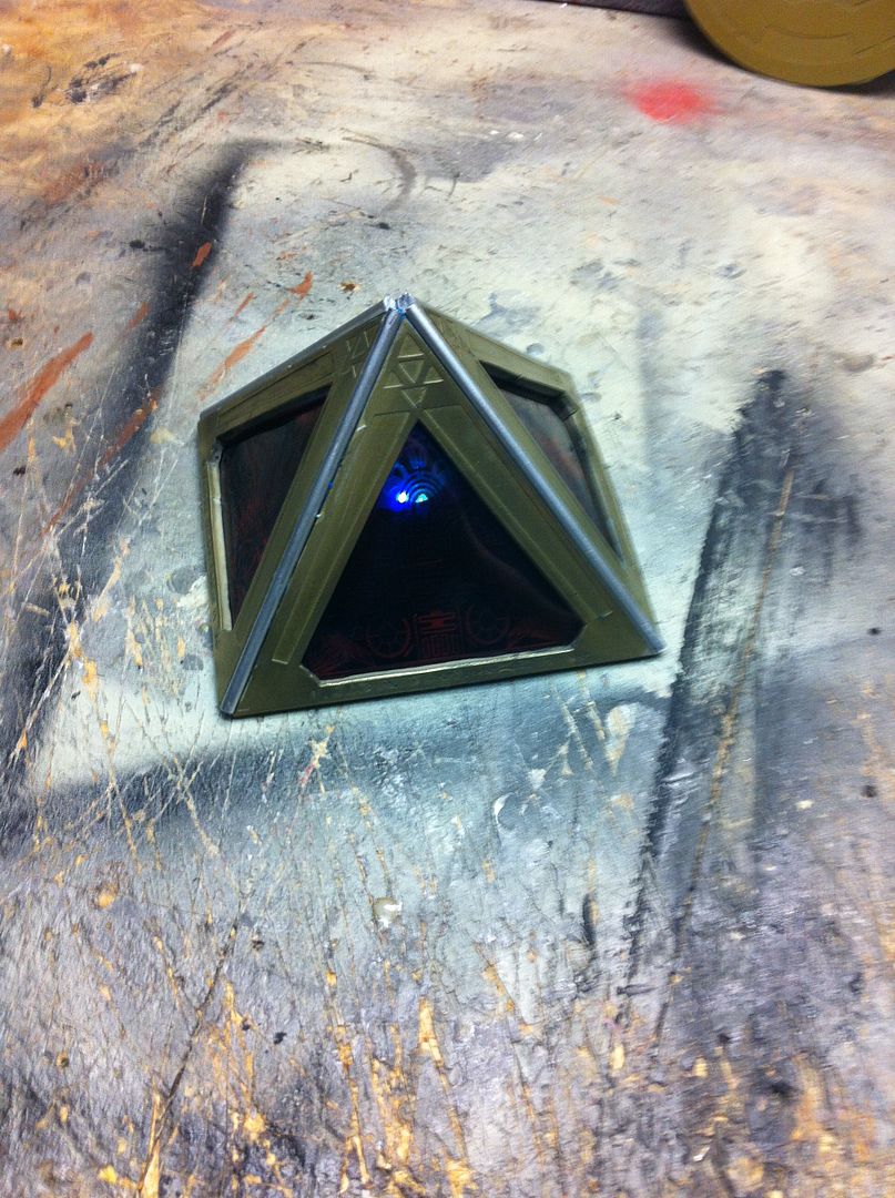

here we are !
