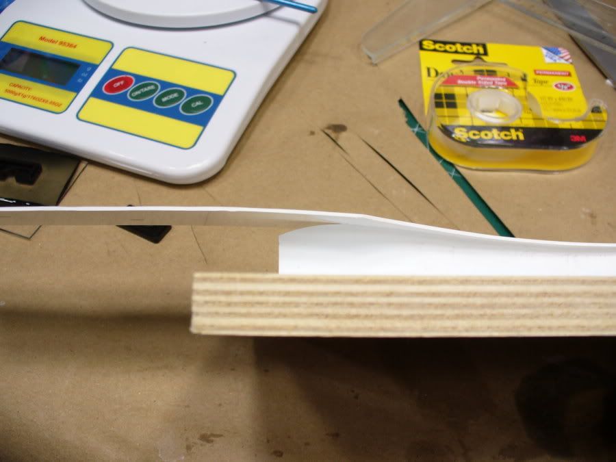

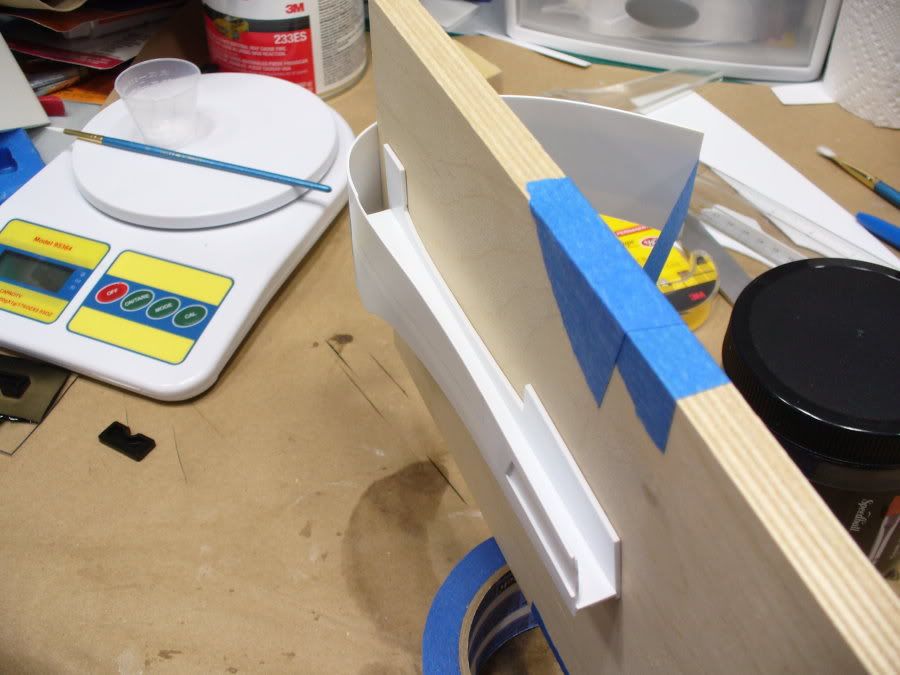

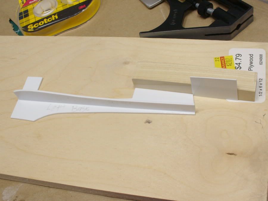

More done on the P2 master. I taped the base down onto a piece of plywood. I added a small wood block as an alignment guide.

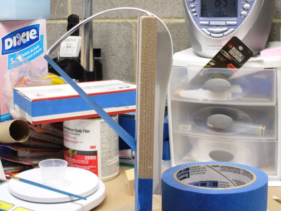

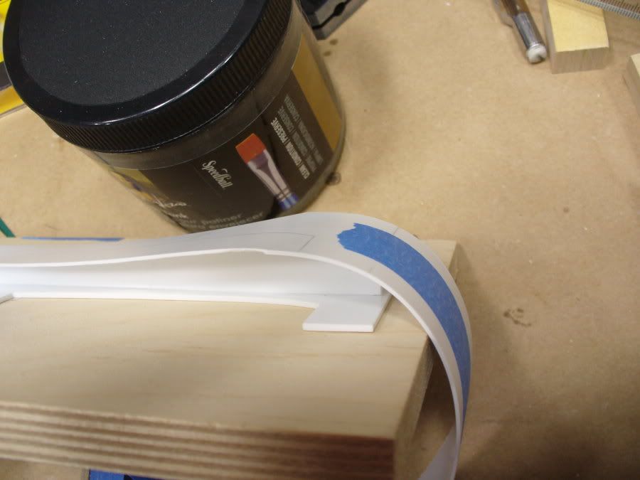

Then I glued the outer skin piece in place. I applied glue to the straight rear portion first, held the part in place until the glue set, then glued the middle part.
Then I glued it down onto the front curve. This is where the extra length comes into play, the plastic won't bend well at the end.
Both halves glued up.
