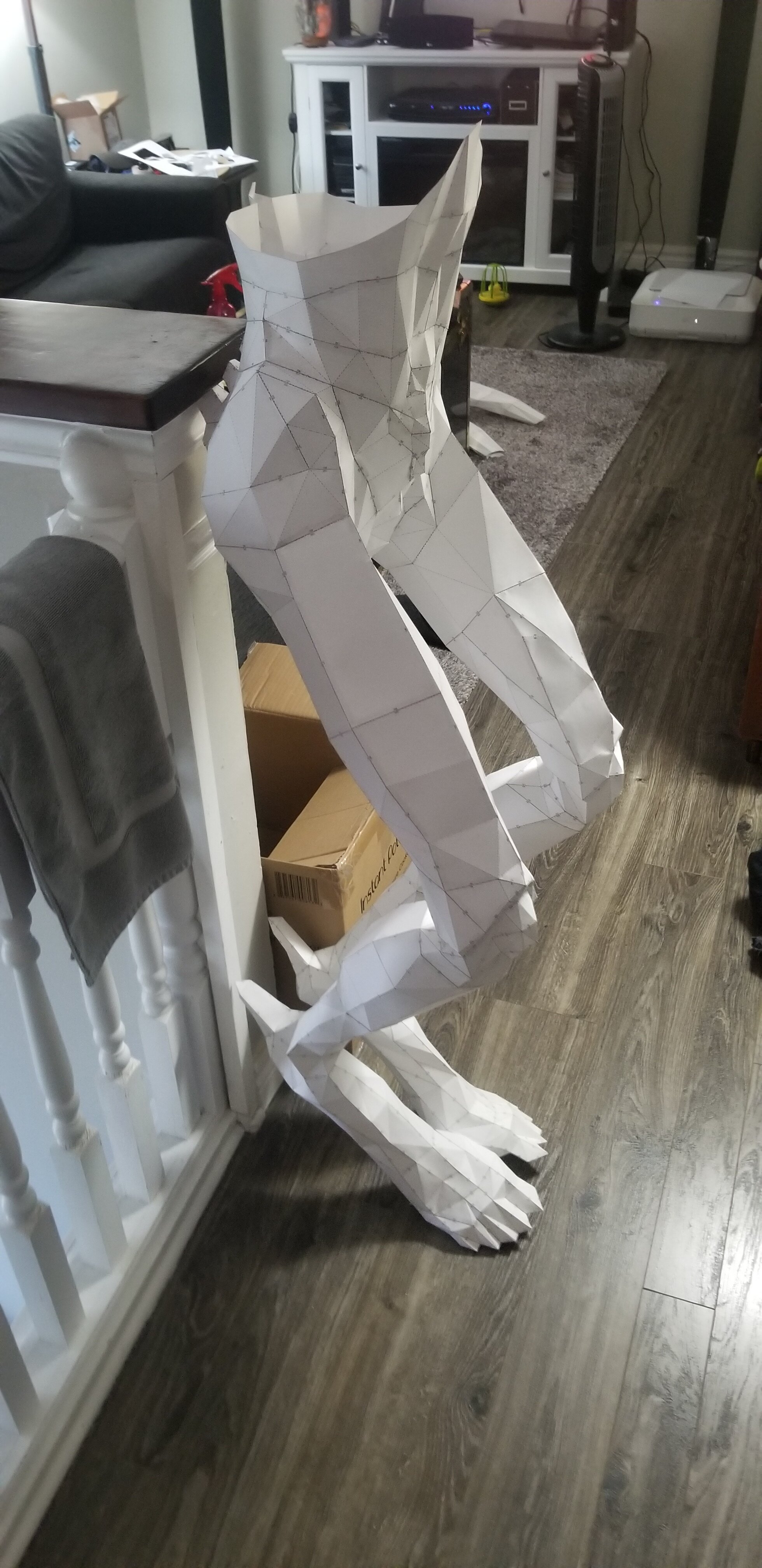

Quick question, should I fiberglass the whole piece om the outside before or after i separate the foot from the rest of the leg? Also going to separate the thigh from hip. Here is an image of the lower half currently.
I would do if before for more control during the resin process. Use scissors or a razor if you are really careful. Cut along the lines where possible keeping it as straight as possible.
