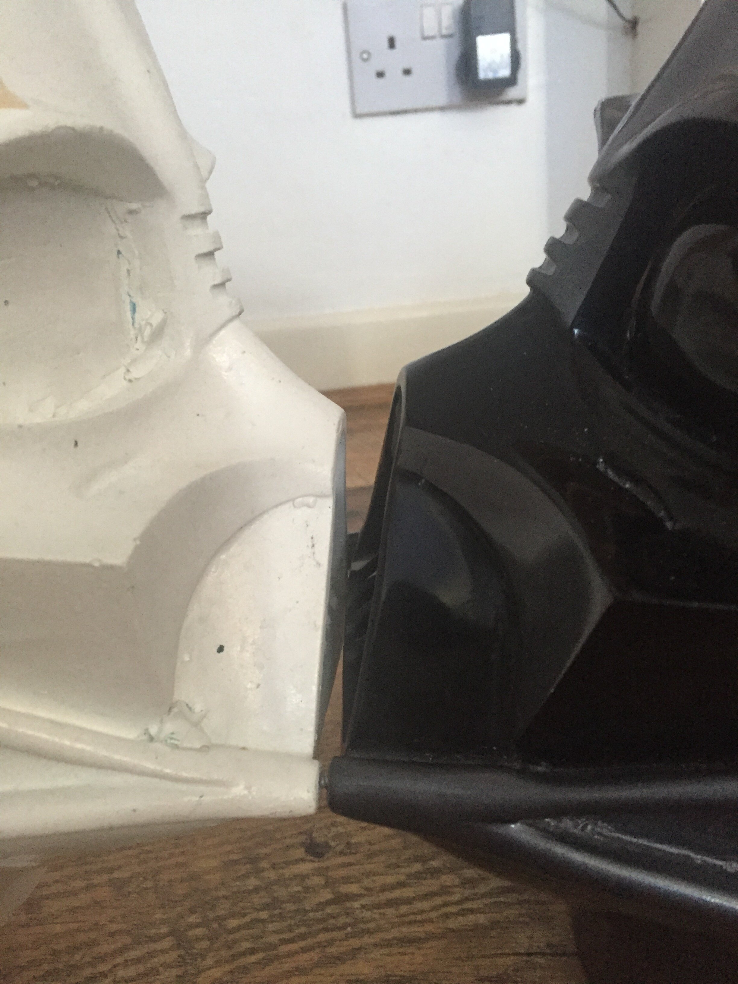

A handful of years ago I bought a reject cast set of Vader gear dead cheap (dome, faceplate chest armour and bells) on eBay to fix it up everything seemed 1:1 scale except the faceplate.

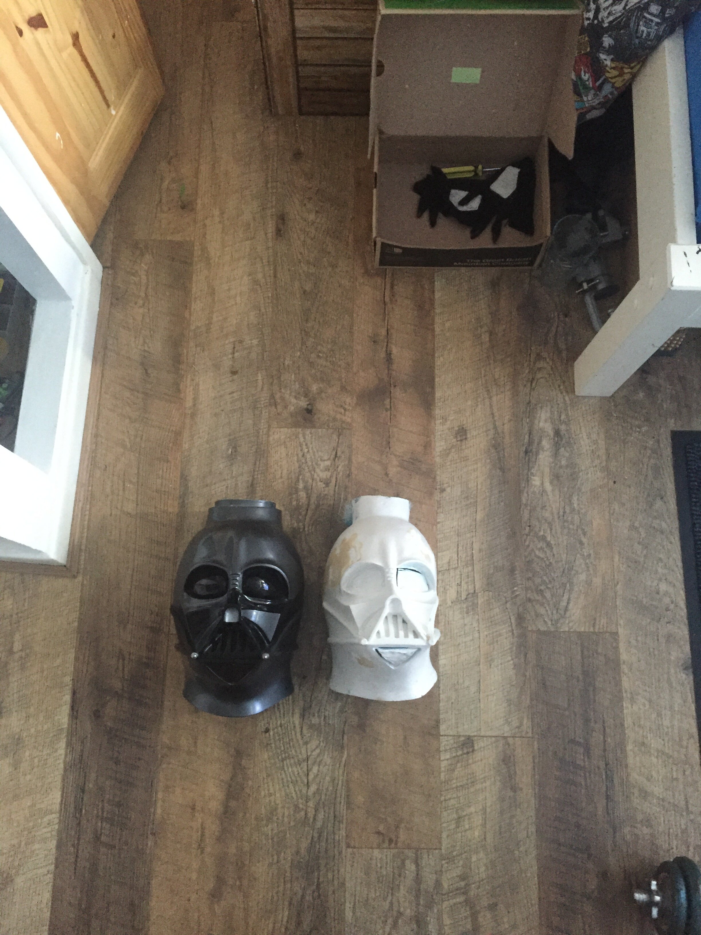

Here it is in comparison with my 'New Image-Prop-Replicas' I bought a year before this.
I only need it enlarged by 10% I know that means making a copy so I may sell this but I can't find a dome this scale.
As you can see by the 'hole' at the top its a DP DLX recast as these where meant for screws to keep the dome in place, I heard that the mask was slightly smaller than the screen used but this is like the ROTS scale faceplate so I highly doubt it was this small, if there is anyone who can give me recasting tips on how to get this enlarged by 10% please let me know I will be most grateful.
Cheers

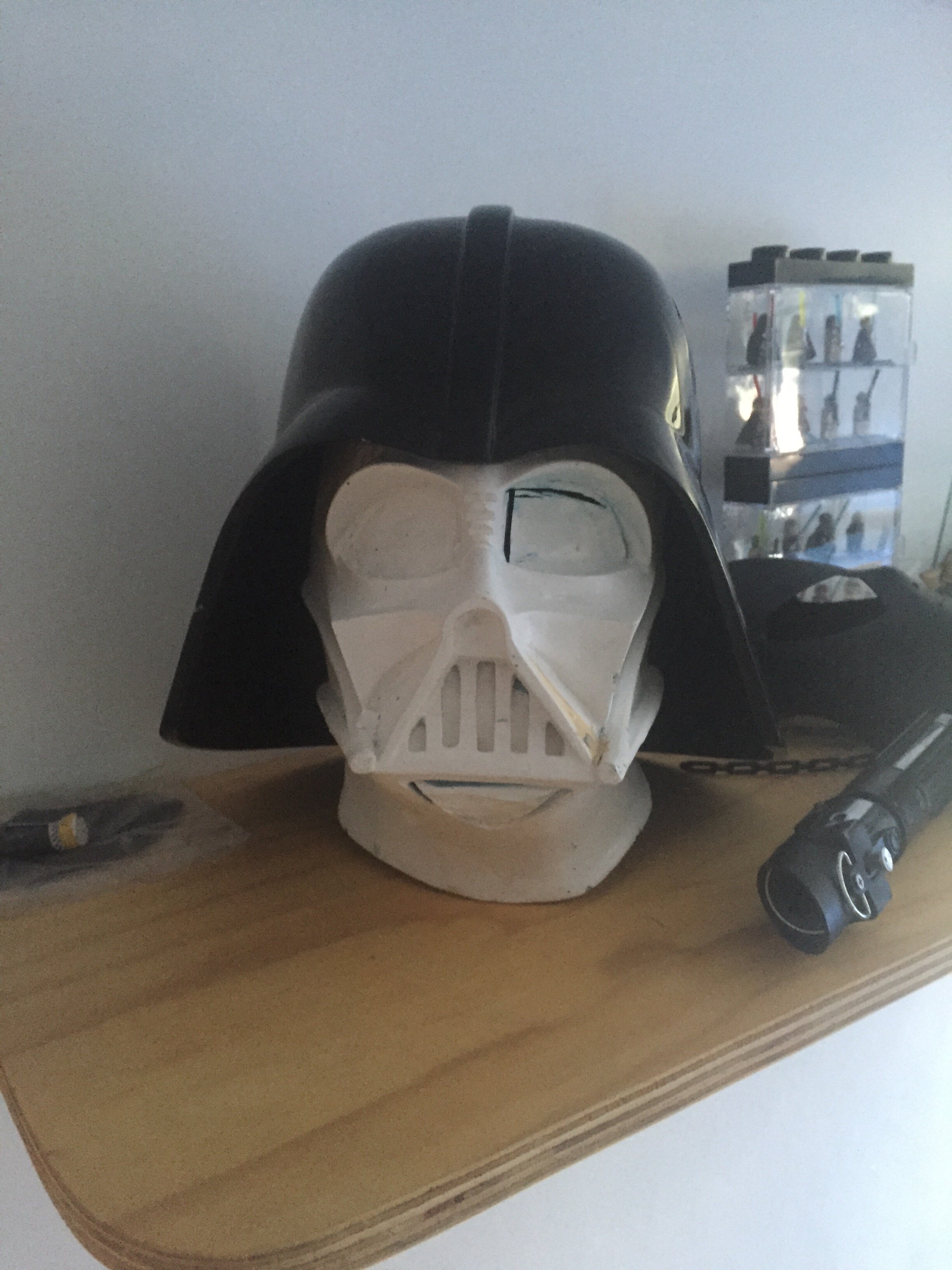

Take some pics about 5-6 feet back of it next to the new image. Hard to tell if it’s really that much smaller. It being a recast does make sense it’s smaller as each time it’s recast it shrinks about 5-8% I believe. Also if you still have the dome take some pics of it with the dome on to get a better scale. The only real way to enlarge a fibreglass casting like that is to build it back up with filler

The dome that came with it is a re casted supreme dome which is too thin and the front crumbled to pieces when I held the dome there and im redoing the caved in side of the dome so I had to use the new image one.
As you can see I couldn't get it in the right position but there it is and also is this image below too tiny?
Also I don't know if using filler would work I mean it would until I'd get to the eye and mouthparts here's an example of what I mean.
