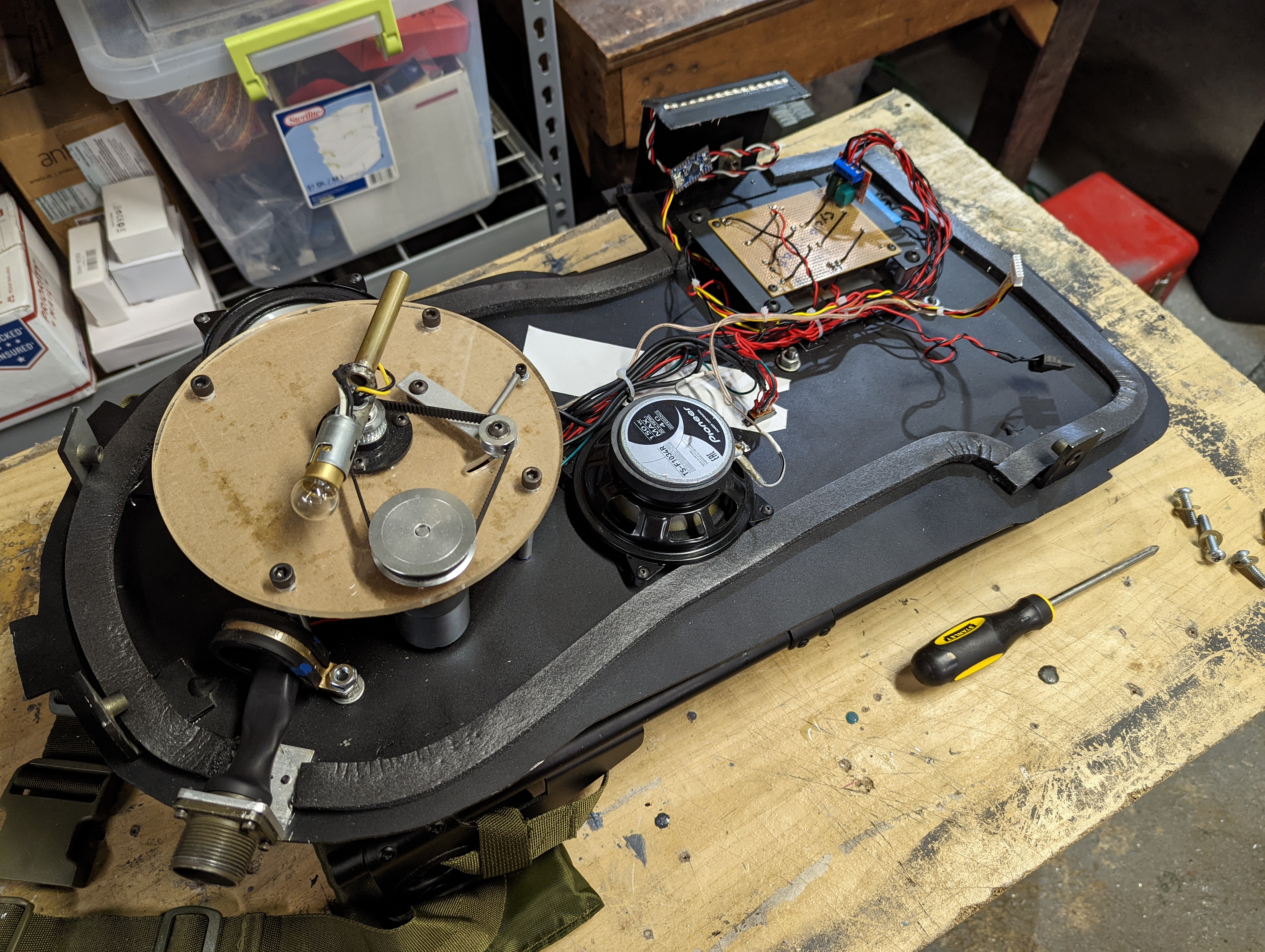

I used this Taidecent 3 wire / 10A / with a 22mm diameter. If you look at the images of the amazon listing, it shows you the dimensions of the part.
https://www.amazon.com/gp/product/B07QRSNHKR/
Here is a photo of it installed in my pack.
Oh wow thank you, I actually baught a similar one to that just the other day off banggood but it has 6 wires even though I won't be using most of them although I will be using addressable LEDS so I can play with the colour, waiting for it to arrive so hopefully it works out, great mechanical cyclotron btw
