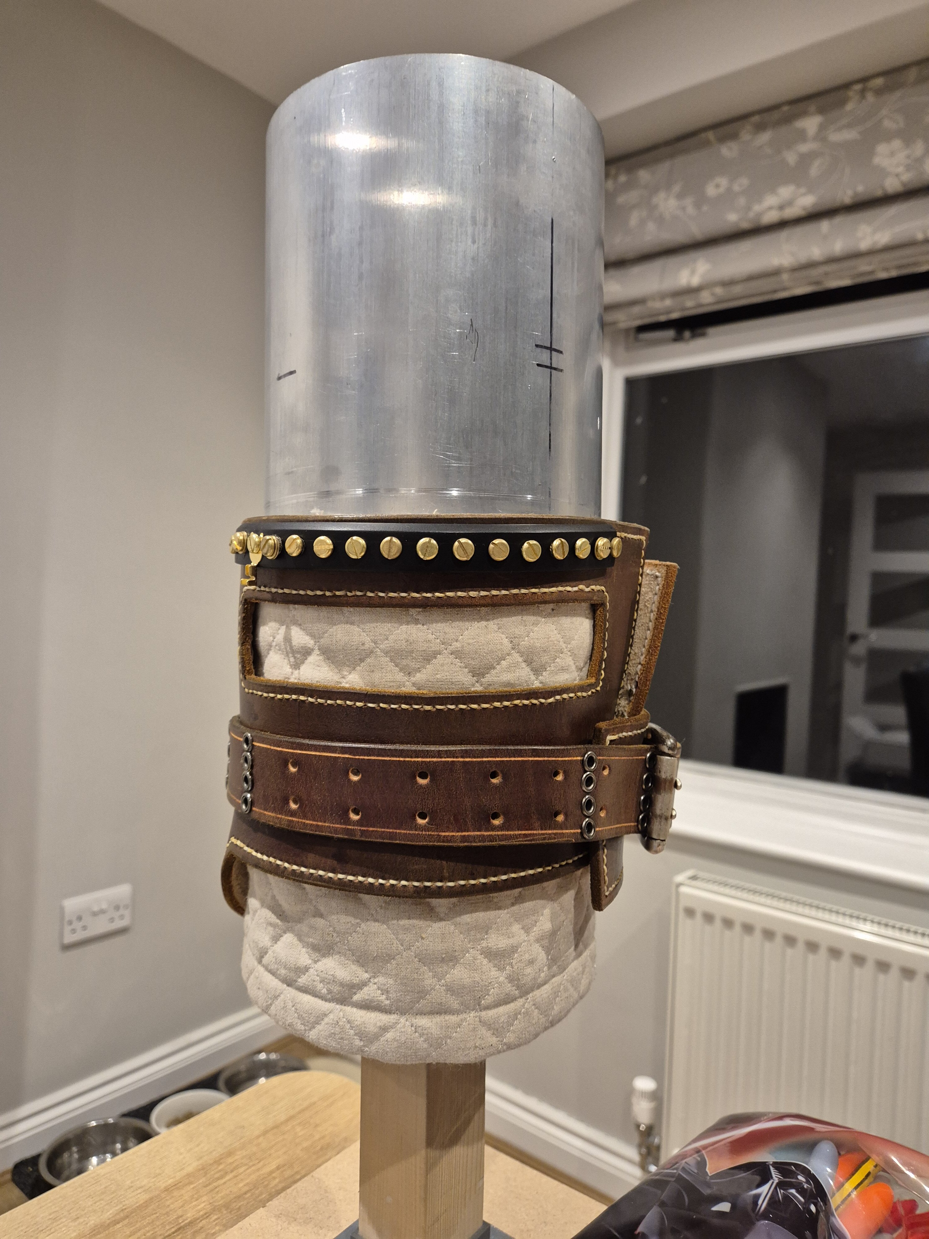

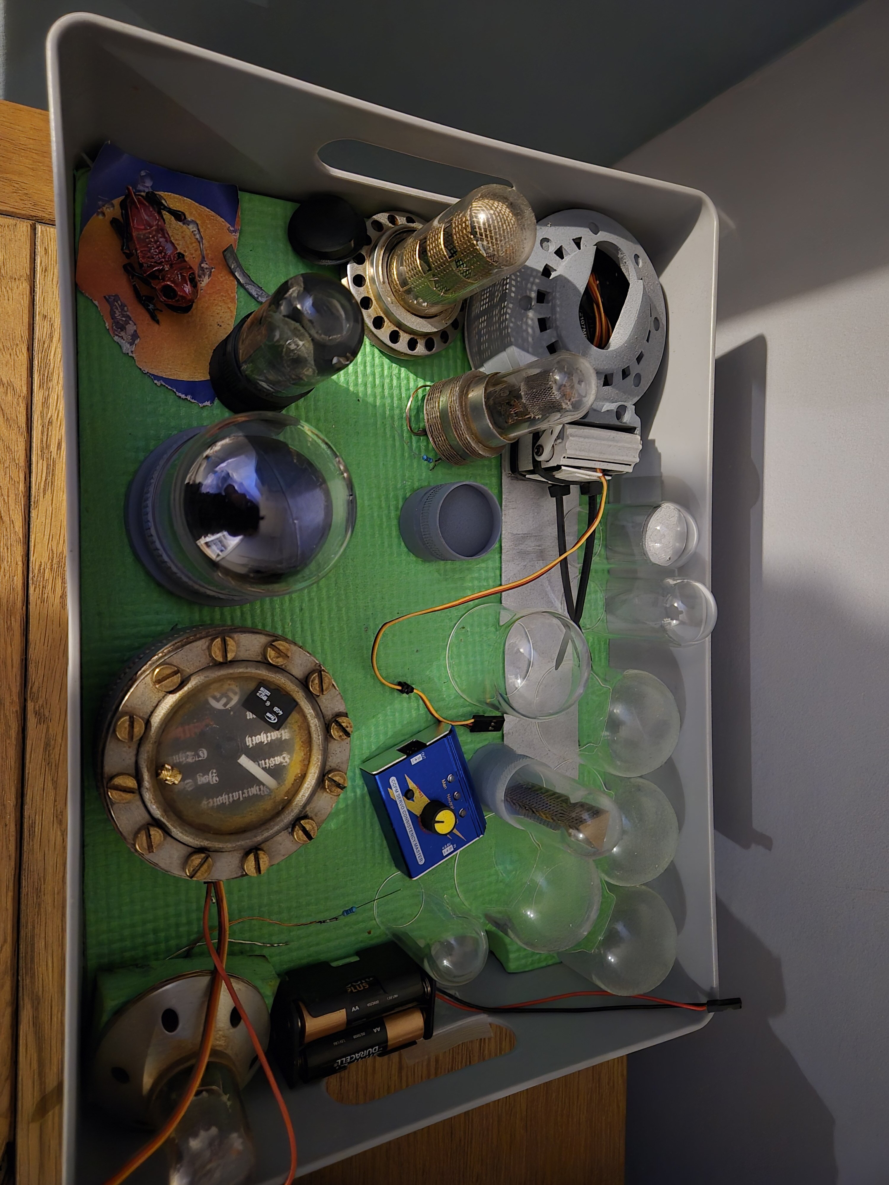

Hi guys just looking for bit of help/information I'm making a bit of progress i have my glass all sorted and some of the leather but I'm stuck on the glove part this is my progress so far
Hi have the spinning ring 80% of the way just have a few kinks to iron out but have a basic prototype working

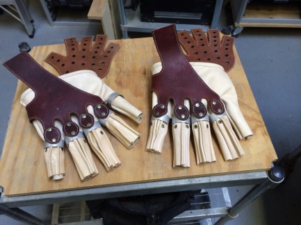

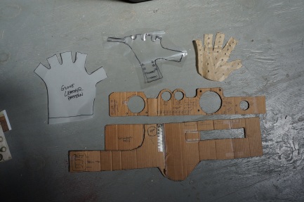

Just looking for a bit of advice on a glove pattern

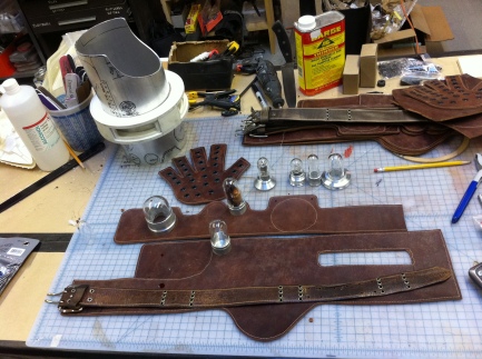

Here is some of the photos i saved before the adams link died i have more these are just the glove pattern. if you could share any of your stuff that would be much apreciated
